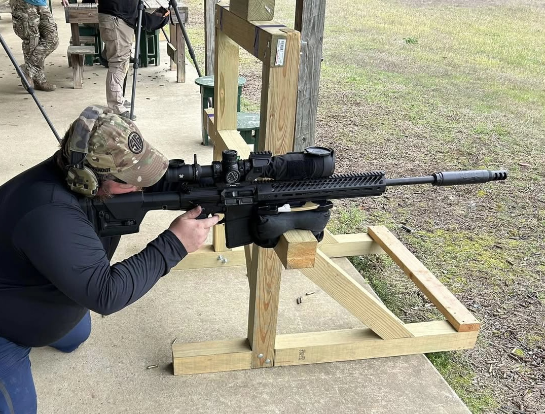

Shot the PRS 2 day at Clinton House SC last weekend - first match with the RecoilX. Omega 300. Dasher. I normally use ACE brake or APA FB Gen 3. Had no issues (no more than normal!) seeing misses. Definitely quiet and dramatically reduced blast/concussion. First stage all my squad mates talking about how quiet that combination is. My biggest concern was the added length through windows and ports but worked out fine. Running again this weekend at a regional 1 day. Did not have too many issues with RecoilX loosening - I checked suppressor and RecoilX after every stage.

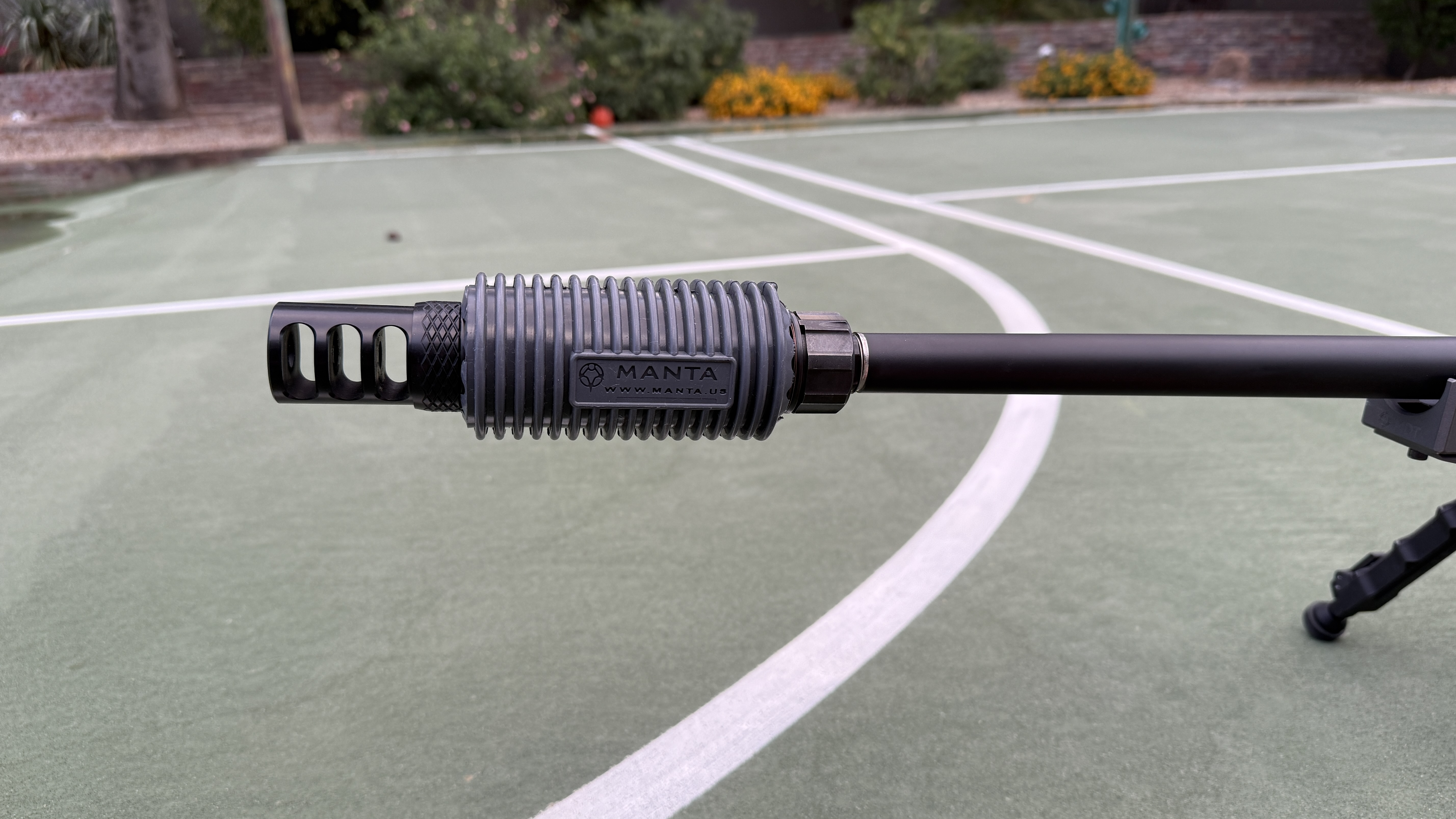

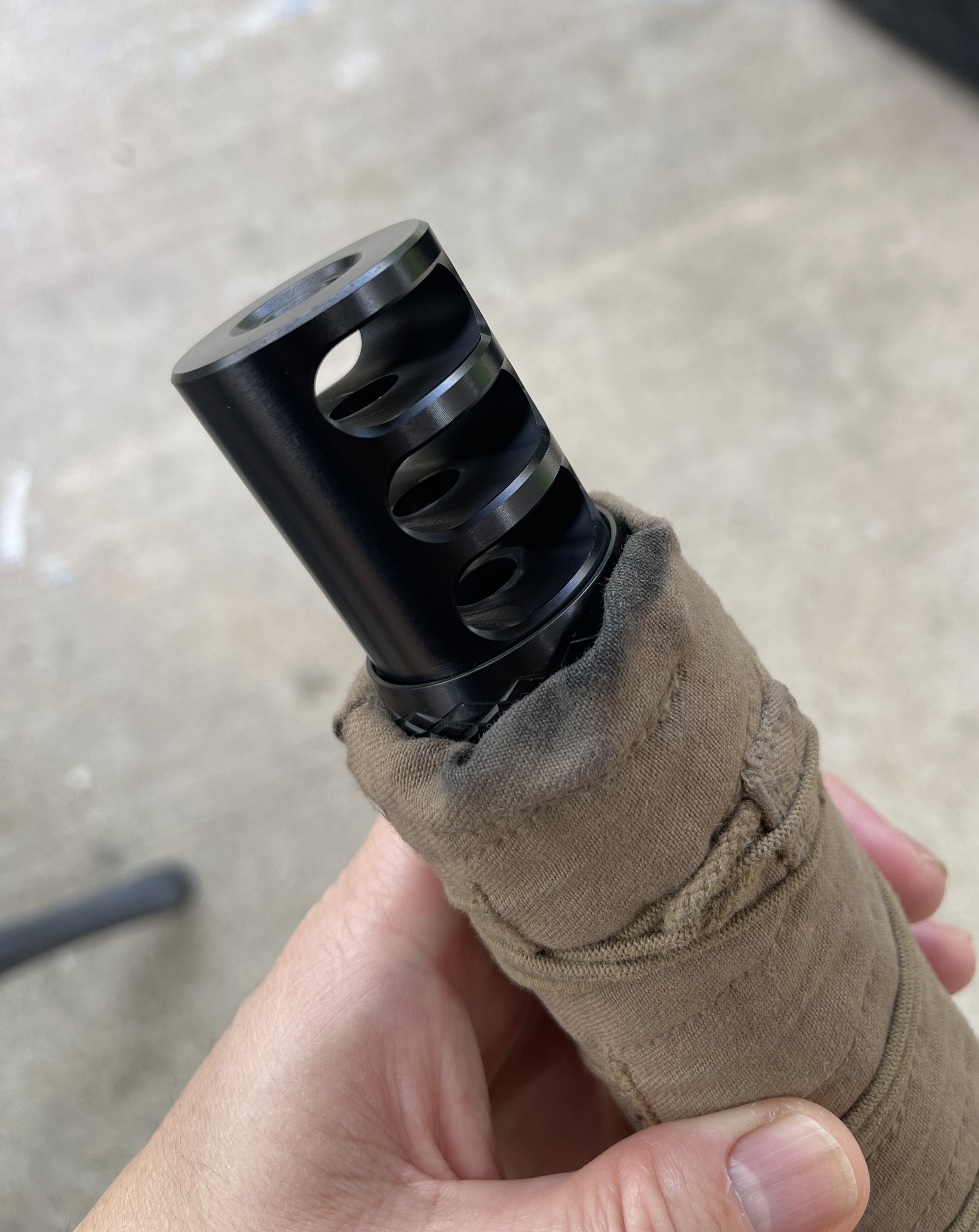

Will be trying this setup tomorrow. RecoilX on a DA Sandman-K on a DA Brake with Manta wrap cut to fit (poorly). Looks ghetto fabulous but interested to see how it goes.
Shot this yesterday, 130 rounds of 6.5 CM. Have to say I thought it was great. Had Otto Noize Barriers in so take that for what it’s worth. Hard to tell how loud it is. But the concussion was reduced and recoil mitigation was great. Zero headache afterwards. Will use this combo again.
