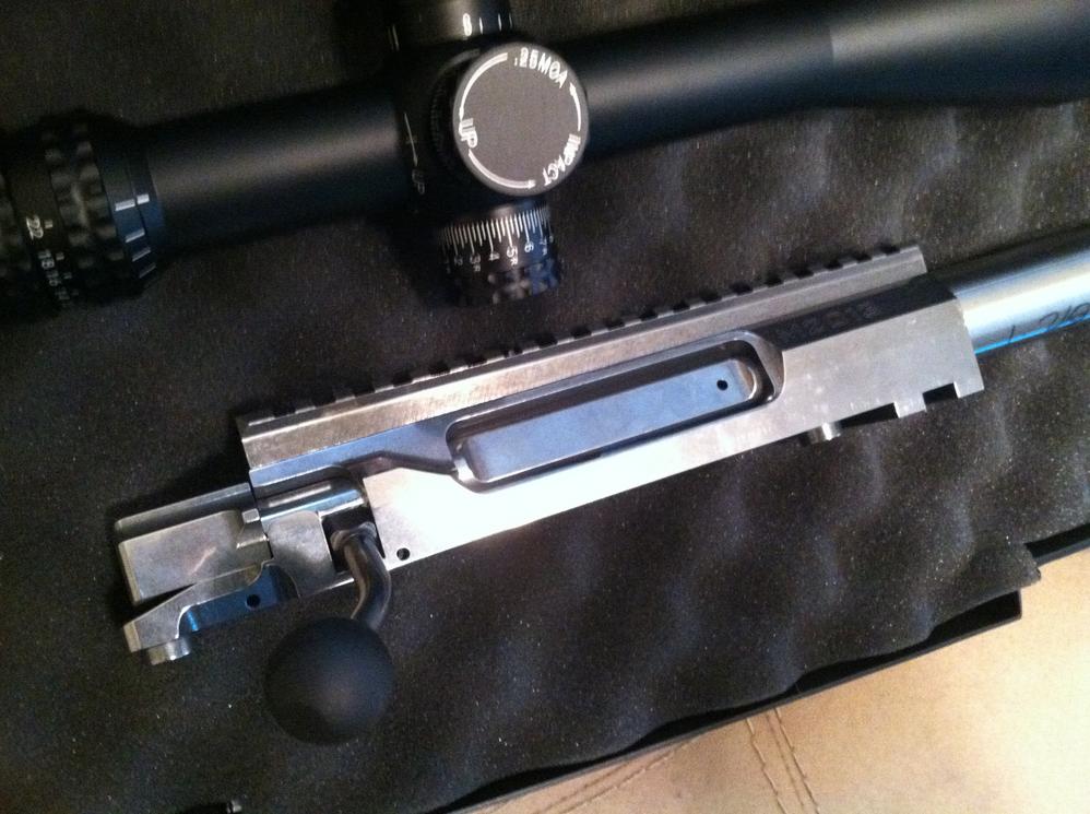

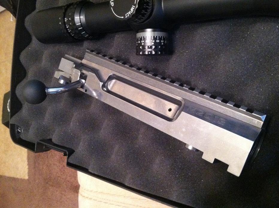

Looks like you were going crazy with the box cutter on your finger getting into the box. Lol. They look really nice. What's your first impression of the action?
xdeano
HA HA... Previous injury to the index....
First impressions.... Stout, solid action. Smooth as silk is right.
It's a beast. You don't want to drop this thing on a toe.

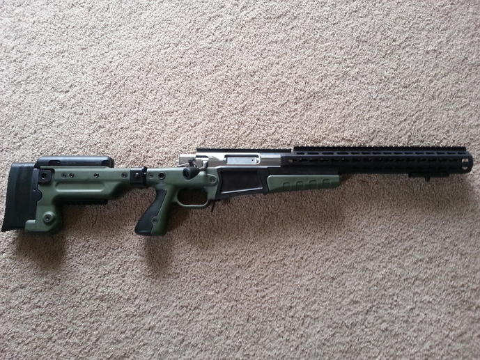

Here it is in an AX Chassis, now what to do to make the top rails line up.

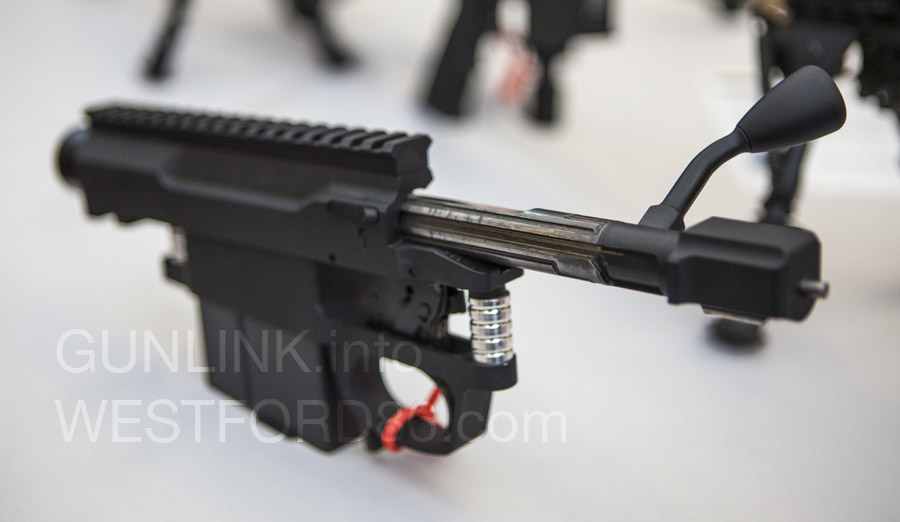

That fluting looks different than the SHOT pictures I've seen.
I don't think it can be done that fast. We had a new baby last week and I lost track of time, didn't realize typing it that July was so close. Here's hoping for a quick turn around anyway.
I remember the SHOT pics having much more aggressive fluting too. Haven't gone back to look at 8541's pics in a while.
