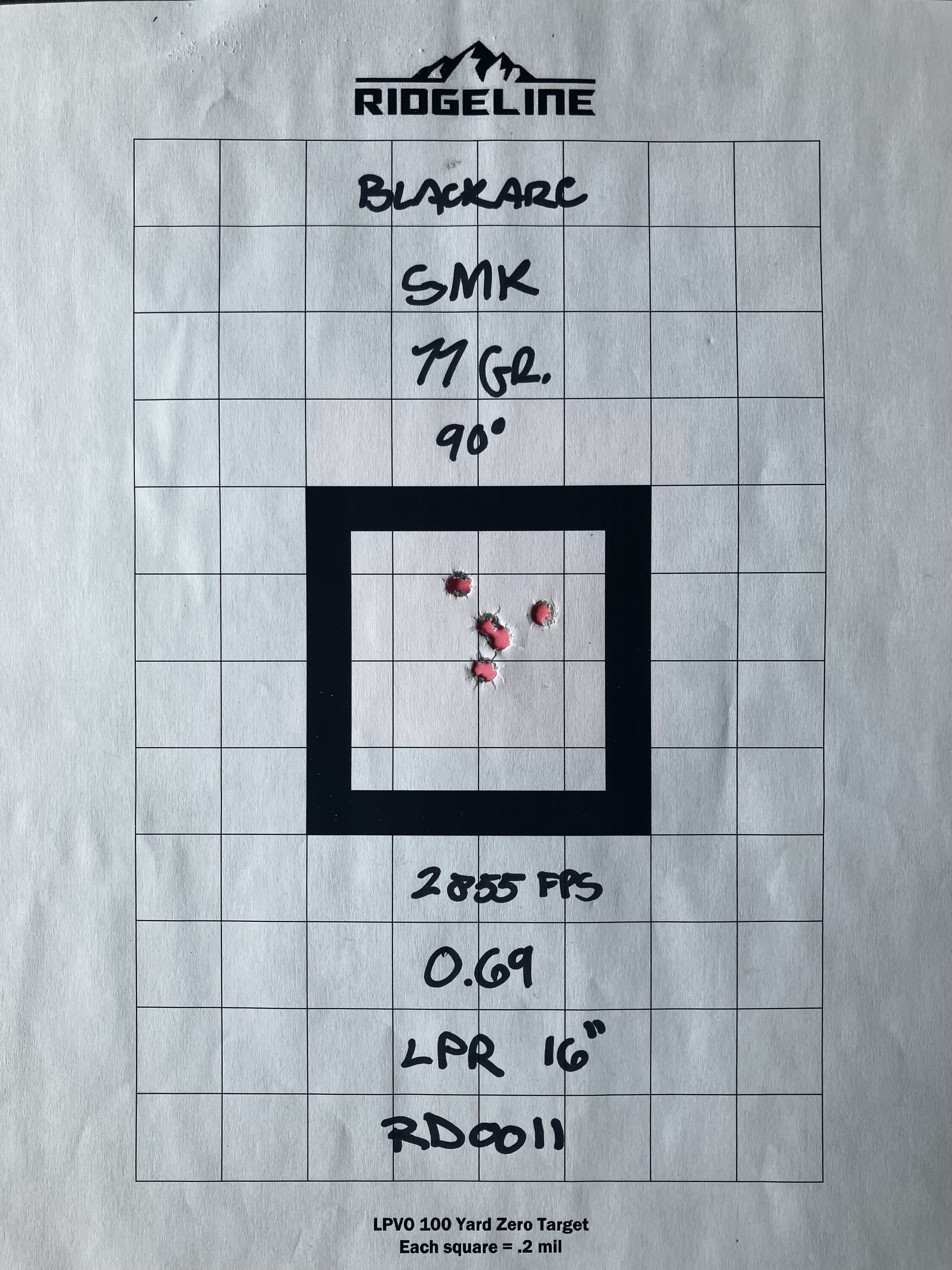

I've been loading NAS3 cases with 77gr SMK at 2900fps from my 18" barrels. The accuracy just as good and SD's are smaller than my brass loaded ammo with an additional 200fps. Also, I am loading them at .83c/round, that's with only using the NAS3 once. IMO, the gains in performance are worth the squeeze. The NAS3 have more case capacity because of the consistent casewall thickness, the mouths are perfectly round with identical neck tension case-to-case, and the SS head handles pressure better than would ruin brass. Now, what it's doing to my bolt and throat I dunno LOL. I have fired 1.5k of my loads so far, so I'm still learning about longevity/wear.
Next I'll be loading some 73gr ELDM around 2950fps.
Maybe this fall/winter I'll try some 55-70gr for thermal coyote hunting, and finally move away from 224V entirely.
I feel like the NAS3 has opened up the possibilities for my 5.56's beyond 600y or just 3-gun/2-gun blasting.

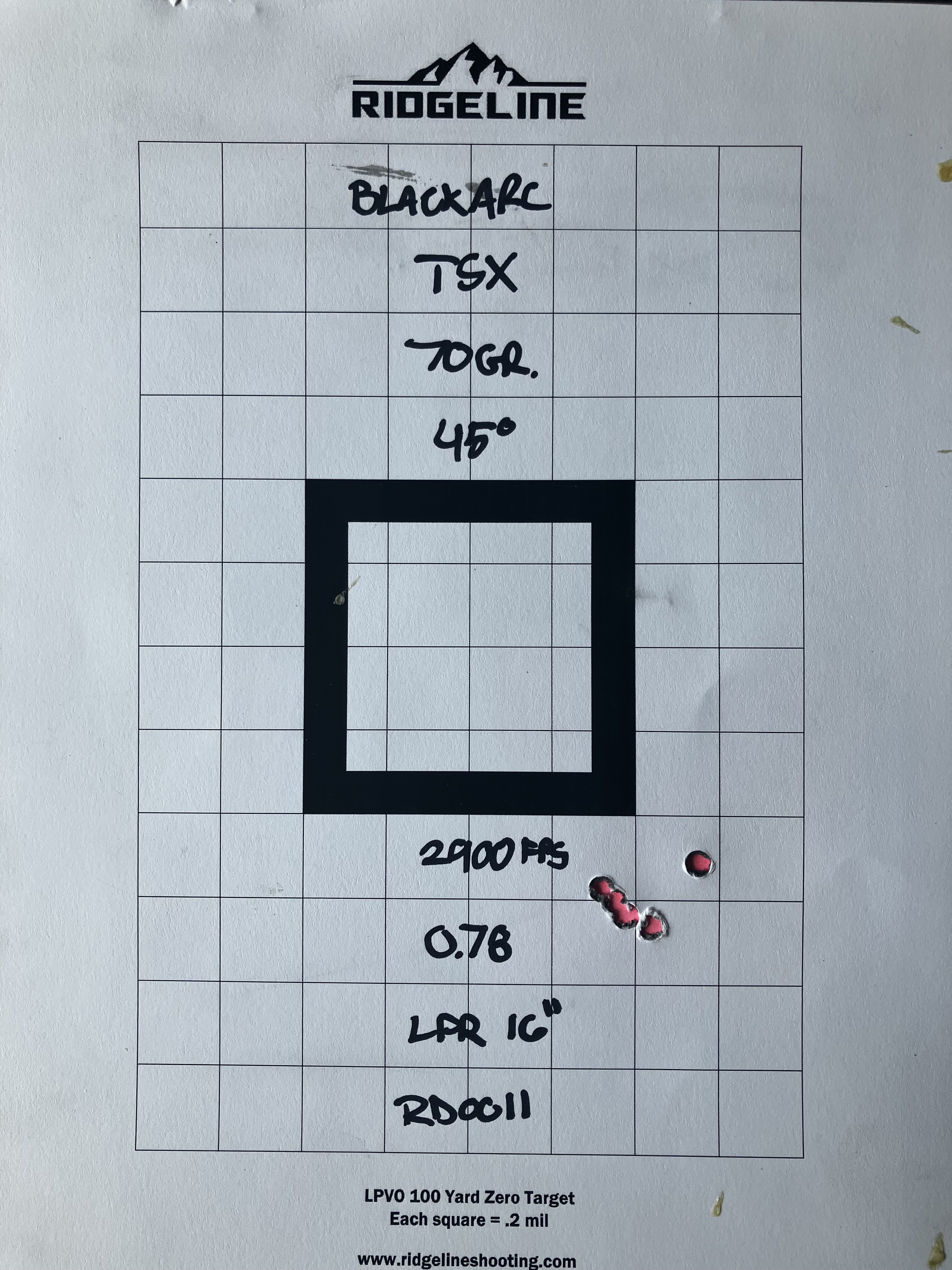

Been running the Black Arc Mk262 “A” periodically over the last year. It has been pretty darn consistent in performance.
The price point puts it above IMI or AAC but I think it’s worth it to have FGMM accuracy and +350 FPS.
Been running the Black Arc Mk262 “A” periodically over the last year. It has been pretty darn consistent in performance. View attachment 8692661

The 70gr. TSX is great too, though it had the biggest POI shift out of anything I have run in the LPR besides M855A1.
Next stop is the 80.5 Full Bores. Larry has run the 80.5’s at a mile last year with impressive results. I want to say he was getting 2700-2750ish out of the 16” LPR.
I wish I had the time to mess around with hand loads, honestly I am not sure if I could really do better than what John is doing. I have maybe 150 casings and contemplating getting some dies but for now factory ammo is more cost effective.
