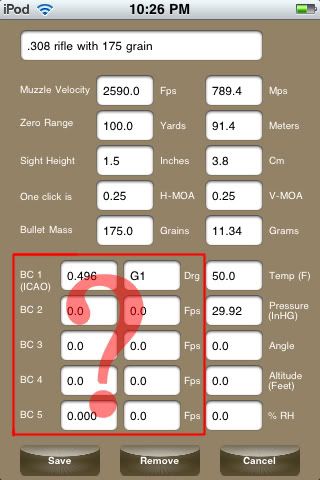

Hey guys, I need to make a new profile on Bullet Flight for the Southwest 175 grain Sierra Matchking .308, but I'm not sure what the ballistic coefficient or velocity is.
Can you guys help me out?
Thanks,
Coby

Okay thanks guys. I don't have access to a chronograph at the moment, but that estimate from Mike at SW should be alright for now.
So I put the velocity as 2590fps and in the first BC spot I put .496, but is that all I need to do? Do I need to change the G1 to G7?

Good catch by Mavrick.
175gr SMK has an average G1 of .475, and a G7 of .243.
For your program, you'll get more accurate modeling from the G7.

Clamber,
Go into utilities, go to bullet libary, find the sierra section, scroll down to 175 and hight light the 175 smk with BL G-7 than import that to your new weapon profile. I did this from memory but you should be able to figure it out

Oh wow thanks. I didnt know it had the 'projectile database".
