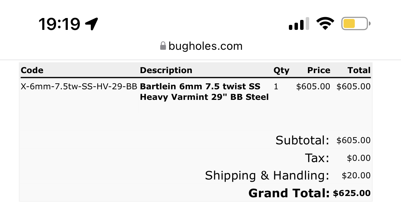

Time to replace my 6BRA barrel.... with another 6BRA barrel. Excited to see how many bullets I can get down it before it's toast!

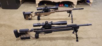

22" Cadex in the rear is standard Bartlein 1/8 6.5 CM.
KRG/Tikka is an 18" Mod400b. Both brand new. I'll report back over time. Definitely curious how either compares.
