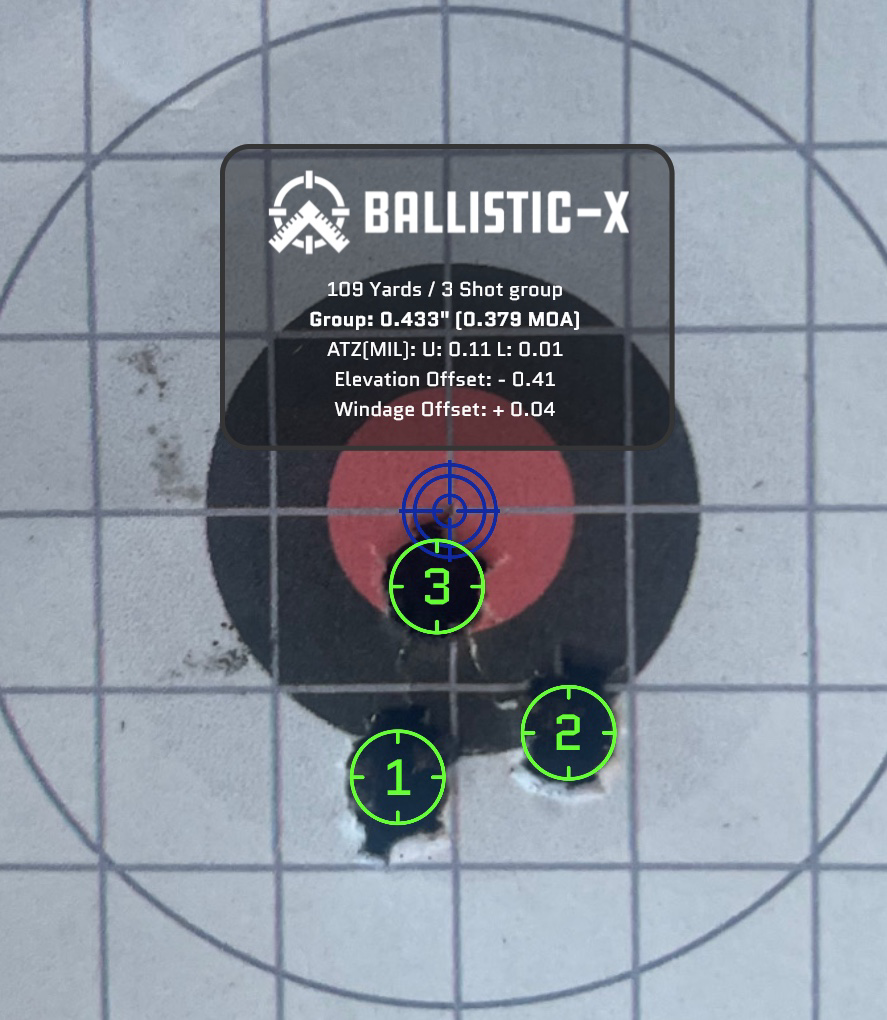

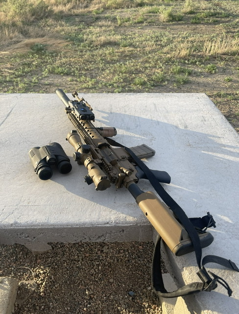

Alright folks. I decided I liked this gun and would put it on a diet and fix its issues all in one.
Enter a Craddock SPR barrel. The demons of golgatham were exorcised with a simple prayer to our shooting lord Bart-lein.

So, at this point what makes this gun a MK MOD SPR? It's got a PRI handguard? I know you said you didn't really care about that. So why buy this gun and rebuild it? Why not just build a 18 or 20" AR in the first place?
I like the look...and I already have 13 other long range AR's. :). All of them modern Gucci shit like LMT's and Radian M1's, night forces and vortex 1-10's and such on them. The current set of guns is the cream of around 150 AR15's that came and went. The only one I regret selling is the JP LRP-07.
Wanted one of these since they came out, and having one that doesn't shoot for shit doesn't appeal to me. Even if I have to diverge a little from the spec.
