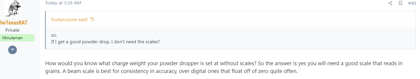

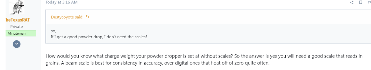

Yes, you WILL need a scale. An inexpensive beam scale works fine but is slow. The gold standard here on SH is the A&D FX-120i, which can also drive an auto-trickler. Lower-tier automation can be achieved through RCBS Chargemaster or similar but you still need a scale.

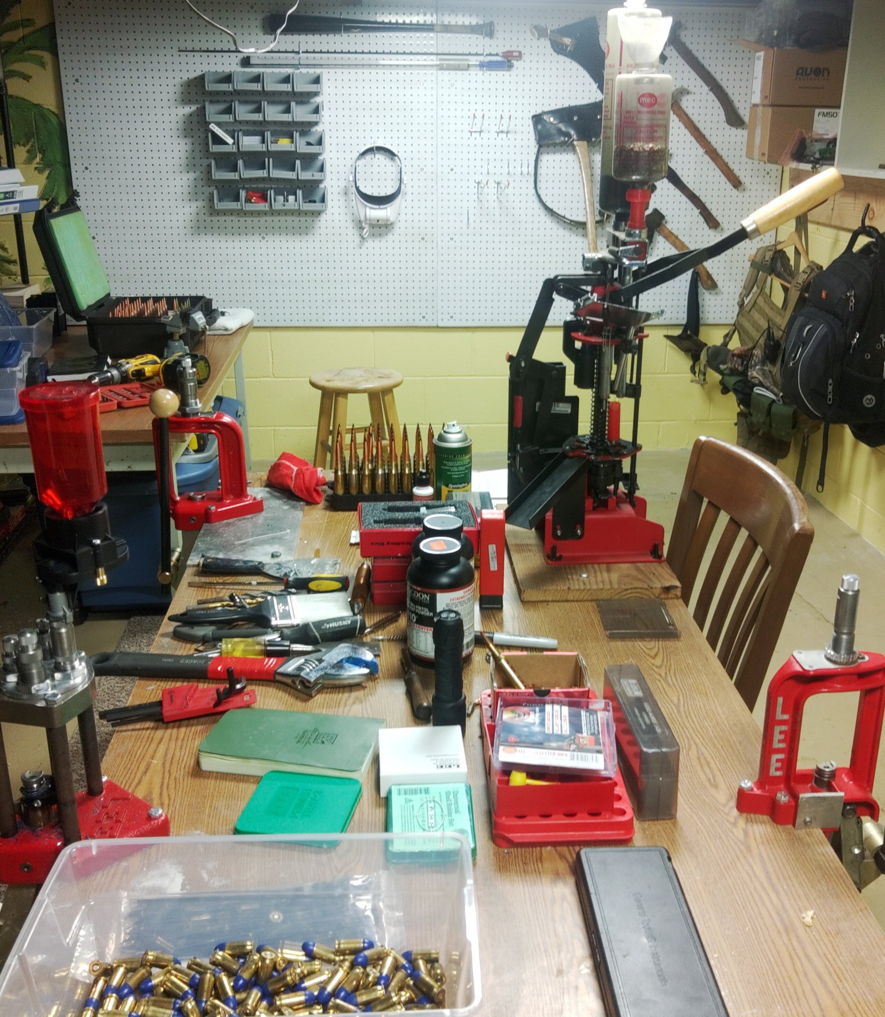

First thing. I don't own a turret press but am not knocking them. I have a purchased in the 90's 550b (actually my 2nd) and same timeframe RCBS Rockchucker single stage. The RCBS has a priming system but it didn't work well for me. I used the Lee hand priming tool for years.
Everybody has their own system for how they load. For rifle, I do mostly single stage although I'll do .223 blaster on the Dillon. I haven't yet used it for, but can do precision .223. If I'm doing rifle and working with fired cases, I just deprime with a Lee decapper die in a hand press watching the boob tube. I'll then tumble the brass to clean it. I'll lube it all and resize it, and clean again. I check for trim length later. Annealing is in there too but you don't want to go down that path yet, lol.
I have the Primal Rights CPS and I can sit wherever and prime all the cases. I could've just bought the appropriate shellplate and used my Dillon but I'm too lazy for that, lol. I'll chamfer at this point too.
When it's time to charge them I put my seater die in the RCBS. I drop powder with the Autotrickler, pour into a case, seat the bullet. That's pretty much standard for whatever press you're going to use, some series of the above. I can't say this to be an absolute but the only personal experience I've had where someone loaded themselves a squib was because they dropped all their charges into cases in one step, and missed one. It might work for many but not for me.
But you can do all on the Dillon or combinations of the above.
Pistol on the Dillon is put a case on station one, no lube carbide die to resize and prime, turn shellplate, put on a new case, 1st case at station two now gets powder and case mouth belled. Turn shellplate, 1st case at station 3 now gets a bullet, case at station 2 is charged, case at station 1 is resized and resized. Turn shellplate again and finally at station 4 the 1st case gets crimped and you have a loaded pistol round.
With a turret it seems like you'll have to rotate through everything for one case at a time. Or do one step for 20, 50, 100 cases at a time. Again, I'm not familiar with the Lee you're looking at but I recall older comments where brands that produced progressives other than Dillon didn't work that well. They kind of set the standard years ago. Whatever you get make sure you go slow and check that each case is charged with powder when you start.

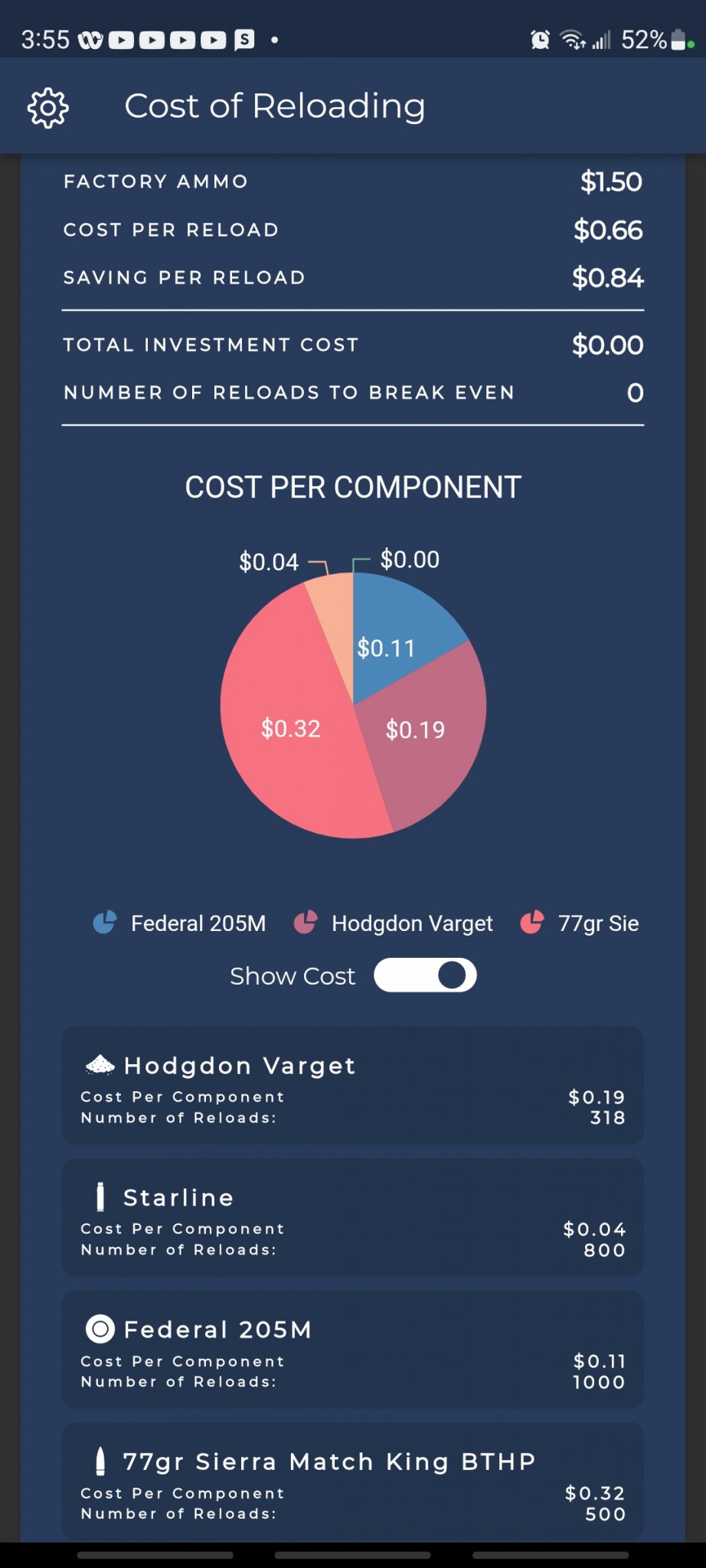

For pistol, with current primer costs the savings on 9mm are thin, if not breakeven, over buying. Primers run ~0.09 and bullets ~0.08, powder ~0.03 per shot. That assumes you already have brass. I was able to pickup 9mm for 0.22 a round at the store, though it was a Black Friday deal. Now for precision rifle, I can reload for about 50% savings per round with current prices.
For the round I shoot in .223

so,
If I get a good powder drop, I don't need the scales?
How would you know what charge weight your powder dropper is set at without scales? So the answer is yes you will need a good scale that reads in grains. A beam scale is best for consistency in accuracy, over digital ones that float off of zero quite often.

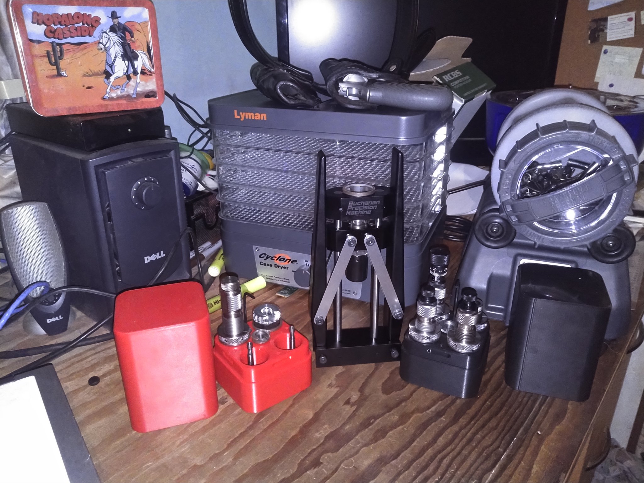

Personally, I use a portable single stage press (Buchanan Precision Machine) with the Hornady LNL Quick Change Die Bushings (to help save time), and Redding Competition Dies for best concentricity [see pic 2]. I run the cases through each step in batches of 50 to 100. And when charging the cases I visually inspect the batch for consistency before seating bullets. Better to catch any problems before seating the bullets as opposed to having to pull them apart latter, or even worse figuring out the mistake after the gun blows up! Yes it is better to be a turtle than a hair when it comes to the irreputable harm that goes with missing details while reloading.
Saving money goes out the window once one gets bitten by the reloading bug! It infects one to want to buy more equipment and bullets and guns.
Happy reloading comes with quality tools and components. Cheap tools and cheap components only lead to frustration! Ask me how I know? Answer - Other than having read through all the manuals and having watched every YouTube video on reloading over the years - I started with three Lee Classic Reloaders and a rubber mallet for one.

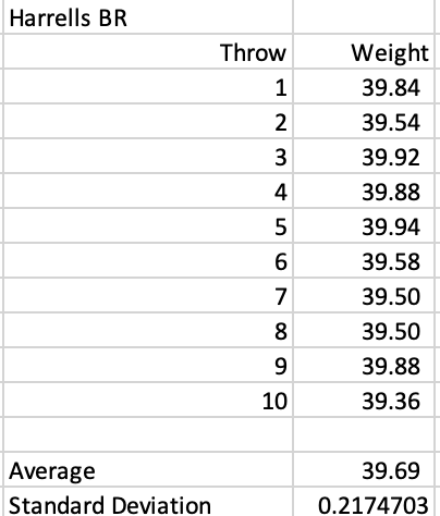

I didn't see this a while back, but yeah, you definitely need a scale. I bought a used Harrells BR off the EE out of curiosity & tested it w/ H4350 (which is notorious for throwing poorly). Interestingly, the distribution looks bimodal. 0.2gr SD is... bad. I'll note that I made an attempt to throw exactly the same each time. I need to retest w/ CFE223 & test my Lee Perfect Powder Measure Deluxe w/ H4350.
See attached photo
