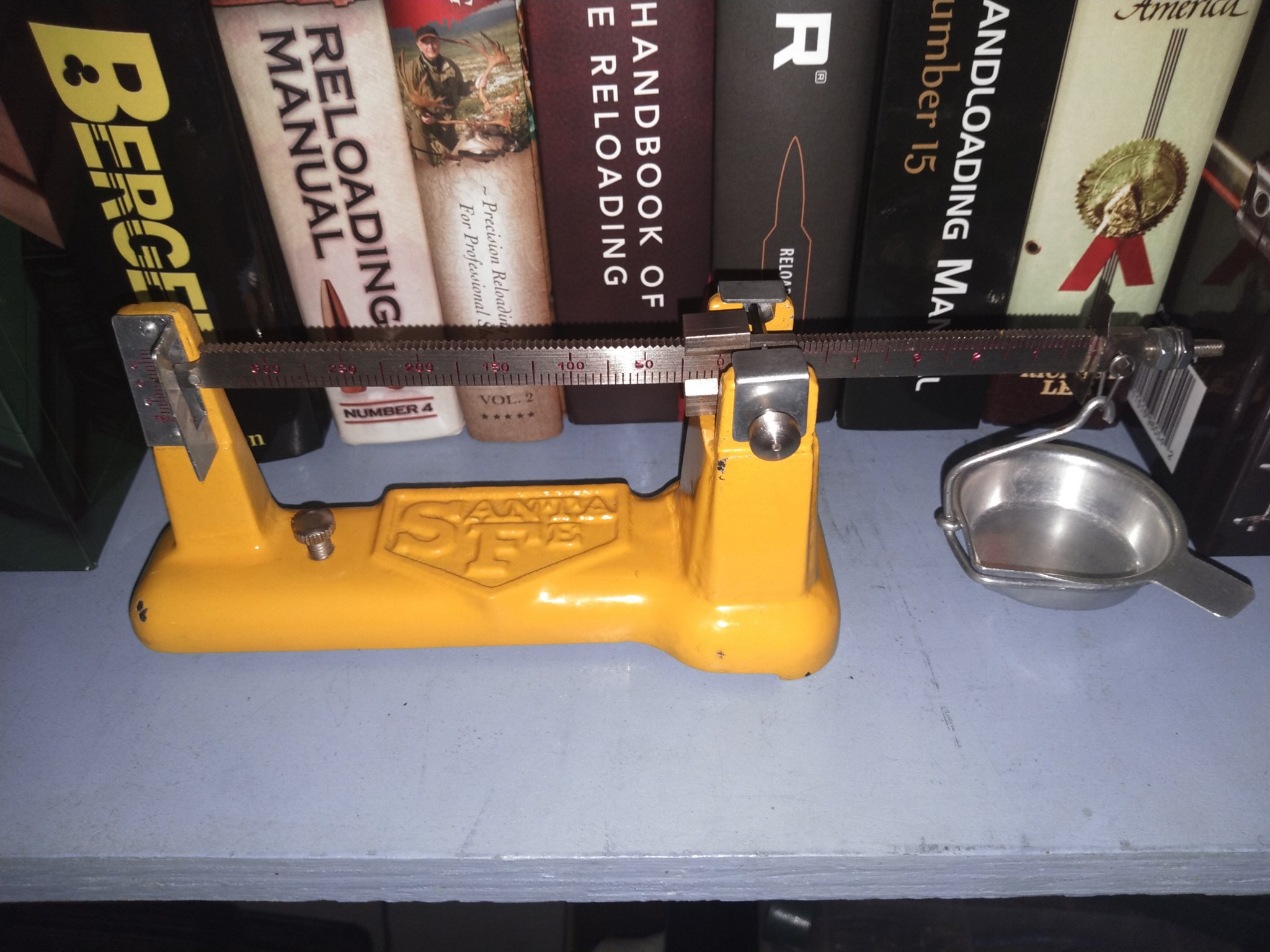

See pic for blast from the past:

Cool looking beam scales
