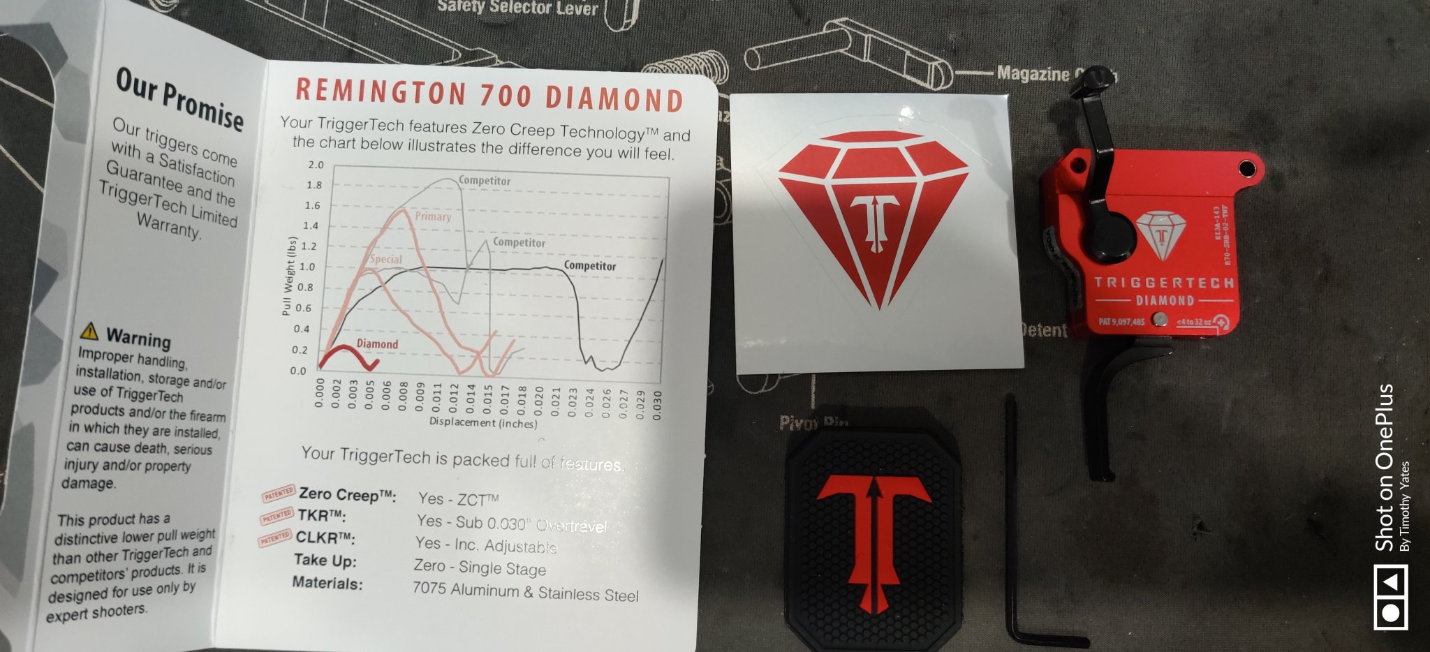

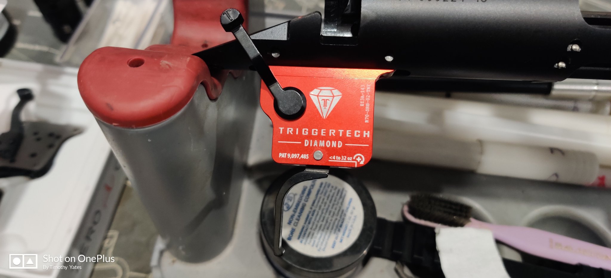

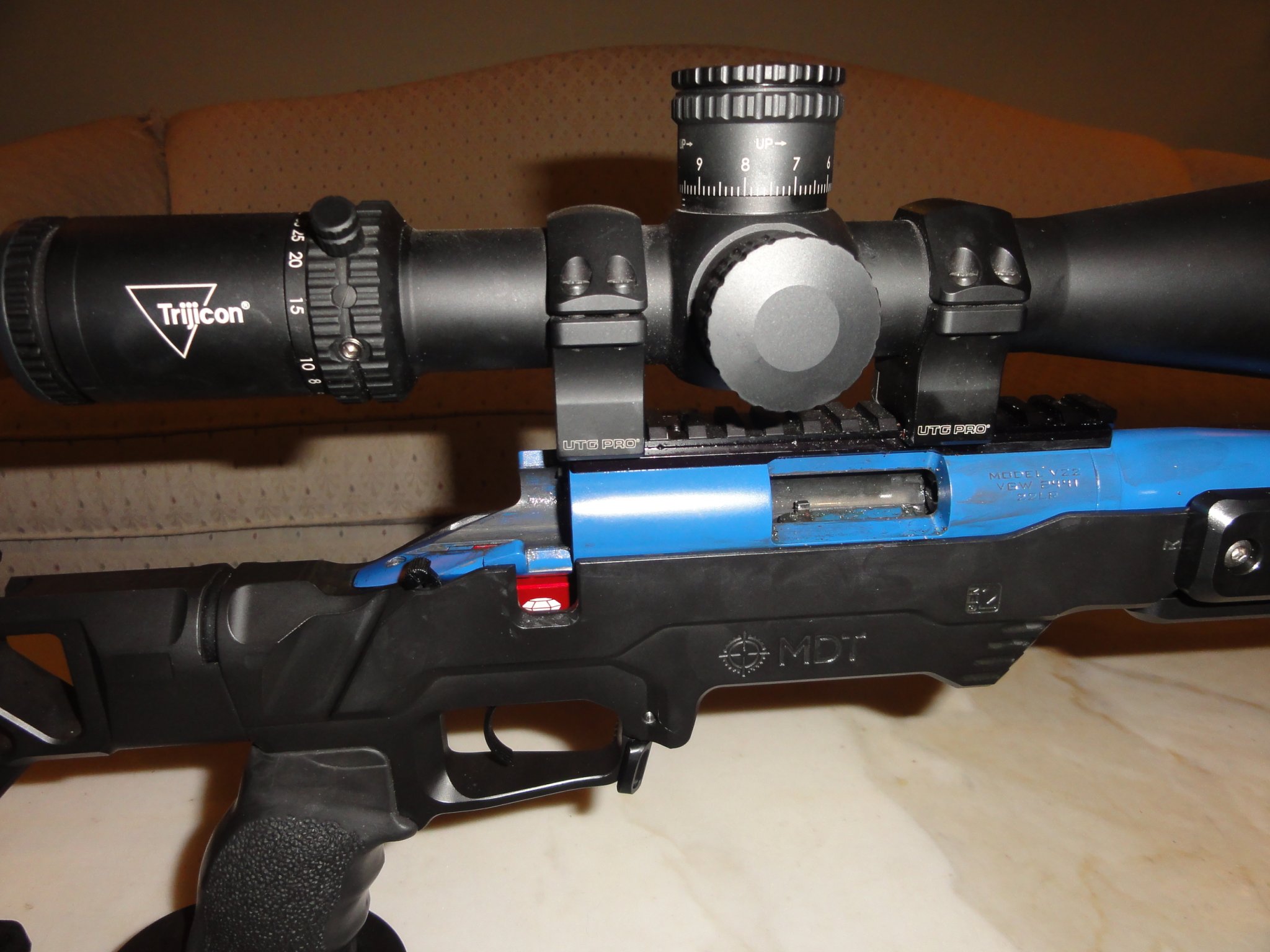

I took a few photos showing the TT trigger but will only show a couple since I'm not happy with it and it probably isn't going to work out for me.
Well, just got done with Midway USA; got a return label and the TT will be going back for a refund. I was pretty excited to have a 4-6oz trigger but not with this one. Remember, I am not knocking TriggerTech, just saying this trigger isn't working with my rifle and it cause a lot of issues with these groups. Groups, I'm sure would have been even better with a consistent pull and solid primer strikes.

Multiple issues with the trigger light strikes, firing on closing the bolt, trigger pulls ranging from a few oz to 13 oz.

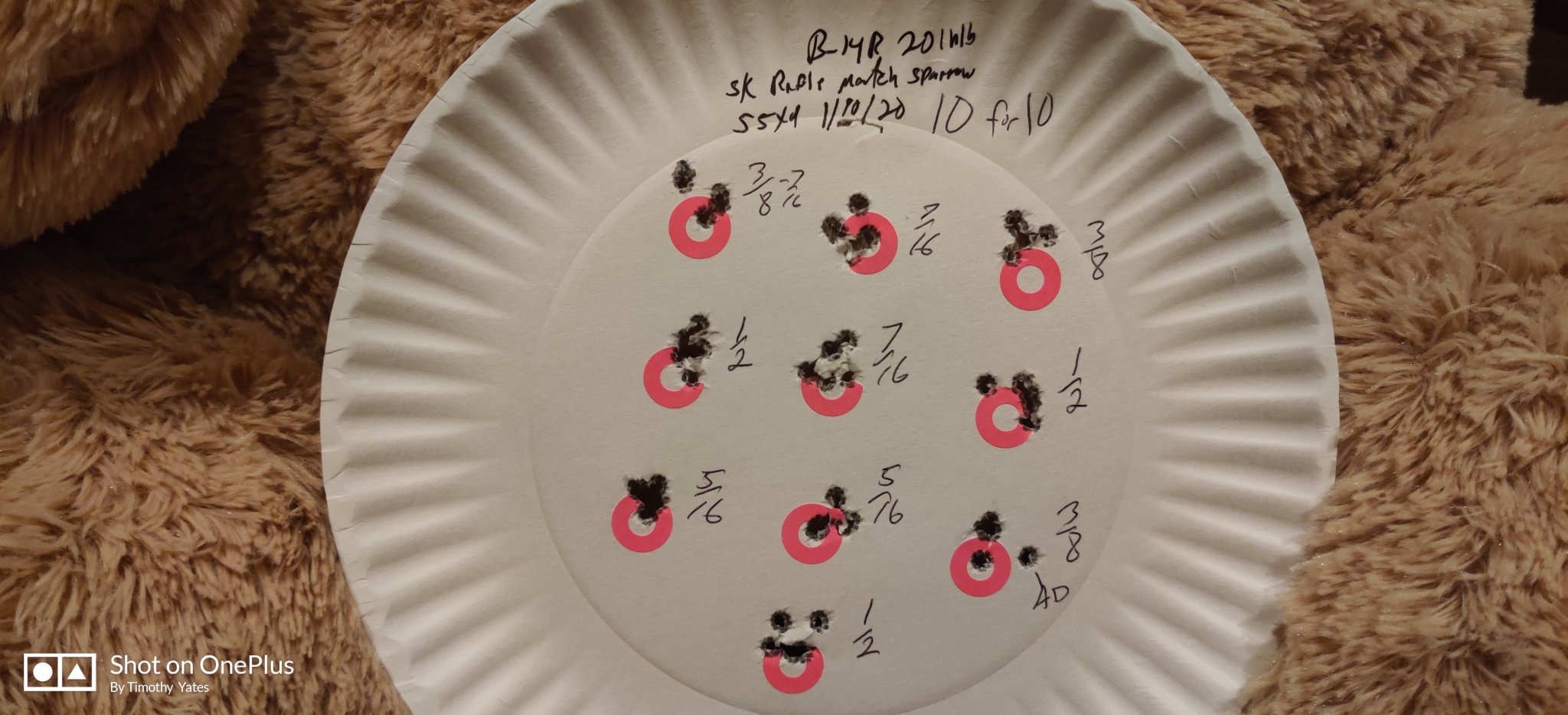

Targets displayed are from what I think are best to worst "subjective, I know". A 10 for 10 is very rare for me but I did get one with the SK Rifle Match. BTW, for those that don't know, a 10 for 10 for me means all ten 5-shot groups on that plate were 1/2" or less. Trust me, it's hard to put "for me" 50 shots together without a single "anything" screwing it up.
SK Rifle Match, may end up buying a case of this lot number if possible.

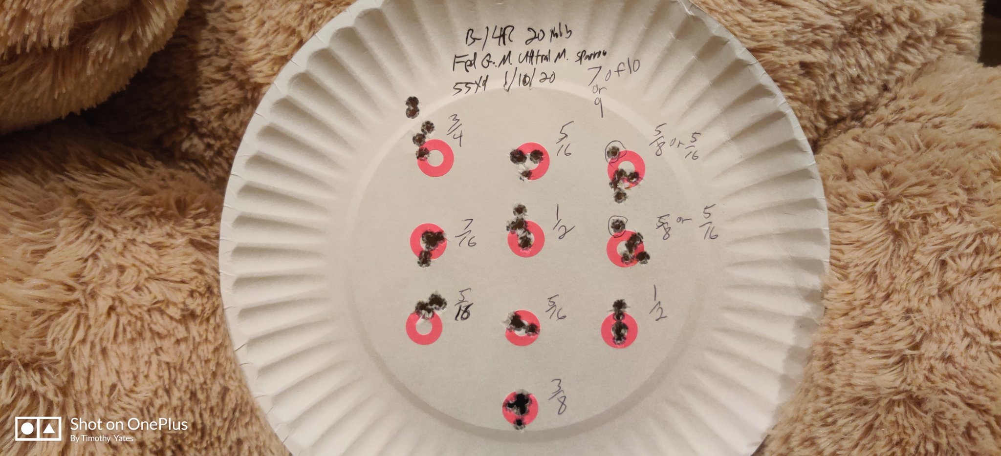

Federal GM Ultra Match. This is probably as accurate as the SK Rifle Match but did have a few "not so good" groups. These could have been caused by the trigger, I don't specifically remember so I didn't make a note.

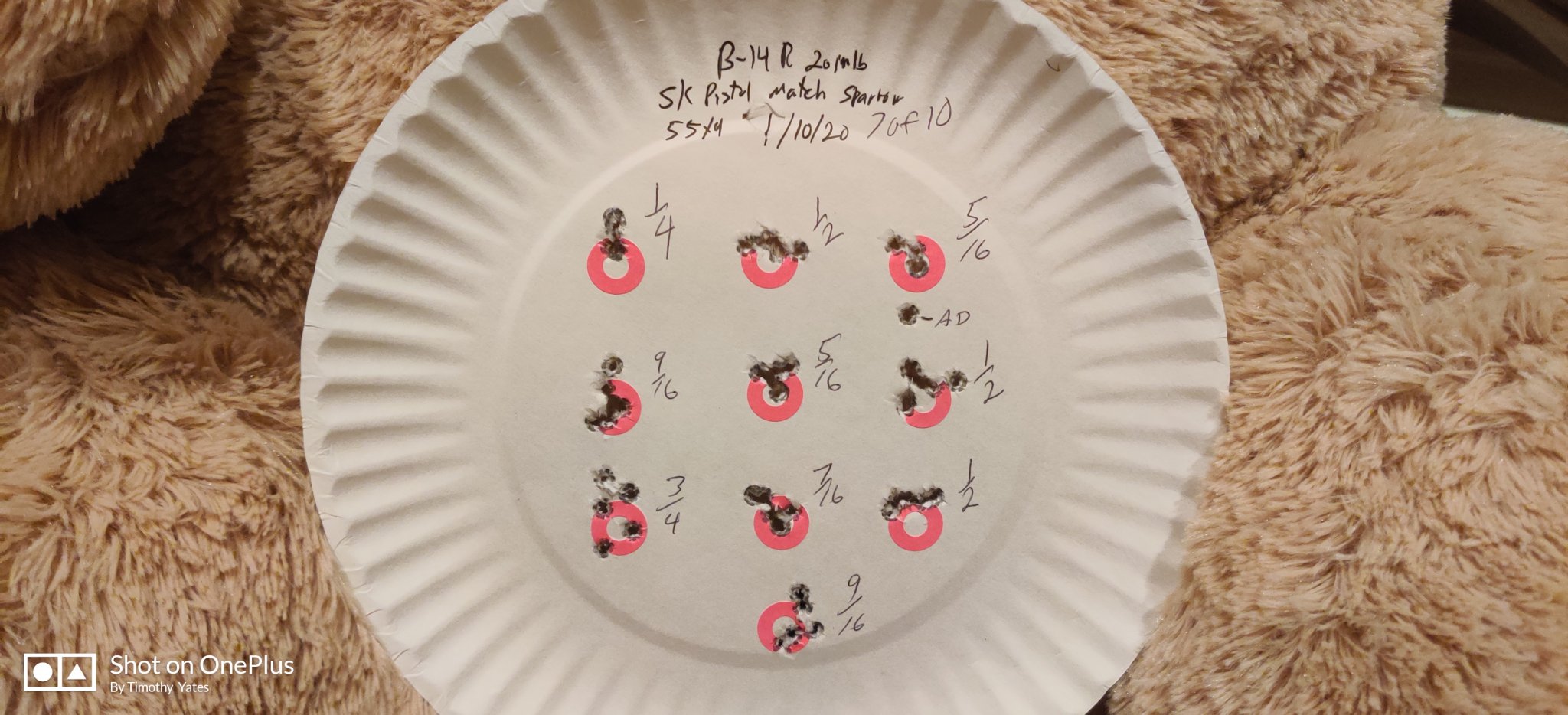

SK Pistol Match.

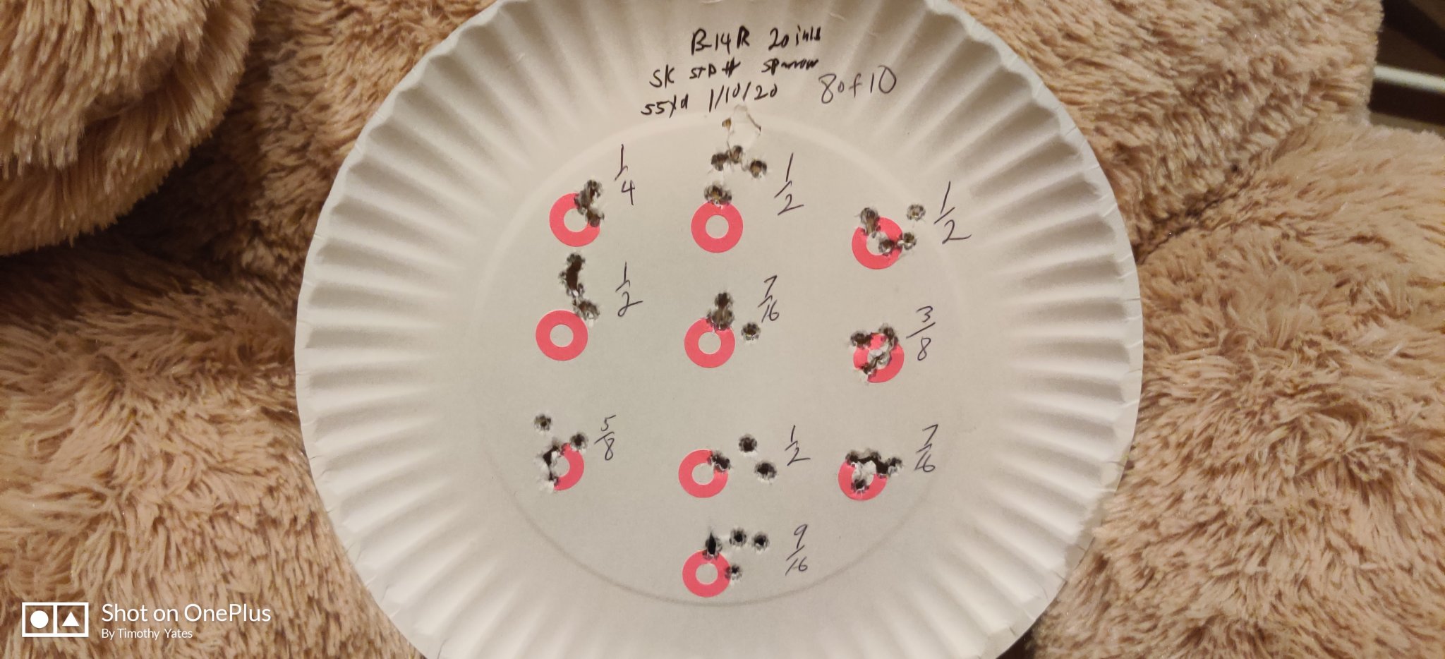

SK Standard Plus. Cheapest ammo I shot today. Not bad overall.

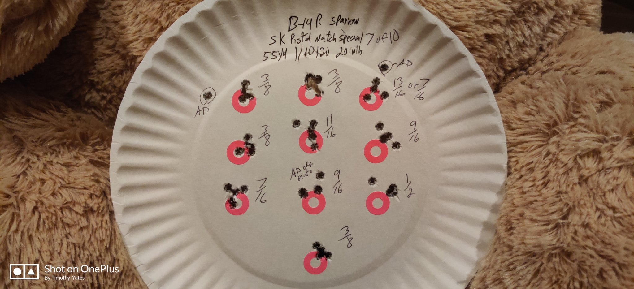

SK Pistol Match Special. Because of the tighter groups maybe this should be in front of the SK STD+. The AD was not the first shot.

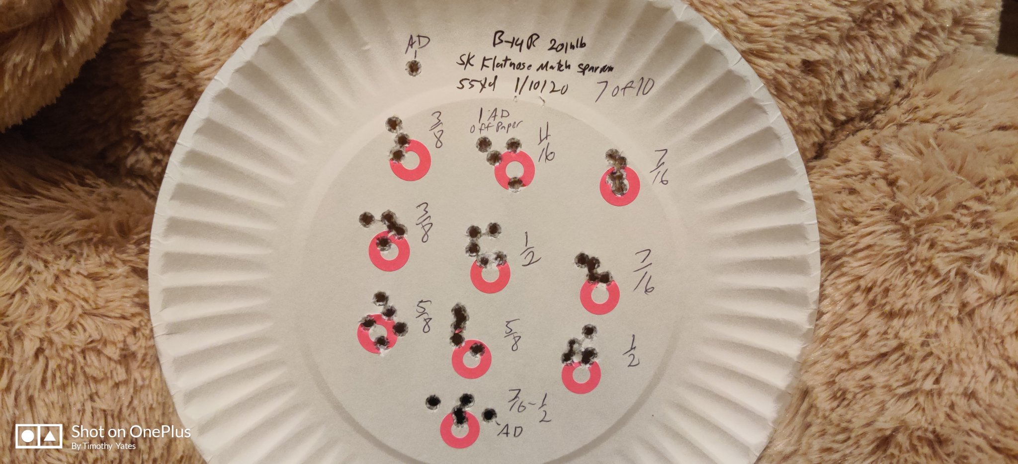

SK Flatnose Match. This bullet has its own unique bullet profile that is in between a round nose and EPS. The AD was not the first shot.

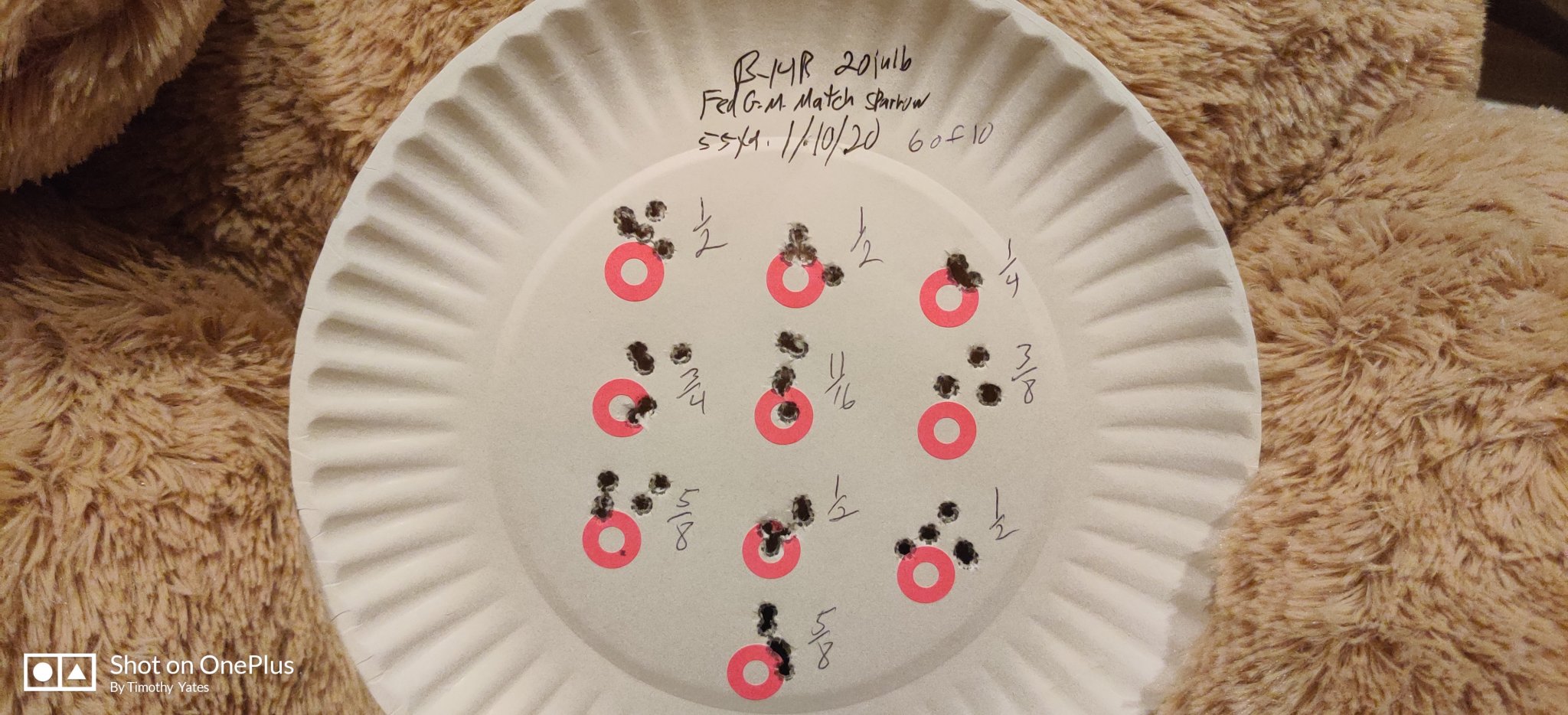

Last place belongs to Federal GM Match ammo.

Well, just bought the Elftmann Tactical 700 SE. As a bonus it's almost $50 cheaper than the TT Diamond and is advertised to adjust down to 2 oz. Hmm, yeah I'll believe that when I'm shooting it.
Another reason I went with Elftmann is the also have the straight trigger bow as well as the curved in the same package. Hopefully it won't disappoint.

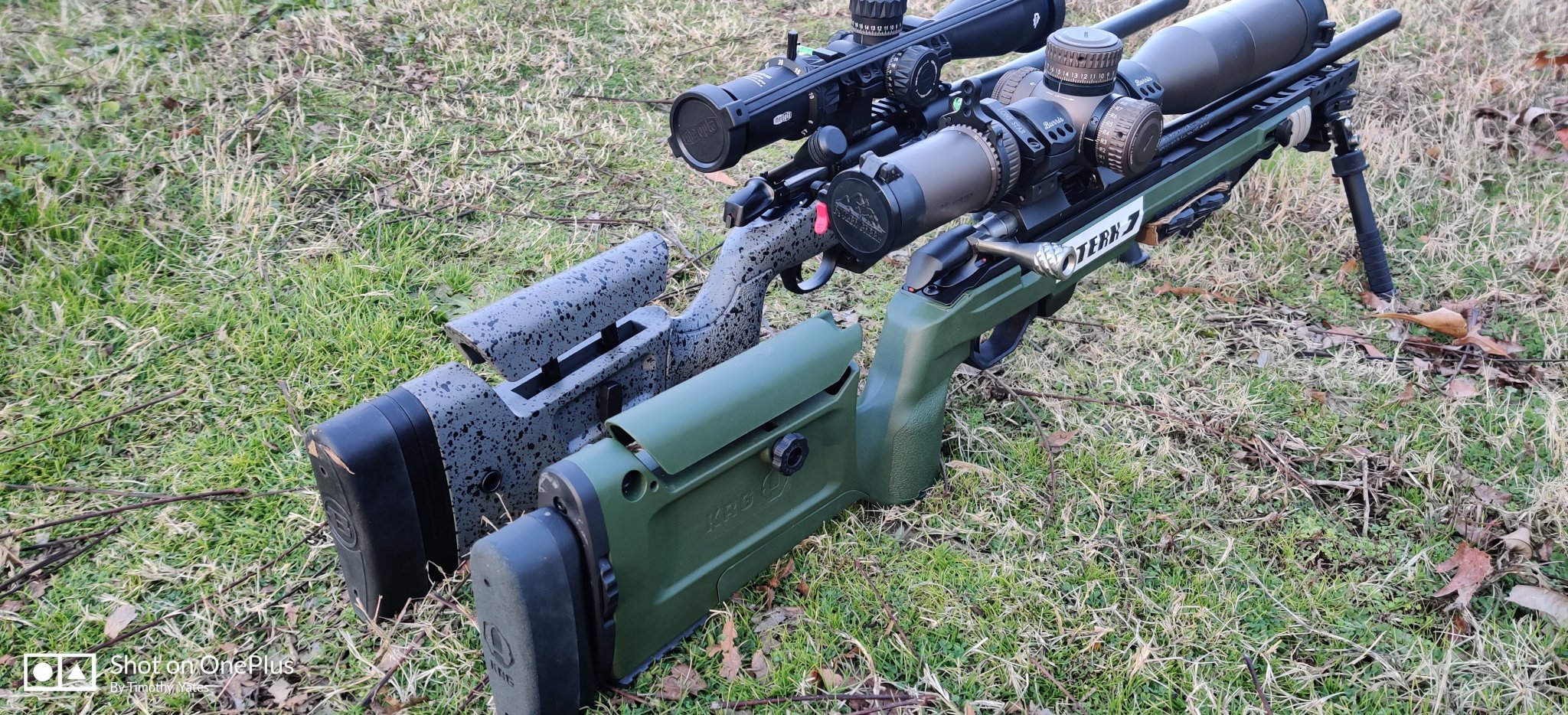

Curious as to your thoughts on the reticle subtention. Given the model you got is SFP, the subtension remains the same across the magnification range. I'm just curious in your opinion as to whether the reticle is too thick, too thin, or just right. And moreover, if you think that the reticle subtension might impede ringing all the accuracy potential out of the Bergara. Images of the Dichro 4D reticle just don't seem to do it justice.
In about 4 days my XLR new to me chassis will be here! So tomorrow weather permitting I will be out with tractor and chainsaw working on extending my range.
I am currently at 156 yards but hope to push to 250.
When I get some extra cash I’ll buy some different match ammo and see what works at 200 plus.
Reactions: Kisssofdeath
I don't consider 4D Dichro reticle having subtensions. Unless you are referring to the distance between the center dot and the beginning of the red on the crosshairs. This is what I have and how you see it is how it really works "color wise".

When I first looked through mine I was worried the reticle would be too small especially the center dot After adjusting the eyepiece to make the center dot clear it also enlarged it and the crosshairs really nice for me. For me the entire scope is perfect for what I do and the reticle is perfect for my use. I have some FFP scopes and at lower magnifications they are worthless for ranging because the subtensions are too small. When you crank up the power to see the reticle you are on a magnification that would be correct for ranging with a SFP scope. For example I have an older Bushnell 5x-30x SFP but has the range indicator identified at 10x. If I had this same scope but in FFP I would still have to put the magnification on at least 10x to make the reticle big enough to use the subtensions for ranging. To me with FFP scope I lose the ability of the reticle at lower magnification and really gain nothing on higher magnification.
Thanks KOD. I guess a better way to ask and clarify my questions would be: when you are shooting, say at the 50yd targets you've posted pics of, does the center dot on the 4D Dichro cover the target dot (1" ?) you're aiming at or is there a protion of the target visible?
Ahh, yeah that makes more sense to me. The dot on the 4D Dichro will cover maybe 1/8" at 55 yards. The center of my bullseye rings are 1/4", I can see white around the dot when the dot is centered in that 1/4" hole.

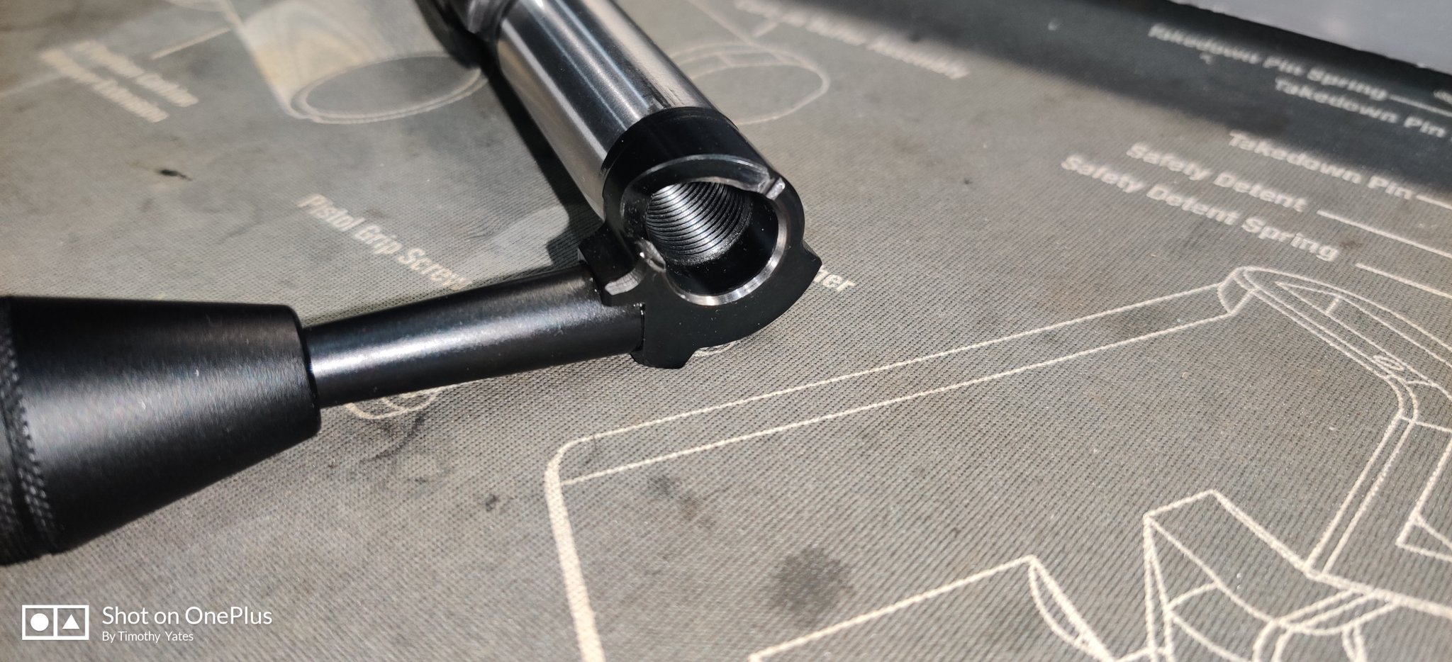

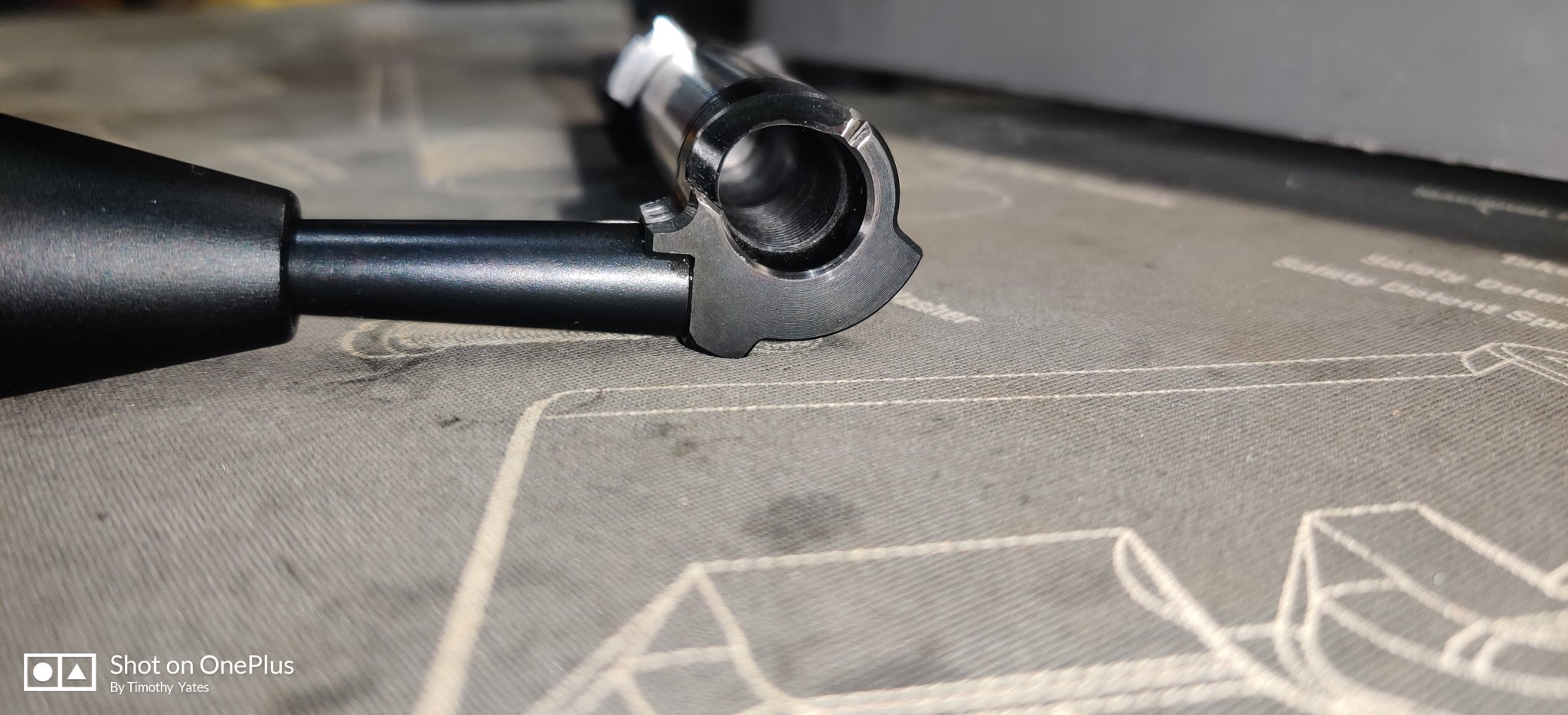

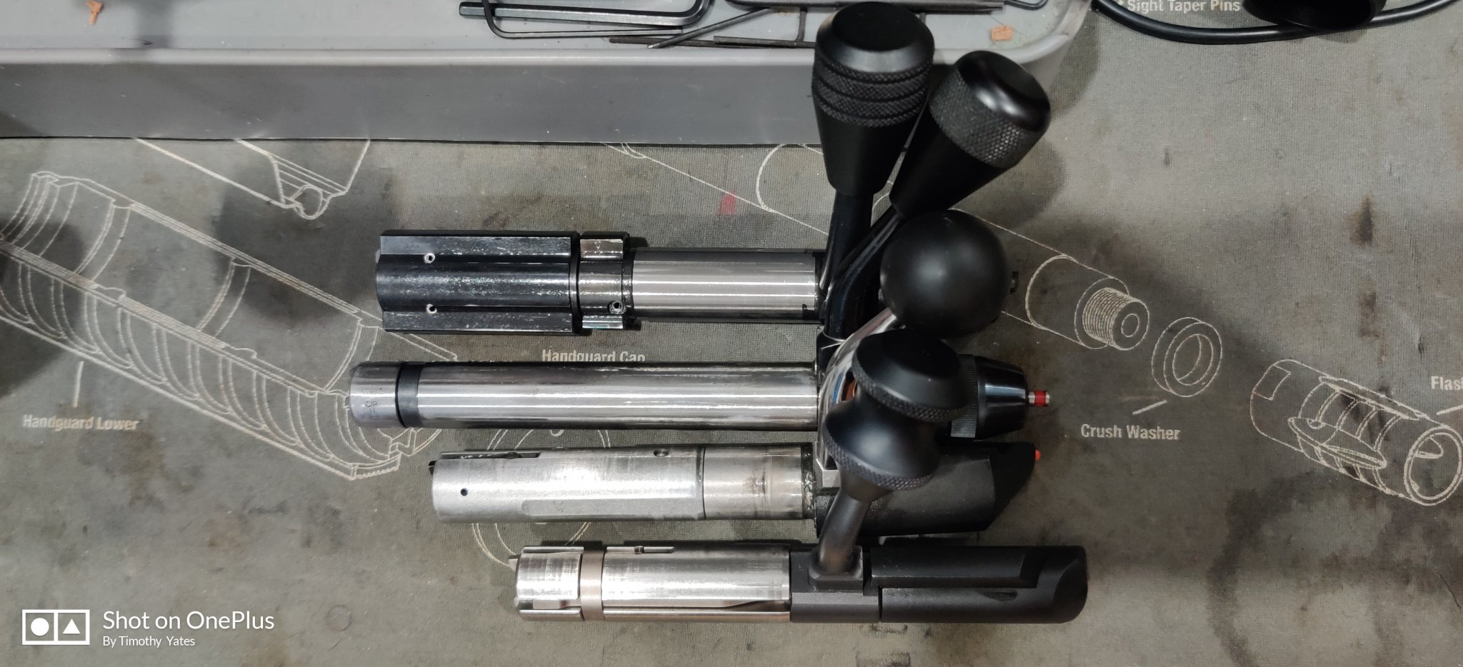

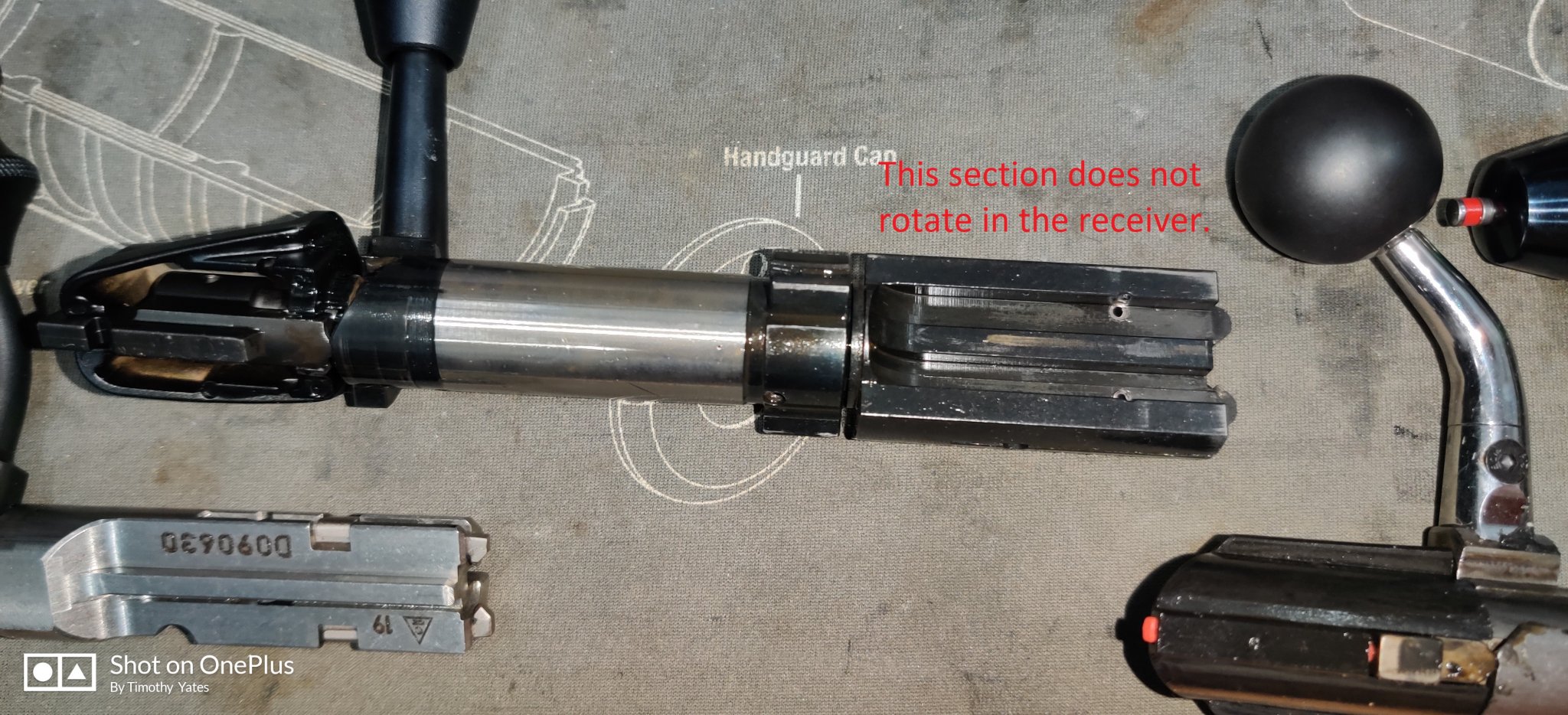

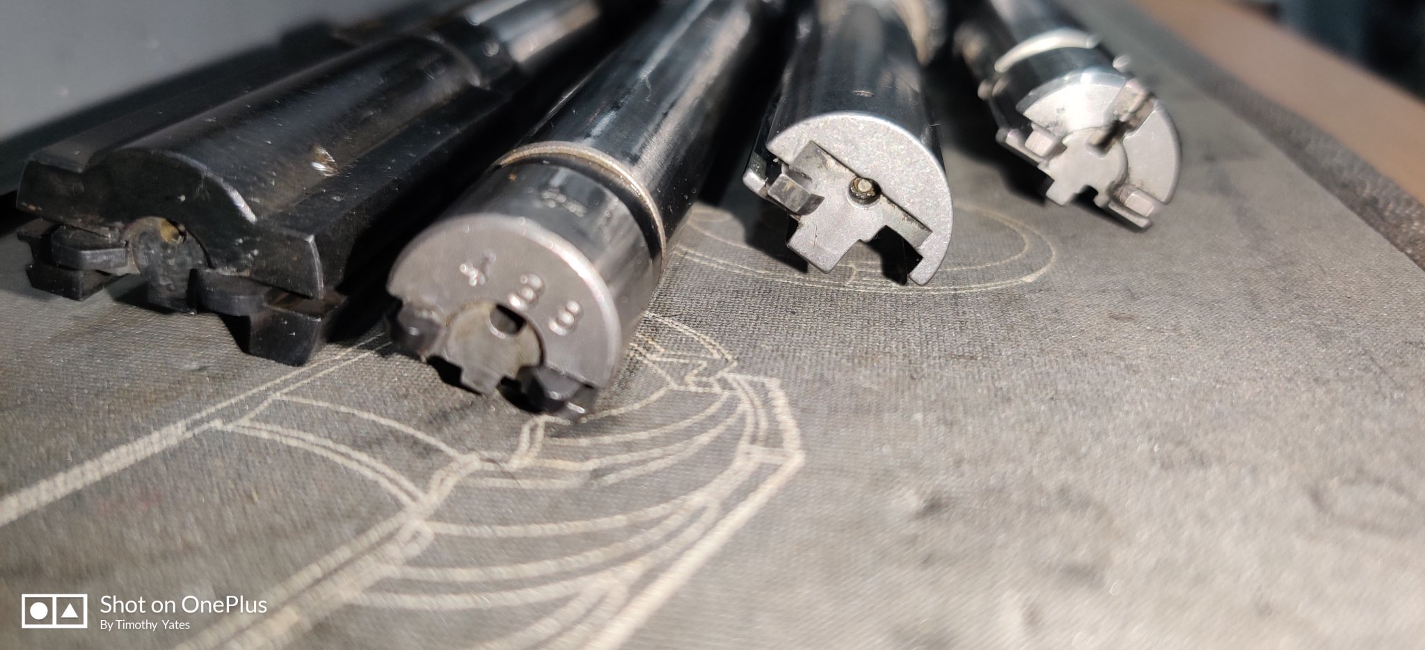

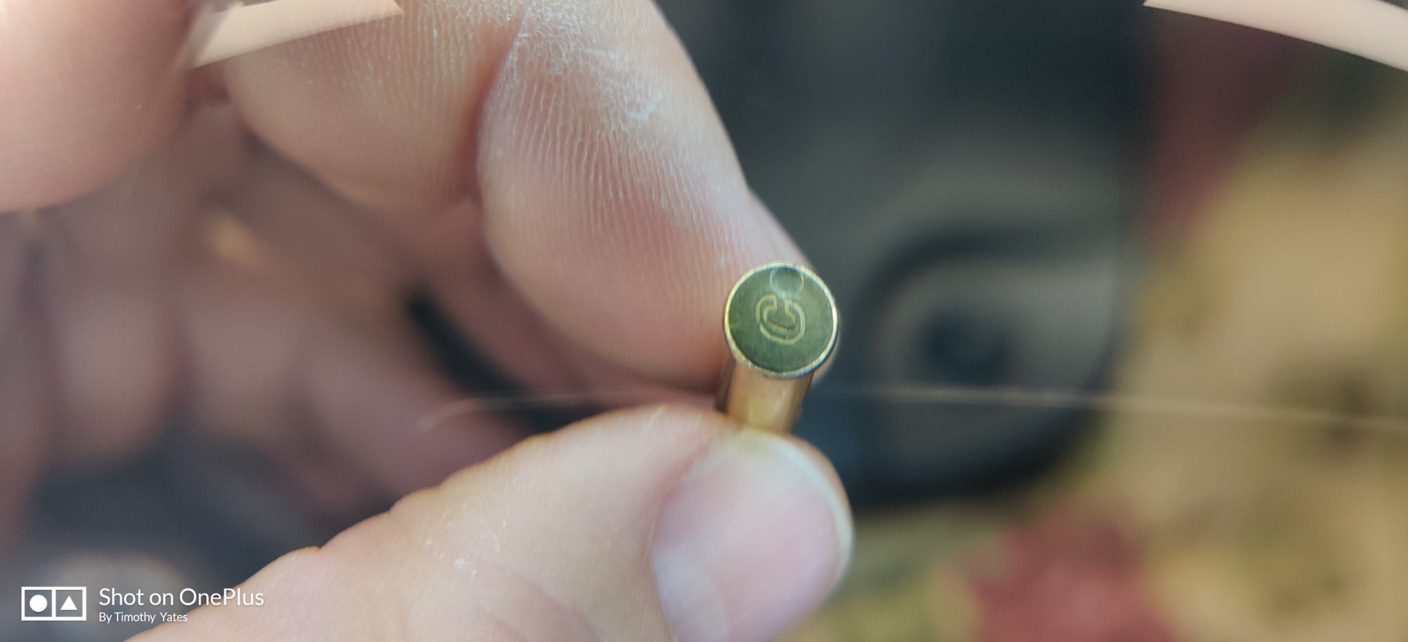

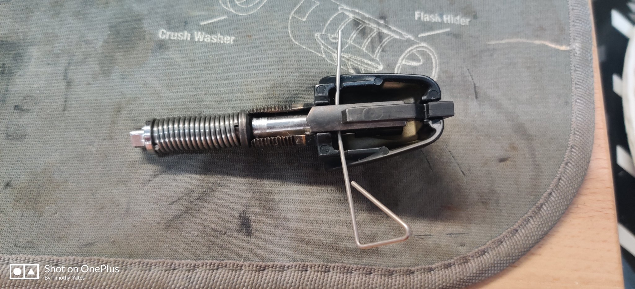

To continue on with the construction of the B-14R here are a few photos of the bolt disassembly. Super easy to take apart. After removing the bolt from the receiver you stick something through the hole as shown. This will keep the bolt spring compressed; you can then simply unscrew the rear section. The firing pin along with it's spring are still captured in the front section. I would have removed the front section but I don't have the right size or type of roll pin to put back and I thought reusing this one might weaken it causing it to start moving. For cleaning purposes this is all one would need to do in the disassembly process. I have taken apart a lot of different designed bolts and this is by far the quickest and easiest way to disassemble and reassemble a bolt. It's equivalent to taking a Ruger Mark IV apart vs. the other generations if that gives you an idea. Just look at the quality machining, no plastic anywhere, the bolt shroud might be a cast part but the rest looks machined to me. For people who ask, "why does this rifle cost around $950", well, things like this is why. I'm liking this rifle more and more.
I hope these photos are beneficial to the readers. My main goal is to educate, help and serve the rimfire community as a whole. When I say "educate" that doesn't mean I'm smarter, what it means is I want to give exposure of different equipment to people that may otherwise never know, that's education in the simplest form.
I'm confused and can't tell for sure by looking at the pics, but does this gun have a SEPARATE firing pin from the striker assembly??
The striker ass'y looks very short and I don't see a pointy firing pin sticking out the front....
EDIT: After re-reading your post, I see that the firing pin IS separate and is spring loaded in the front of the bolt. Not as bad as a separate falling hammer (like a 10/22) but much slower lock time (at least 2x as slow) than a true striker fired assembly.
I would hazard to guess that all the bolts pictured are all cocked. That said, the firing pin is retracted. Beyond that, my experience with RF firing pins is that they are not the same as a CF firing pin. Keep in mind that a RF firing pin needs to evenly strike across the rim of the cartridge to ignite the round, therfore they are often larger in dia at the point of impact if round, or a blade-type unit - ala 10/22 and others.

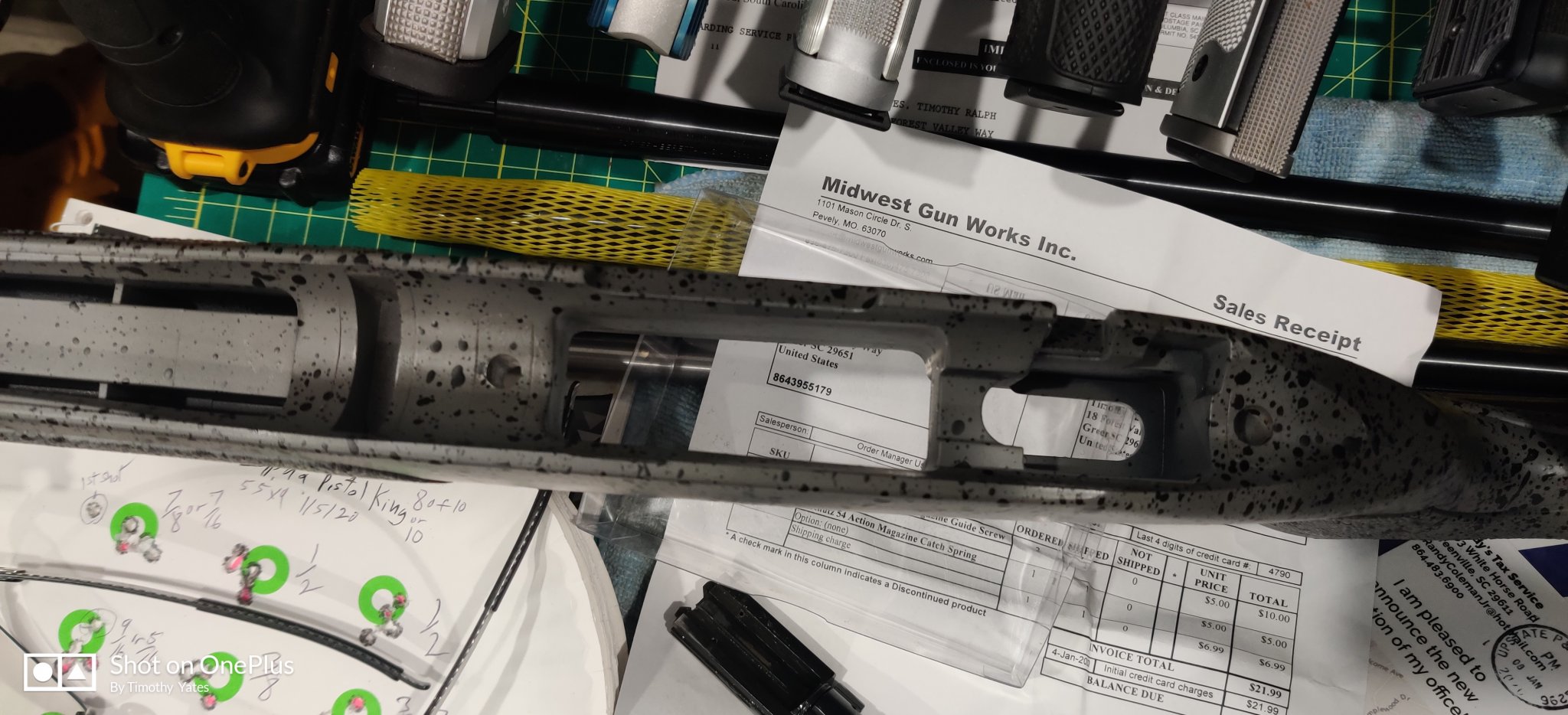

Got the Elftmann in today and it won't fit in the bottom metal. The bottom of the trigger body where the shoe comes out is .412" wide, the opening on the trigger guard is .384". The stock trigger body is .296" I will call Elftmann on Monday and see what they say about this.
The Elftmann appears to be a really nice trigger. There was zero take up, nice break and just a bit of overtravel. The bolt was easier to operate with the Elftmann over the TT Diamond. I did an extensive amount of dry firing and the lowest reliable setting I could get was 9.5 oz on an average of 10 pulls with my Lyman gauge. That's a far cry from the advertised 2 oz. After this and the TT Diamond I don't put any faith in advertised trigger pull weight any more.

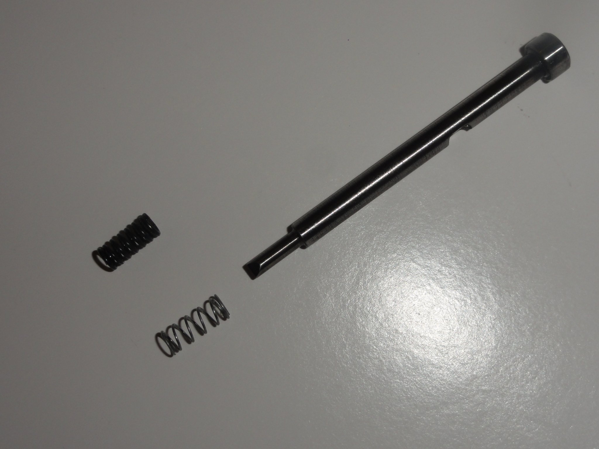

If I were to buy a B14R, I would see what spring rate my V-22 has in it and try and duplicate that into the Bergara.
Shawn,
The Bergara will require a much stronger striker spring with the spring loaded 2 piece FP arrangement.
It has to hit hard enough to overcome both the inertia of a stopped firing pin AND the spring holding it back.
Slows things way down and has to be compensated for with higher spring rates.
EDIT: You probably won't be able to modify the nose of the FP, as it will rotate (Not positive on this, but looking at the bolt face pic it looks round, not flat, like a Ruger).
Shawn,

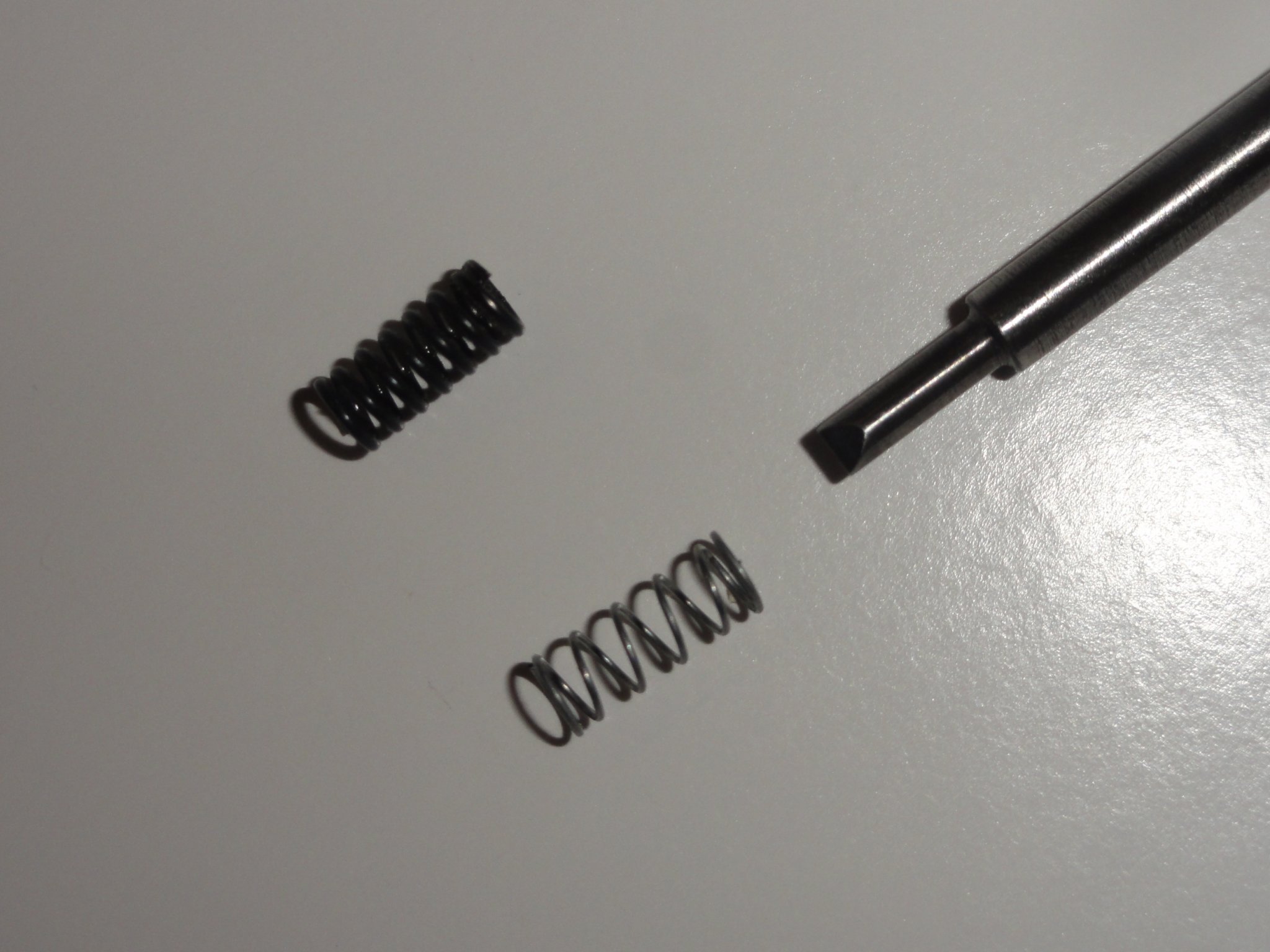

Hi Hellbender,
I would like to think that after 28 years in mechanical design I could overcome or at least minimize nearly any problem that I run across. ;-). My years in the shop as a welder and machinist help a bit too.
I do hear exactly what your saying. If you go up to entry #63 written by Kiss of Death, his last photo shows a rather large, round FP imprint created by his B14R.

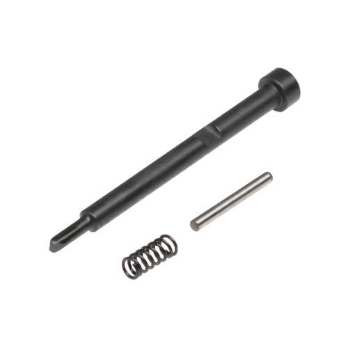

The first photo below shows a stock Kriss Defiance FP. They use a cross pin set in a groove to prevent rotation of their FP. In the next two photo's you can see the original heavy spring and the much finer .014" wire spring that I replaced it with.
View attachment 7225259View attachment 7225261View attachment 7225262View attachment 7225263View attachment 7225265View attachment 7225266View attachment 7225268View attachment 7225271

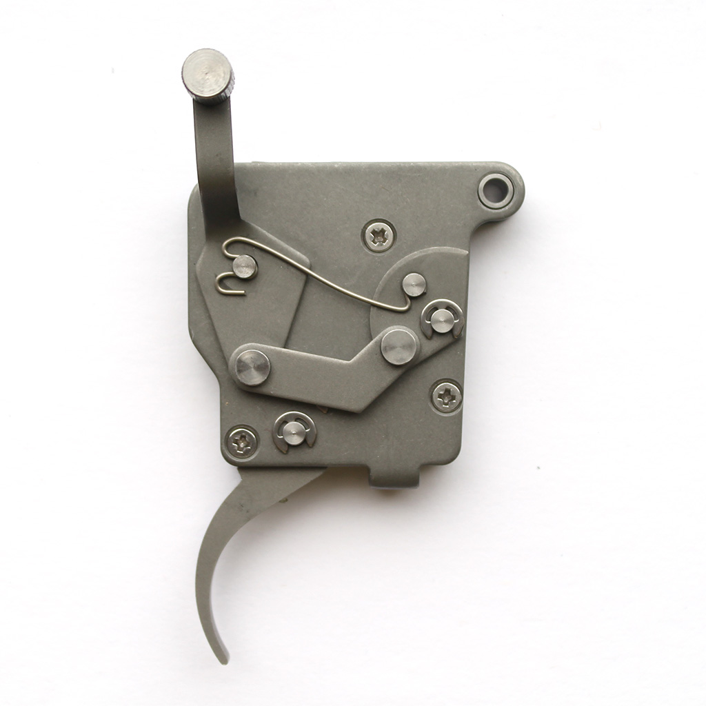

Hi KOD.... you showed me a Jewell trigger you were looking at and it had no safety on it. I just looked at a YouTube video of an NRL match. It looks like they need to safety their guns when transitioning from one position to another. Do you plan doing any formal matches?
Shawn
Shawn,
I know where you're coming from, I have a pretty complete shop (lathe, mill, etc, etc). I made a 40x into a repeater way back in 2009...before it was cool, LOL!
Just wanted you to know that it wouldn't be a simple spring change, most don't have your skills!
Shawn
You don't need to safety if you have your bolt open during transitions. You do need a safety in a semi auto.

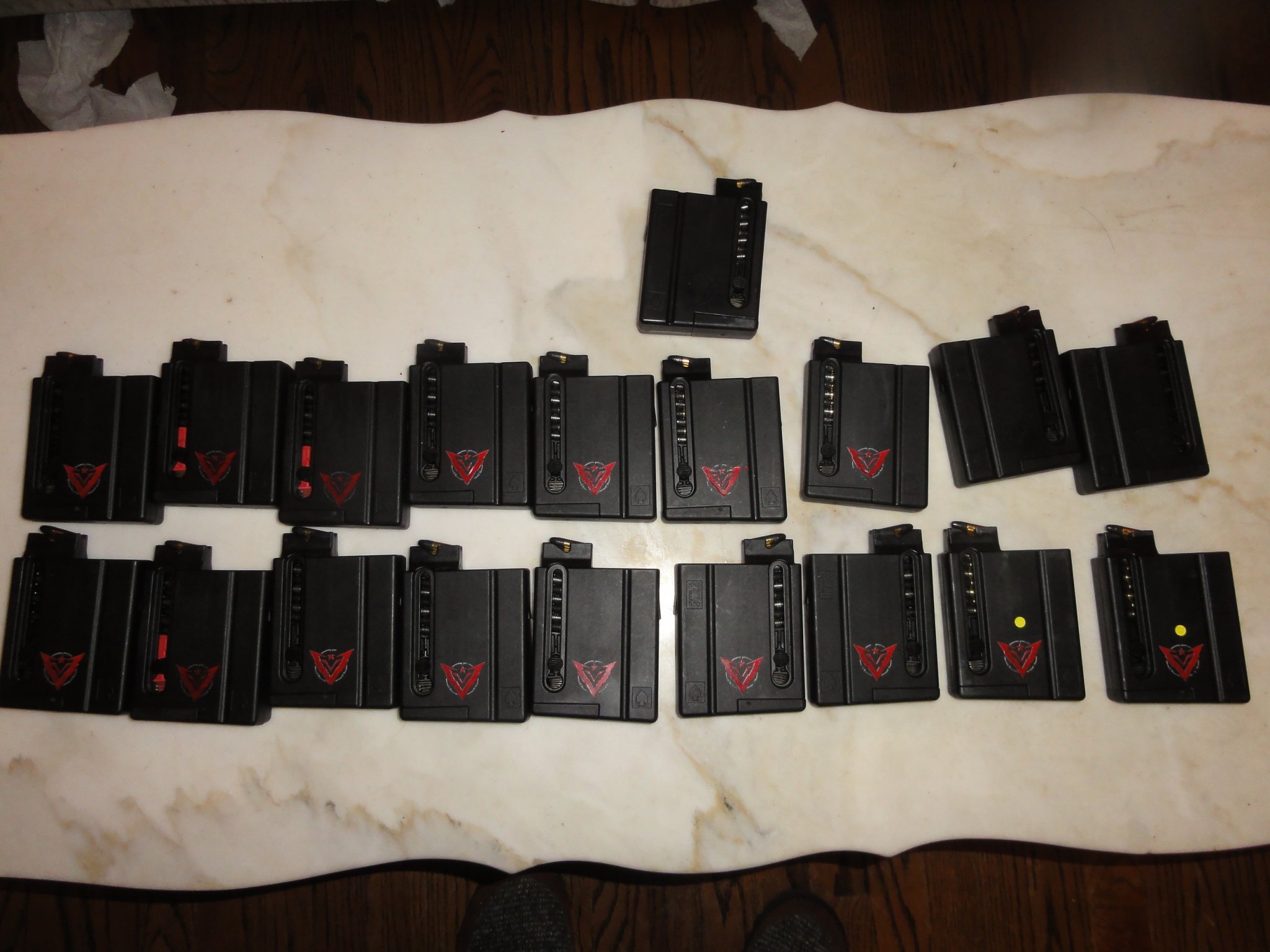

My 18 lb. V-22 with a couple magazines.
Shawn

Hello KOD,
You and I had talked about the safety less Jewel in a PM, the safety was not my concern. I didn't want you to have a trigger without a safety if you were considering shooting NRL. Jewel makes triggers with right and left safety like the one in the attachment below.

Thanks, I'll take a look at that one. The main thing with the Jewel that caught my eye was its advertised pull weight along with the $170 price tag. Monday I am going to call someone with Bix'n Andy and ask a few questions about their TacSport Pro. Even with this Elftmann I am still getting more resistance pushing the bolt in and out and closing the handle than with the factory trigger. The TT Diamond was worse than the Elftmann.
