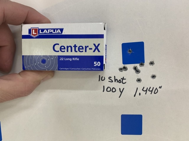

I wanted to edit this to add one more metric, out of the 44 5-shot groups the data above represents 66% were under 5/8".
Really impressed with the Federal results. I couldn't get any of the Federal ammo to shoot worth a crap out of any of my rifles.
The Midas + is some fantastic ammo.

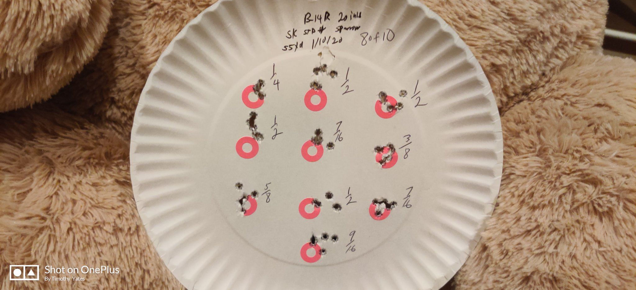

Done a lil ammo testing. Wind was 4-9mph from about 4:30.
Going to explore more with the Wolf MT, along with some Wolf MT Extra.
And Yes. I did go back to the factory stock. I didn’t like how the other stock balanced with the shorty 18” barrel. I’ll be on the look out for a used MPA Comp chassis to put it in.
SK Rifle Match is on my wish list. May have to add some Wolf Target Match to that list.
For now, I have Center-X, Midas +, SK +, CCI SV, CCI Clean Tgt, Eley Club and Target, on the shelf waiting for the weather to warm a little so I can get out a nd shoot. Last few days have been hovering around 0* with 5-10mph winds.

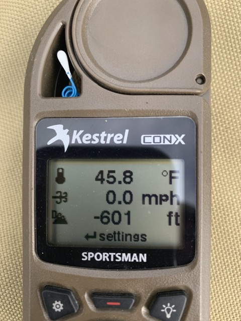

I know the feeling about the temps. While the kestrel read 46F, it damn sure didn't feel like it. We've had a shit ton of rain/ice and the 9mph wind skipping across wet ground sure made it feel colder.

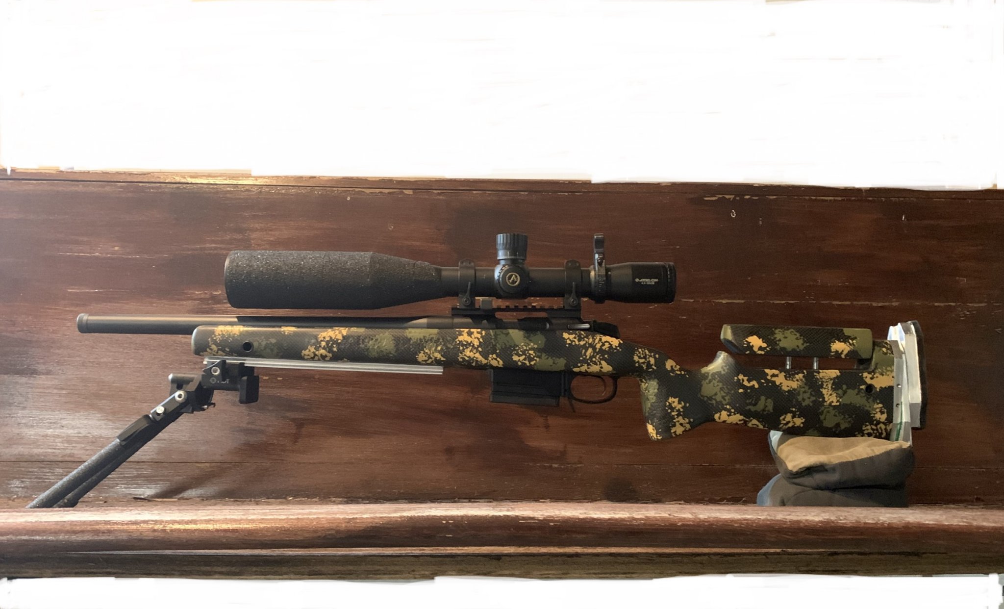

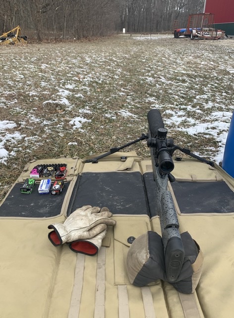

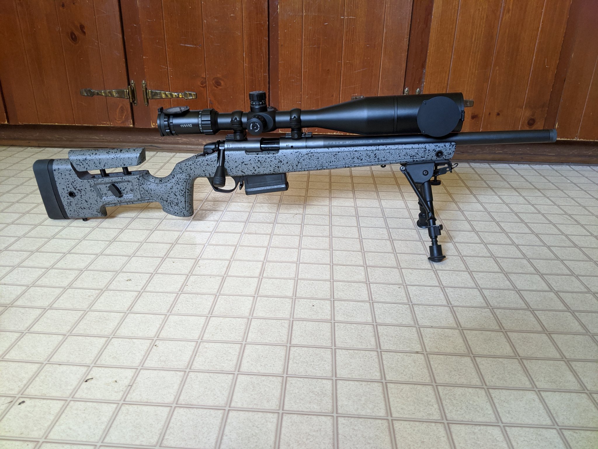

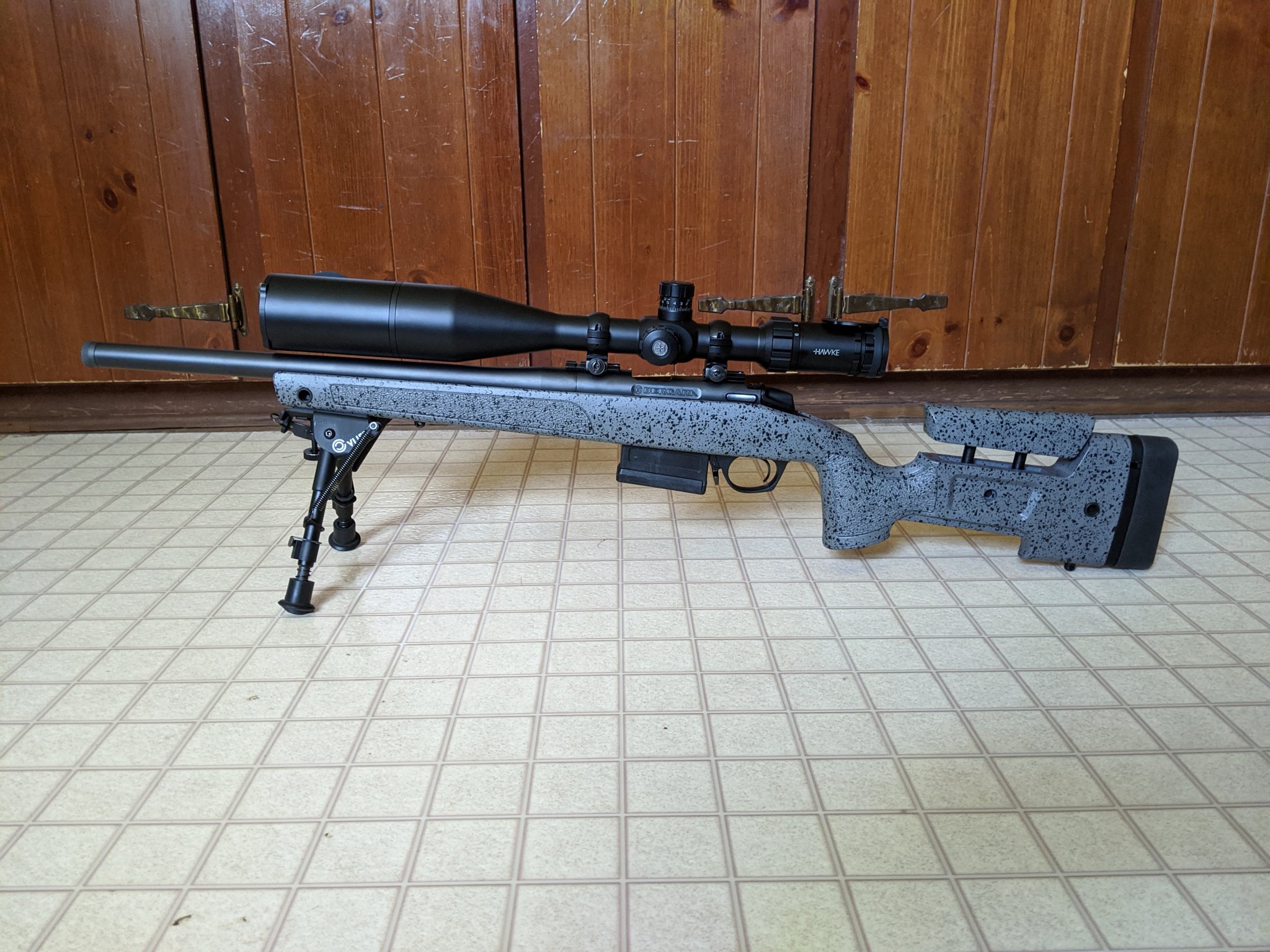

Received my scope of choice Friday and installed on my B-14R. It's a Hawke Sidewinder 30 SF 6-24X56. Now I have to get out and sight it in, maybe today or tomorrow.
Reactions: JKW70 and A&8's
You will love the Bergara in the BA Comp. Although it is a bit rear-heavy so I added some steel weights up front to balance things out.
Yeah, that shorty 18" doesn't really make it easy to balance without up front weight. That's the reason I pulled my from the CF Composite, as there really isn't a good way to add weight up front. I think the MPA Comp will do the trick for me.

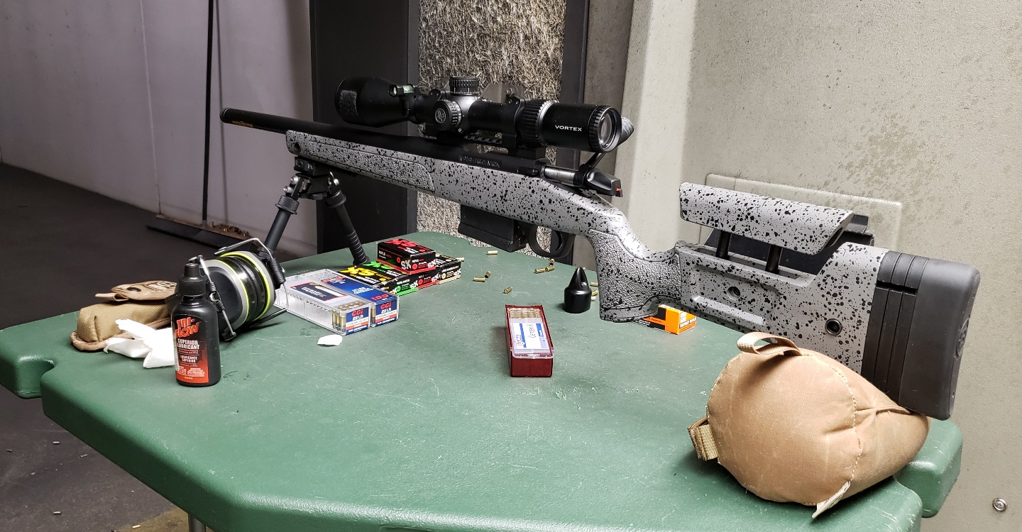

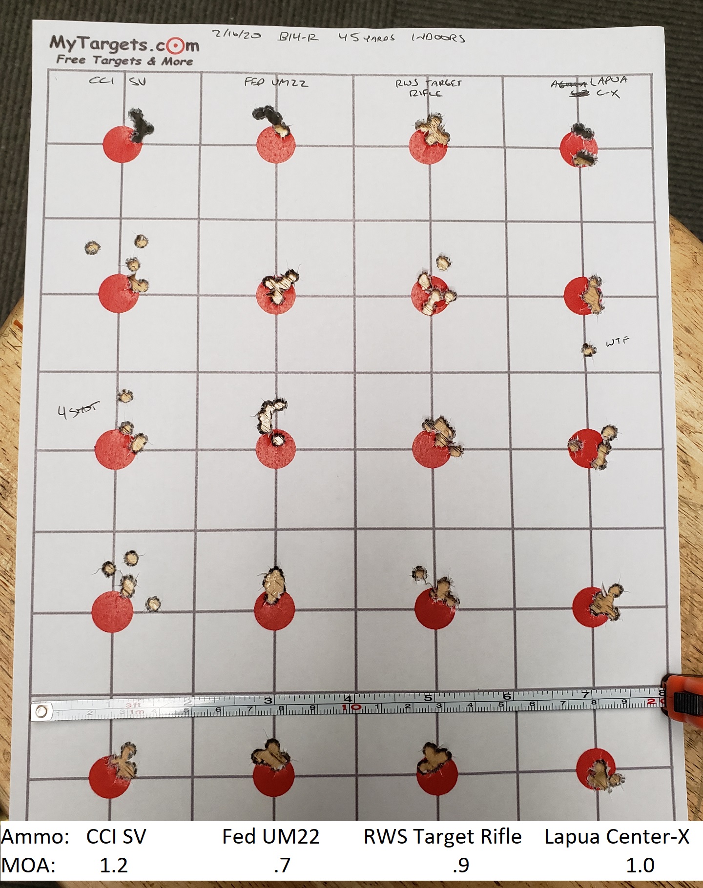

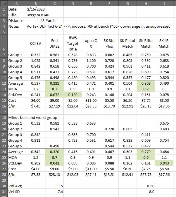

1st post here, thanks for starting a great write up KoD! I finally got a chance to put my Bergara B14R together and test it out...
A few notes:
  • Rifle Config: B14R, bedded EGW 30 MOA rail, Vortex Diamondback Tactical 6-24 MRAD FFP in Warne permanent attach low rings.
  • Action screws torqued to factory spec 55 in-lbs (only mentioned in fig 8.1 in the manual).
  • Lowest trigger setting is ~2.25lbs on my rifle.
  • EGW 30 moa rail sits ~0.016" high on the front. Solved by bedding the front of the rail. Not sure if the rail or the retarded Rem 700 reference design is to blame.
  • Fabbed a cheek rest 24mm extension out of 10mm aluminum spacer stock, to allow rapid return to my preferred height after removal for cleaning/maintenance.
  • No feeding or extraction failures of any kind.
  • 4 of the CCI SV's didn't ignite on first (or subsequent) strikes. Everything else went off just fine.
Test Setup:
  • Indoor 45 yard range, ~70F at the bench and 50F downrange
  • Atlas bipod and small rear bag
  • 5x 5 shot groups
  • No fouling shots or cleaning between brands/boxes during ammo testing phase.
  • Groups measured with a digital caliper, raw size listed - 0.22" for the average.
  • Wasn't particularly careful about shot placement or focus. Table was wobbly and I have at least a 1/10 moa wobble in my body/eyes as well. Bolt was run hard, nearing typical match pace.
  • Except for 1 sight in shot, pictures show every round fired from the gun so far. Progression was top to bottom, left to right.
Results:
  • Looks like I can run SK Rifle Match (when my last two bricks of Fed UM22 run out), and get my wish for near 100% sub-MOA performance out of <$8 ammo! I'm stoked with this rifle!

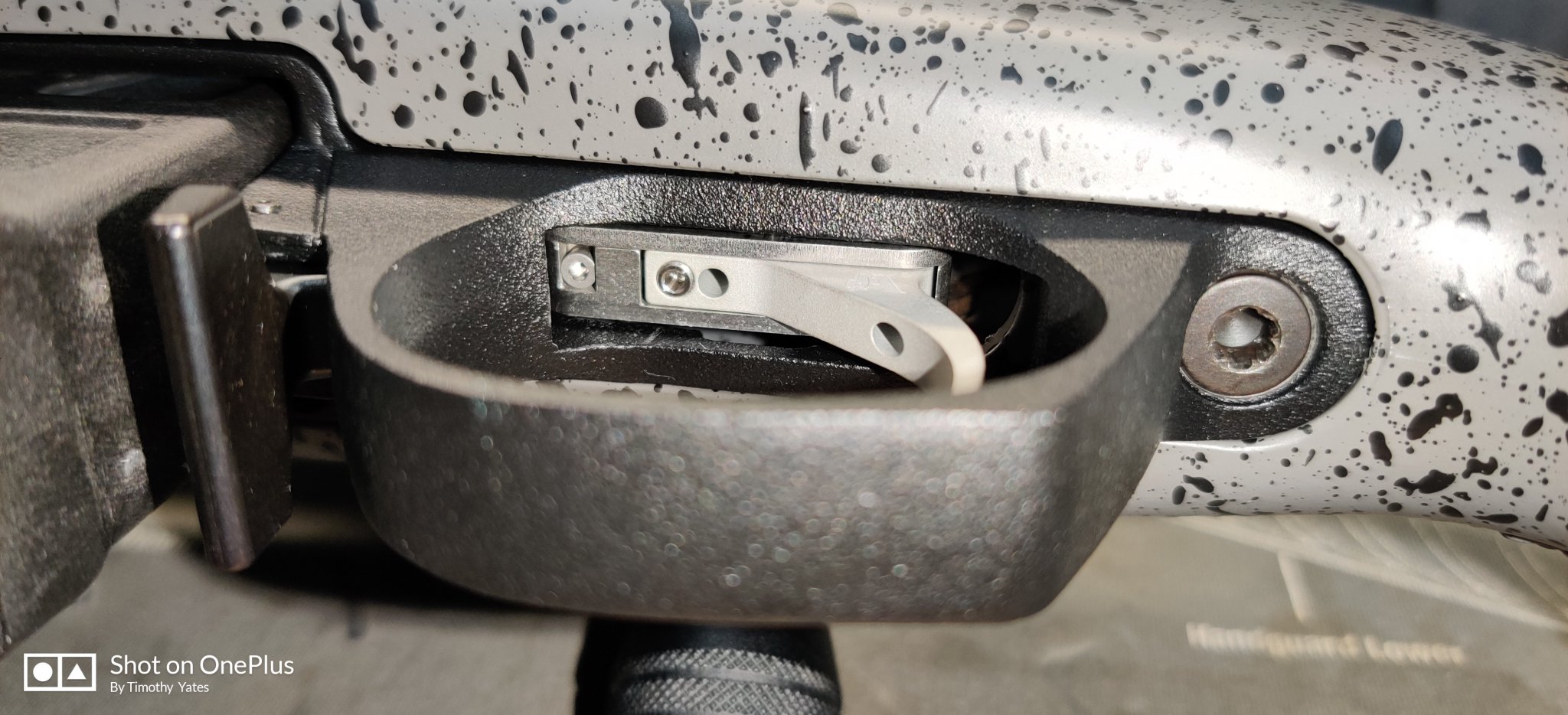

First item to discuss are triggers.
Factory Trigger:
My factory trigger was very bad if I recall it was around 3 lb. It may have been a little less but even so.... So to shoot to the full potential of the rifle I felt I needed to get a different trigger.
TriggerTech Diamond:
Based on recommendations in here and what I read I went with the TT Diamond as first choice. The TT Diamond was a total fail. To be a safe trigger without AD's the advertised pull weight was not even close. Even when getting it safe the pull itself was very inconsistent which resulted in a few AD's from that. AD's in the beginning was caused by bolt closure, AD's in the end was caused by trigger pull weight inconsistency. Also the bolt was very hard to open and hard to move back and forth. Keep in mind, I'm not talking hard to the point it could barely be done but it was noticeably more difficult than with the factory trigger. One thing I did like was the flat trigger shoe.

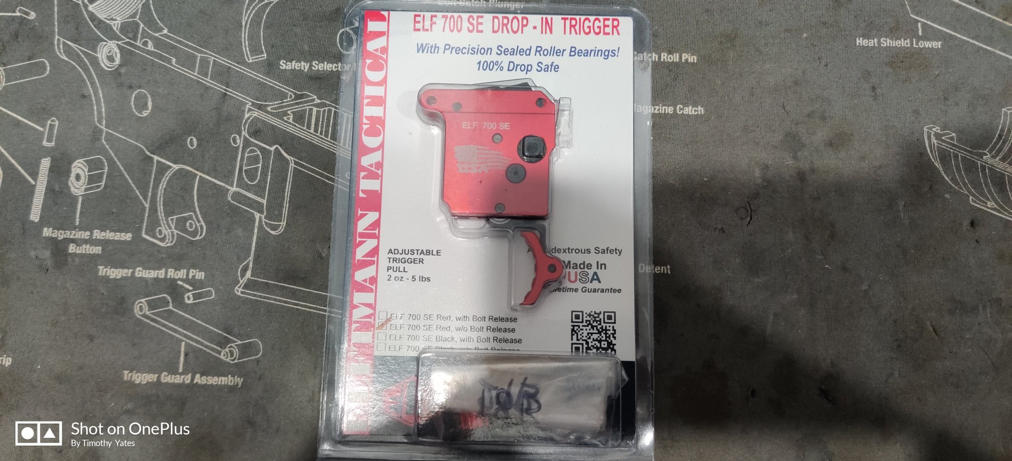

Elftmann Tactical R700 SE:
I decided on Elftmann because I got a good deal at $200 shipped. What I didn't know was I was only getting the curved trigger shoe and the flat one was not included. The installation was straight forward without issue. But, when I tried to put the trigger guard on, it wouldn't fit and was hitting the bottom of the trigger housing. I'm not going to go into it much with Elftmann unless someone wants to hear the finer details. Currently they know about the issue with the Bergara HMR stock and are in the process of developing a new, slimer housing. Mine is at Elftmann being fitted. According to Cara at Elftmann it will ship out next week. We will see. Things I notice while I had it in was the same hard bolt manipulation as with the TT Diamond. The minimum trigger pull weight was also not as advertised. For the price I paid I'll just wait on this one and use in a RimX, Deuce or Vudoo barreled action. Also it will come with both shoes when received.

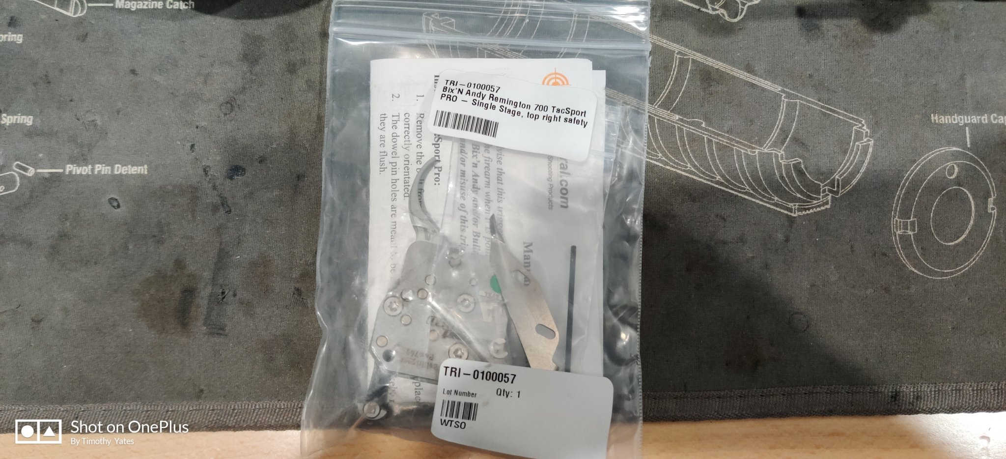

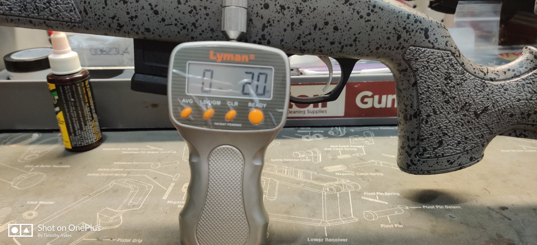

Bix'n Andy TacSport PRO Single Stage:
Grand Slam! This trigger is amazing. I never did anything to it but install it. The pull weight is a consistent 2 oz just as advertised. The bolt manipulation is just like it was with the factory trigger. It does have an extremely small amount of take up then a nice break. It does have overtravel that I talked with Bullet Central about and they tell me it's supposed to be that way and that B & A has a different way of thinking about having overtravel and no having it. I may try some things to remedy this. I credit the easier bolt manipulation on the fact they B&A offers their trigger with 3 choices of bottom sears. When I measured my cocking point to the trigger pin hole mine was close to the middle of the default 3.8mm bottom sear.

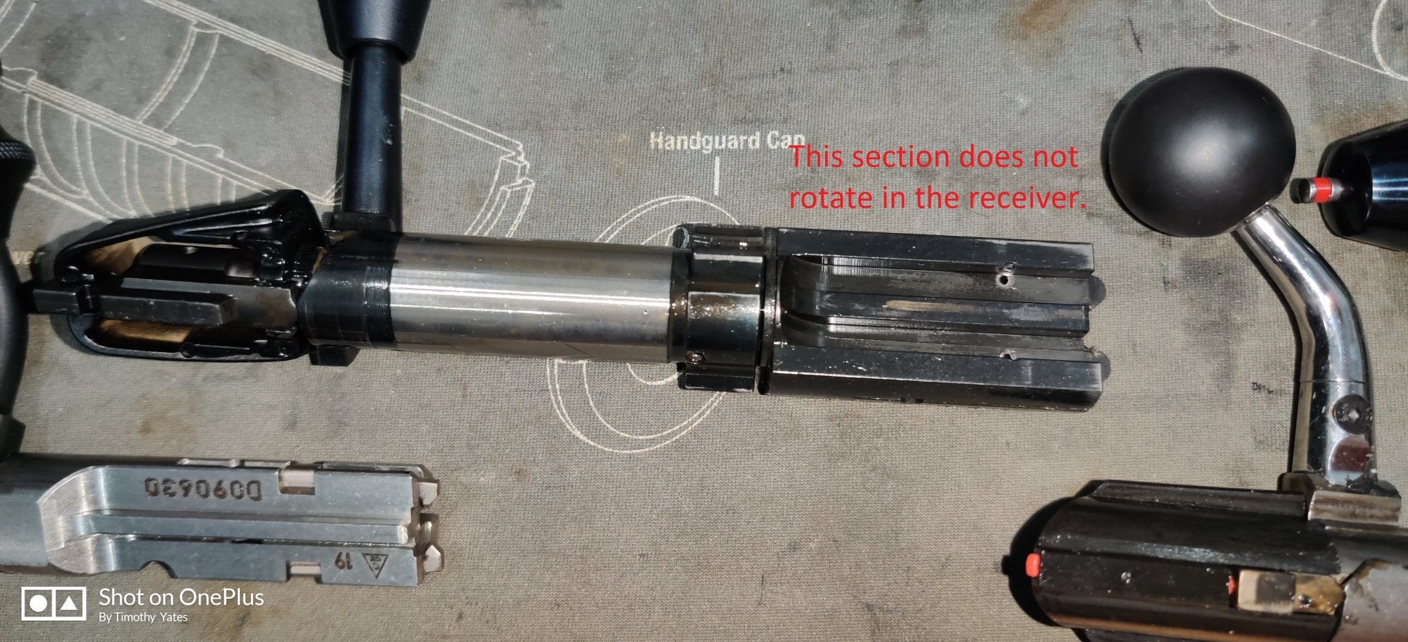

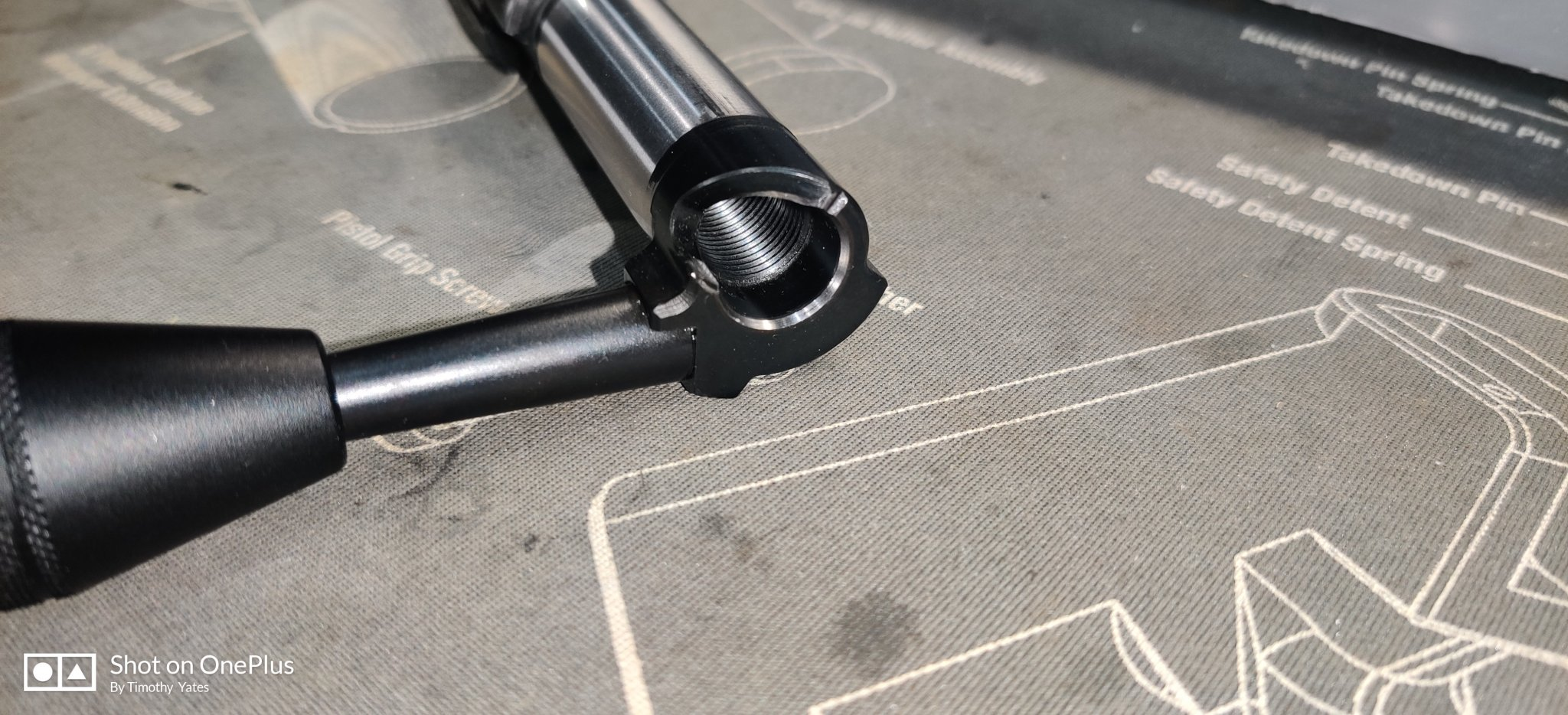

Some rifle characteristics that may not be know.
1. The barrel is threaded into the receiver.
2. The bolt knob has a M6X1 thread pitch. This is the same as the CZ 457. Your typical R700 knob will not fit without an adapter.
3. There's no plastic anywhere except for the spacer system for LOP adjustment.
4. The feeding is controlled round feeding, just like the Vudoo is.
5. Chamber is a match chamber where the bullet engraves the rifling.

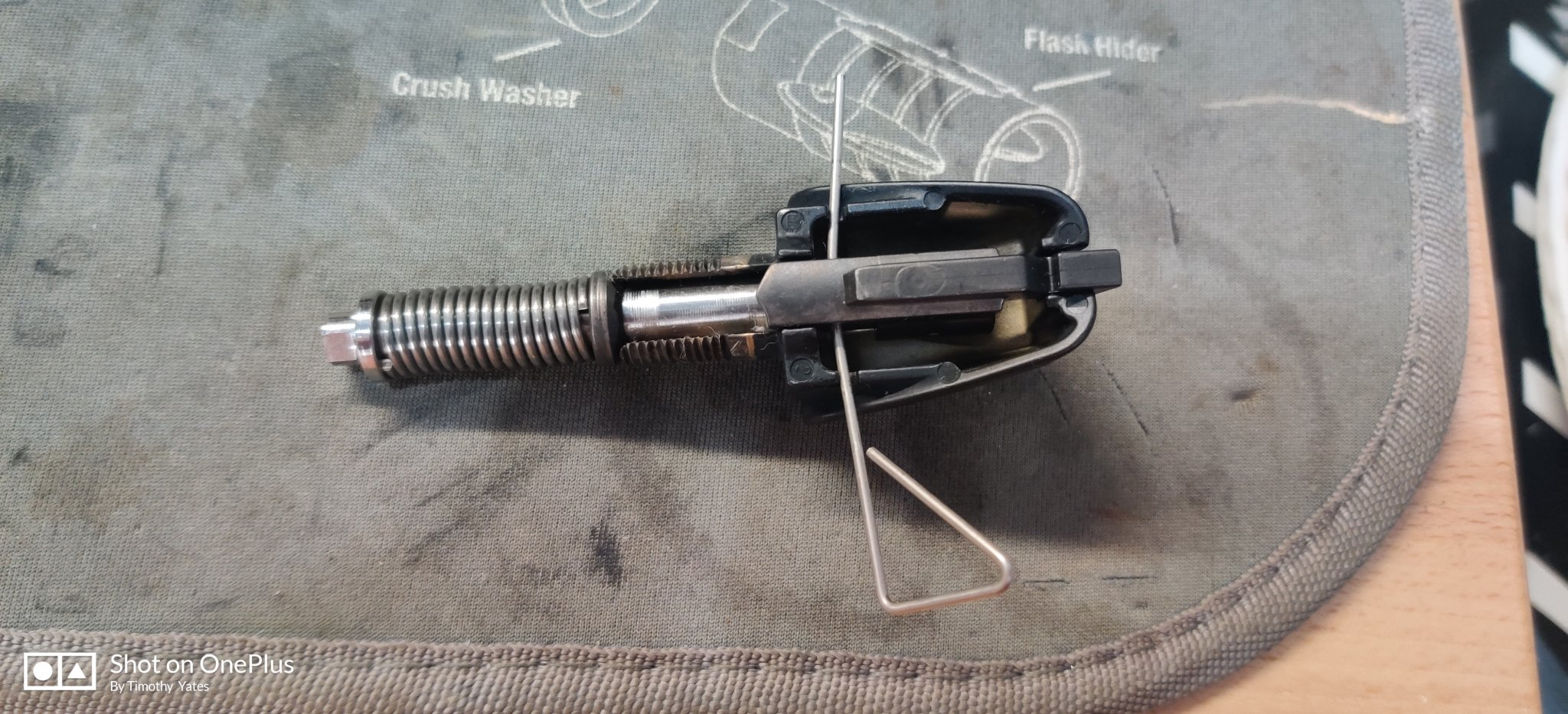

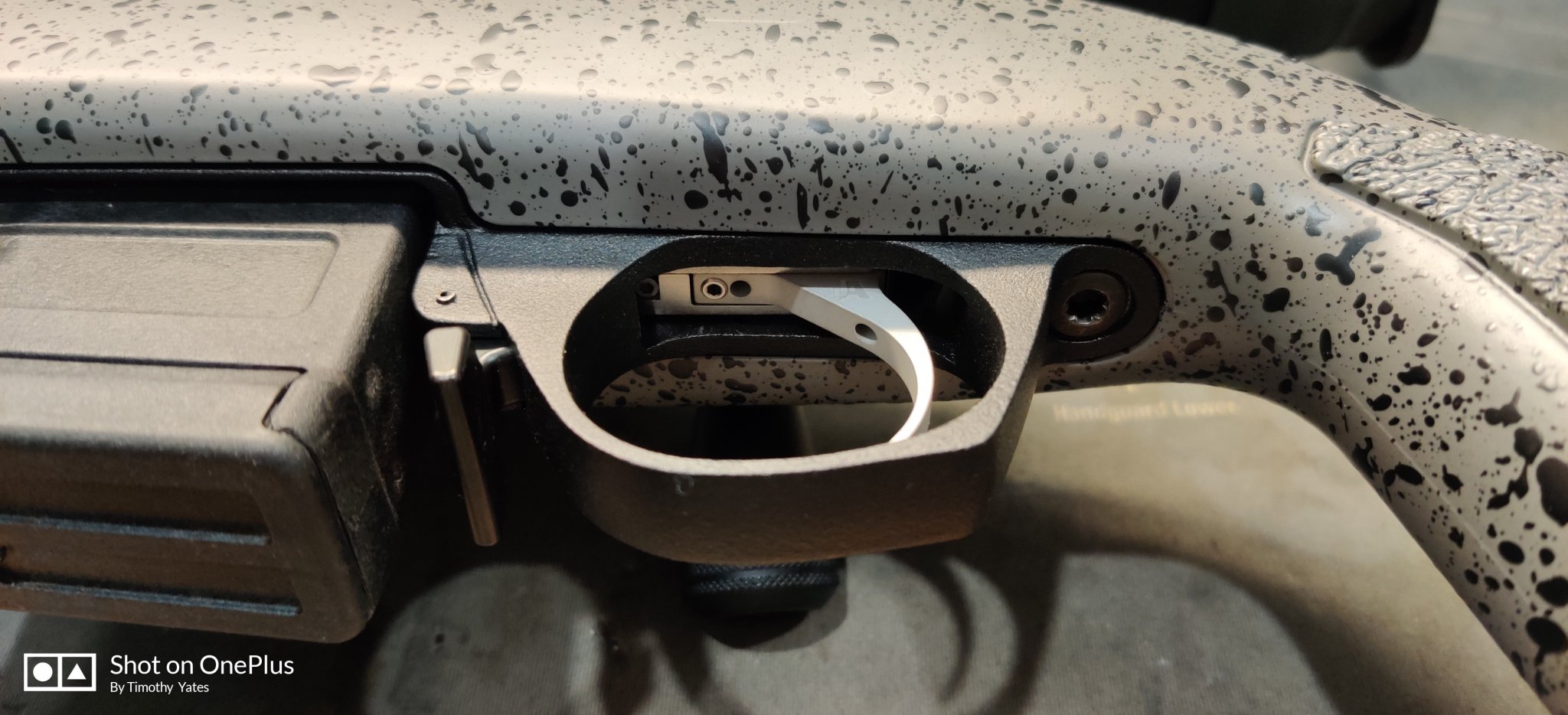

Here are a few photos that may be of interest.
Some don't like this design because of the supposed increase lock time. IDK, I like the ease of disassembly. I will continue on with another post showing accuracy results from a few days ago.

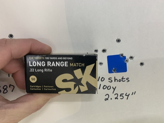

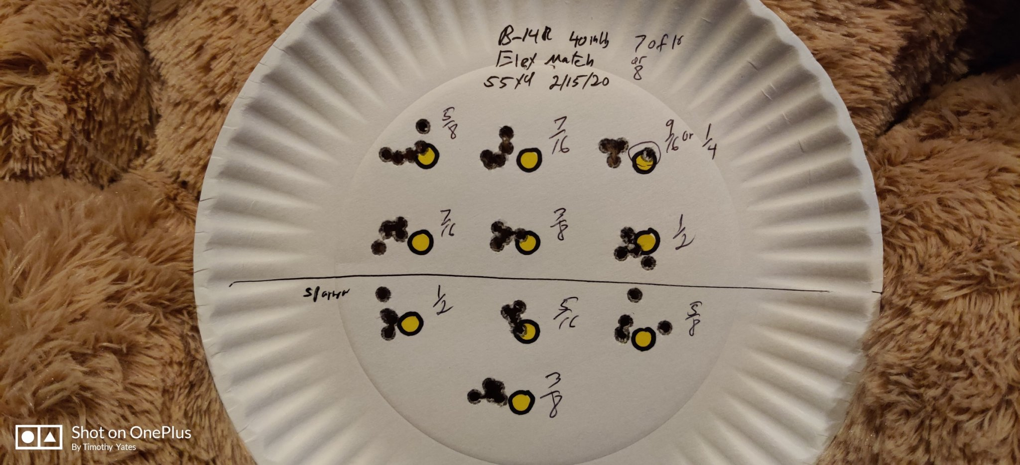

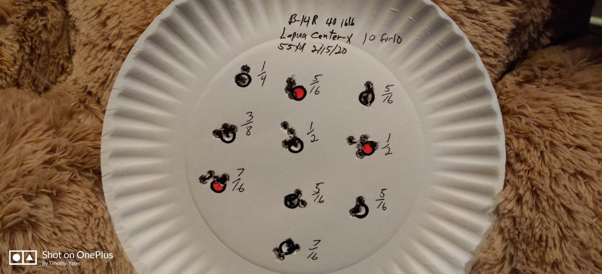

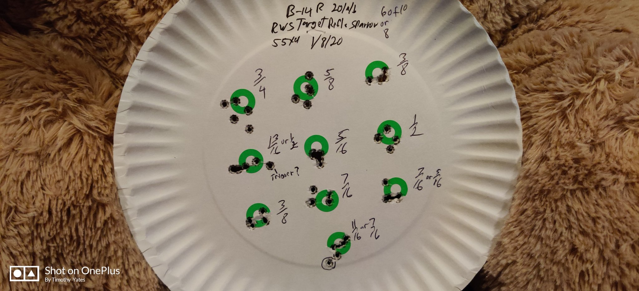

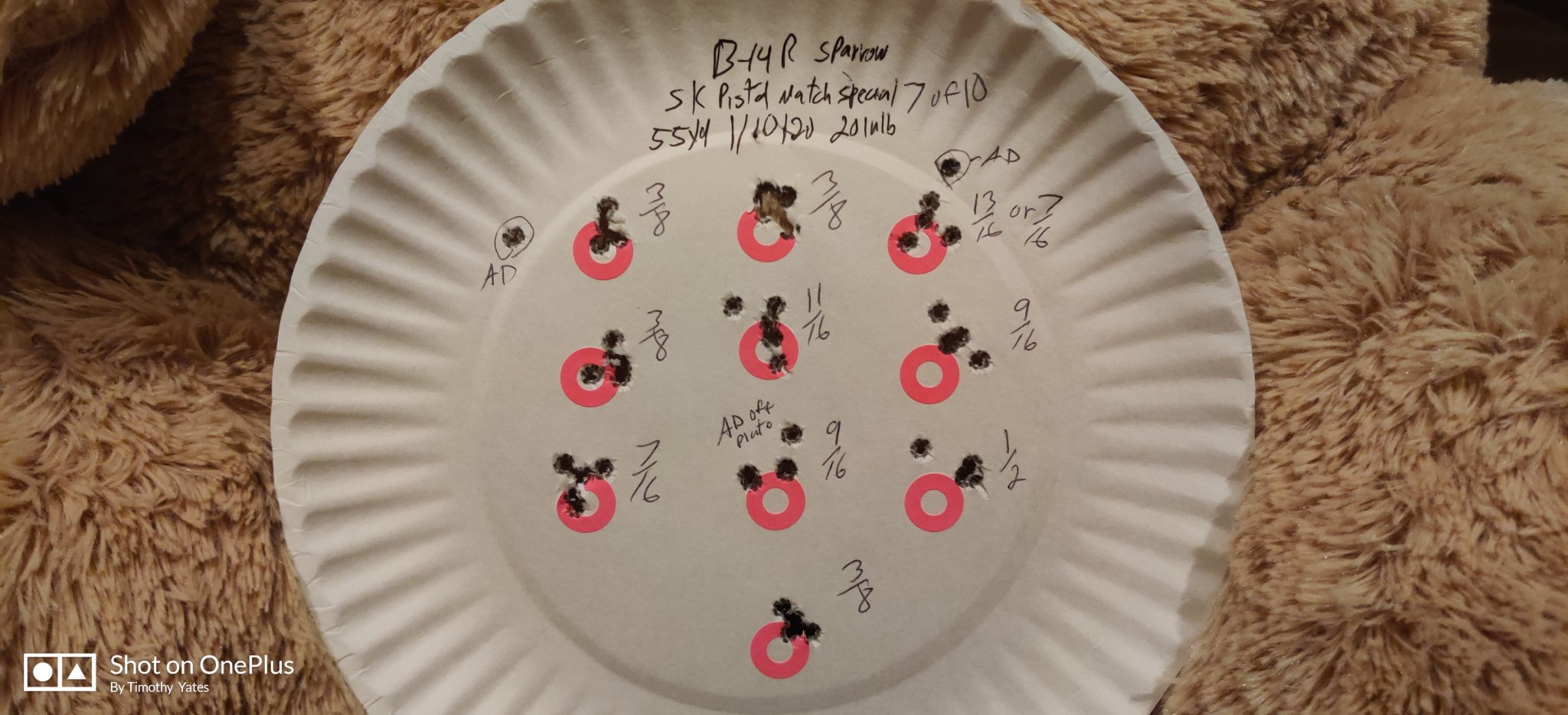

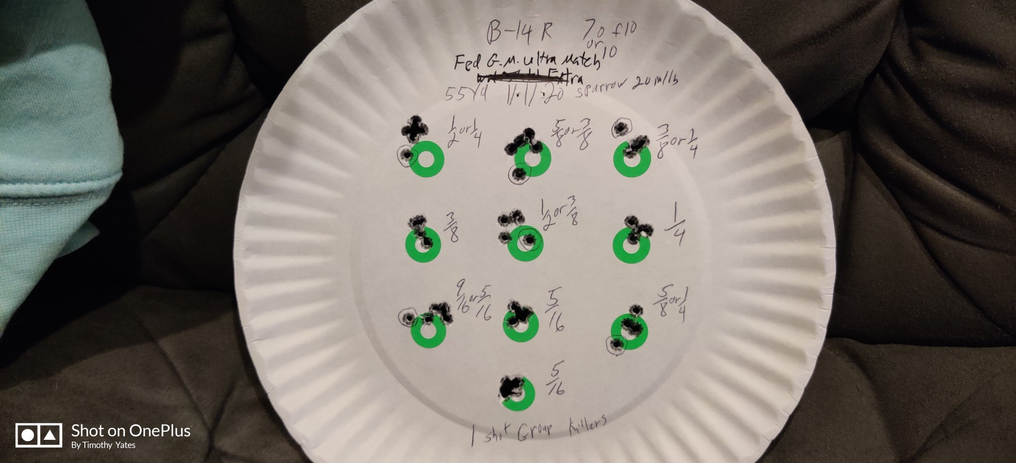

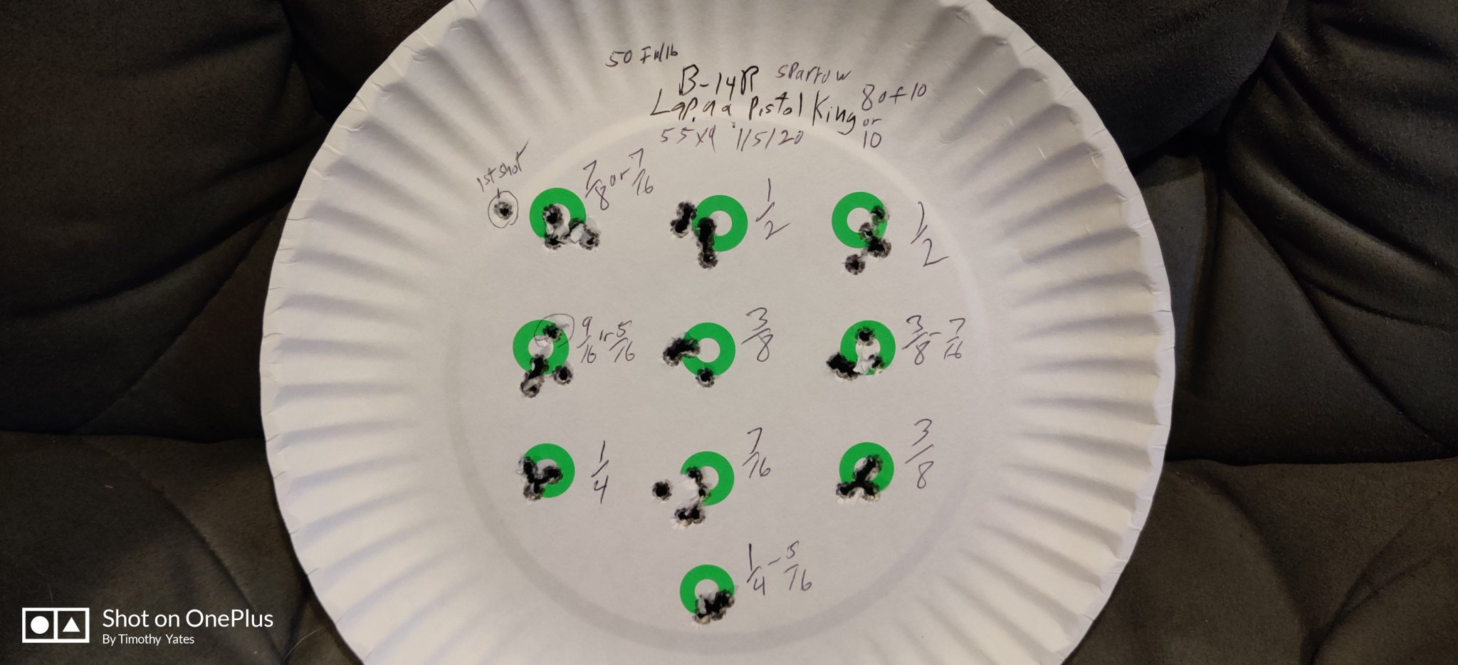

I wanted to go back and od a little more experimenting and reshoot the Eley. Today was a nice day for that. Results are as follows.

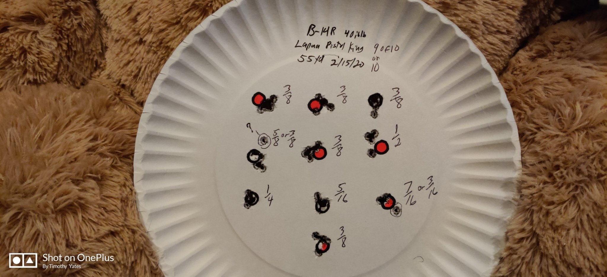

First up is Lapua Pistol King. I wanted to shoot a full 50 rounds with my Sparrow and the action screws set at 20 inlb.

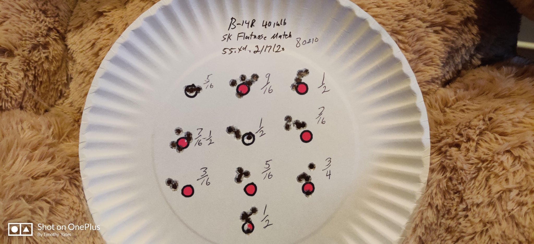

Wanted to reshoot SK Flatnose Match. This is consistent ammo and I'll probably try find this lot number with Cathy at Good Shooting.

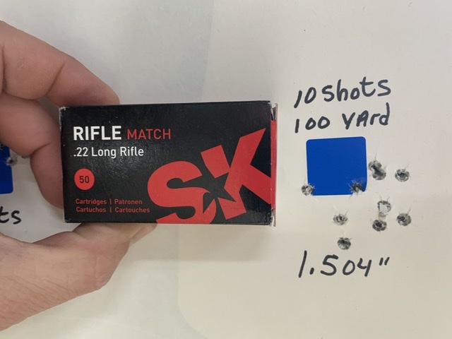

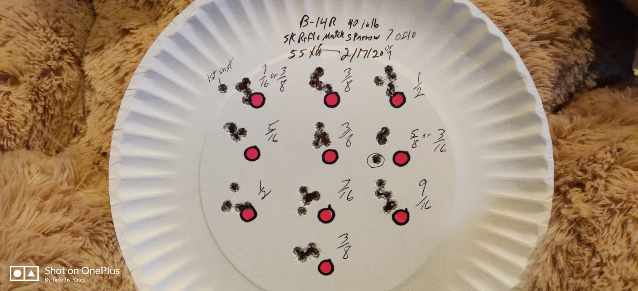

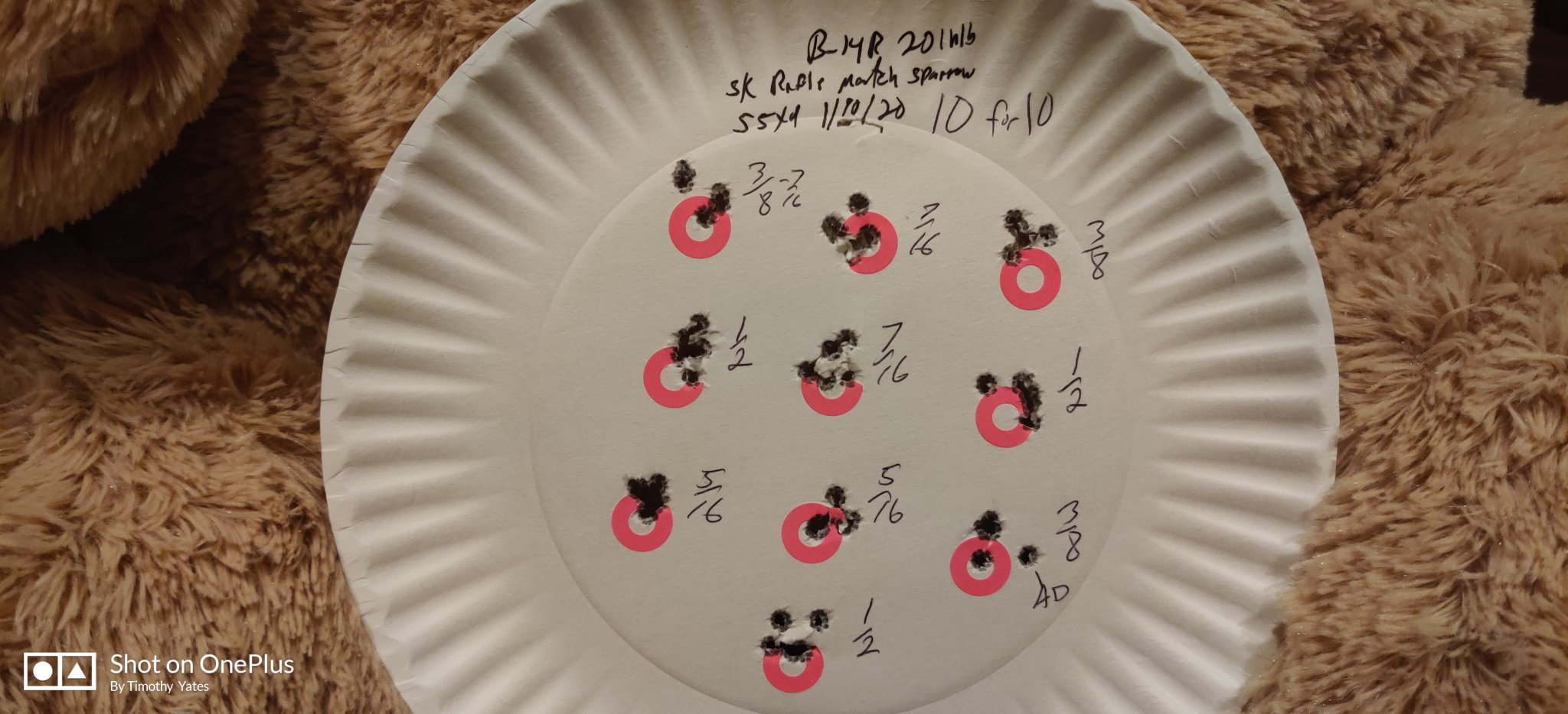

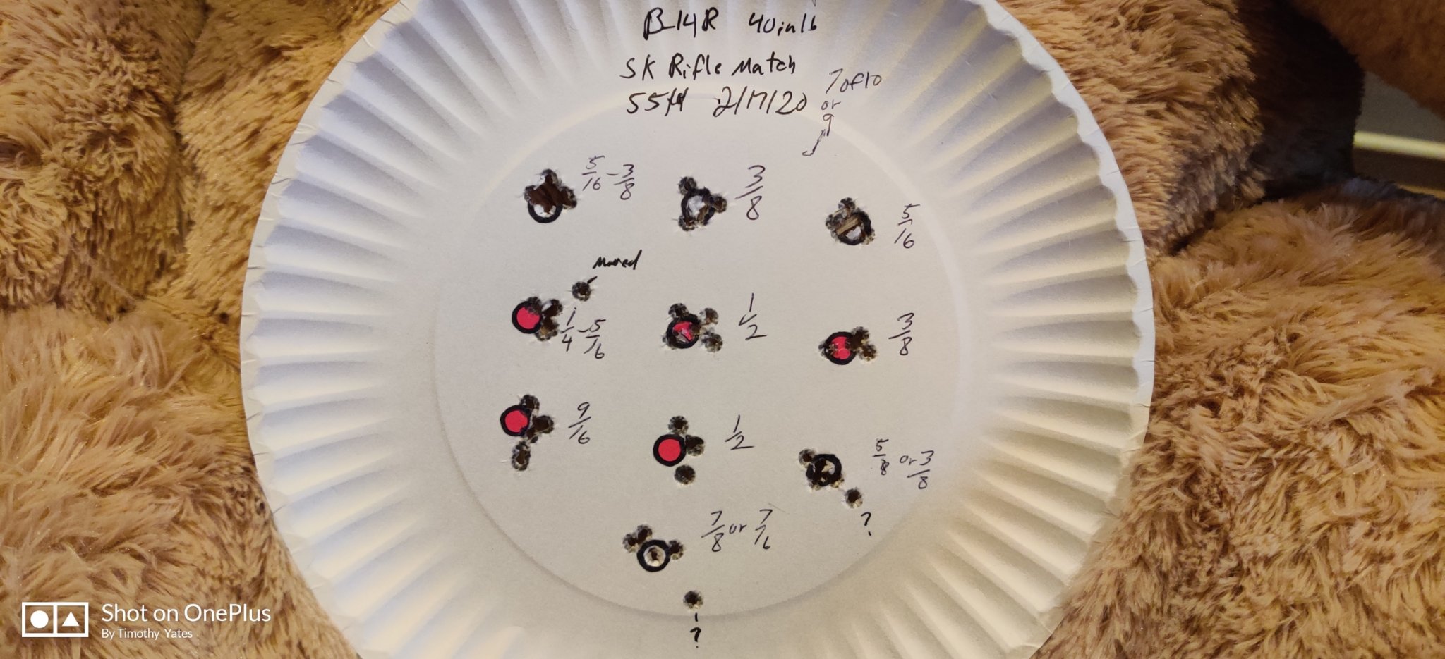

SK Rifle Match. Shot this to check consistency. I'll be getting more of this lot number too if it's available. The 5th shot on each of the last two groups screwed up a good run. Still not bad though. When I put a question mark down that means everything looked and felt good on my end but it just didn't happen.
Next I decided to see what SK would do suppressed and at 40 inlb on the action screws. Not bad, better than I had expected. I didn't make a scope adjustment the entire day. As you can see with the Sparrow on the impact shifted up and left.

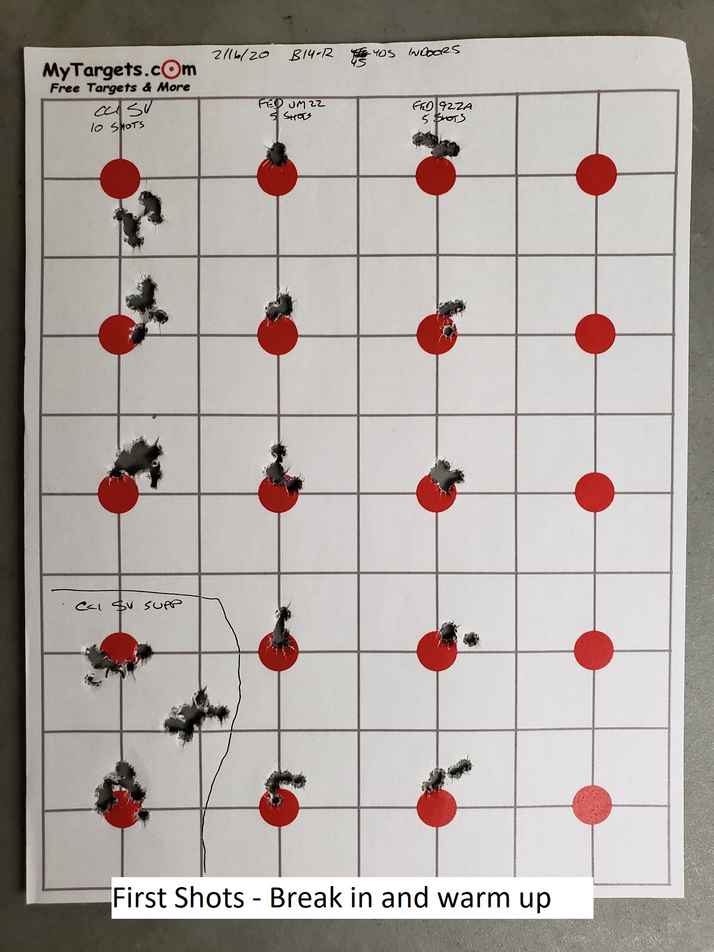

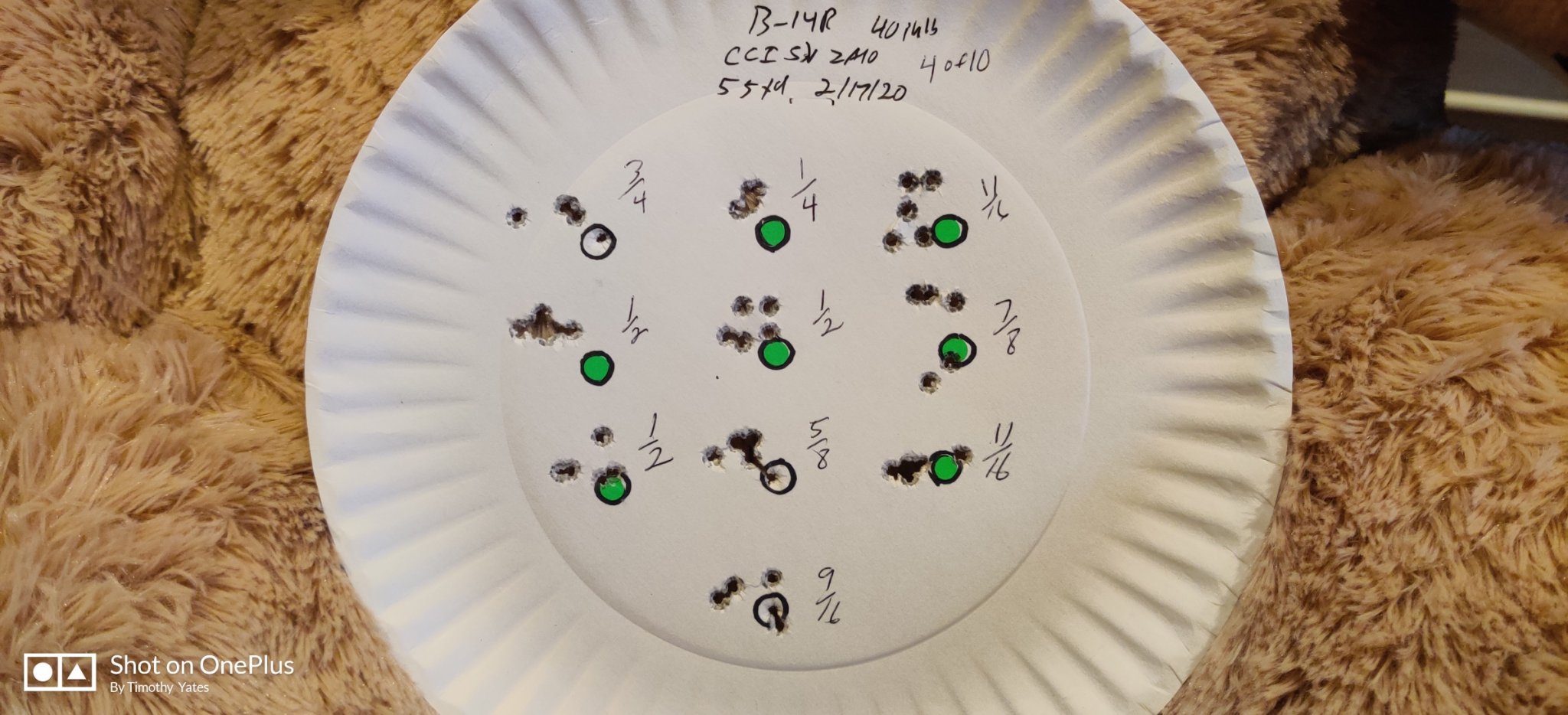

CCI SV. What is a day at the table without shooting CCI.
Well I'm done with the B-14R until my Elftmann comes in. Cara said it was completed today and will ship out tomorrow. Really looking forward to that to see how a trigger with zero take up and zero over travel will feel.
A few notes:
Test Setup:
  • 5x 5 shot groups
Results:
View attachment 7252136View attachment 7252137View attachment 7252138View attachment 7252139View attachment 7252140
Seems the SK Rifle Match is shooting the best out of most of these rifles. I know mine loves it.

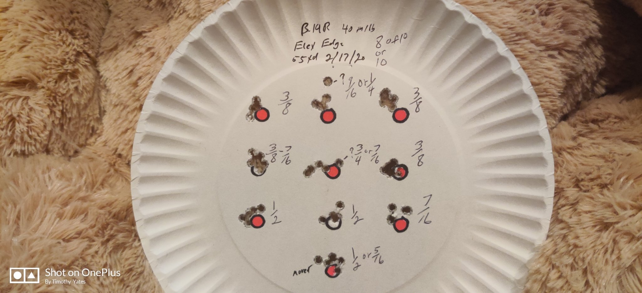

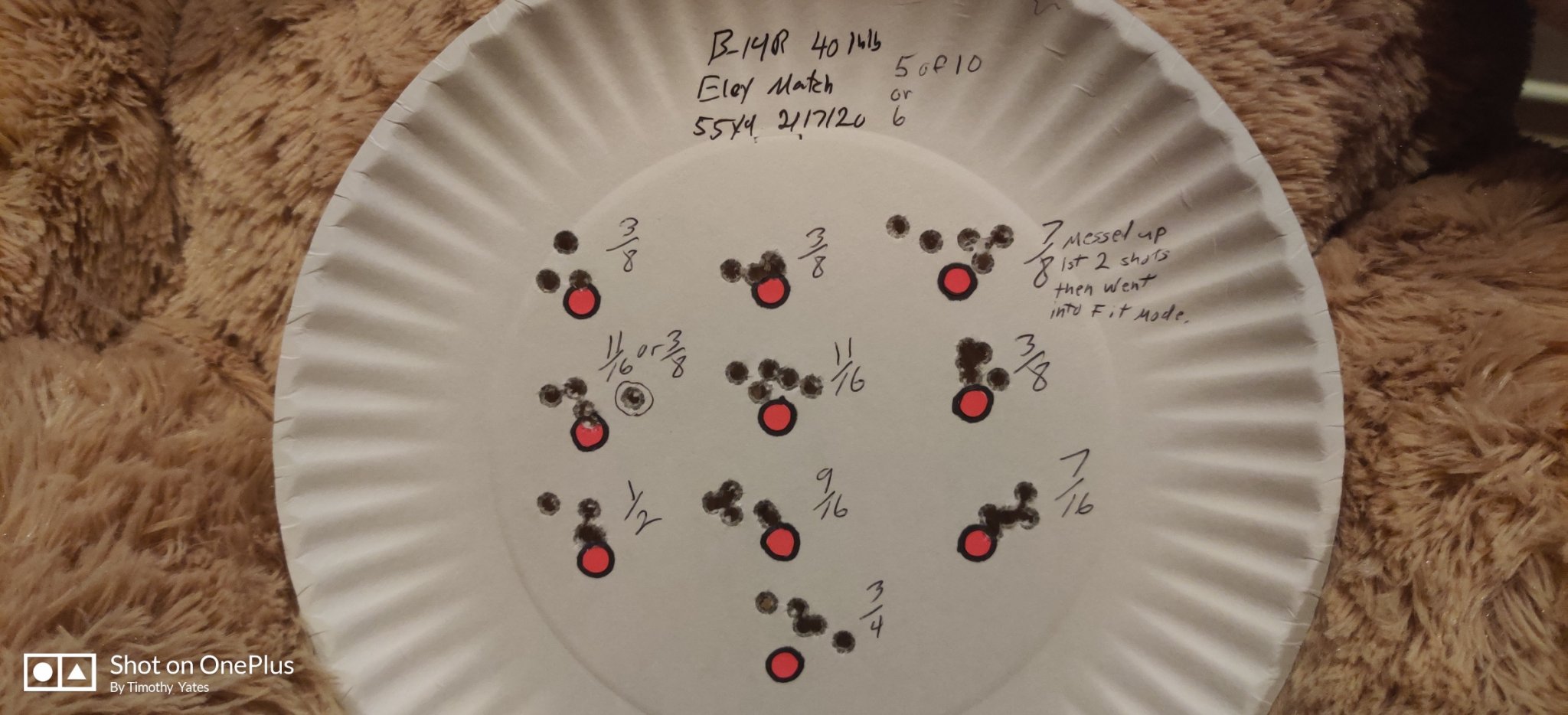

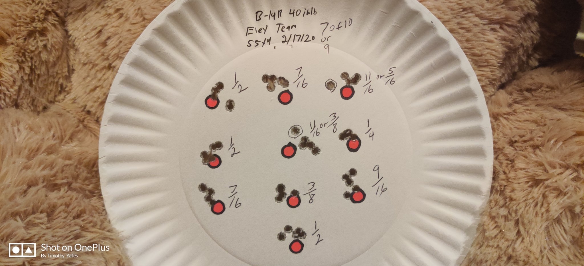

Also here are those Eley targets I forgot about.
