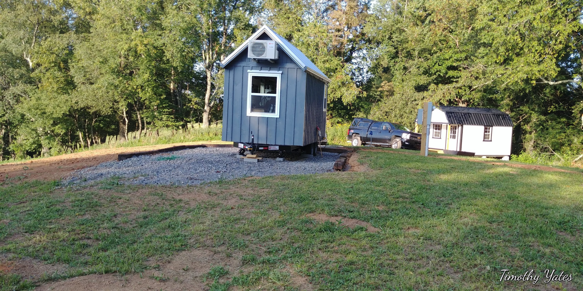

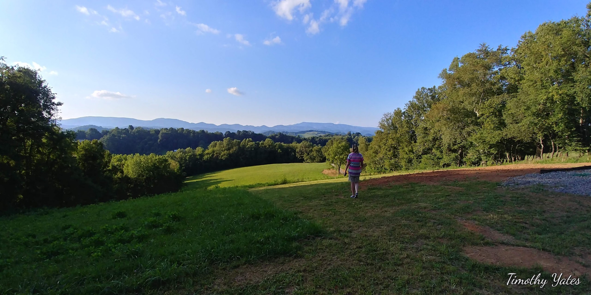

Here is what my property looks like in VA. In the bottom photo, from where I stand, down to the tree line I can get 300 yards. My white storage building is larger than the tiny house. All this was bought as a package deal.

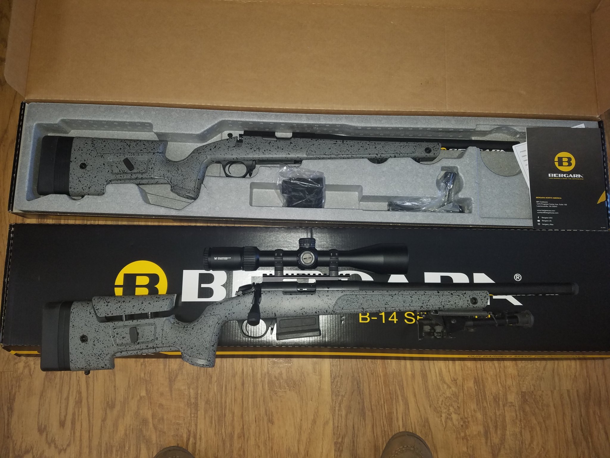

The review was good but could have been more in-depth.
There seems to be a a lack in confidence in the rifles represented on SH. Tons of pictures of the rifles and very few targets other than cherry picked "best group" ever shot with that rifle. This thread is almost an exception to that statement as kissofdeath posted more than a few plates full of holes.
You have one of these rifles in an unopened box for sale and ask others for a more in-depth review?
Why don’t you just open it, shoot it and provide this in-depth review yourself?
As it happens I have 2 of them. I didn't offer a review of the rifle, and don't intend to.
