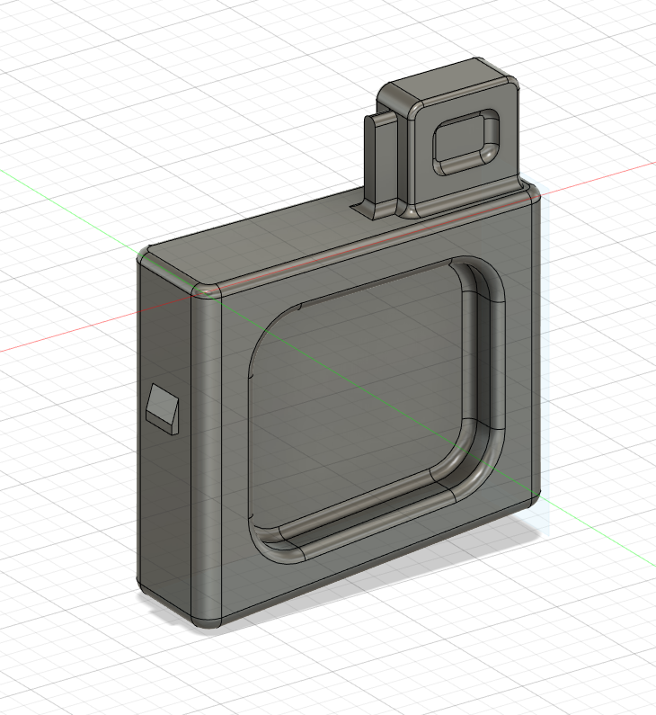

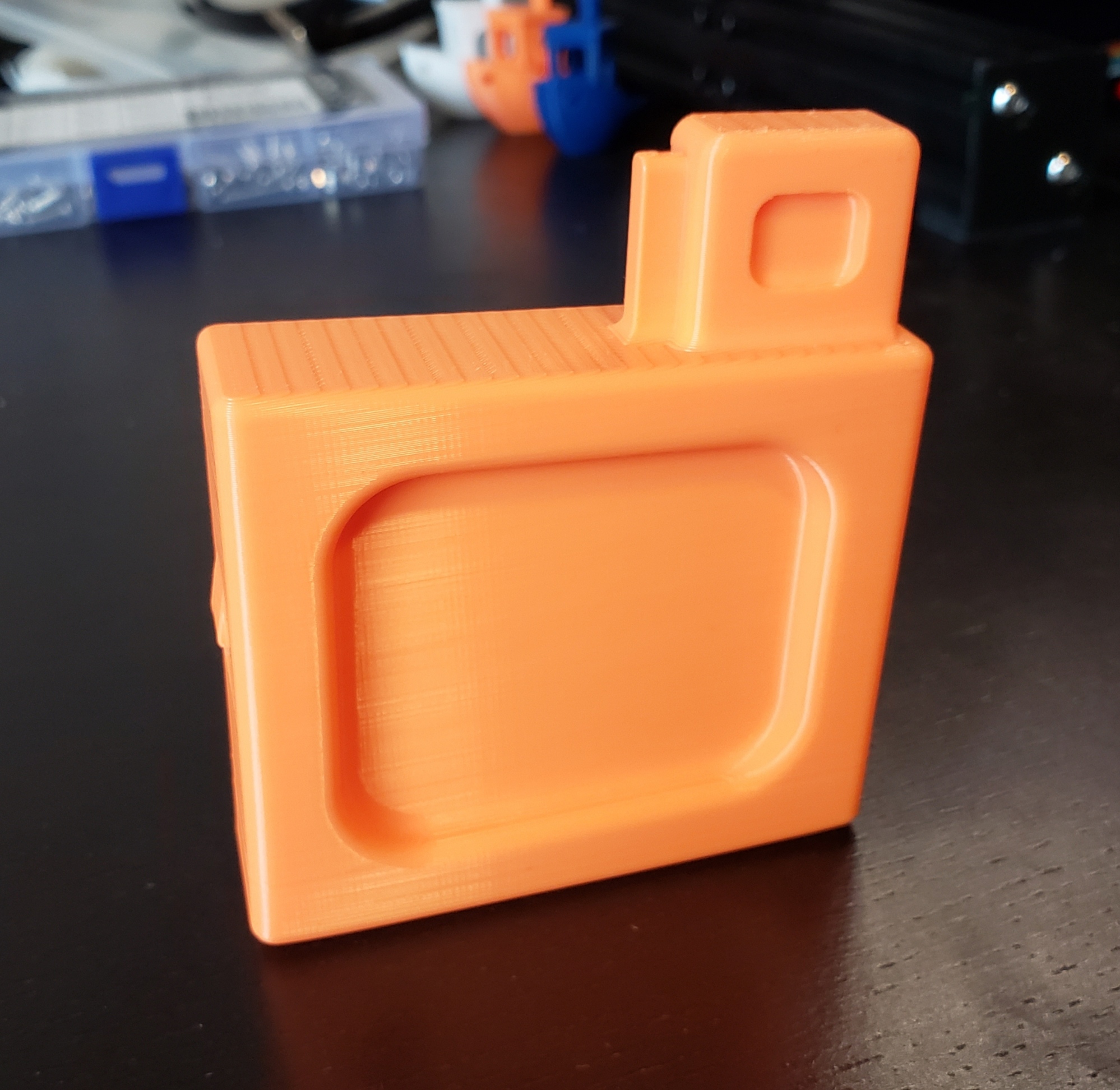

Forgot to add a feature to protect the extractors... Rev 1.1 is on the printer...

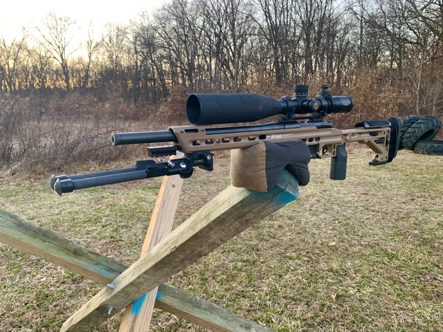

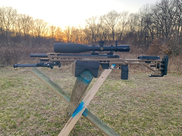

Decided to put the barreled action in a spare MPA I had. With the short 18" barrel, I could stand to add a bit of weight up front. But, it's not all that bad.
Now that I have more available rise on the cheek, I have a set of Burris XTR 40moa rings I'll install tonight. I have a 20moa base now, so probably go with the 30moa bushings to get a total of 40moa. I doubt I could zero at 35y with anything more. I may have to remove the NV bridge, too, as the sun shade is close as it is now.

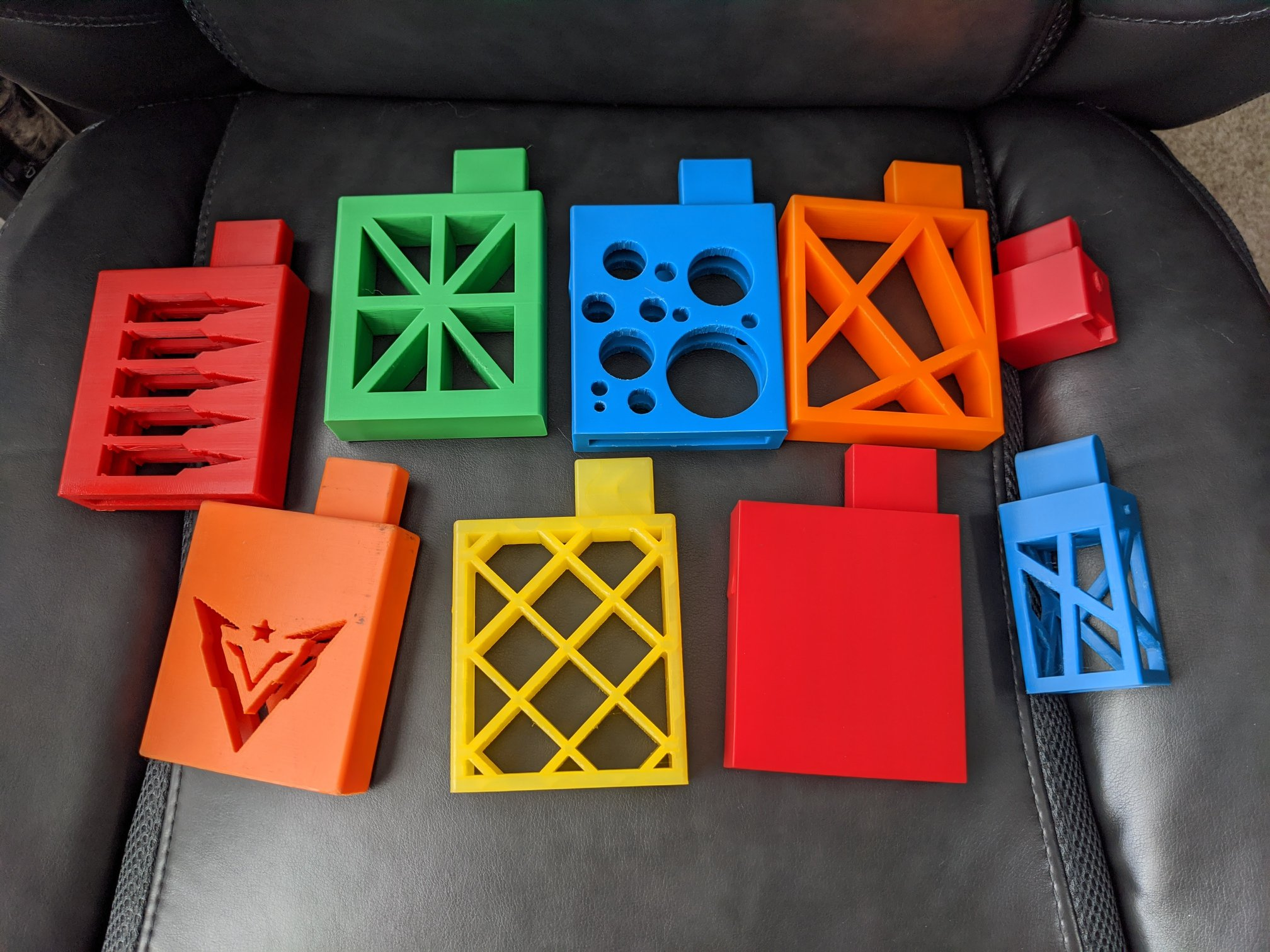

version2 chamber flags hot off the printer. Added extractor protection feature, deepened the recesses and added a more robust mag catch feature.
I'm all ears if anyone has any thoughts on how to improve this design further.

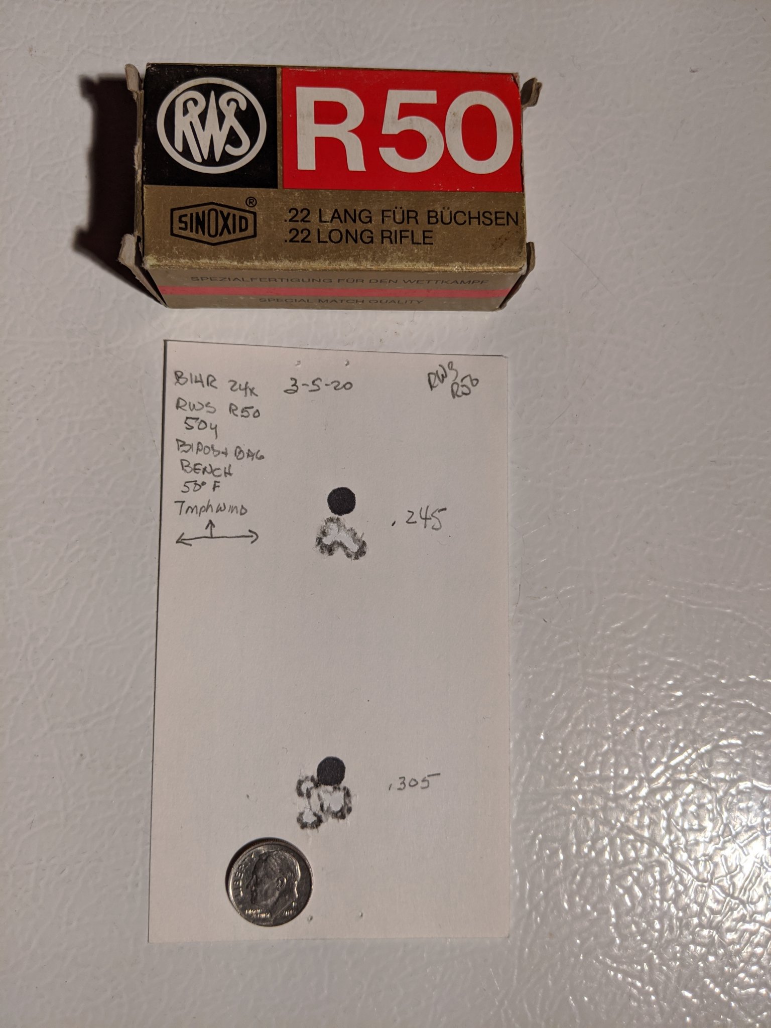

No, 50 yards. The Aguila ammo that I had skewed the results a bit because the rifle didn't really like their Rifle or Pistol Match ammo. I don't have the data in front of me but if I remember right the 20 round aggregate for 4 out of the 11 types was under 1/2" and a couple others were a shade over 1/2".
`don't know, but I suspect that the reason is longer headspace than the Aguila (and Eley) need.
Aguila, like Eley, employs shorter .038" case rim thickness than Lapua/SK, which uses the longer .0415" case rim thickness, as does CCI and most American rimfire ammo manufacturers, btw.
It's not that one size is better than the other; it's more a matter of fit. If you have size 10 feet, size 12 sneakers are going to swim on you. If a round is floating in the breeze within the chamber, where that round goes will not likely be as consistent (precision).

I wanted to edit this to add one more metric, out of the 44 5-shot groups the data above represents 66% were under 5/8".

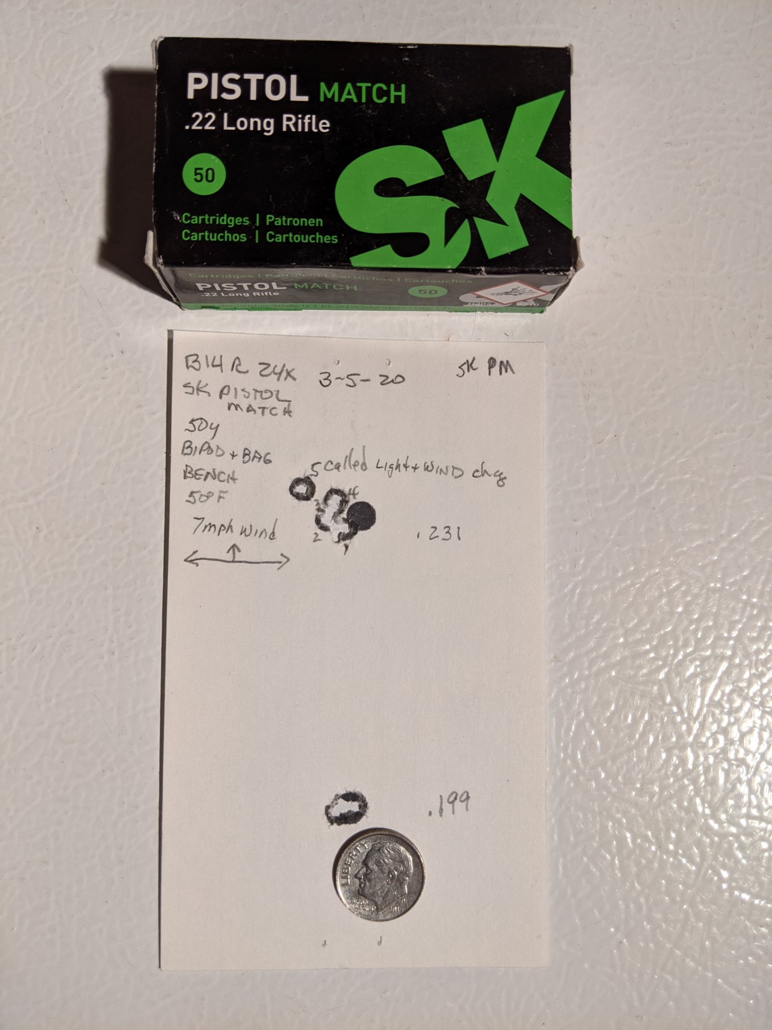

THANKS - for posting the above. Those results just about scream to me that the Bergara headspace must be more like .042" than .038", which is the Eley and Aguila case rim thickness size.
Federal and Lapua/SK employ the .0415" case rim thickness size.

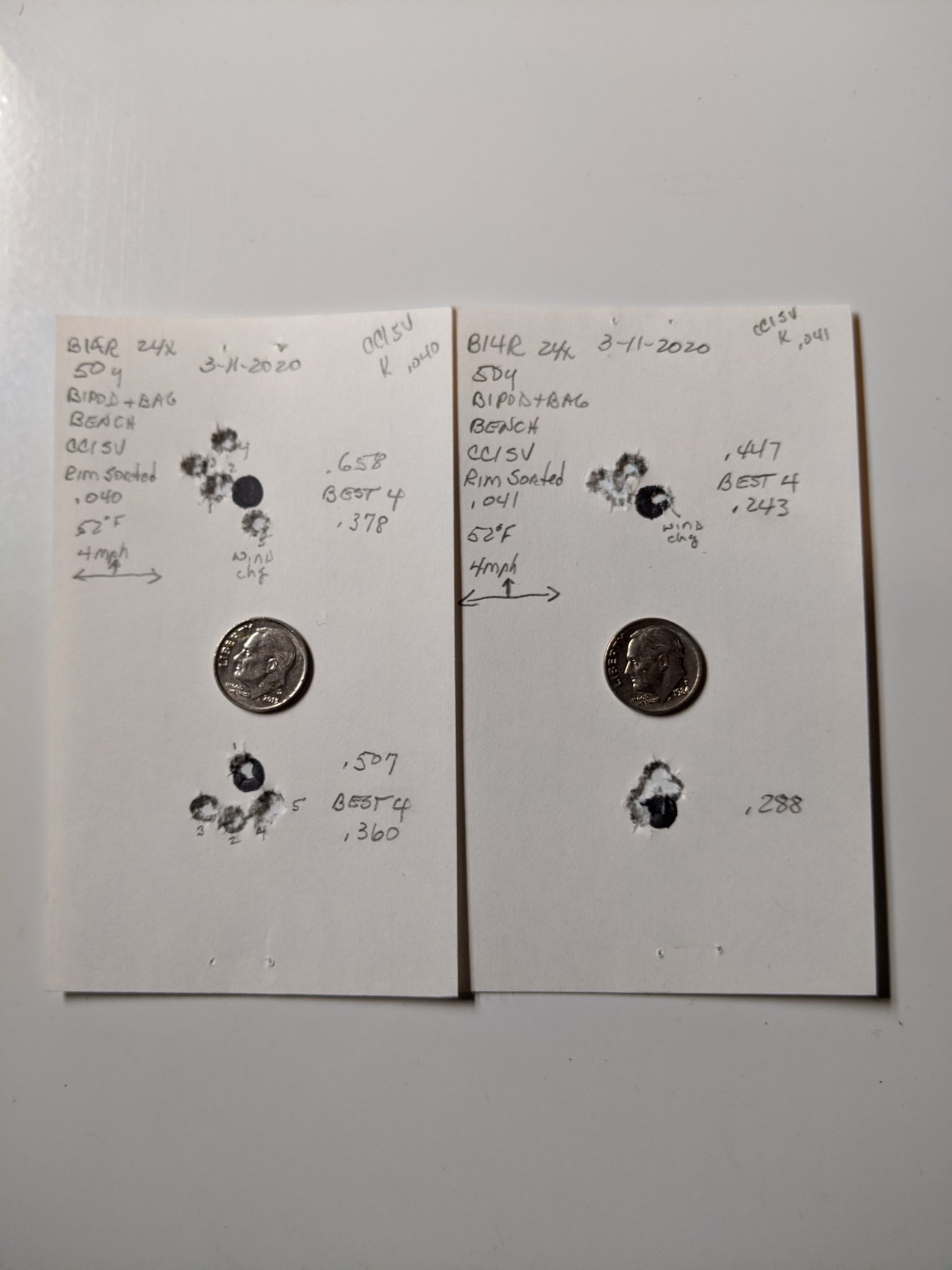

Interestingly, I shot some sorted CCI SV for rim thickness, .040" and .041" sorts. This lot only had these 2 sizes +/_ .0005" on my dial caliper. Groups are below. Make your own decision. I wasn't shooting my best today as it was overcast and was near impossible to read mirage, and the wind though light was shifting constantly with the tail wind the worst culprit. Missed a few conditions due to rapid shifts, but I think you will get the idea.

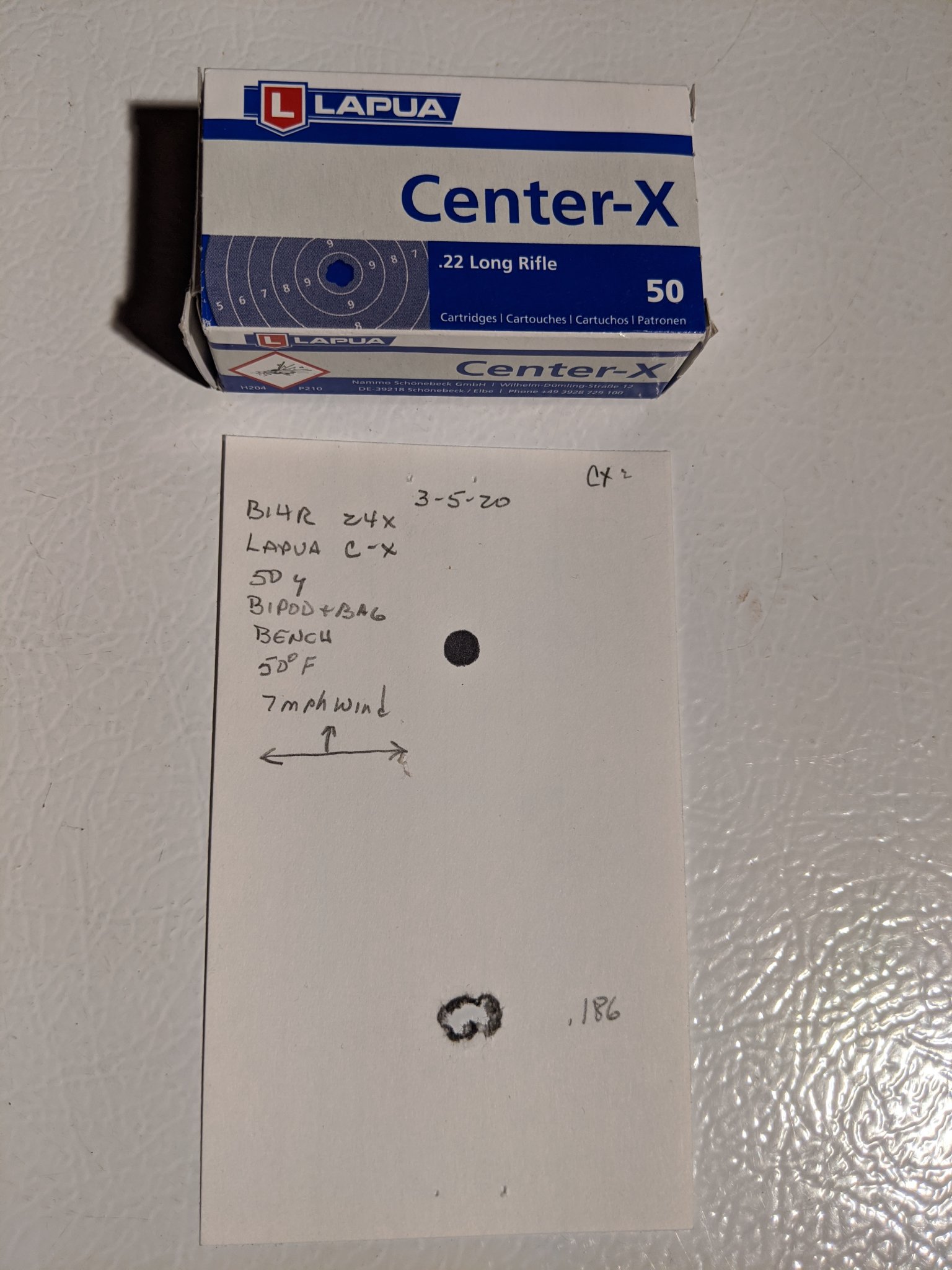

The puzzling (unexplained, to me) observation is Lapua Center-X not running well ??? My Center-X rim-thickness measurements were around .043"; maybe Center-X rims are a tad too thick (???) to seat nicely (and consistently) between the Bergara bolt and breach?
