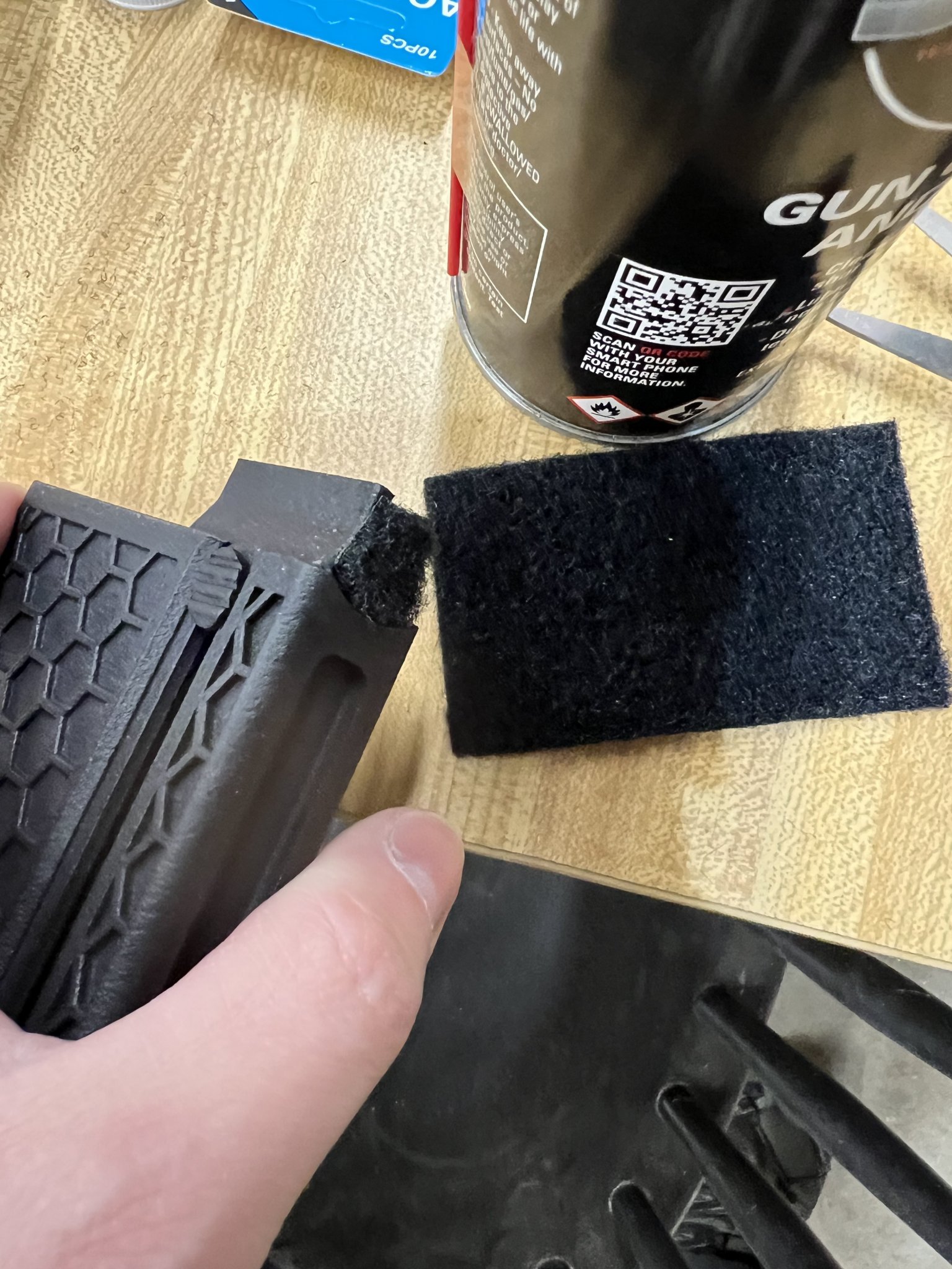

After trying l3i extensions (trash) and the l3i 14rd mag which i like and with tuning and velcro on the front works fine. I've found the best combination is a standard mag with the mkm extensions and velcro on the front of the mag works really well. And this is with a krg bravo chassis with the aluminum forend.

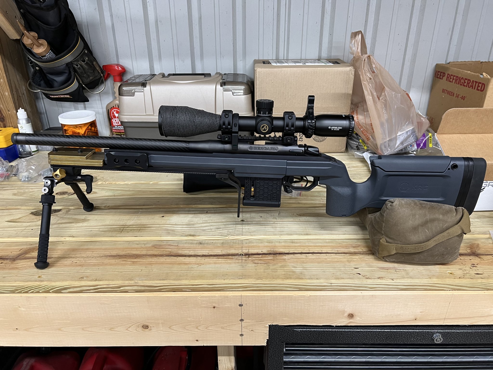

So after attempting to use my carbon barreled action with a KRG Bravo and the KRG arca rail, like everyone else I was buttstock heavy and had feeding issues. I had a spare adjustable weight Area 419 arca rail laying around so I went to work. I ordered this:
Amazon product ASIN B01F80VXJS
I turned the arca rail around backwards and found I could mount it with three MLOK attachment points. I took the rear most weight out of the Area 419 rail. After mounting the rail I cut the bar stock and attached it as shown. If I could do it over I would have cut the bar stock in half and only bolted on two pieces that stuck out closer to the end of the barrel instead of three even with the end of the arca rail. It is much better balanced now though.
I’m hoping the Gray Ops bag stop I also added fixes the feeding issues. I also added Velcro to the L3 mag and the factory mag. Not sure how much that is actually helping. I’ll find out tomorrow.

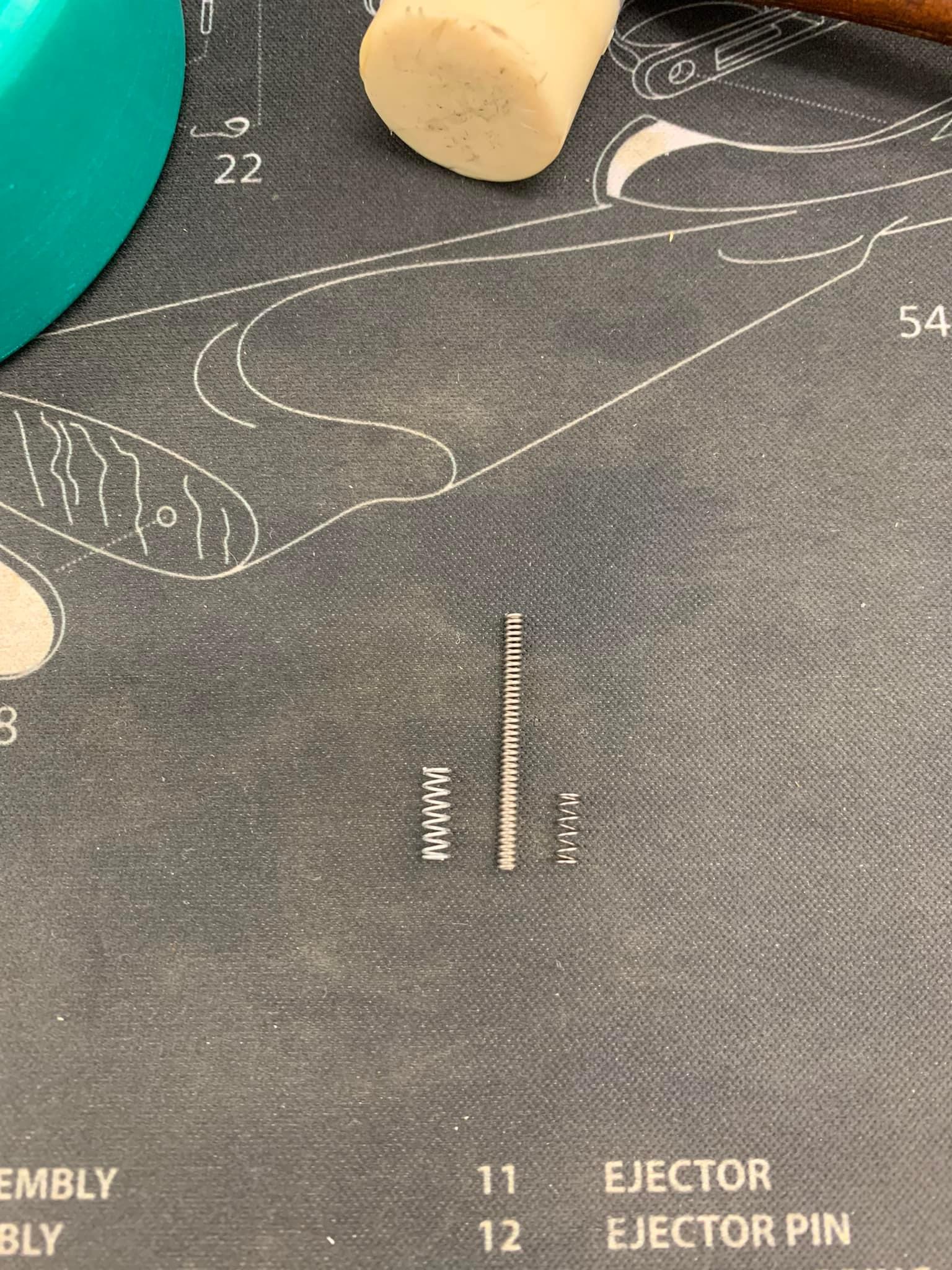

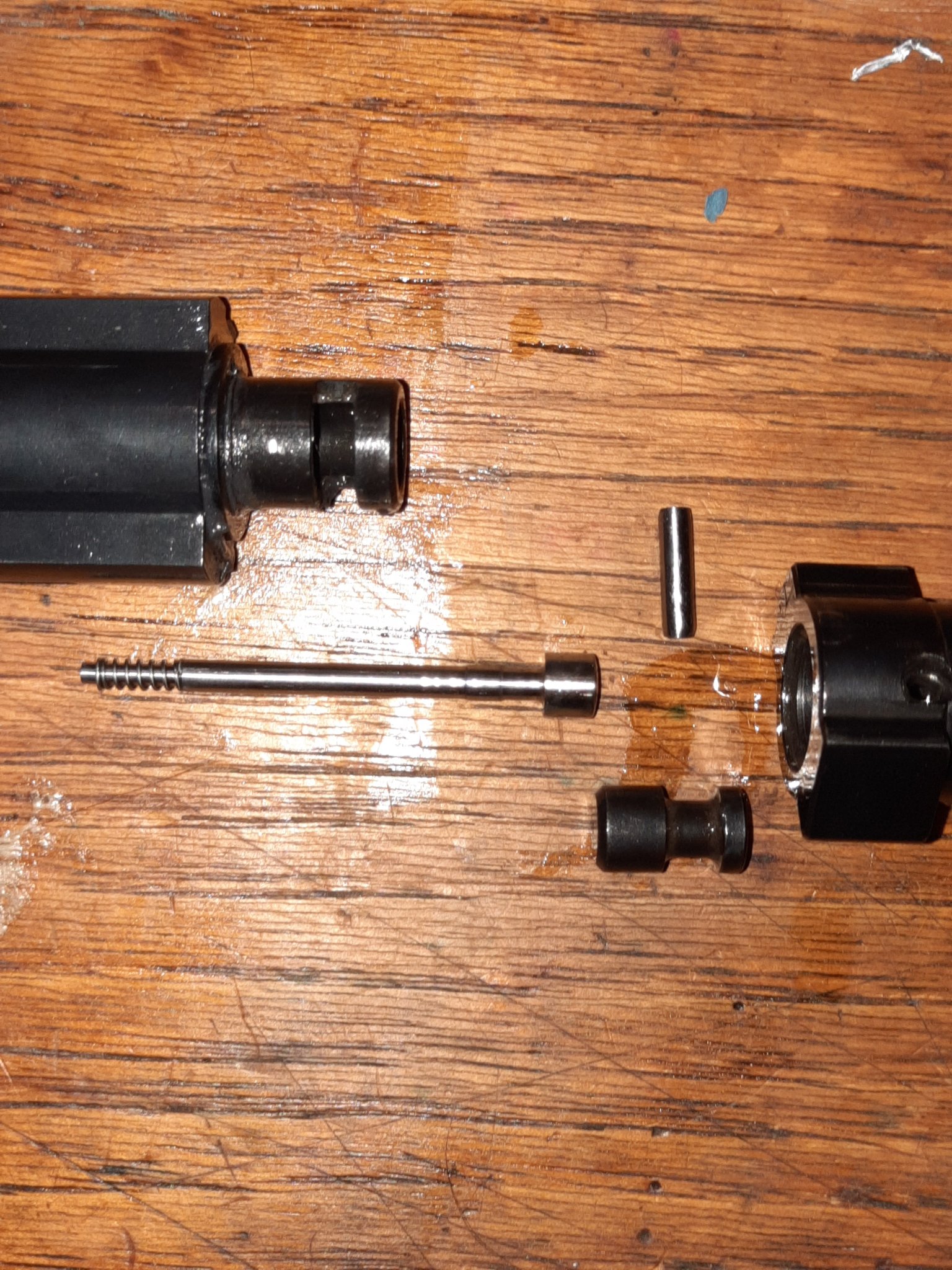

Hey guys
Found another potential solution for the weak spring under the case tensioner.
A Glock firing pin safety spring (L in photo, Detent spring middle, Stock spring R) fits nicely and ads 2-3 coils of tension and in limited testing has eliminated the empty case being released too early.
Being in the land down under, for most of us over here a Glock safety spring is far easier to get than a AR takedown detent spring.
Give it a crack and see what you think, it’s solved the issue for me in the few hundred I’ve shot since installing.
cheers
Jackson
An easier spring to find is one from a butane lighter.
It slips inside the OEM tensioner spring. Just cut to the same length as the OEM spring and install. I have done this to 4 different bolts now, all with positive results.
Reactions: Pomyluy

I used a twist tie and trigger pull gauge. Just feeling with finger pressure they are about the same. Pull gauge show both about 2 lbs. But the left a few oz lighter. I got left side exactor at 1lb 12oz. Right side extractor at 2lb 2oz. To the best of my memory all factory parts with maybe 5k rounds through the gun
Easiest fix is to install a butane lighter spring inside the original spring, cut to same length, and reinstall the tensionor (left side) on a right hand rifle looking from butt, opposite on LH model.
Problem is OEM doesn't hold case tight enough to bolt face and fall off easily. Easy way to tell is to place a fired case in the bolt held in your hand, see how little it takes to remove. Then do the spring mod and try again. Noticeable difference, case held tight enough so when finally hitting ejector imparts proper direction out the ejection port.
This also eliminates having to operate the bolt with excessive speed or muscle to eject consistently out of the port.
I have done 7 rifles this way, mine and others, all with positive results.

My B14-R is an early steel model and there are 3 springs of similar length and outside diameter, but different thickness of wire and obviously different compression weights. I swapped mine around so the lightest was on the firing pin (return spring), medium on the bolt release side (tensioner spring), and heaviest on the bolt handle side (extractor spring). This cured all of my failures to eject. I have not altered magazines, peened the ejector, or altered the gun other than dropping it into the BMP chassis and mounting a scope. 4 seasons of monthly matches on the original 2 magazines.
