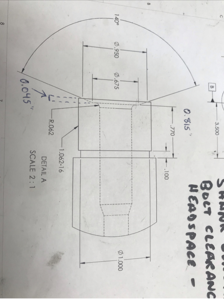

I understand there is a “cone” on the Bergara barrel from Photos looking online, that cone looks to be roughly ~0.045”?

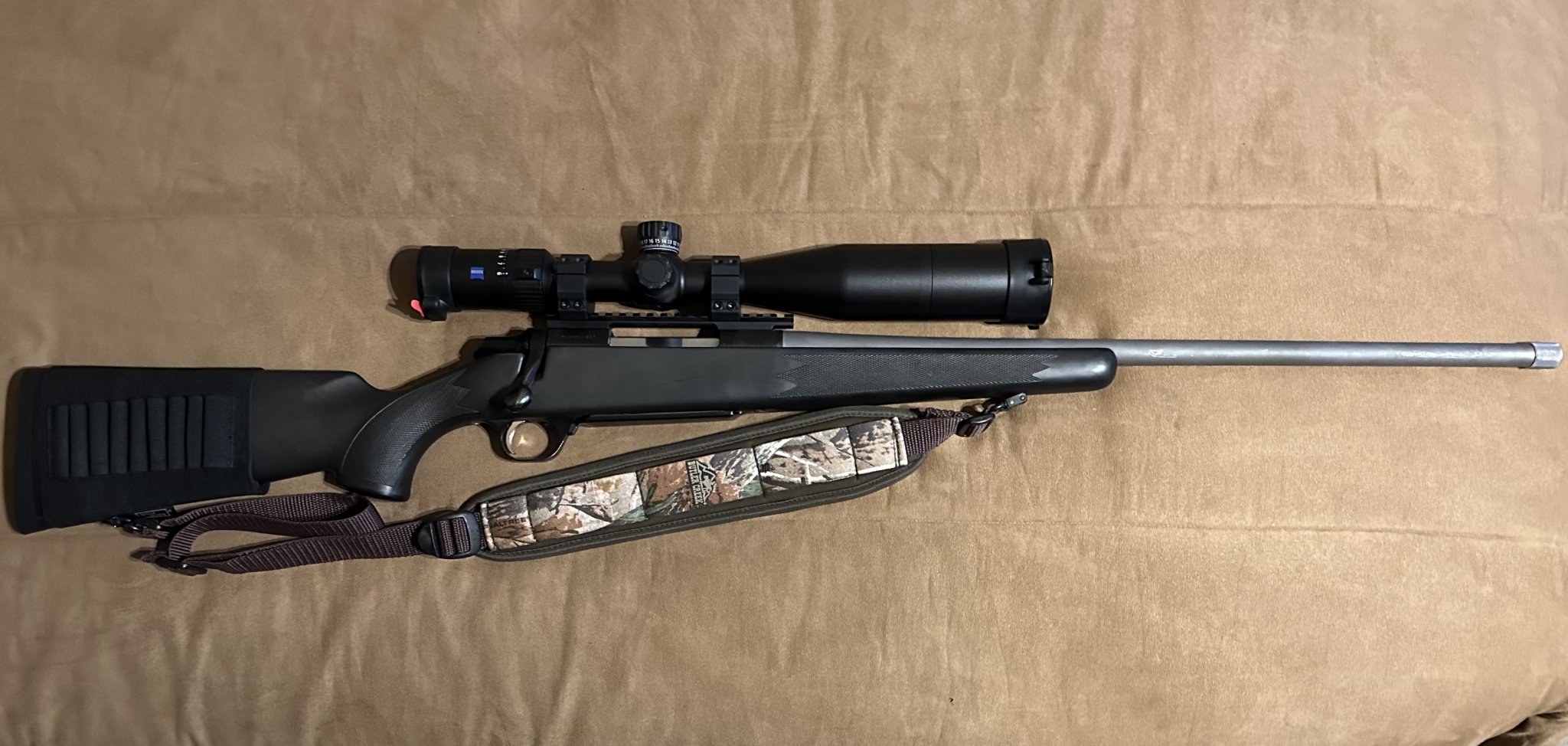

I call it “The Brownington”. Took some lathe work, but I salvaged a perfectly good (nearly brand new) barrel, and salvaged a rifle with a burned-out factory barrel. After all the work the rifle shoots 0.3xx” groups. Not bad for a hunting rifle. 😏

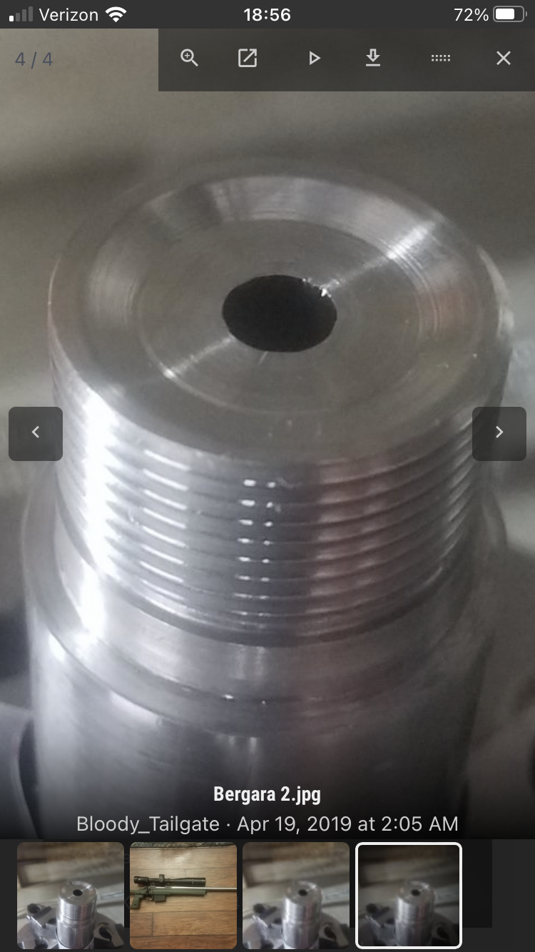

I've never studied the Bergara actions, so I have no idea what this "cone" is that you're describing. Can you post a picture of the cone so we will all be on the same page as to what you are describing?

Post #55 & post #62
Interesting design... Taper vs. the Remington lip (the "3 Rings of Steel" design as they call it). I could see where that have some advantages, but would make headspacing a bit of a bitch. So, yeah, the smith will have to cut the lip off the back of the Remington tenon anyway, to cut it flat and square, and then cut that taper cone seal into it. So, he would have to break out a reamer to rechamber the barrel anyway, so I'd have him take a few threads off the back, and then clean the chamber up with a tight-spec match quality reamer, and re-cut the recoil lug shoulder square while he's at it. It shouldn't cost any extra, he'll already have the barrel in the spindle, and have to use a reamer anyway to set headspace. So, might as well have him cut a better-than-factory chamber for it. Another thing he can do to ensure it's true, is put the factory recoil lug in a surface mill and ensure the mating surfaces are perfectly flat.
