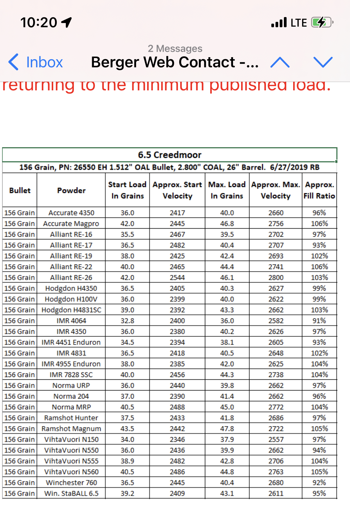

I just saw this post. Apologies. Berger’s max load data that they gave me was 39.5g RL-16. I’m only getting 2590 fps with a 22” barrel and CCI-400 primers. I’m sure it has to be my shorter barrel length. Maybe I could use magnum primers and increase the charge weight by .5 grain? Thoughts. I really want 2,700fps out of this bullet.

If you have any RL26 or similar slower burning powder give it a try. I ran RL26 with 153 Atips and got a little over 2800 but it was a warm load. I don't recall the load but think it was in the 44+ grain range. If you call berger they will give you the data. But you will need to run a slower powder with a heavier bullet to get the speed you want.
Reactions: Bunny723
Ok. I called berger. They gave all the load data for all powders on the 153.5 g bullet they had. I’ll try and get my hands on some RL 26. I could use it for other applications anyway. Thanks for the help.
