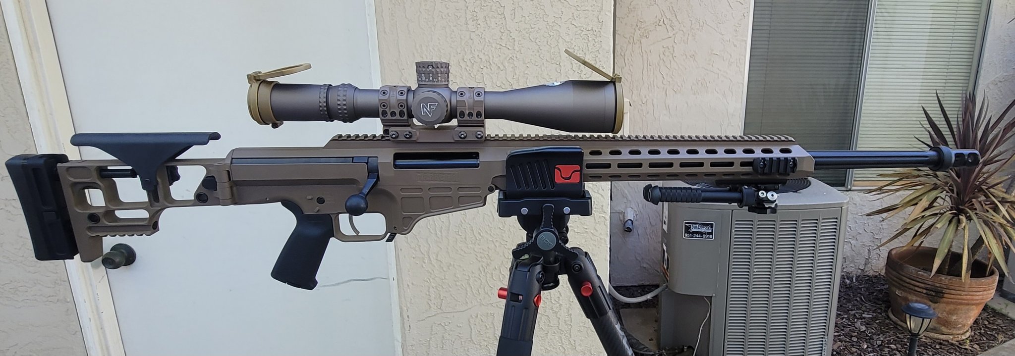

guys following this thread as I am about to upgrade my tikka t3x tac a1…..putting the tikka t3 action in a new chassis and new barrel. Been shooting 175 grn sierras and doing ok. this gun is used for PRS matches only out to 1000k. My barrel options are as such….24” MTU 1:10 rock creek cut rifled or 26” MTU 1:9 rock creek button rifled. Of those two given I will stay with the 175grn and maybe give the 185 jugs a try , which barrel would you suggest?
Id go with a 10 twist too
Wow good call on the tactical division limit of 178grn….i missed that.
So losing 2” of barrel not a big issue to any of you? Currently running the factory barrel 24” 1:11 twist and getting 2715 ish with 43.6 of N140 , 175 sierras
obviously with the new barrel i am starting all over again with loads. Going to start with 175 berger OTM & Sierra 175

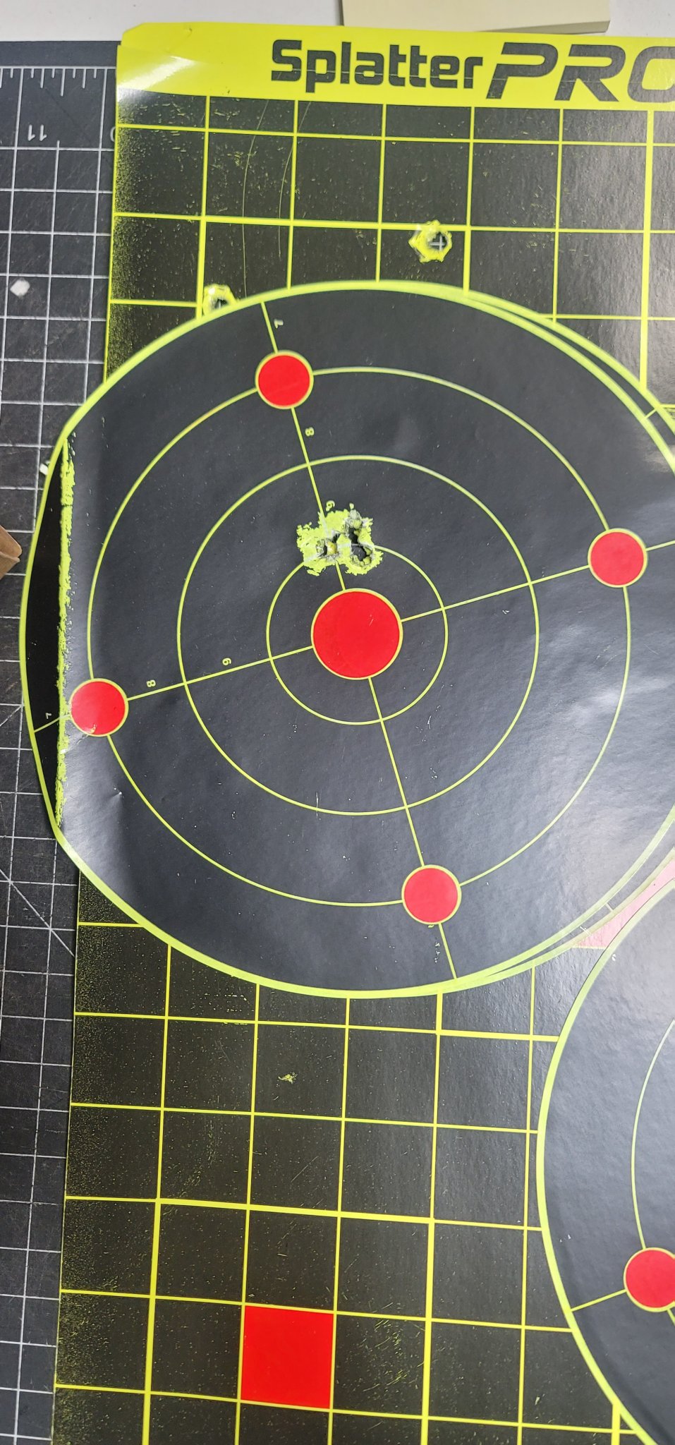

Finally got a load worked out. Got a chrono and that let me know that my speed was good enough. Thank goodness
That's a 3 shoot group of 308 at 100yds

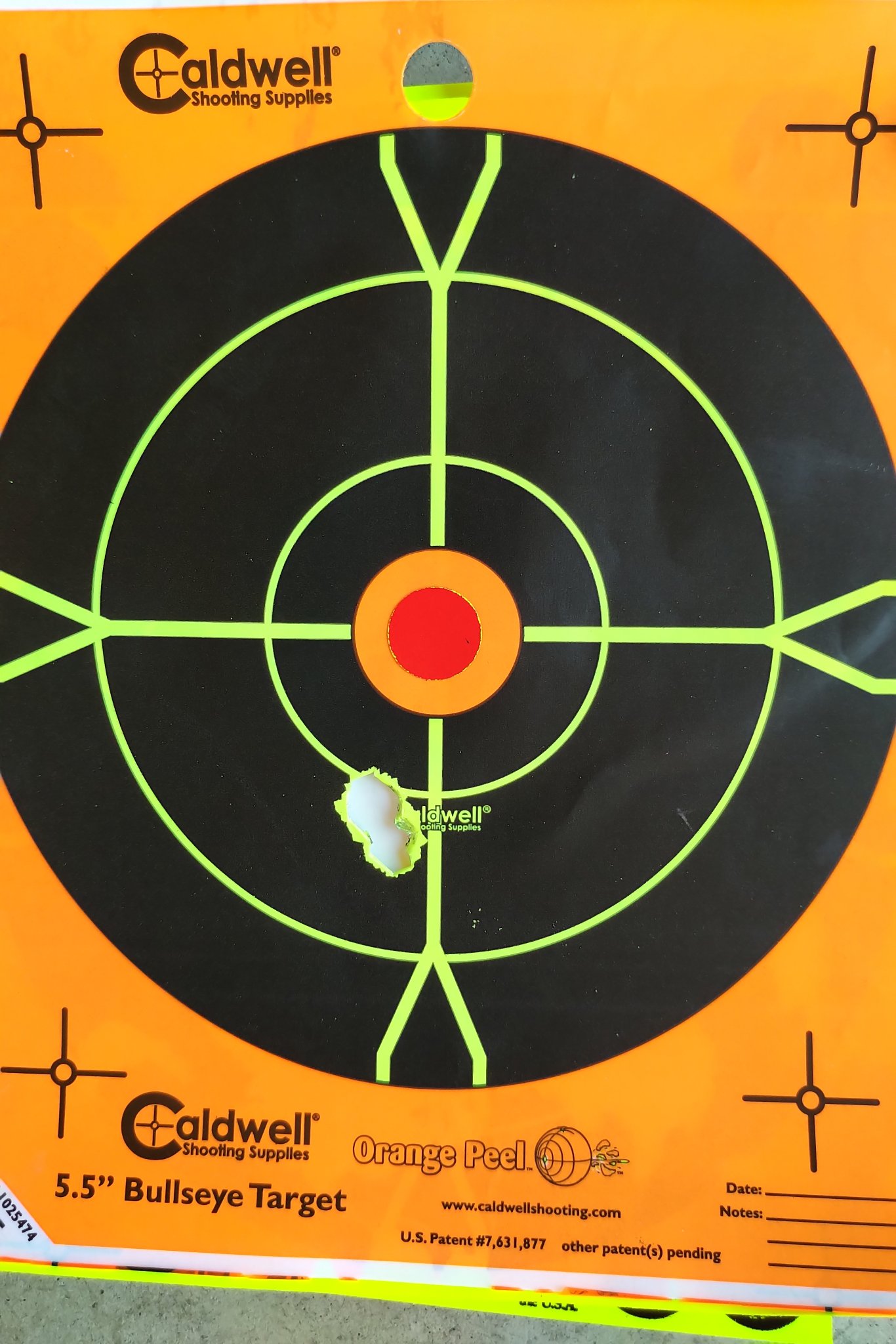

Well since that was 2-1/2 years ago, it was definitely me. My little man does well but he isn't able to do that just yet. Which scope is that you're talking about?
Just busting your chops. Seriously, nice shooting! Never tried the 185's. Only used the 175 SMK and 178 ELD-X. Tried the Warner Tool 160gr but just could not get any accuracy out of them. I think it was a 1-6 USO for your son.

I'm sure that was a 175smk that did that group. Those things shoot great but if these new tipped ones Frank is talking about shoots that well I may switch to those. Tmk just don't shoot as well
