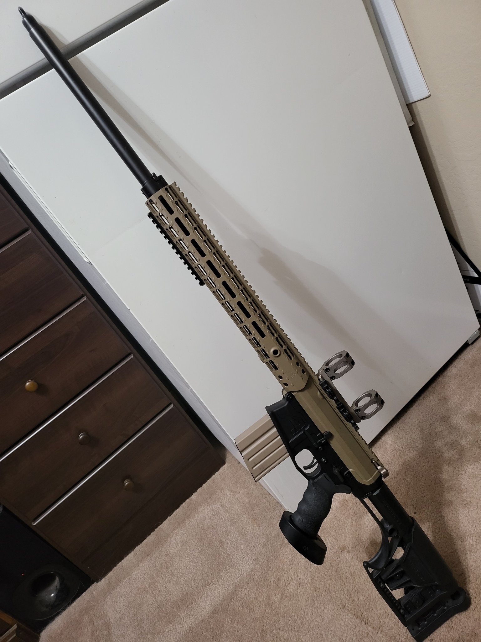

I just picked up my AR10 barrel yesterday. Chambered in 7mm Sherman Short Tactical, 27" long heavy profile, 1:8 twist. Built on an Aero Precision M5 enhanced builders set.
I still have to save up for glass but will hopefully run over the chronograph next weekend at least. Time will tell on how it performs out to a mile or more.
Reactions: Northman623
BCG is from KAK. I had Mostek make the barrel for me here in Mesa, AZ. Very good people to work with.

Both upper and lower are Aero Precision, 27" heavy profile barrel, adjustable .930 gas block. I'm planning on running 180gr ELDMs at least to start off with since that's what I'm running in my 7mm Rem mag.
It will be a little while before I can get glass so can't really work up a load yet but will hopefully run a few rounds over the chronograph this weekend.
