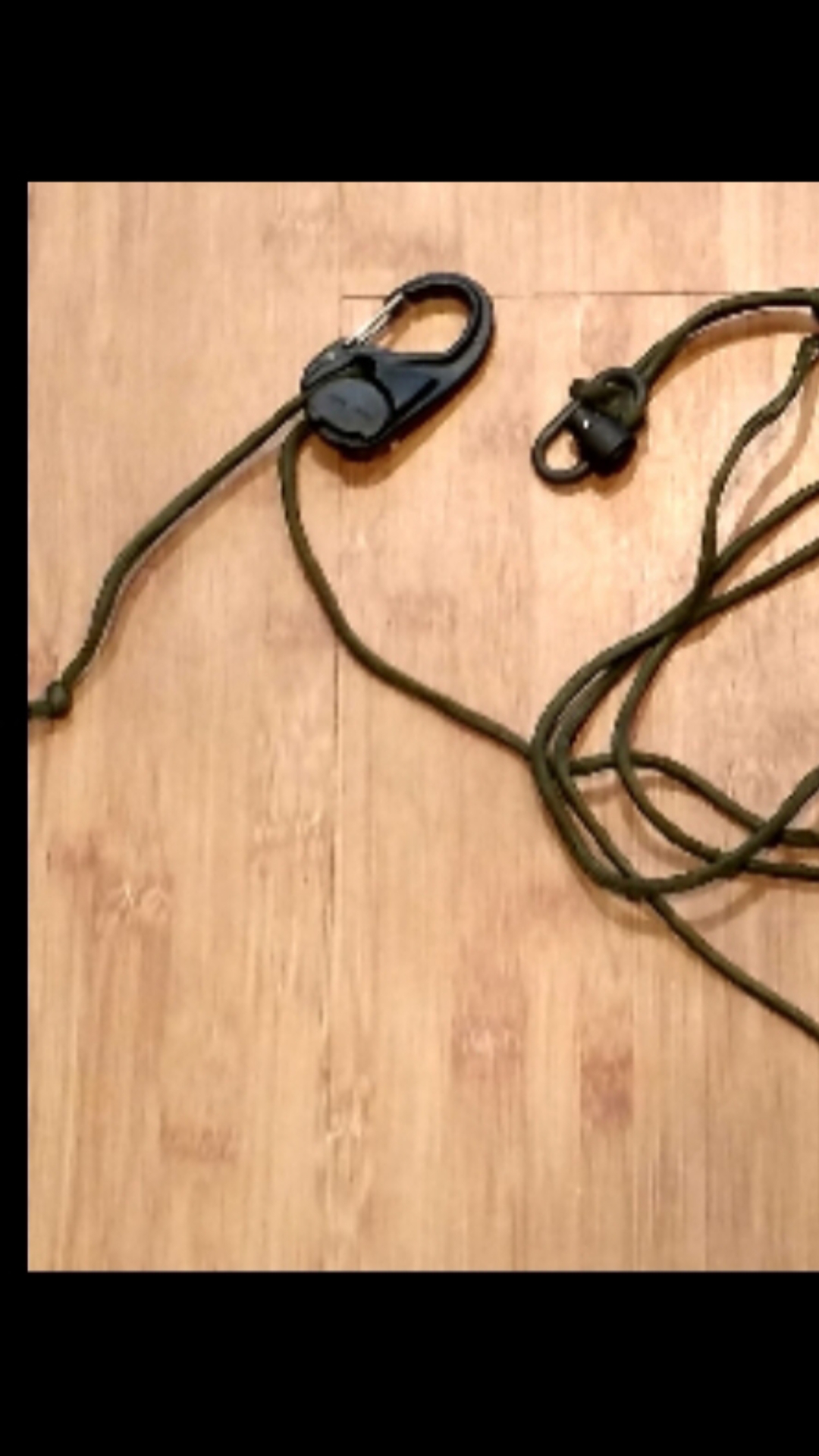

I’m not sure what you guys mean by a camloc. Can someone post a link to one?
Thanks
Steve

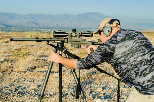

Working on link, but tent rope friction. lock might be more appropriate than camloc.
Satellite reception sucking real bad right now, can't get pages up.
Go back up to MarkCO's pic post and his is pictured.
SLG - I like that a little better than the one I found.

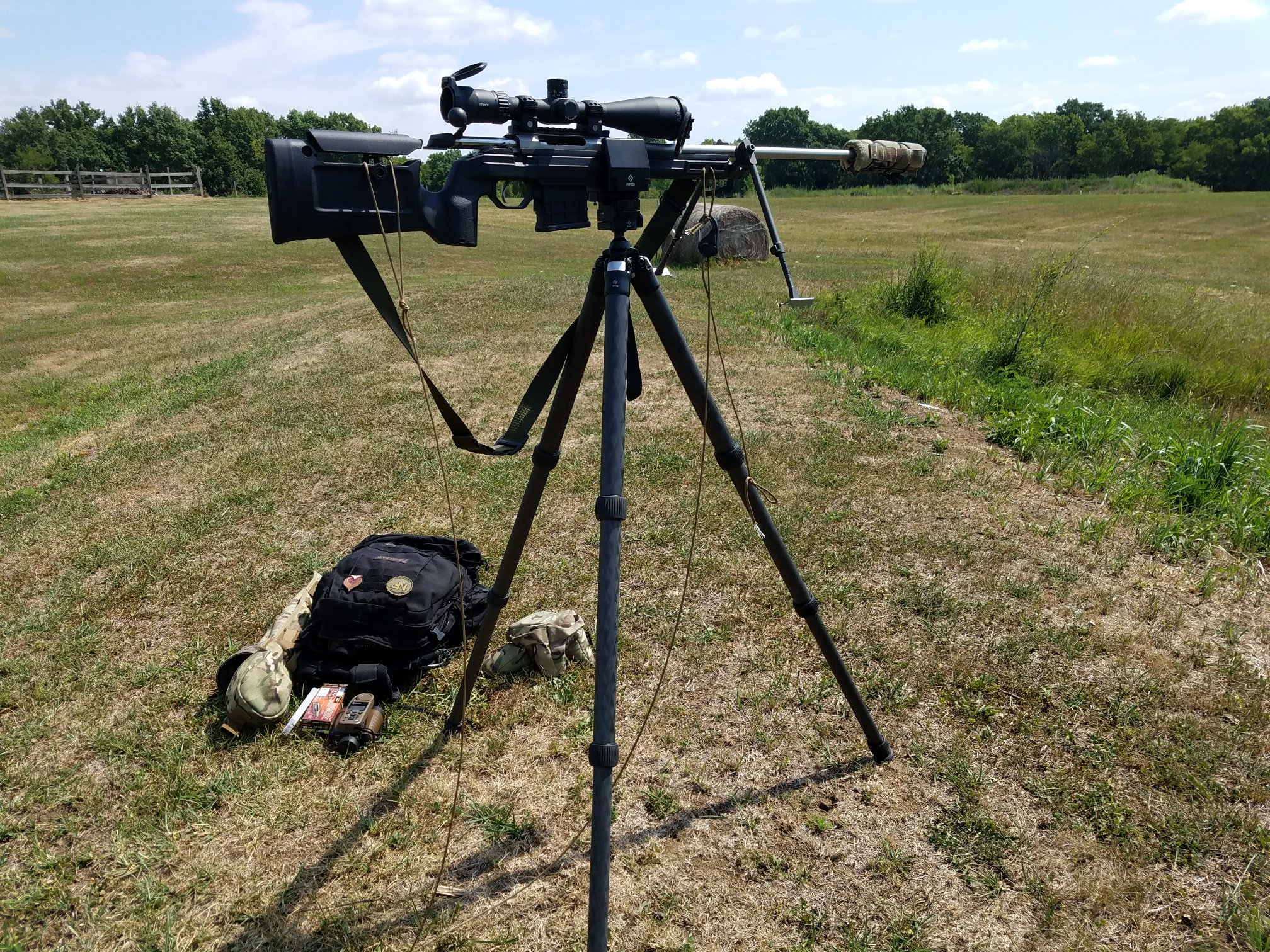

Would it help to have a second one of these to use to hang a pack from the bottom of the tripod? I'm thinking with something like this you could put tension on the pod without supporting all of the weight, or having the pack hanging completely in the air swinging in the wind.
For that matter, maybe even run the cord to the rifle under the pack? It would keep the tension centered under the tripod. Using your foot as an anchor is going to slightly pull the tension to the rear. Just guessing here, haven't tried any of this yet. First I need a better tripod....
It may help, but I prefer to shoot without a weight hanging from the tripod. Pros and cons to everything.
Weights hanging take longer to set up and take down, and can be pita to carry when not essential.
The cord and camloc is fast to engage, easy to carry, and has other uses.
Reduces training time with camloc, and gives you more mental freedom to concentrate on making the shots.
Each method has benefits, some better suited to your needs than others.

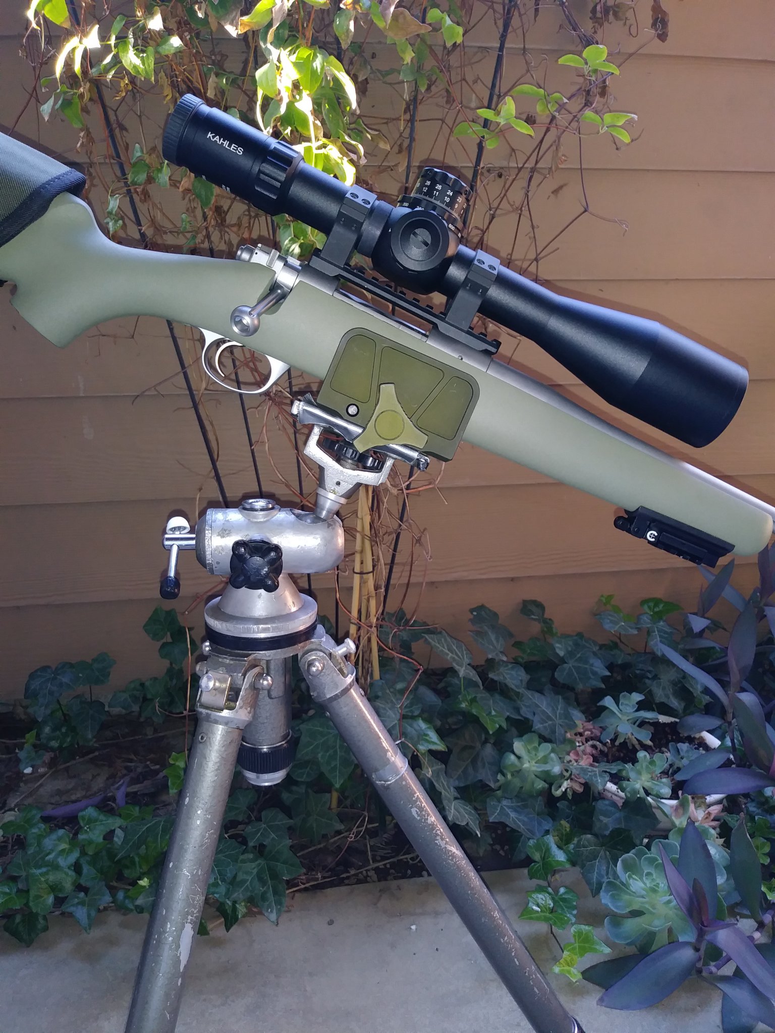

Also, my work gun is being reworked right now, and it has a rail on the bottom. My substitute gun needs the Vyce. Once I go back to the main gun, things may change a bit since I won't be using the Vyce anymore. Most of my practice with the cam loc method is using personal guns, but in the Vyce.

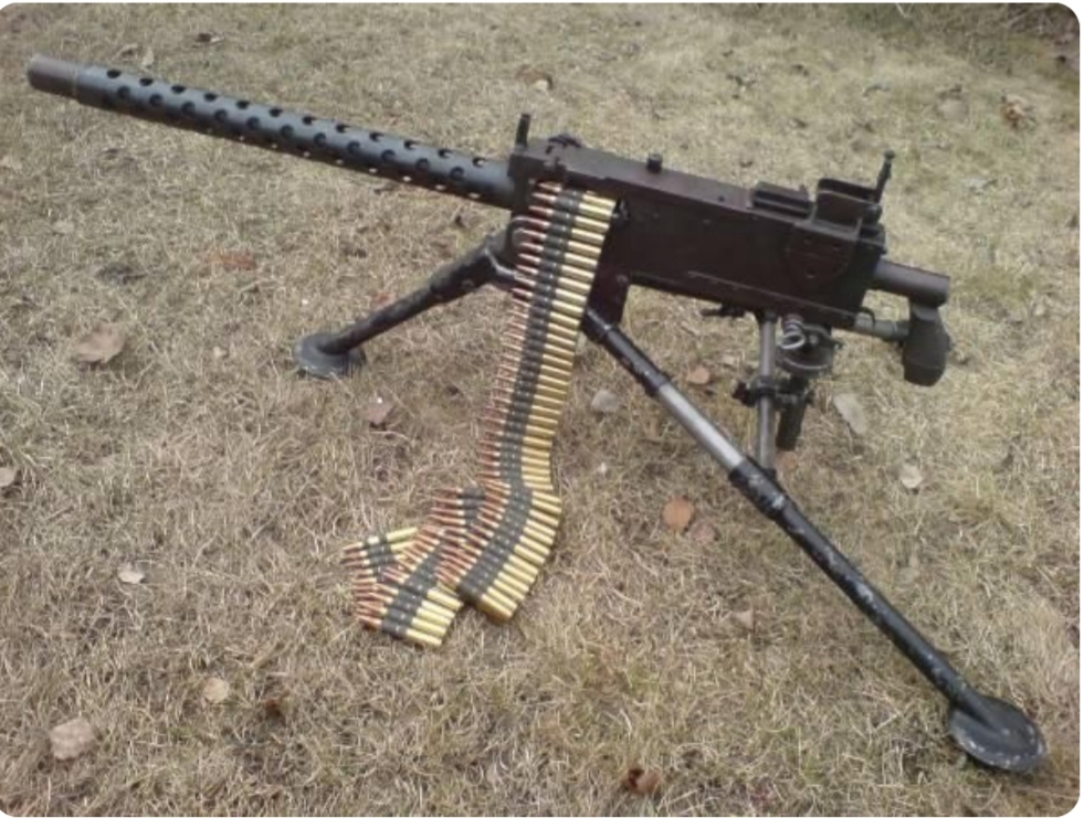

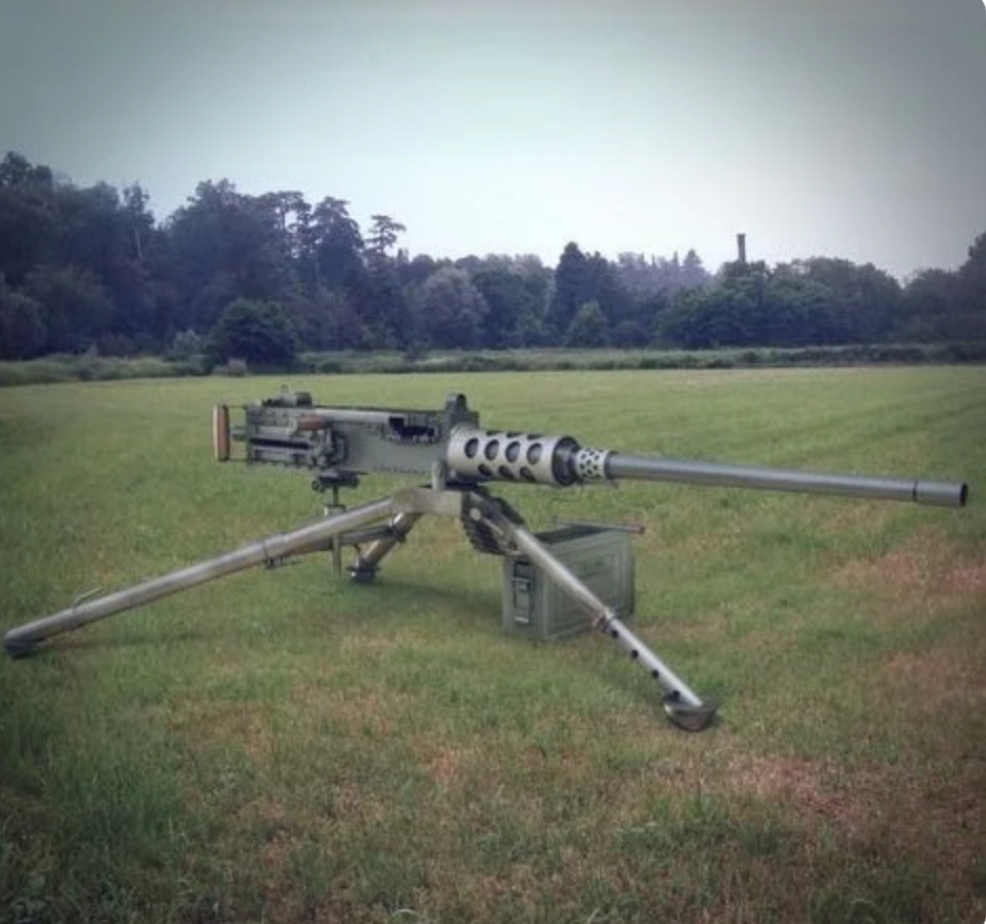

The heavier the tripod, the more support it offers.
A long time ago, ma deuce had to have sandbags on the feet to secure her, for consistent repeatable results.
Otherwise md skittered on top of the surface and moved around.
And sometimes md dug in deeper in loose dirt. This was way less of a problem than skitter movement, but a problem nonetheless.

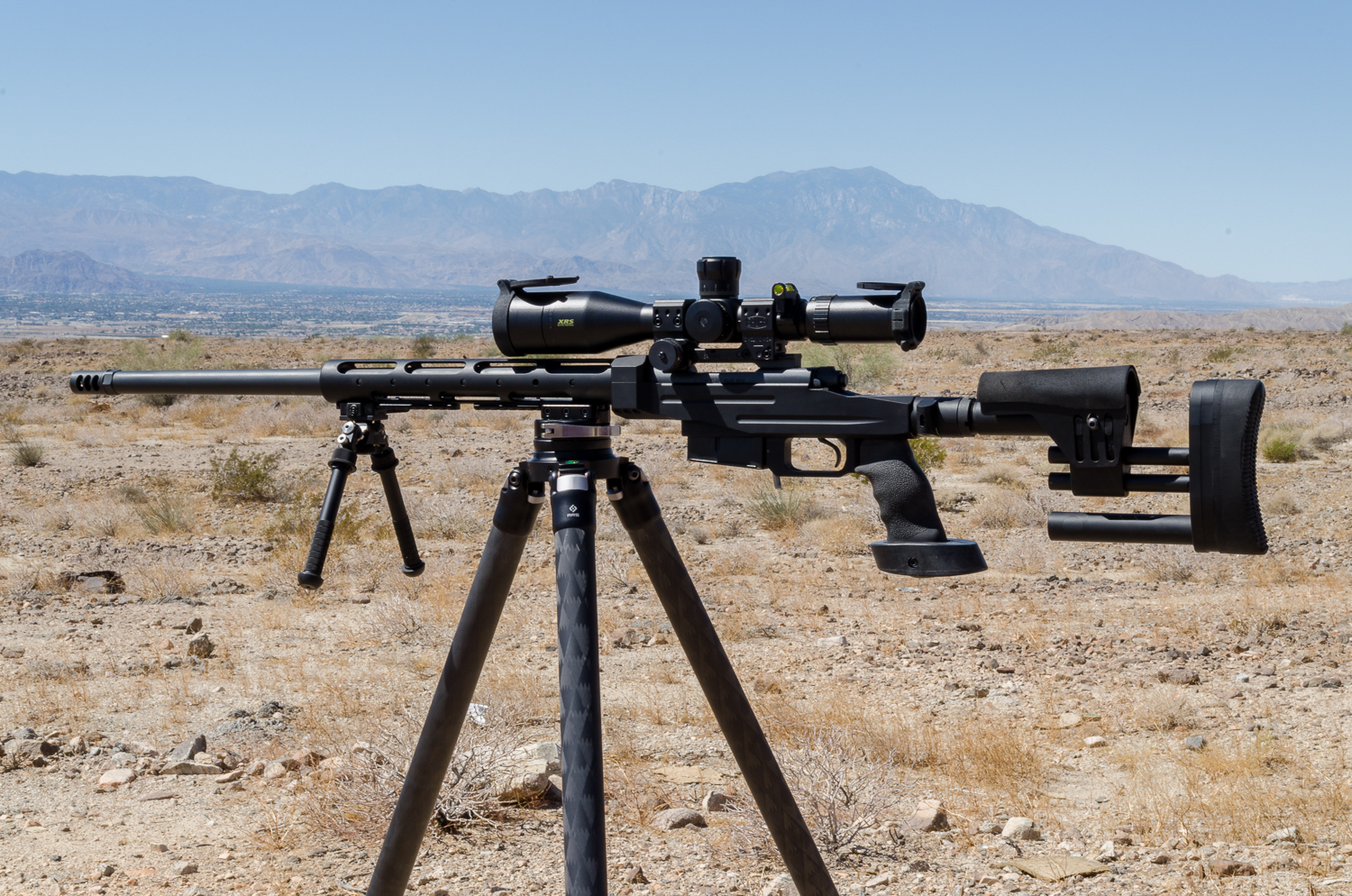

All of this can be avoided if you put the rifle in its NPOA on tgt via the tripod and use FR. F-open guys use FR via their front supports. FR is just another name for mechanical natural point of aim.[/QUOTE said:
Are you able to get the reticle exactly on target (say 1 MOA) via tripod? I have a RRS tripod with Anvil-30 and I get the crosshairs on the target but when i tighten the clamp it always seems to move it off a little and I have to “muscle “ it back on to Target.

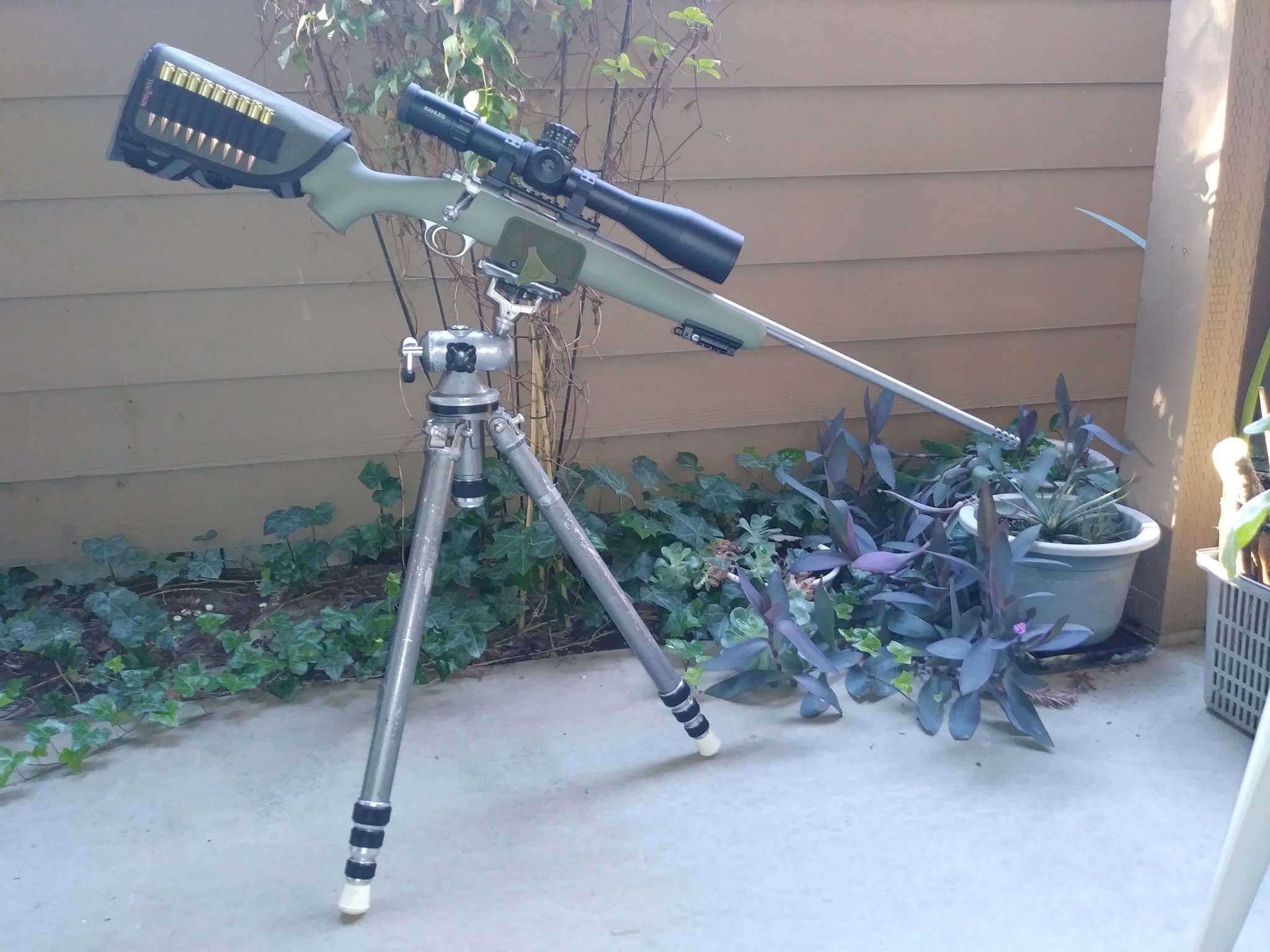

There is is, pic of carbine with 1-legged stick ...
Just a beginner, my assumption is that variations of my shots will most likely be me varying my fundamentals.
The comments of J-Huskey ring true for me. Simplicity in gear and building fundamentals is priority-one for me.
That said, I've started with a fine rifle, match ammunition, extraordinary optics, an adequate set of arms connected to a body that knows the stillness of a monastic order and a planet earth that occasionally throws surprises to any of us.
Some added gear allows me flexibility in odd conditions....if I happen to want to lug the extra stuff into back-country where I am happiest hiking off-trail and not using a 4-wheeler transport.
An already-owned tripod allows me extra stability if standing is a necessity in the prairies where bracing against a tree or rock outcrop is a figment of the imagination. The prairie states and provinces would benefit by a Johnny Appleseed of oak and ash trees. Such a Johnny of Oaks has not yet done much in the Great Plains wildlands. Having grown-up in the Tall Bluestem Prairies where grasslands can force my short stature (5" 6") into a standing position, my tripod and cradling device is only a once-in-a-while necessity.
Having mastered ultra-close-up photography, microscopic imagery and telescopic viewing of the stars I have a significant Gitzo Ultra-low & High tripod with their ball-head capable of holding 1000mm lenses and solid brass camera bodies steady in the unceasing winds of the Dakotas (all-seasons). The ball-head is capable of measured rotation 360 degrees and simultaneous articulation of the ball joint to permit zenith and nadir aim of a camera or rifle. The Ultra-Low & High tripod permits lens or barrel placement in rock-solid alignment at 3 inches above ground or 78+ inches above (using the taller center post that can be switched under the ball-head). I'm too short to fully use the tallest tripod height extension.
Atop the Gitzo ball-head is the Hog Saddle for nesting the rifle fore-end (used primarily for sharing the rifle-shooting experience with a few friends unable to squat, crouch, get in the dirt or use the David Tubb asymmetrical bipod for the easiest acquisition of my Natural Point Of Aim). While my bipod is capable of aligning in a sitting position for shooting, it is not one I prefer.
With all the extraordinary wisdom, advice and experiments you all mention in this forum, I am certain to try new skills that are proven in your many years of filed-smarts.
Targets at 200 are .75 inch pattern of three on and next to the centerpoint.
Thankful for your insights,
Stephen
Reactions: wigwamitus

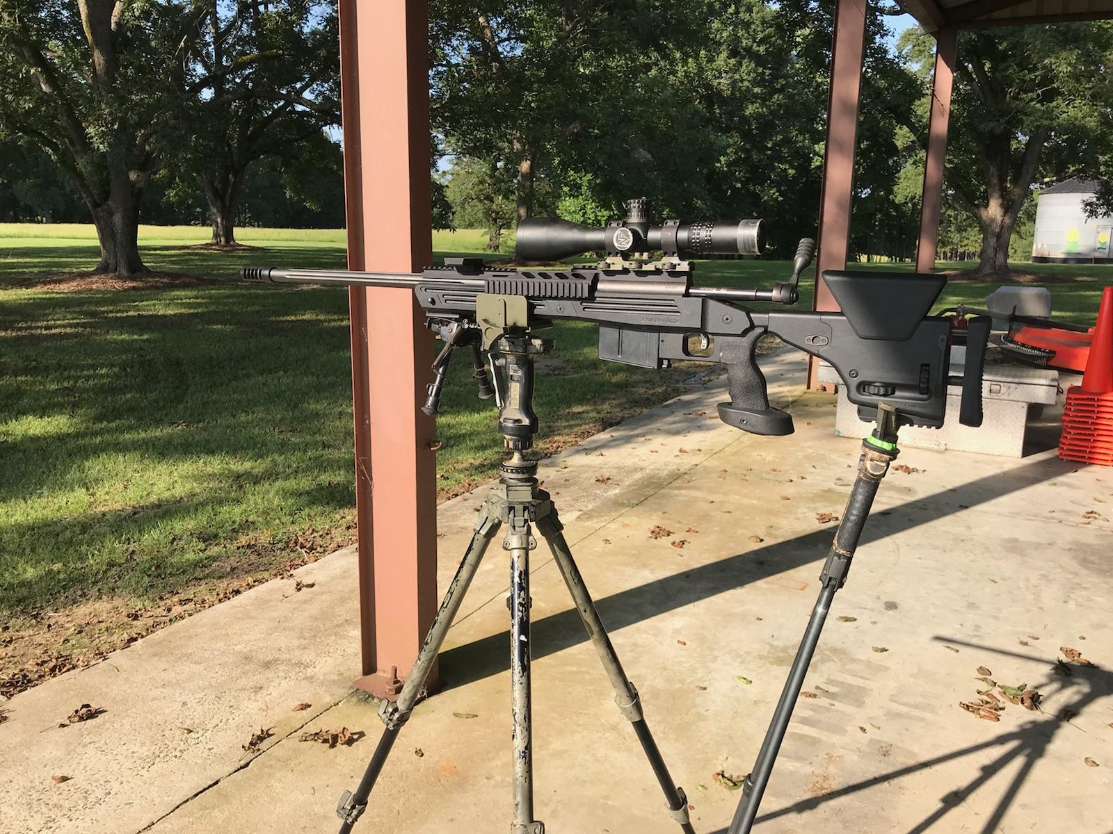

So just another data point for you. I went through this whole tripod exercise and invested in an RRS setup with leveling base.
Here's a pic with my Custom FN SPR sitting on top of it:
I'm a pretty consistent .4-.5 moa with my setup over a bipod/bag with occasional .1 - .3s every now & again. I wanted to quantify the accuracy difference between this & a tripod setup so I shot back to back 5 shot groups at 300 yards. This was the first time I ever tried off the tripod
Here's the bipod/bag results at 300 yards- 1.125" (.375 moa) A touch better than my overall average:
And the tripod results in the standing position:
So came in at 4.75" or 1.5 moa. Naturally didn't feel as secure as the prone bipod/bag position.
I reached out to the Hide and got a lot of great suggestions. Diver160651 was really helpful.
After much experimentation and practice, here is what found works for me:
Turning tripod around with two legs facing forward instead of towards me. Gripping front leg
Bottom legs retracted halfway (me leaning over more & driving the rifle)
RRS claw feet to give added bite into ground
TAB PRS sling attached to rifle & carabiner off my belt & cinched up tight. This really helped with stability.
Here is how it looks:
Improved dramatically and consistent sub moa. I did notice that it is much harder to maintain consistency vs a bipod/bag, but here is one test I shot at 200 yards back to back: (1 inch dots)
I do notice that I get a slight shift to the left with my zero, probably due to sling & hand pulling it off slightly. I will usually adjust for it .1 mil when I am setup on my sling. I would say I probably average .75 moa with groups ranging from some occasional lucky .5s to 1 moa.
Mind you this is with a .308, so might be a little easier with 6.5s or 6s.
Hope that helps!
