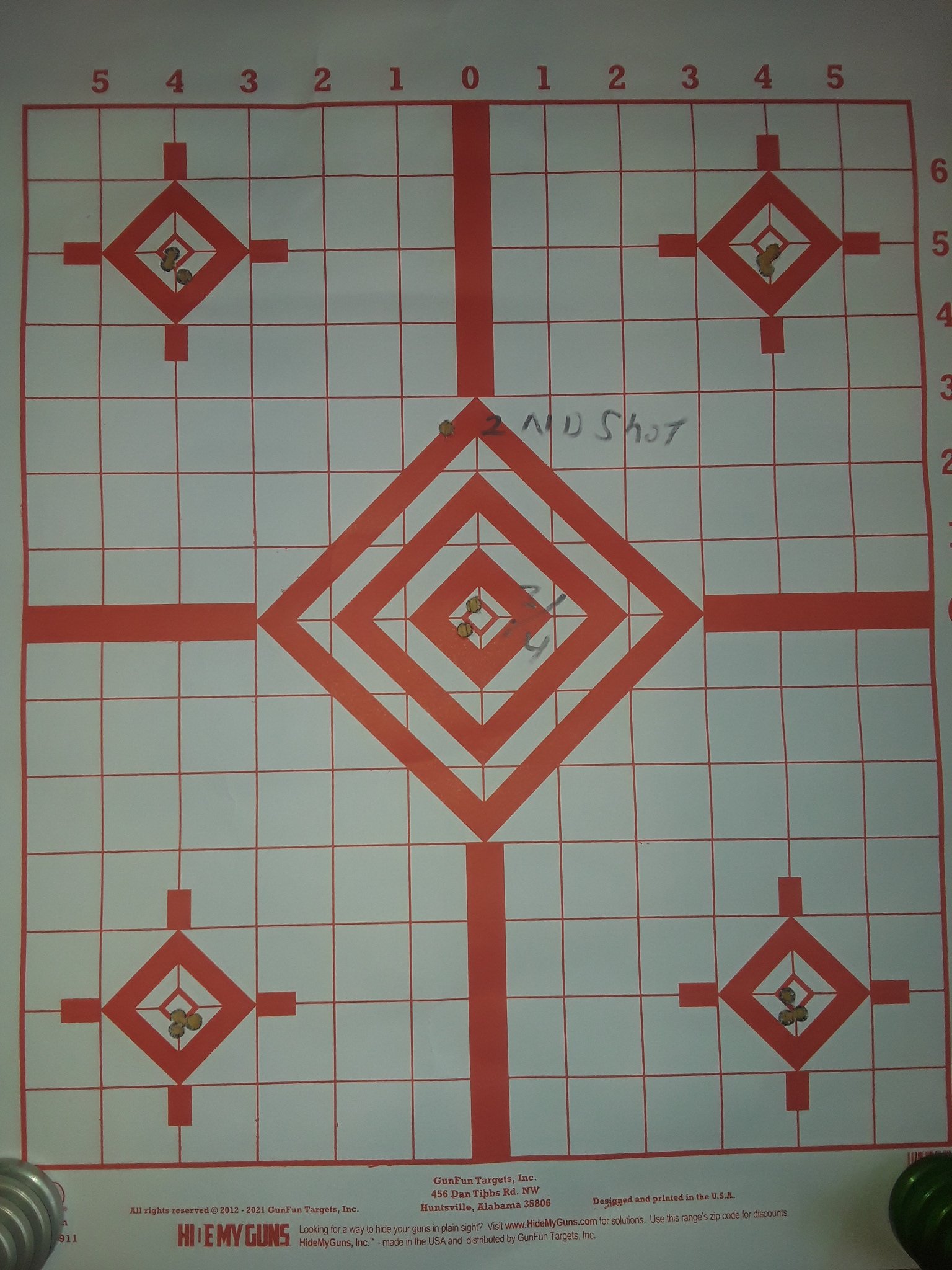

Guys the Dillon is not holding most of you back.
Todays shots.
No groups just sighting in and verify settings. This ammo 52g speer in sorted range brass over cfe223 is a good plinker. Due to high winds this is a 50 yard target.
Powder dropped with dillon dispensor.
Point is Dillon is gtg in my opinion.
My 20 inch ar identifies as a bolt gun, only quicker.
First shot off paper, second shot 2 1/2 high. All in all I think up one click and set it or down one and call it set for 100 zero.

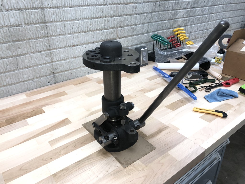

Has anyone taken the creedmore upgrade kit for the T7 and trimmed the center bushing so that you can tighten it up at each station like the zero press and seen if it makes a difference
Not on the T7 but I've done that on my Lyman turret press, which is basically the same press just with 8 instead of 7 spots. It was easy and worked extremely well. Zero slop but it moves very well. You just have to go slow amd test fit it a lot to make sure you don't go too far. I used 1500 grit on my loading bench table top. It sure what you mean about tightening each station but doing that removed the tiny bit of slop that was in the press from the factory.
Reactions: cro789
I guess I don't get why the T7 needs to be "improved" ... it's a great performer for me. Looked at the Creedmore upgrade and ultimately had to answer the question "Why?" ... and couldn't figure out a good reason. I use my single Big Boss for all my sizing dies (using the Hornady lock-n-load bushings), and keep all of my seating dies for 300-BLK, 6.5-CM, 300-WM, 300-PRC and 300-NM ... in the T7. Works great, at least for me.
Becuase there is deflection in the machine, which can not only size your brass off center, but could seat a bullet in a non concentric manner.
Really not that hard to understand. Even with a machine less than 1K cycles on it, you can feel the flex when you size/seat.

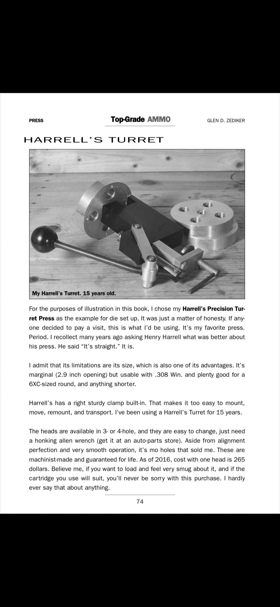

Harrells makes great stuff for a very decent price, IMO.
If he ever brought his website and marketing into the 21st century, then I believe more people would be calling out his stuff with compliments.
I have one of his muzzle brakes on a Rem 700 .308 (mostly for eastern whitetail). It works great and is stupid cheap compared to stuff we buy from the more "tactical" vendors.
I think he's more well known among the BR crowd.
Interesting ... I'm not seeing any of that, and getting single-digit SD's and tight groups from everything I'm seating with my T7 (except 300-BLK of course. Measuring concentricity on both the loaded neck and bullet, and seeing nothing worthy of concern (always less than 2000ths, usually less than 1000th) wrt concentricity.
As am I, but it doesn't mean that its not still there and you can actually feel it when you use the press.
Who knows how much accuracy is left on the table if any?
There would not be a product to remedy this if there was no issue.

Turret is still faster. I am making really good ammo on one and being able to size and mandrel a piece in 5 seconds is really nice. You are touching the brass half as much than a single stage.
Yeah, I have to agree. My turret press have zero slop at all after I carefully sanded down the bushing. I make very very good ammo on it and I can keep everything on the turret and not have to change dies. I do like the Forrester co-ax but for maximizing space and speed ect, it's very hard to beat a good turret
