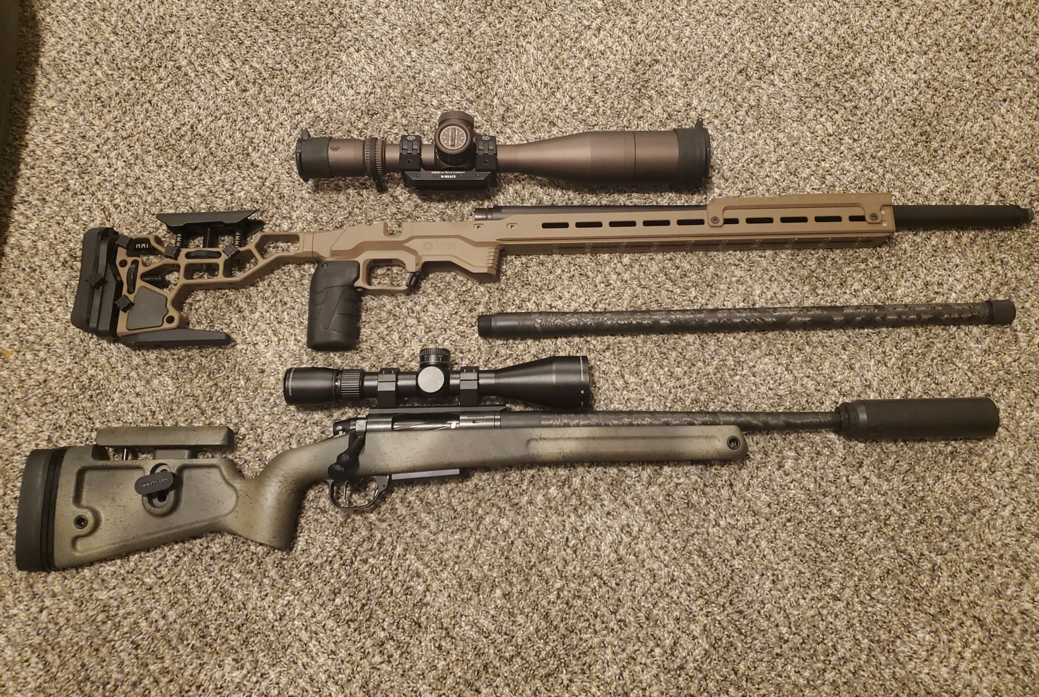

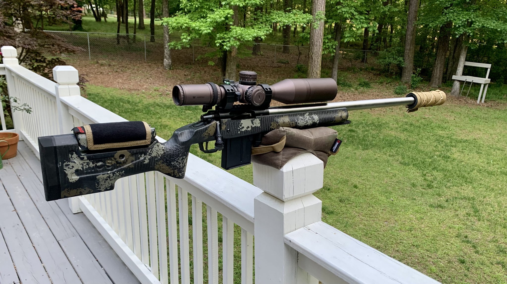

Bighorn Origin Build Thread
Big Horn Origin .223 Rem
- 26” Proof prefit 1:7 twist
- 2 stage Triggertech Special
- Manners T4A team elite - swamp
- Area 419 14” Arca rail
- Vortex Razor gen 2 - 4.5-27x56
- Vortex PMR rings - 1.1”
- Acurracy 1st scope level
- mischief machine throw lever
- MDT .223 mag
- DeadAir Sandman-S
- Rifles Only MAD suppressor cover

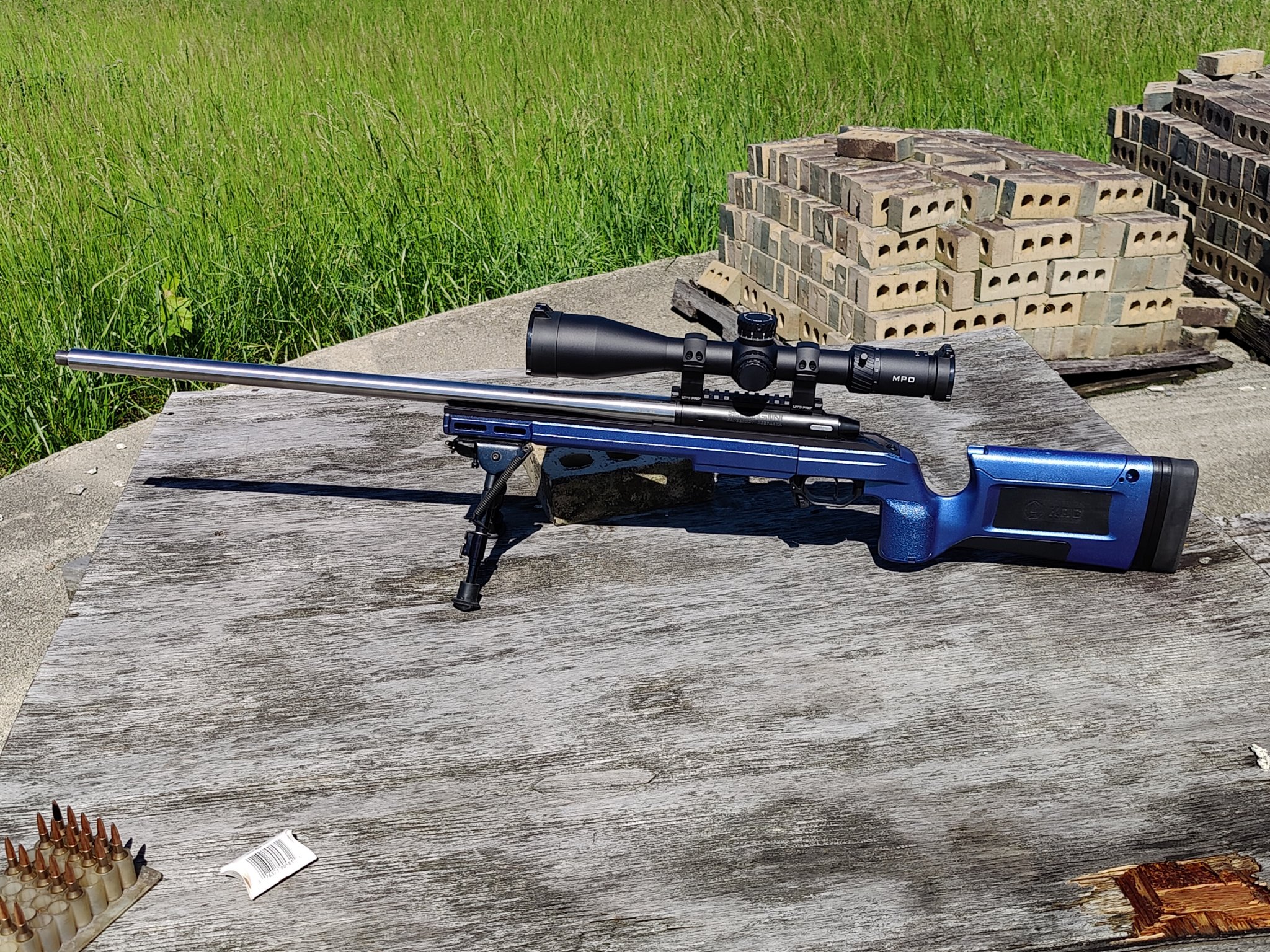

Just put the first 15 or so rounds through this one today. It took 3 shots to sight in, 2 at 25 then 1 at 100. Then just some random loads with factory 2nd 212gr ELDX and Ramshot Magnum powder to run through the Proof barrel break-in instructions, but it shoots better than me already.

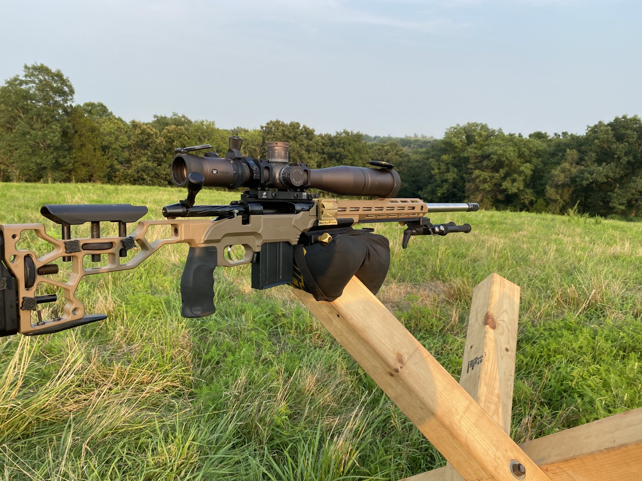

Zermatt TL3 18" 22 Creed with a 7 twist
Right now I'm testing 69 TGKs for predators, but will likely consider 80-90gr bullets later on.
Trigger Tech Diamond and the Oneill Ops 224 VAPR suppressor for this one and pretty much everything else should be outlined in the picture.

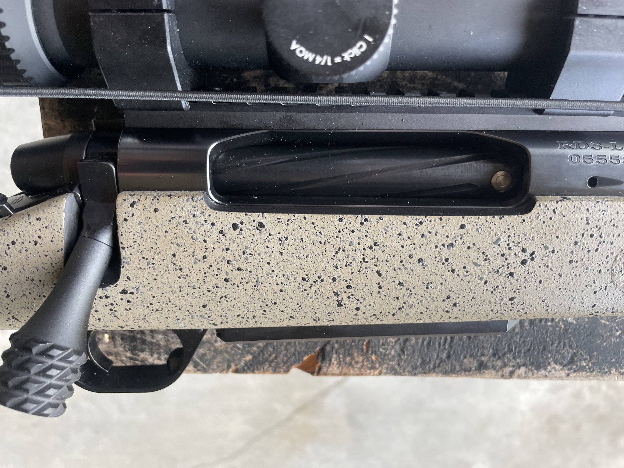

Has anyone tried doing a 277 Fury build in an Origin Action? Can it handle the cartridges with the metal base?
It seems like one could build a lightweight hunting rig with a short(ish) barrel with that cartridge.

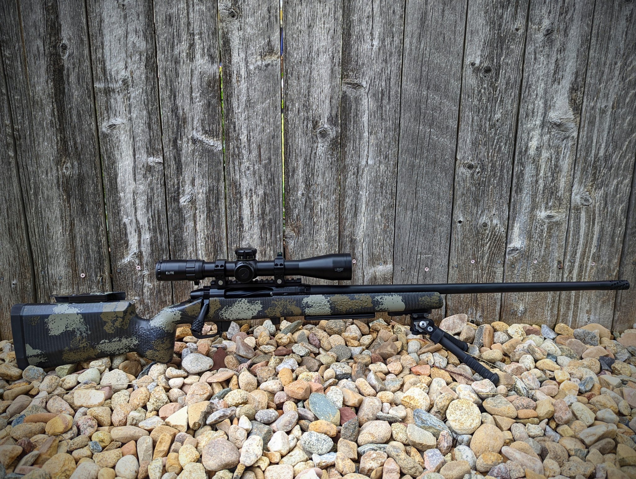

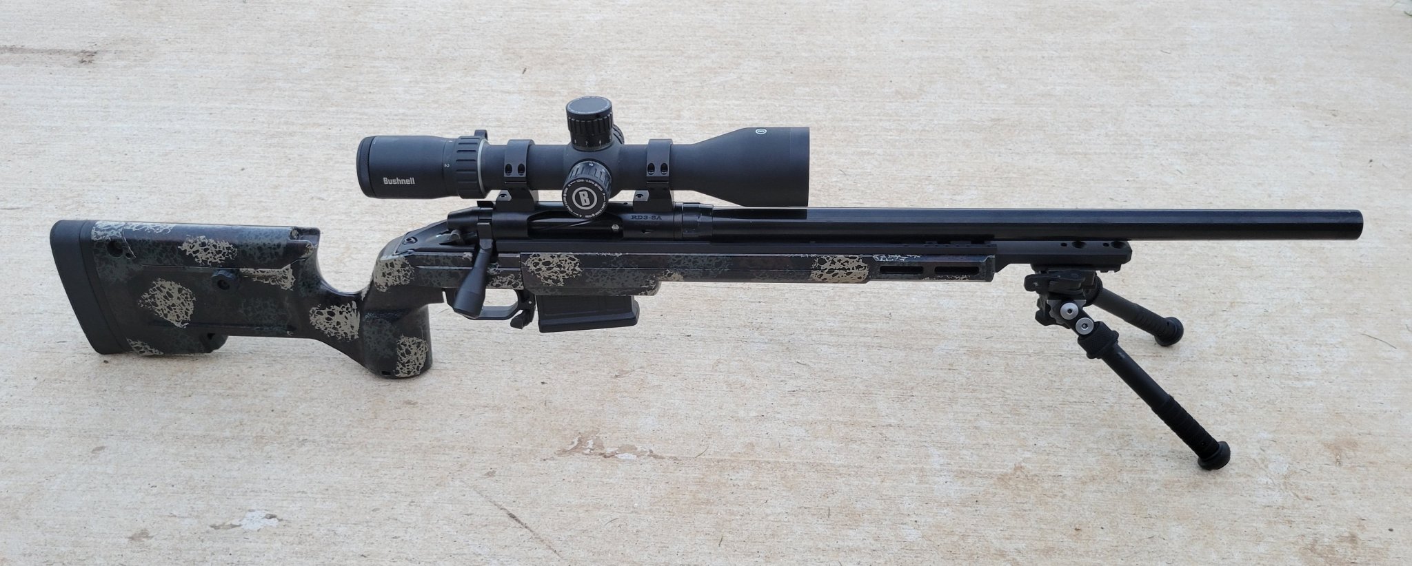

Proof "Prefit 6mm ARC Sendero 22"............hell of a deal from Stocky's on 4th of July sale.
Torqued to 60 FT/LBS
Bergara HMR Stock (I had to open up the barrel channel)
Trigger Tech Primary July 4th edition set at 1.5lbs
MDT Metal Mag 10rnd
Seekins Low 34mm rings
Bushnell Elite Tactical DMR3 3.5-21x50 (G4 ret)
First 50 rounds out of setup AVG Group size (3 shot groups) just under 1/2 MOA on a variable windy day. Largest 100 yard group was .650". I'm super happy with this setup. Only fired FACTORY Hornady 105 HPBT Black ammo.
I don't think that'd make a lot of sense, at least yet, as loaded ammo, let alone dies, brass, etc are not yet available.
Sig did that short run, but the only gun for it so far was the spear.
I really like the idea, and intended to get a cross when it came out, but they're not even following their own spec with the barrel twist on that rifle and it won't be capable of shooting the bullets I like to use.
If the army goes forward with the new rifle, I figure it will become a common cartridge at some point.
My Origin is going to be a 280 AI, but a short lightweight barrel might be a good 2nd barrel for hunting and hiking.

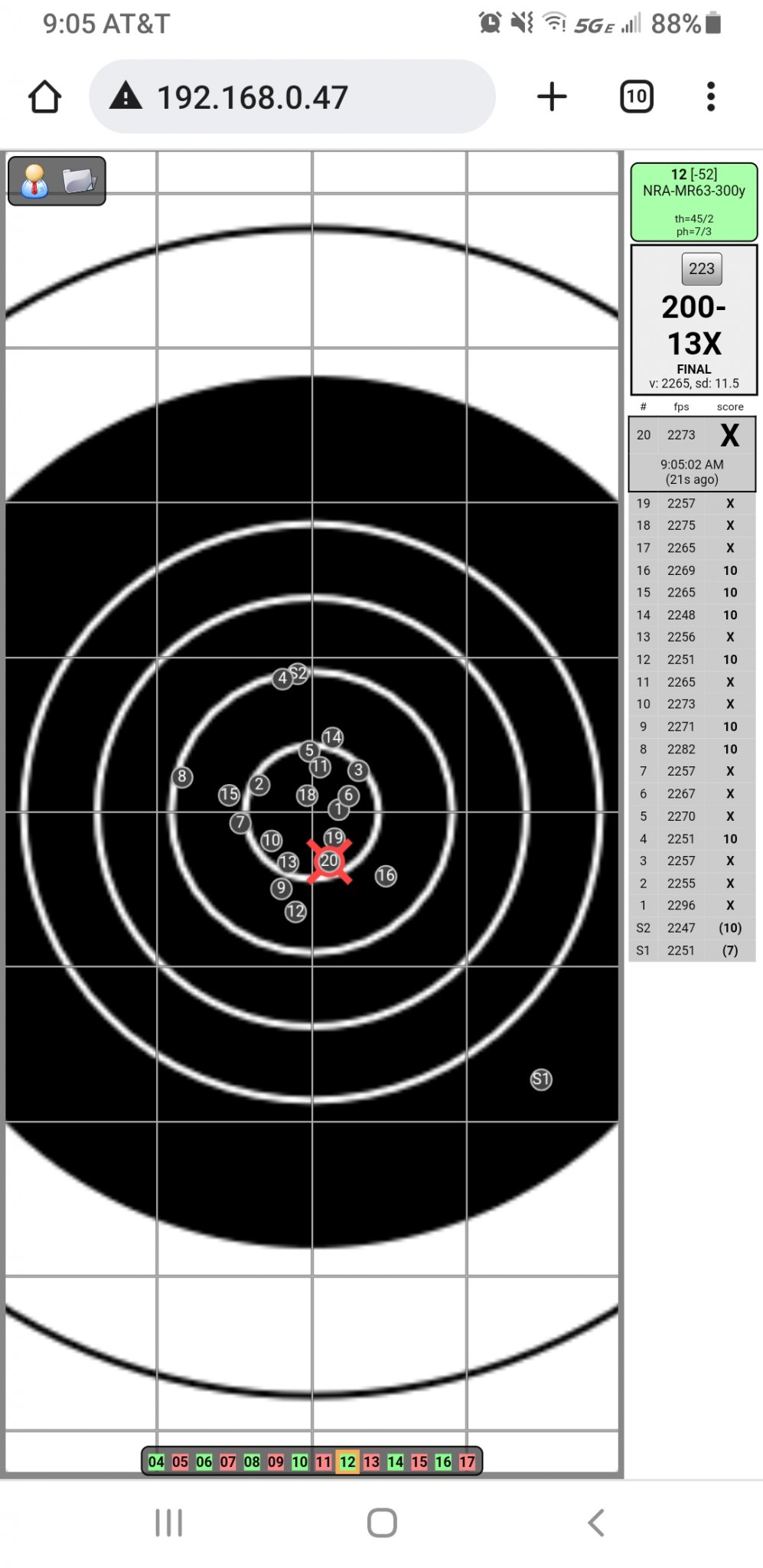

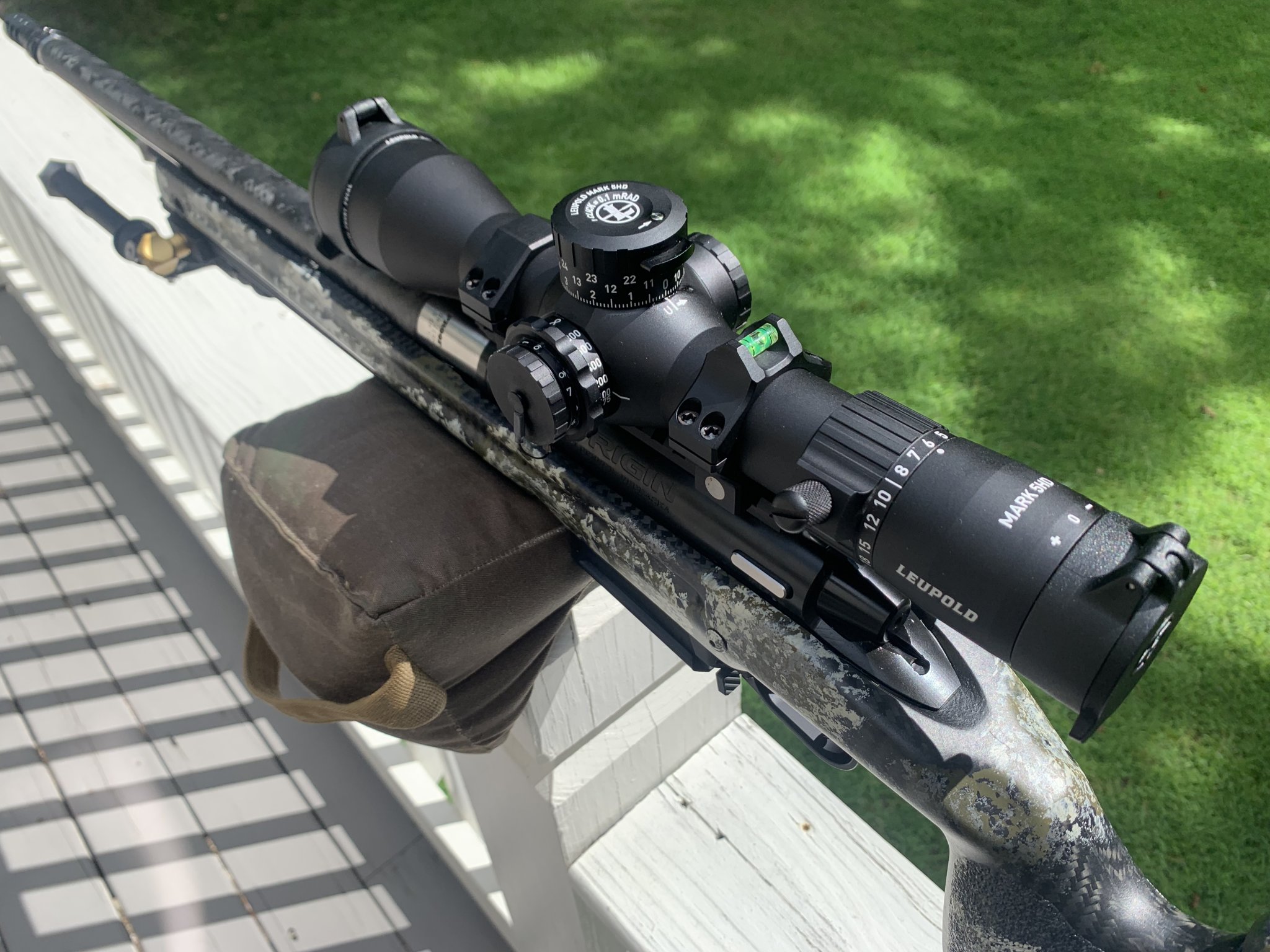

My palma rifle I built last winter. Origin SA, 31" Bartlein heavy palma 1:7 in .223, .110 freebore for 80's, 88's, and 90's, Eliseo RTS stock. I built this thinking I'd make a across the course/prone rifle combo, but I've never used it as anything but a single shot thus far. It usually wears iron sights for Palma matches (.223 or .308, iron sights only, 300 to 1000 yards), but I've shot it with a scope for midrange matches quite a bit lately.
Best scores so far have been 200-13X at 300 yards, 200-10X at 500, 200-9x at 600, and 196-9X at 1000 yards.

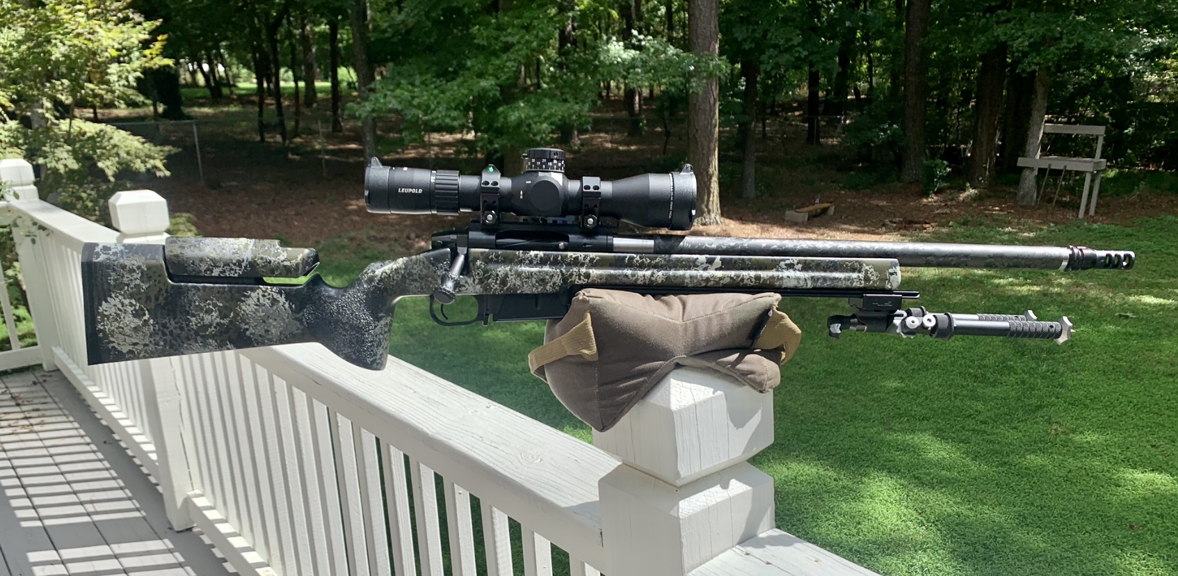

22" Proof Sendero prefit............6mm ARC
PVA Jet Blast (3 port 6mm diam brake)
Trigger Tech (July 4th special trigger)
"Greyboe bottom metal"....IE Hawkins
Mesa Precision Arms Altitude stock (Timberline Camo)
Seekins precision Low rings
Bushnell Elite Tactical DMR 3.5-21x50 G4 ret
With less than 80 rounds through the rifle, it's consistently 1/2 MOA or less at 100 and 200 yards with factory Hornady Black 105gr HPBT ammo.
Really happy with this package.

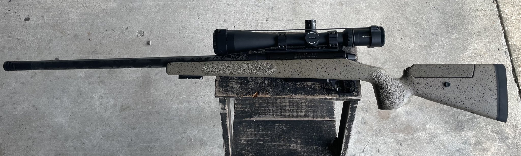

Hey folks!

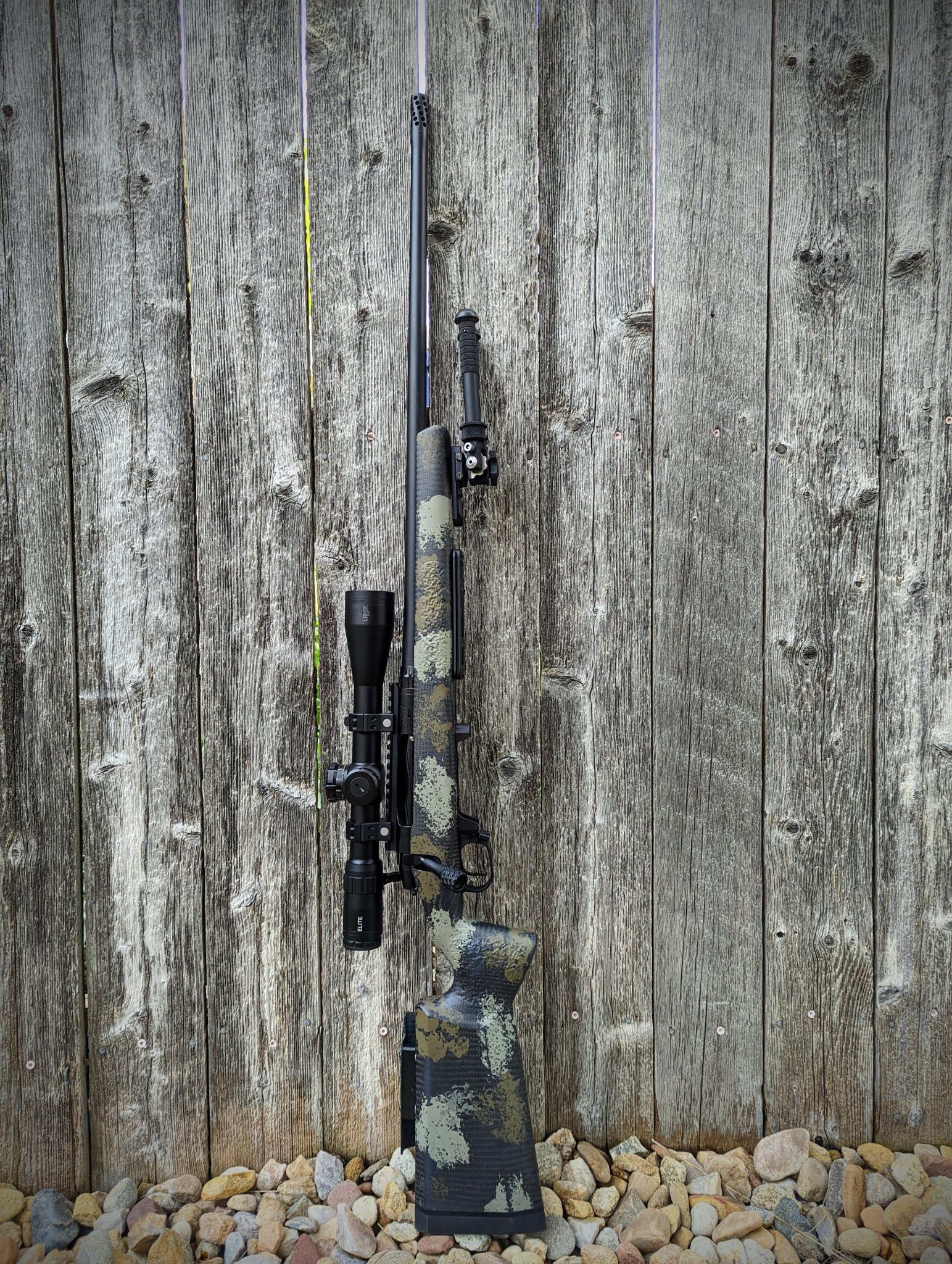

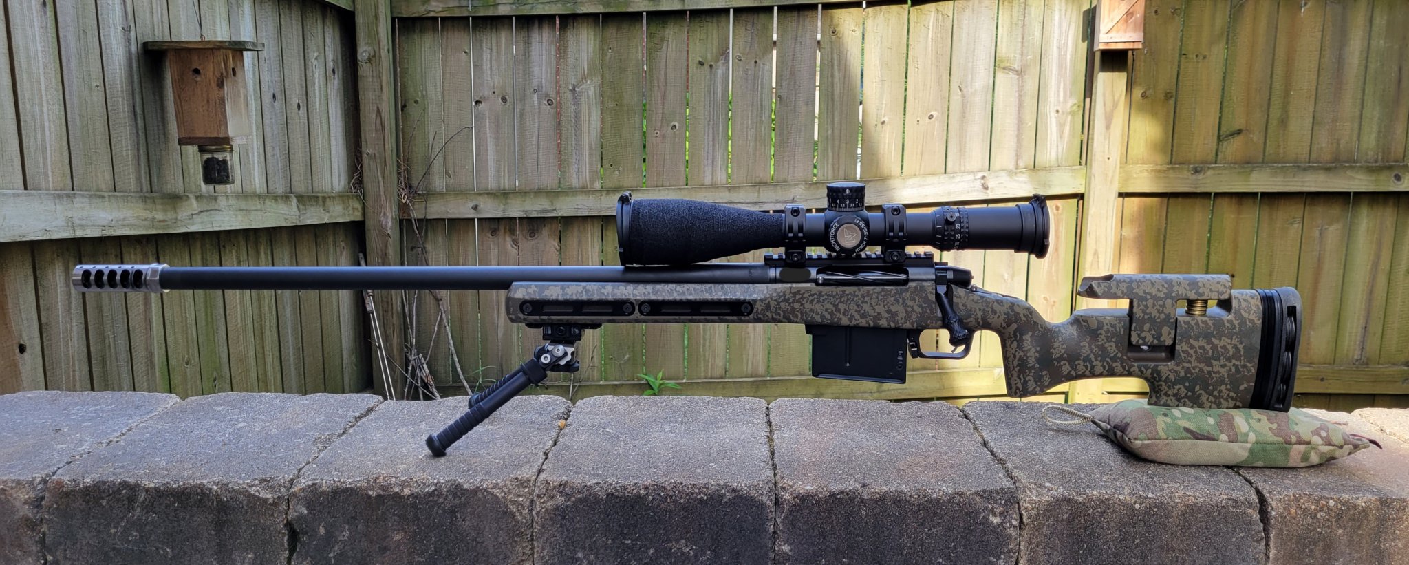

I am so, so stoked to share my hunting rifle with you all. I finally after years of shooting LR and hunting have a dedicated hunting rifle. I picked it up from my smith today after a full glass bed, and will break it in tomorrow.
This is my 6.5 PRC hunting rig. It'll be used for deer and elk in Colorado out to 500 yards. I wanted a rifle that felt like a precision rifle, and can be treated like a precision rifle, but was light enough to walk straight up mountains. Weight is 11lbs 1oz as shown, no sling or loaded mag. 11lbs 8oz with sling and mag.
It's a 24" Shilen heavy sporter with a blended brake on a Bighorn Origin long action. It sits in a Manners EH1 stock, with added spacer adjustable cheek system, with Hawkins 300 win mag length bottom metal. Optic is a Bushnell LRHS2 4.5-18, on Hawkins rings. Bipod is an atlas v8, and I've added a Henderson Precision arca rail to the stock. Trigger tech primary flat face for the trigger. And not shown, but will be heavily used, and self promoted...Longtucky Supply sling.
I went with a long action because it's a dedicated hunting rig. I can use every part over again, but barrels are consumable, and I intend to consume them. With a long action, I can swap to whatever cartridge fits my needs down the line.
Optic was chosen for its weight, reticle, locking turrets, and glass quality. It's a solid blend of everything.
The Manners eh1 is interesting. I knew I wanted an adjustable cheek piece for rifle setup, but I didn't want the extra lb of the eh1a. I found the manners ultralight riser kit, and it's simple but works. It's a spacer stack with a carbon fiber riser, not much to it. The stock had to be glass bedded, and my smith used g10 pillars.
I can't wait to go shoot this rifle and hopefully harvest some animals.

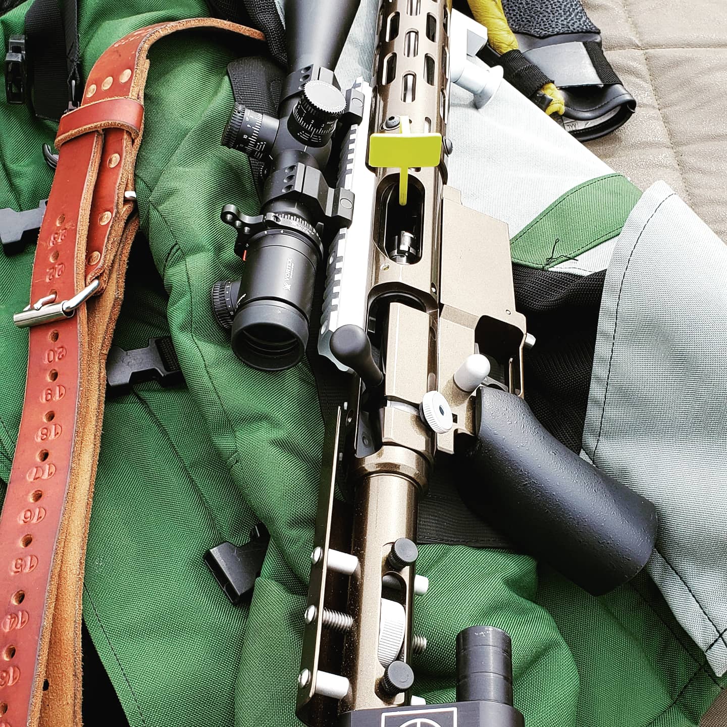

View attachment 7921138View attachment 7921137

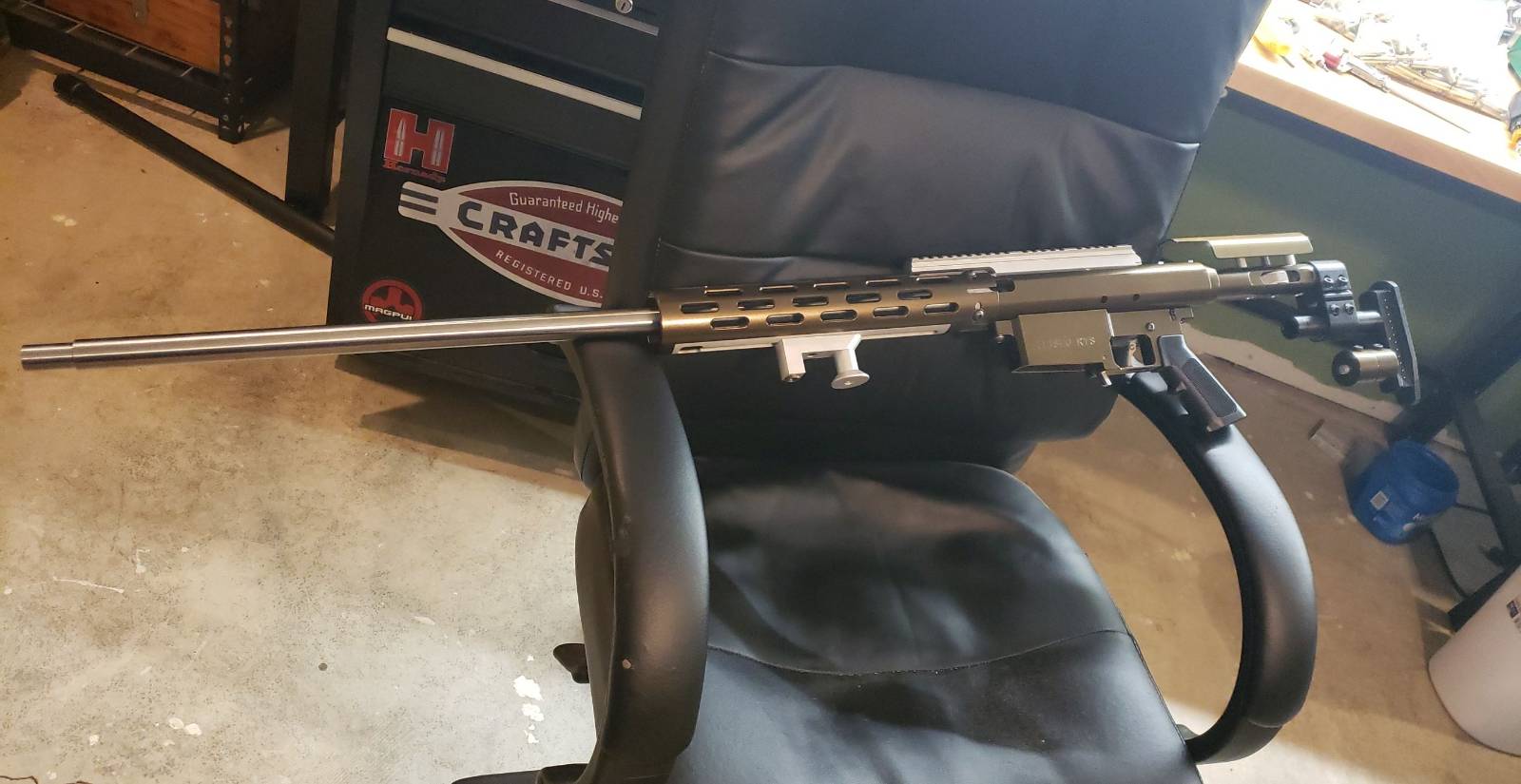

Gonna show my ignorance here……what is that thing?
Looks like a home machined rifle; which would make it even more cool.
If manufactured, who makes it. I would like to read up and learn. Not a big AR guy or chassis gun guy, but that rifle is pretty unique and makes me want to know more.
Apparently it is a Big Horn Origin action inside of the upper “shell system”? Is the upper specifically designed for the Origin or any Rem 700 clone with straight bolt?
PS - please dear lord let me send you a different AR pistol grip. The mil-spec A2 style grip leaves much to be desired on such a unique system.
It’s an elisio
It's an Eliseo RTS chassis for any SA Remington 700 or clone. I'd say 50% of all the prone rifles you see on the line at high power matches now are in one of Gary's setups. Mine is setup for AICS magazines, but most are set up for single shot actions.
Gary Eliseo is the real deal. He is as good as they come.
www.gotxring.com
I actually have a Sierra/Tubb grip on it now, but I'd be just fine with an A2. I cut my teeth shooting service rifle, so now they are more comfortable than almost any other AR grip. Ive got giant hands (size 16 ring, can palm a basketball), so most grips with finger grooves don't work at all for me. Magpul MOE grips are good, but I prefer the A2.
- MDT .223 mag
- DeadAir Sandman-S
I've been trying to decide on a 24" barrel vs a 26", I will also be suppressing it. I want to get your opinion on 26" + suppressed. Do you find it to be too long?
