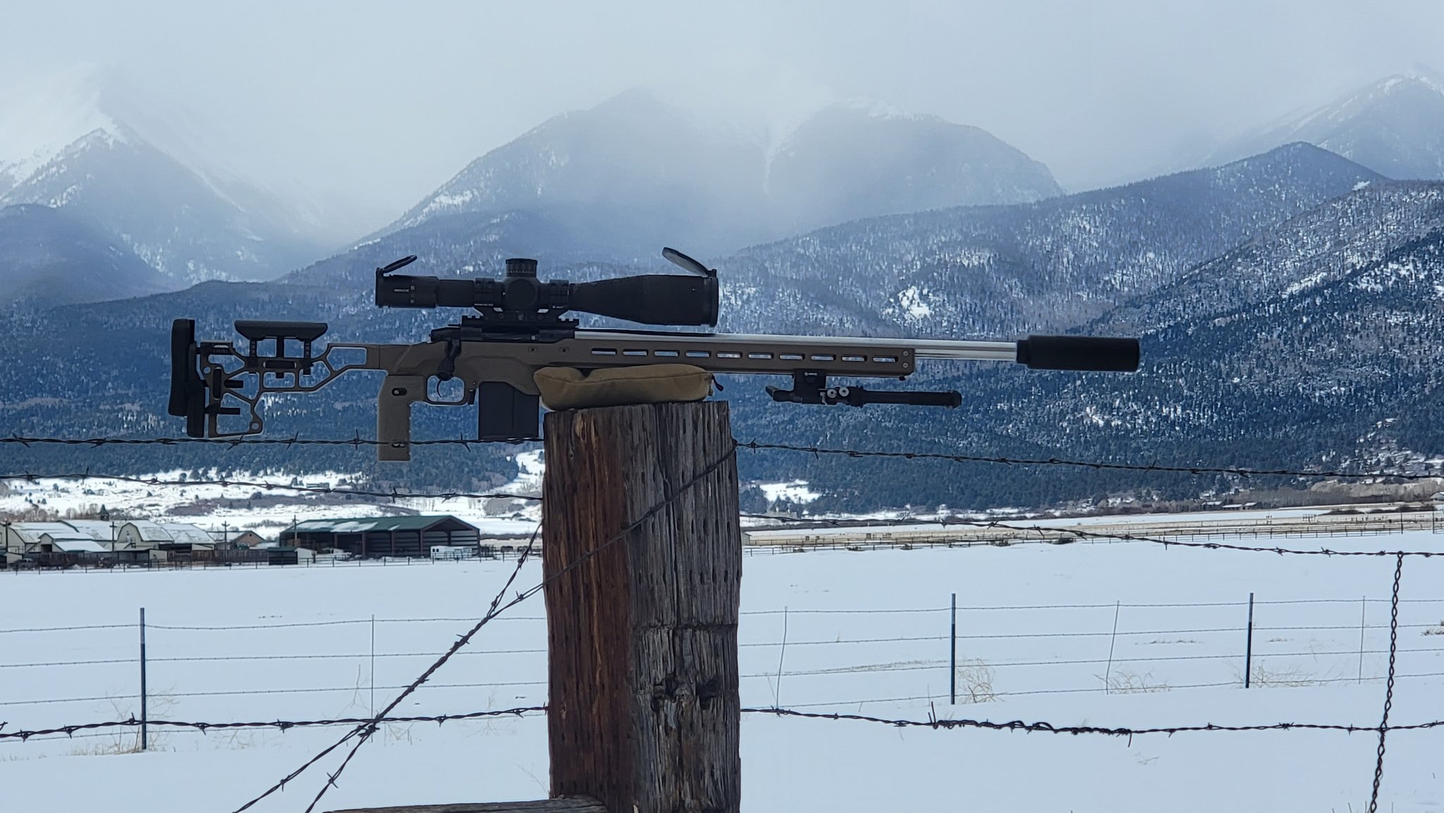

This one has changed a lot of times simply due to 2 actions, 6 chassis/stocks, 8 barrels and probably 5 different scopes that are all a part of a never ending truffle shuffle...but this one is pretty fun.
Only forseeable change is that I'm considering a VUDU 5-25x with an H59 for the glass. The proximity to the MUNSTER EFR up front means I can't take advantage of the Tenebrex caps.
Zermatt TL3 18" 22 Creed with a 7 twist
Right now I'm testing 69 TGKs for predators, but will likely consider 80-90gr bullets later on.
Trigger Tech Diamond and the Oneill Ops 224 VAPR suppressor for this one and pretty much everything else should be outlined in the picture.
Great looking build man, how are you liking the Gen III? Also is that a straight bolt handle for the Origin? Admittedly every time I handle an origin I have an urging want to start a new build. Love that little action so much for the money.
+1 for @Front Range Precision. Just got my Origin in last week. Owen was very helpful and awesome to deal with, I'd recommend them to anyone looking to buy!

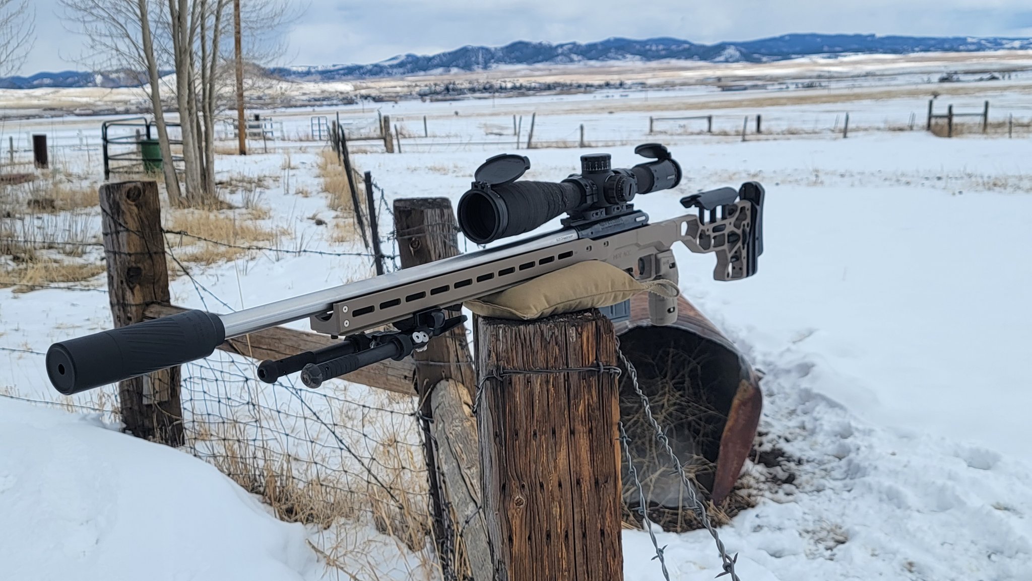

Origin
Proof TL3 6Dasher with HLR Lug
Henderson HRP
Razor Gen3
ARC MBrace Mount
Hawkins M5 DBM
Area419 Hellfire Match
22.8 pounds no mag/bipod

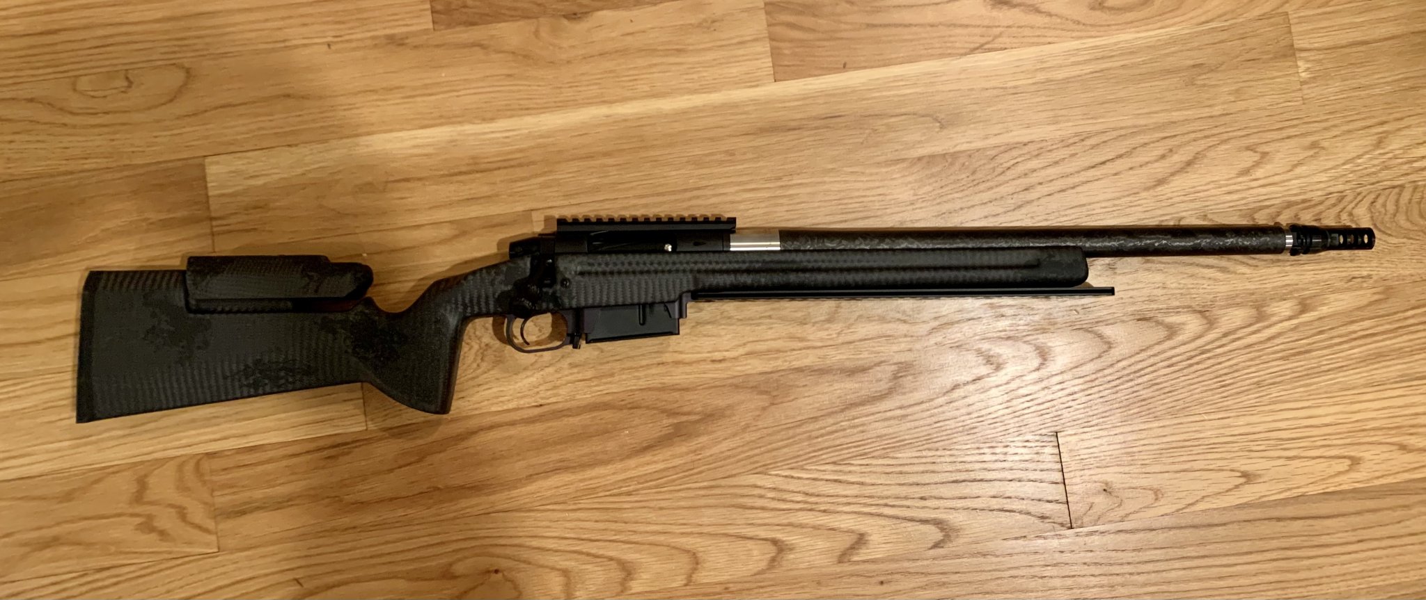

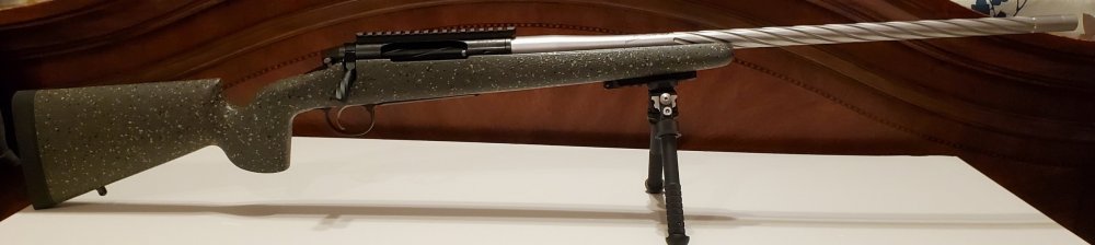

Got to test mine out and didn’t blow my fingers off tonight so that’s a bonus. Proof 6creed. Will have to sight in next weekend when I’m not freezing my balls off. First venture into bolt actions so we’ll see how I like in a few months
Reactions: long range sponge

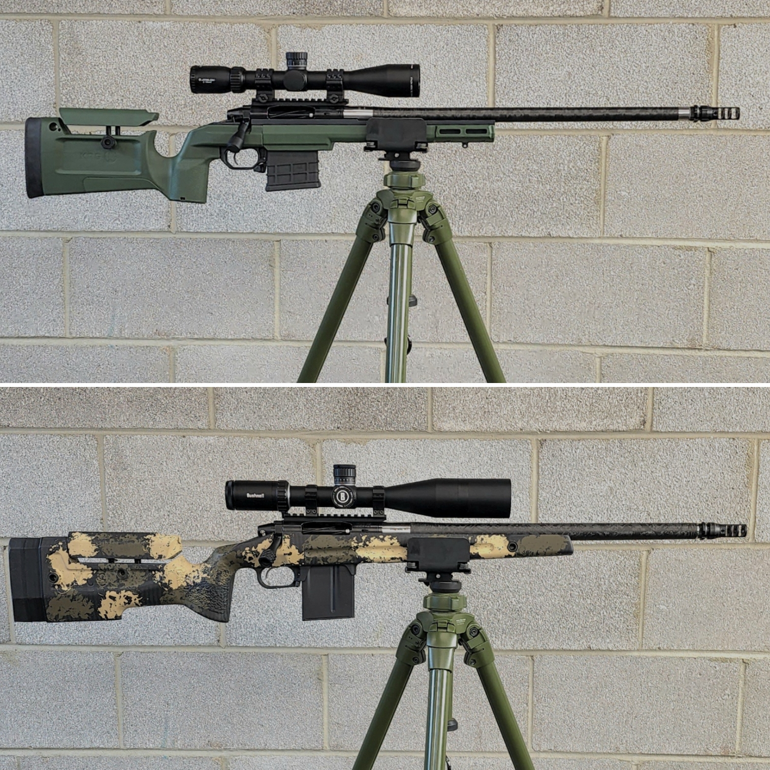

Here is mine. Also I agree with triggertech special two stage and northland shooters.
Criterion 24” 308 w/ 118LR chamber
Macmillan A5 and triad stock pack
SOL bottom and 419 extensions on AI mags.
Going to paint the stock but no solid idea what yet.
Reactions: Army First

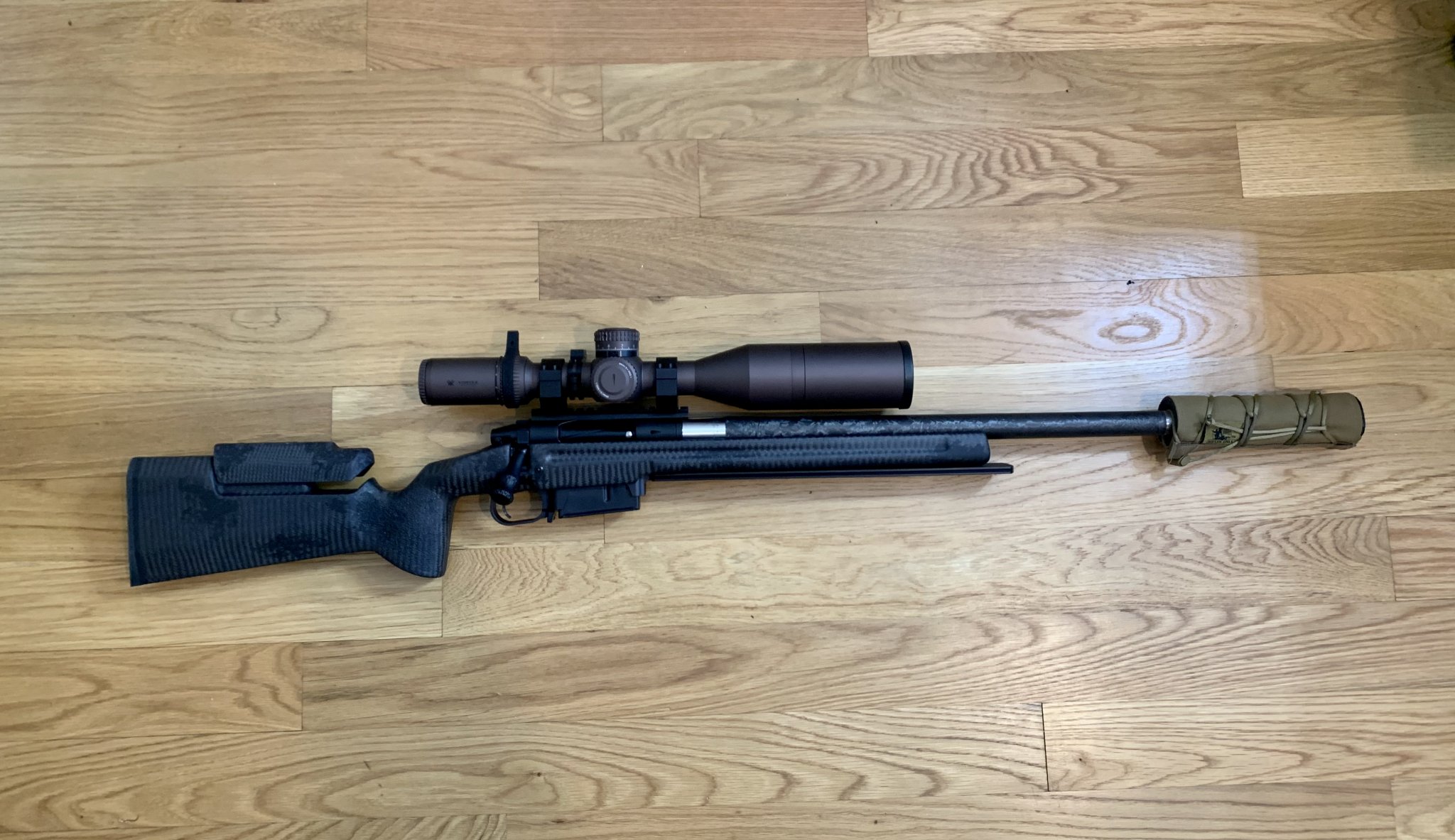

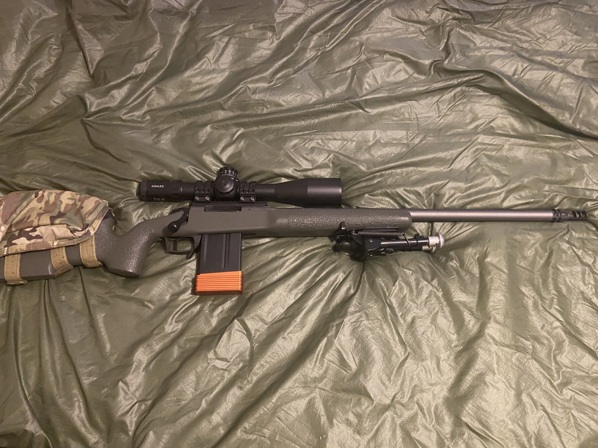

Origin SA
Proof Research - carbon fiber -20” 6.5 CM
Sandman S
Manners LRH - elite tac back in black
M5 mini chassis- Hawkins M5 dbm
Triggertech - special
Full length Arca rail
Vortex Razor Gen 2 - 4.5-27x56 - for now
(Going to swap to a lighter more compact scope eventually - Leupold Mark 5HD 3.6-18)
Rifle without this scope combo and no suppressor weighs 8 lbs
Origin SA
Sandman S
Rifle without this scope combo and no suppressor weighs 8 lbsView attachment 7841160
What rings are those and what height?

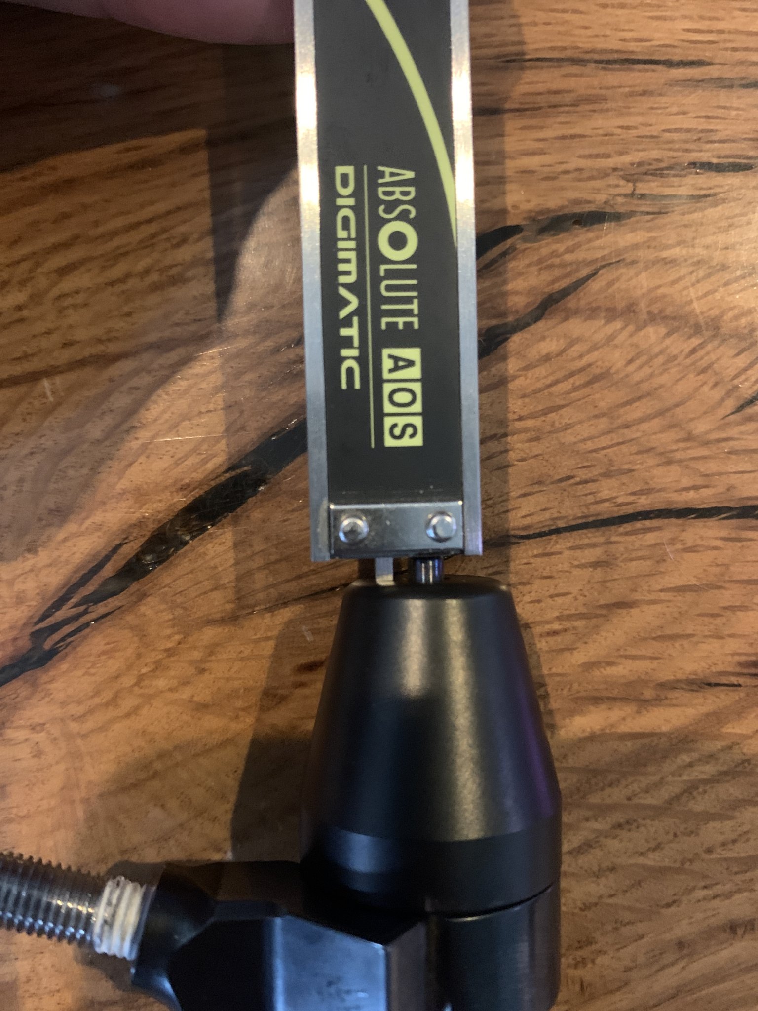

In some of the early threads I see people talking about timing the action to the trigger. I understand what they are talking about but what is the process without being able to change trigger hangers?
This image is of a rem 700 cocking piece but timing it is actually filing away the engagement surface so that it hits the trigger sear a bit later in the bolts forward travel. By causing them to interface later in the bolts forward travel you dont have to physically overcome and compress the firing pin spring yourself during the close before the locking lugs catch.
Edit: I found this of two bighorn firing pins and you can see the difference in where their sear engagement surfaces line up. Its not much but its there and it depends mainly on the particular trigger as to where the "sweet spot" is.
If you DO have an old origin with the grayer cocking piece shown on the left first contact zermatt and they will swap it out with the revised version thats sorta copper colored which is shown on the right second.
That makes sense, is this something that you hand fit or do they make different cocking pieces that you order?
If you have a standard piece you will hand fit it with a file.
If you have the new version they offer then you shouldnt need to... but if you do you will still hand fit it.
They dont have a bunch of different ones you can order, just the single revised version.
You can send your action and trigger in and they will do it for you for a few bucks.
OR you can measure how much you close on firing and then file that much off of what you have.
Edit: I still have my old style that zermat never sent the return label for sitting here handy-
You will take this measurement of the cocking indicator sticking out the back of the bolt with the handle up and unlocked with your calipers depth gauge.
Then you will take the measurement with the handle down and locked in the action.
Ideally it will be the same dimension so you have a seamless handoff transition from the bolt body holding the firing pin back to the trigger sear holding it back.
The difference between the first and the second measurement are how much cock on close you have, if the second number is smaller than you dont have any cock on close (you have a negative cock on close) and filing it further wont do anything good for you.
You would remove that amount of difference you measured (maybe less .005" just because you dont want to go too far) and then stick it in the action and check its feel and remeasure if you still feed the need to take some off.
