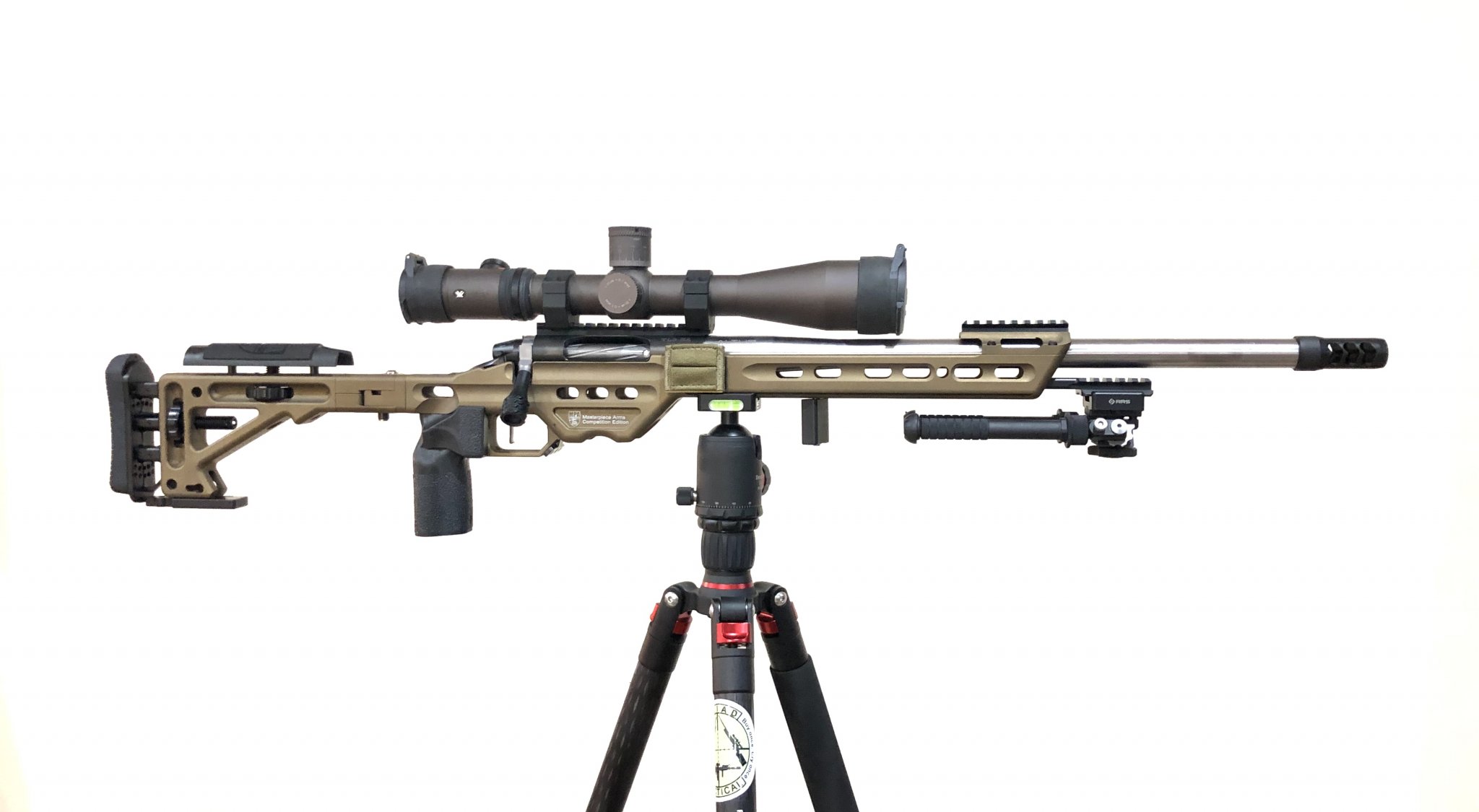

Bit the bullet so to speak and got an order in with Altus out of FL. They had everything I wanted in stock. It’s all in and I’ll do some more pics and report once I get it going.
TL3 action, MPA comp chassis / folder, Triggertech special flat trigger, Area419 hellfire brake, Proof 20” 6.5cm stainless heavy palma shouldered prefit (I think they cut em all in house from proof blanks).
Added my Gen1 Razor on it and atlas PSR bipod. All in weight is right about 15-16 lbs. Fit and finish and feel is all good, lockup is smooth and solid on the folding chassis. Just don’t like the diamond cut bolt knob.
