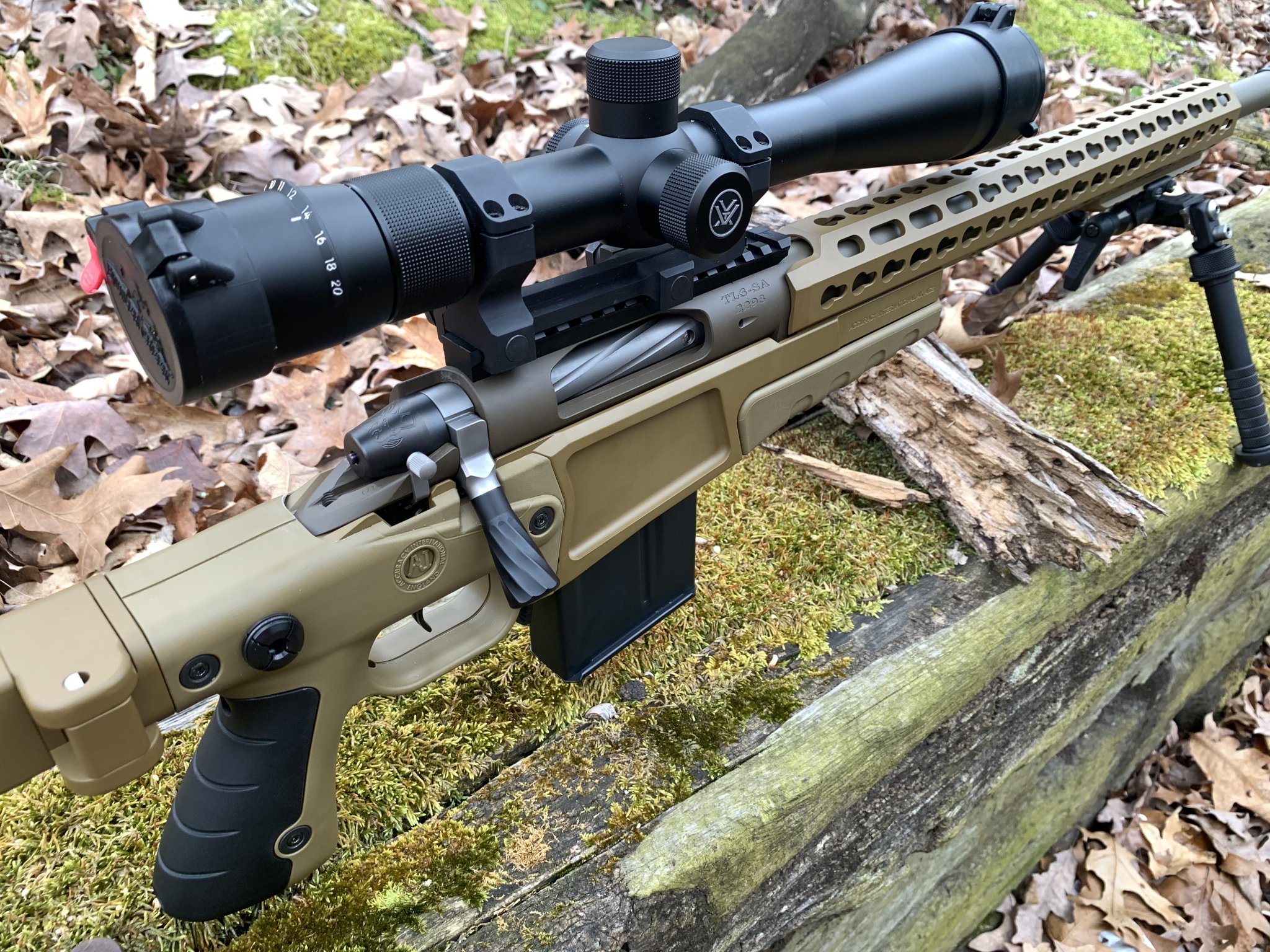

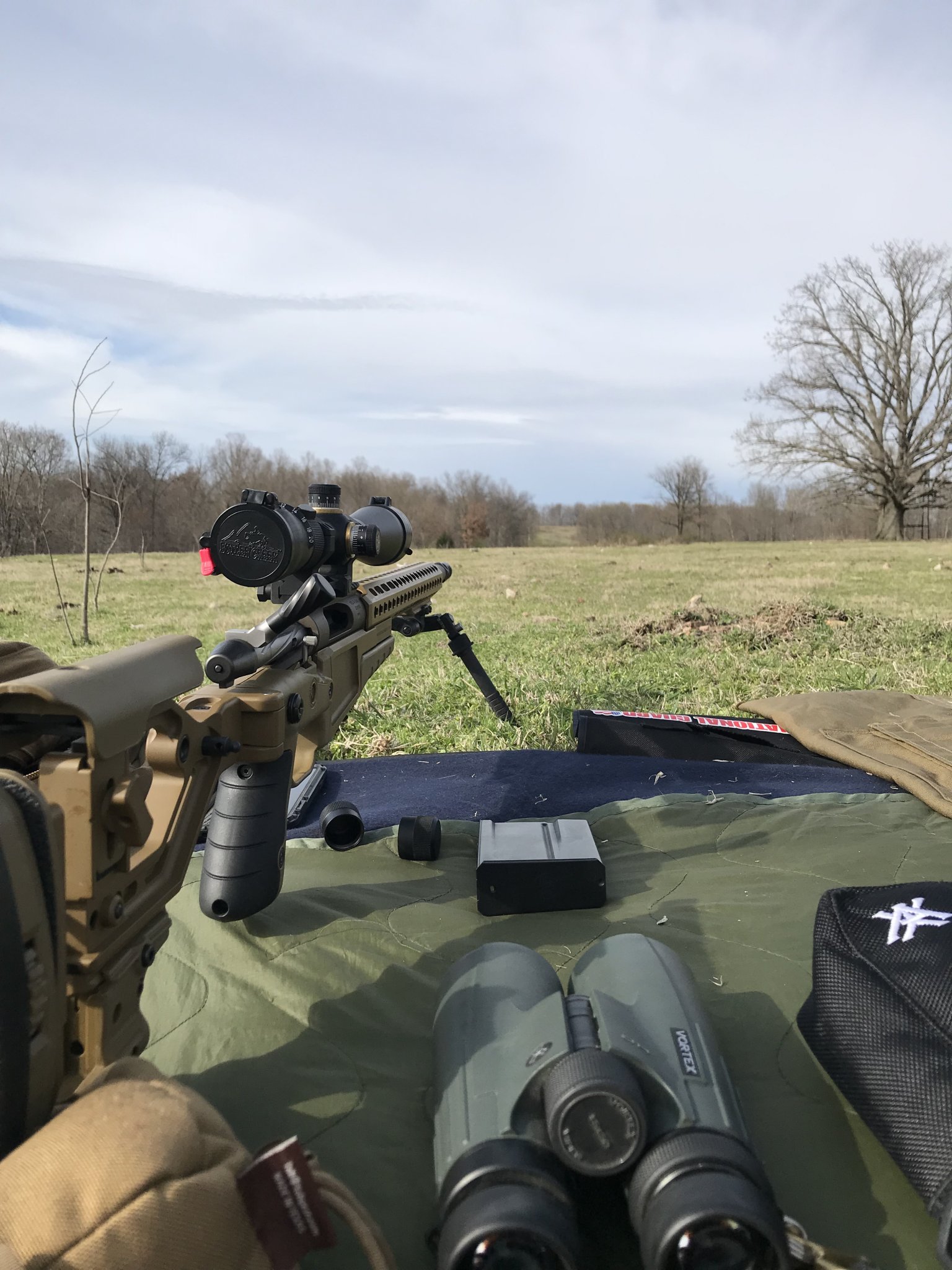

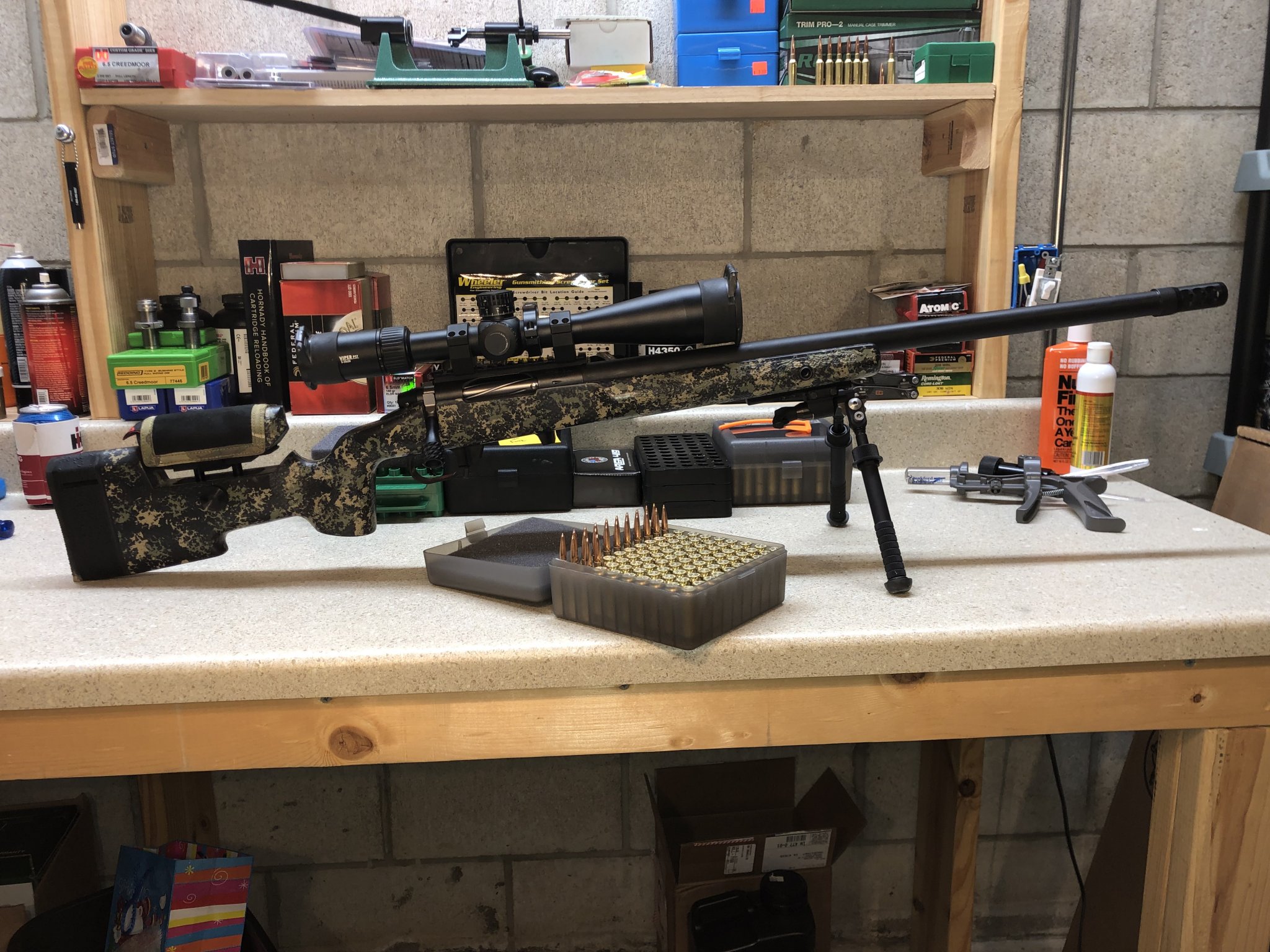

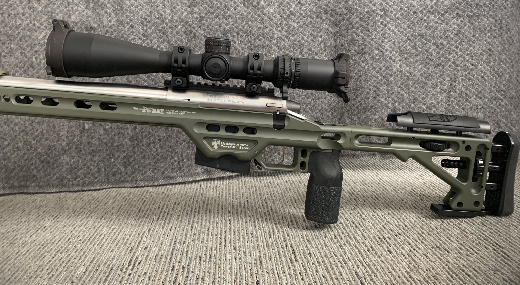

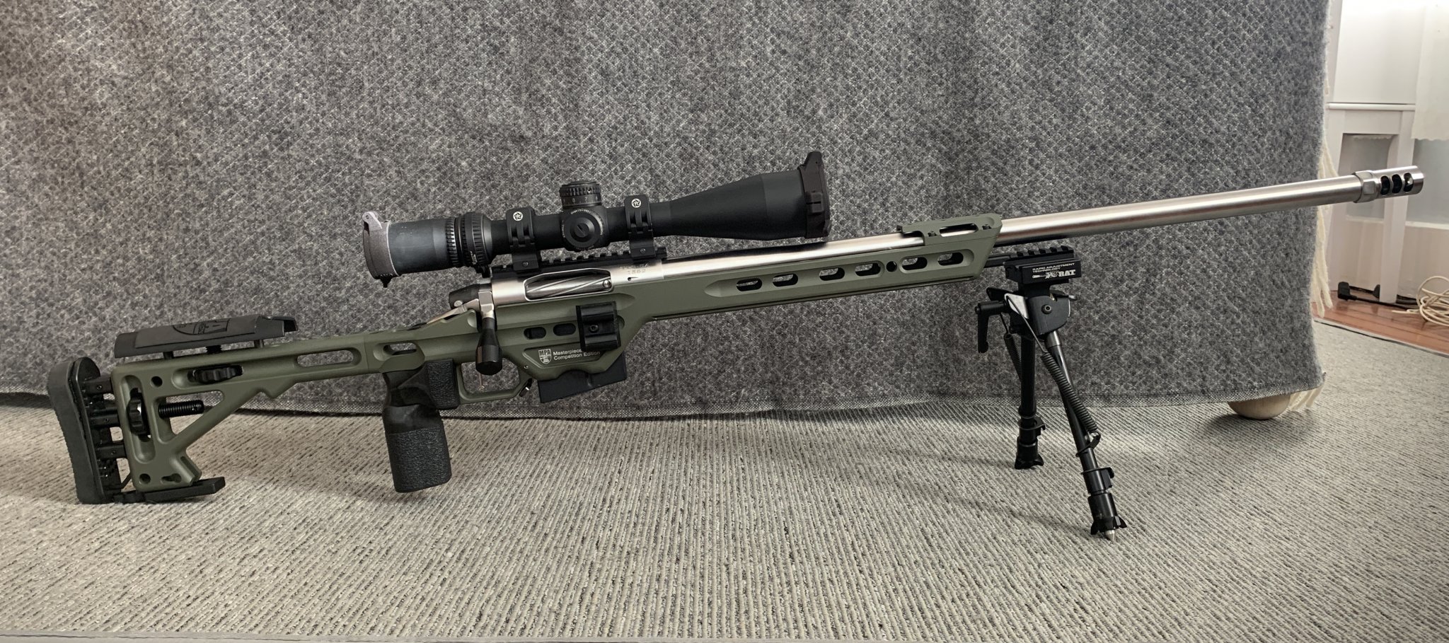

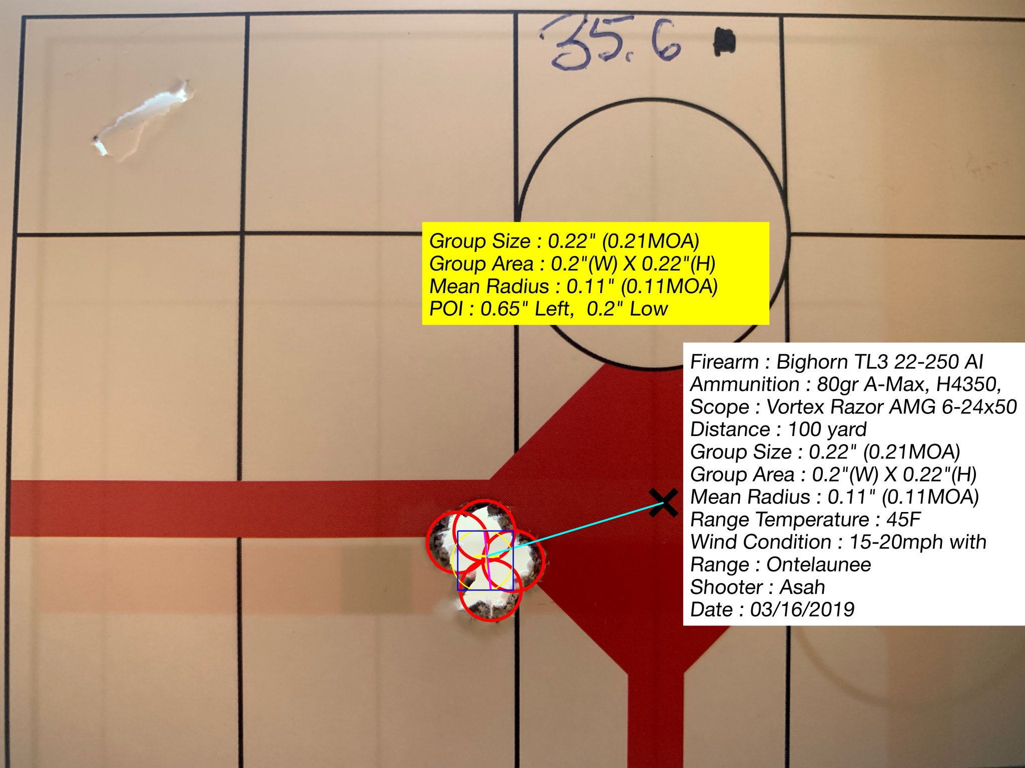

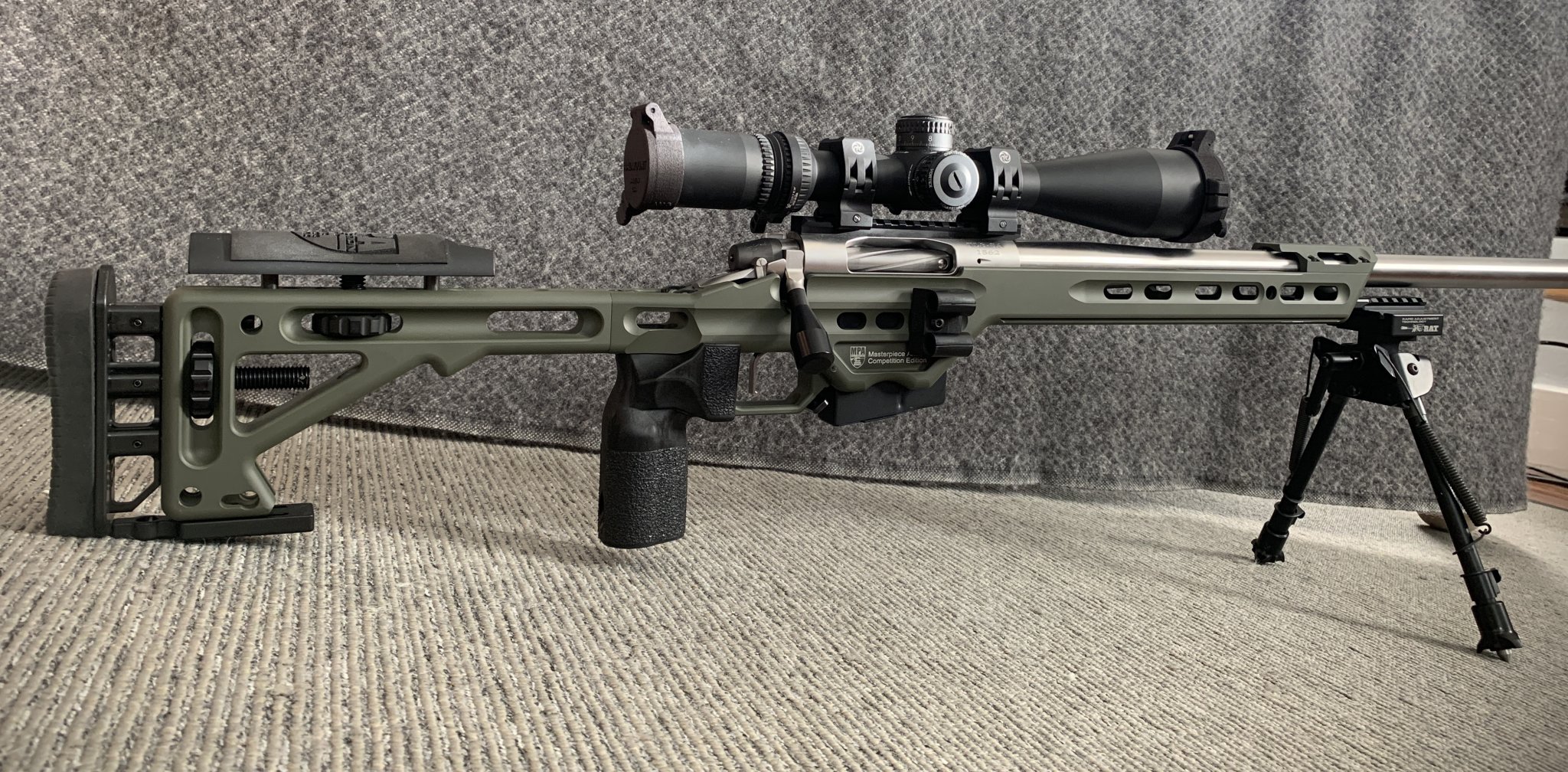

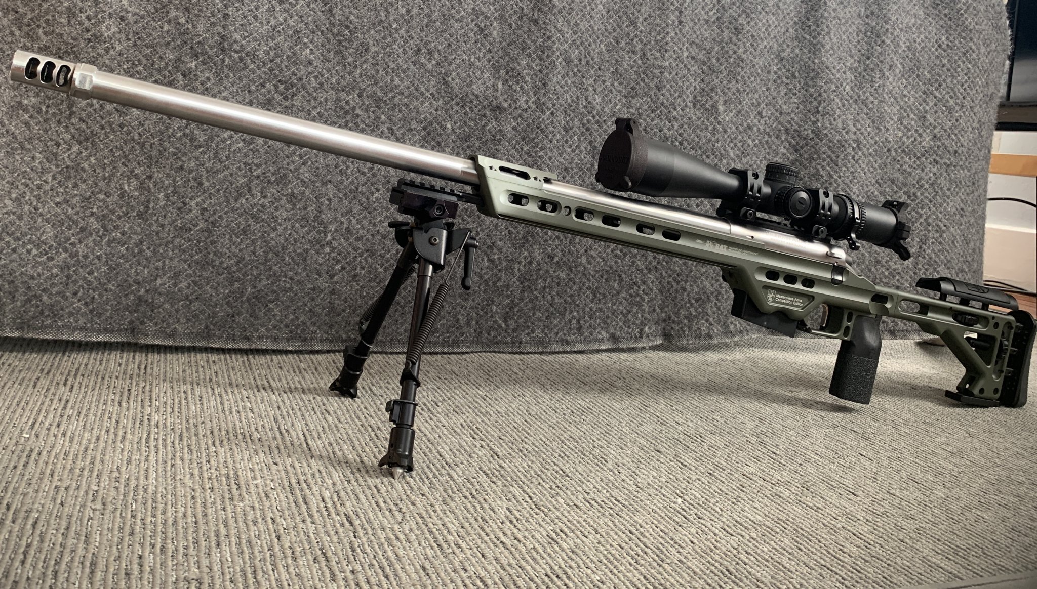

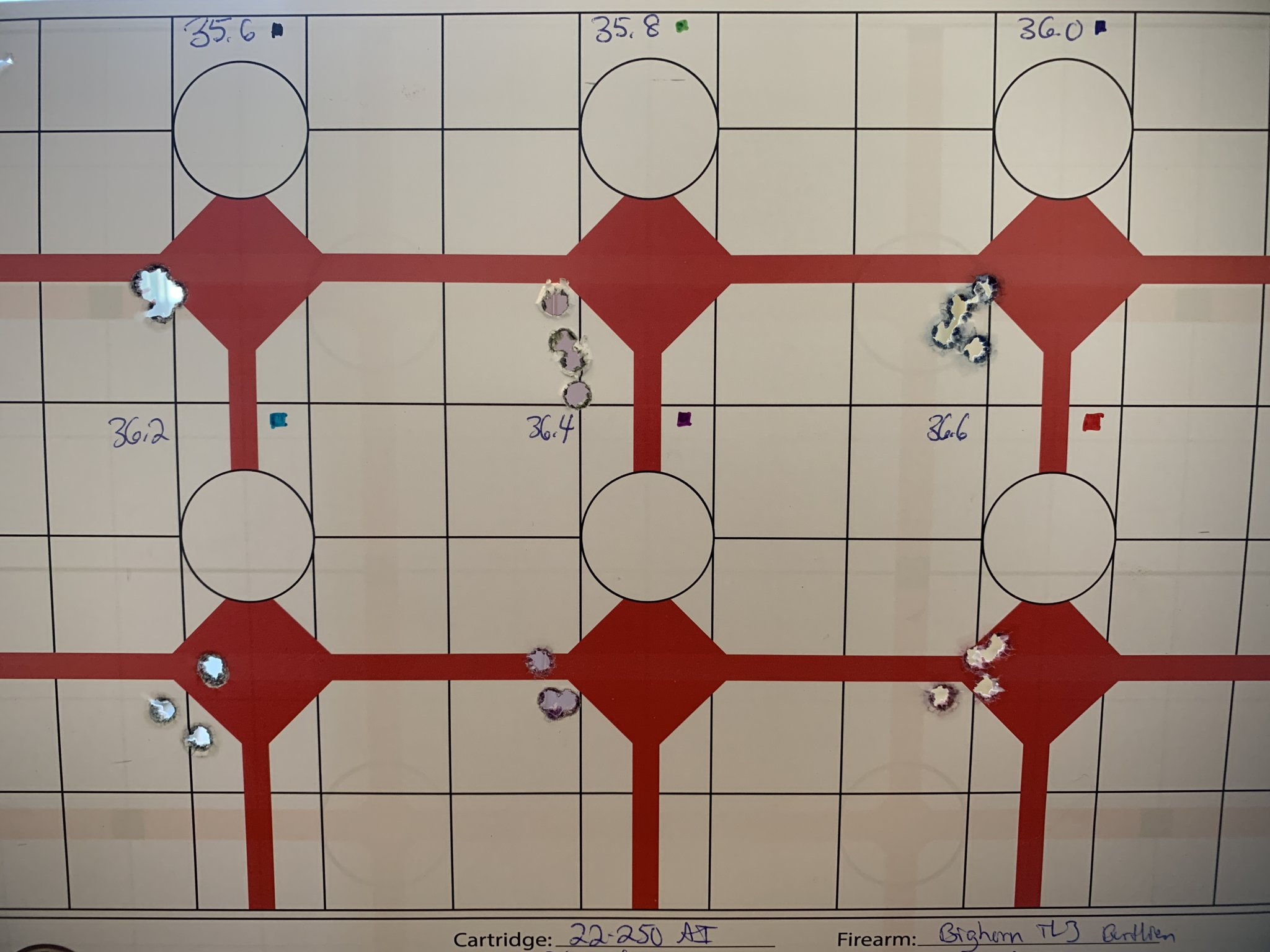

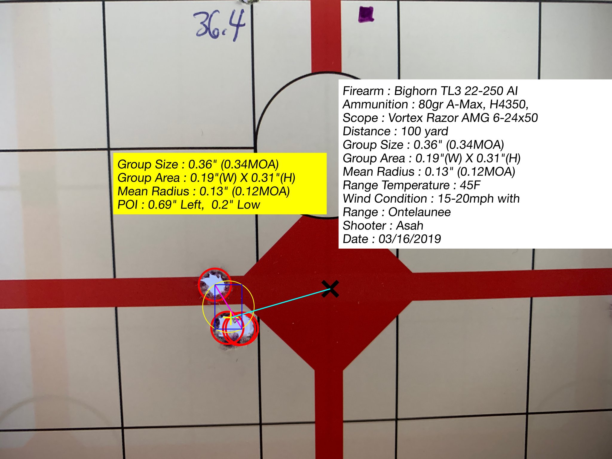

Finished up my newest build this week after 4 months and shot it yesterday. It’s a TL3 SA chambered in 22-250 AI. Just trying to find a decent fire forming load for my new Lapua brass at 100 yards. Was not expecting the results I got. Couldn’t be happier. Big thanks to Phil Cashin and crew at MPA, Greg Young at SPR/Bugholes, and last but not least Ray at Bighorn Arms for all the help and support. Can’t wait to stretch its legs and shoot some matches with it.
-Bighorn TL3 Short Action, AW Cut, Medium Tang, 20 MOA rail
-Shouldered Bartlein 7 Twist 26” Heavy Palma contour spun up by Greg at Southern Precision Rifles/Bugholes
-APA Little Bastard Gen II Brake
-MPA BA Competition Chassis in Sniper Green
-ARC M10 Scope Rings
-TriggerTech Special Flat Shoe
-Vortex Razor AMG EBR-7 MIL reticle
-AICS AW Magazines
-Harris 9-13 Swivel/Leg Notch Bipod with Hawk Hill Talons
-MPA RAT dovetail clamp with Harris Adapter
-MPA 2 round holder

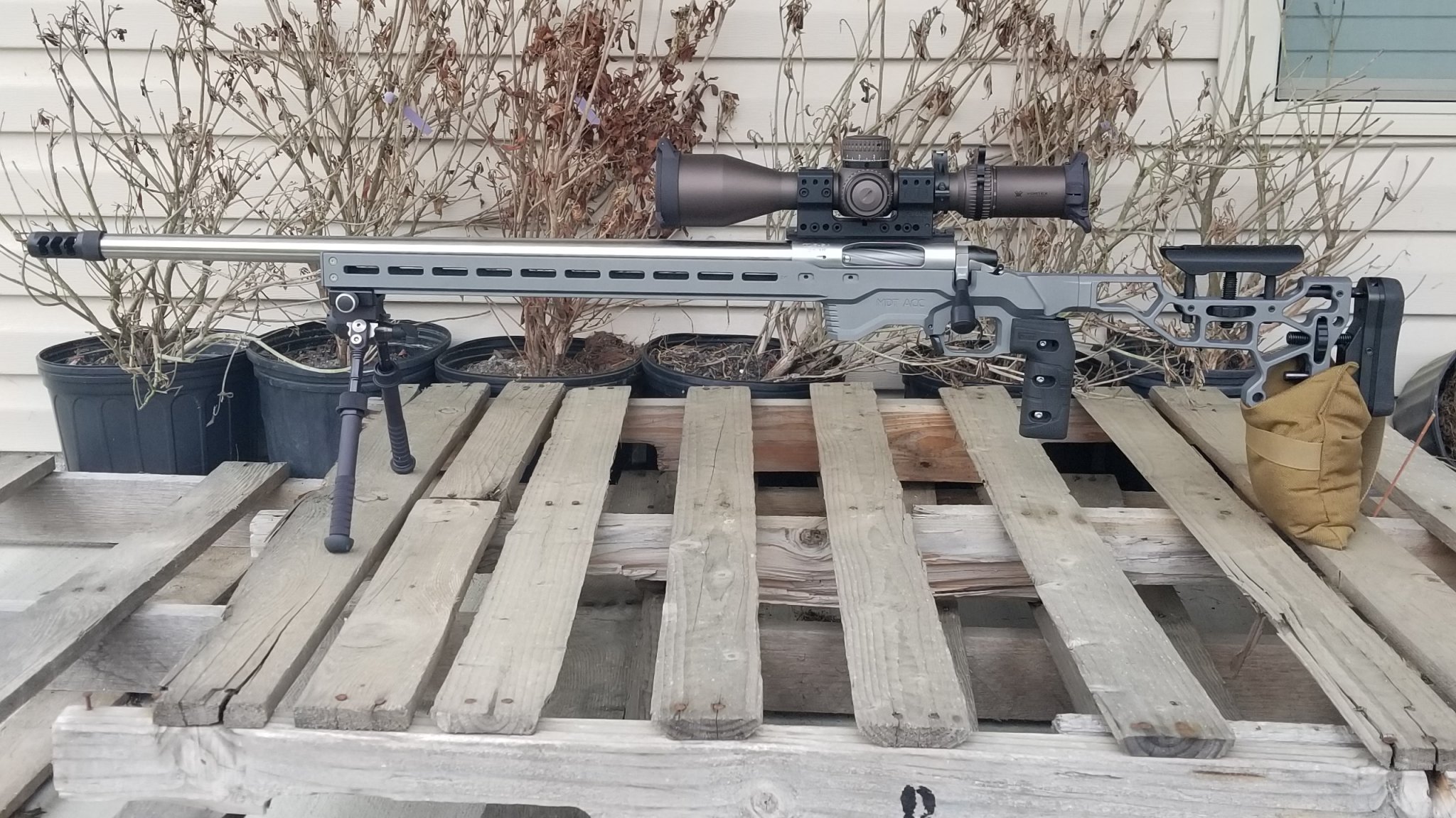

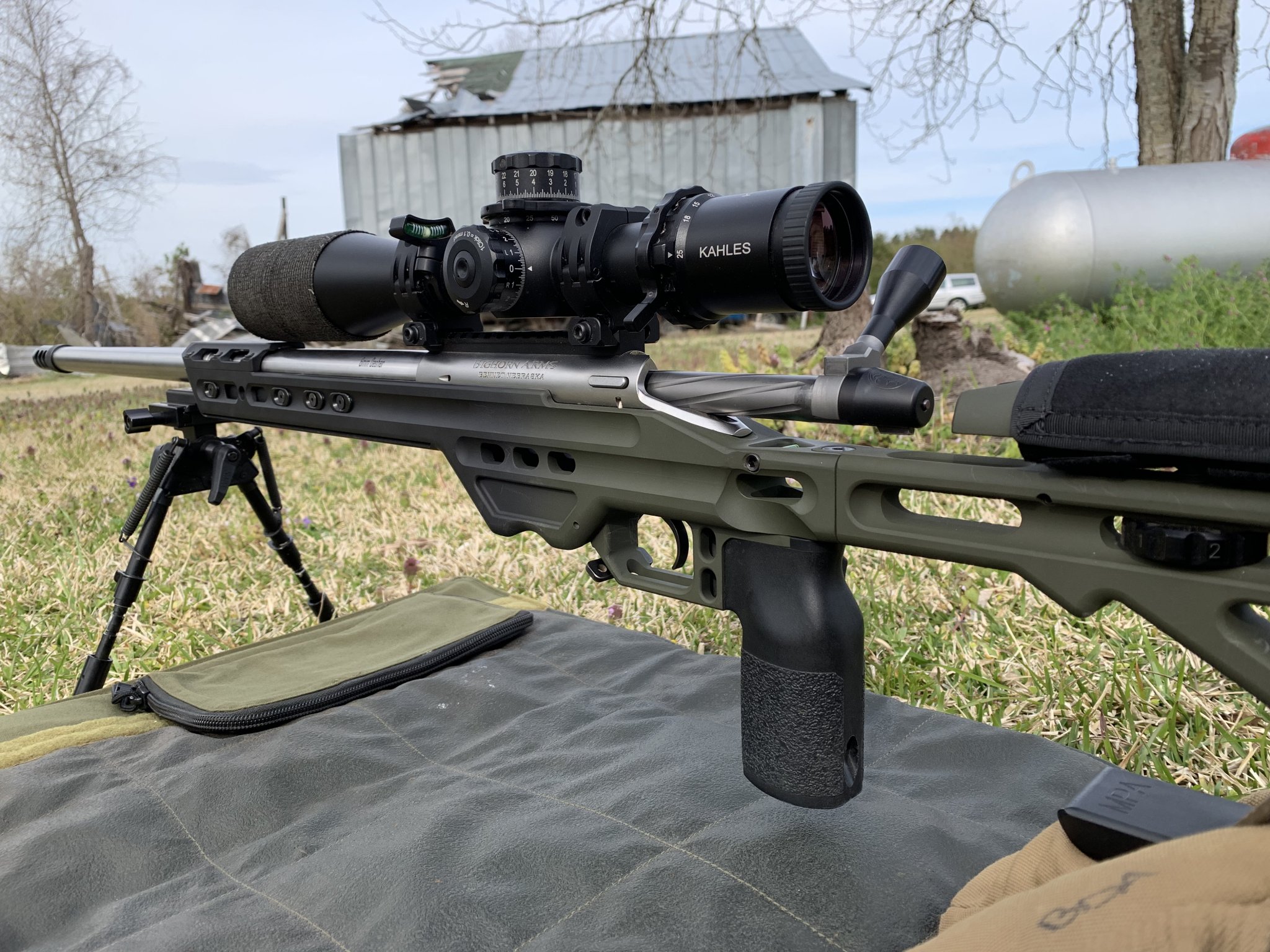

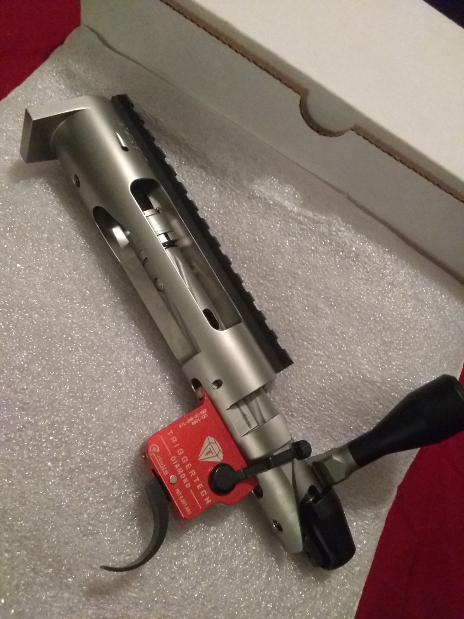

Finally got my barrel torqued on and my glass mounted.
Lefty TL3 SA in stainless
Altus Shooting 6BR Bartlein Prefit M24 26"
Triggertech Diamond Pro Curve
MDT ACC chassis
Atlas CAL bipod
Razor Gen II 4.5-27 EBR7C in a Spuhr SP4006
Area 419 6mm Hellfire break
Is there enough room between the cheekrest and receiver to remove the bolt? And get a bore guide in?

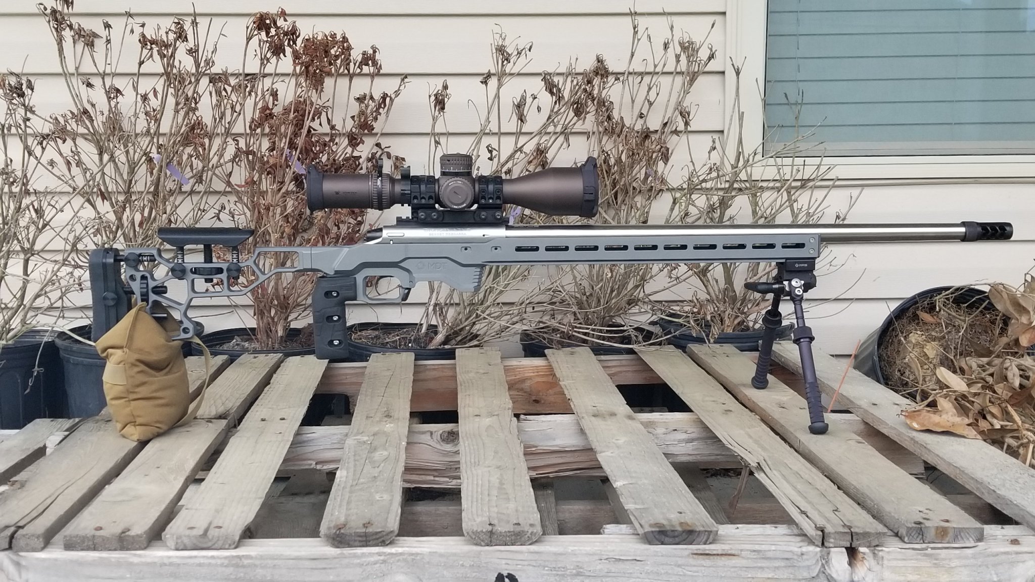

MDT ACC chassis
Atlas CAL bipod
Did you have to do any modification to the ACC for the barreled action to fit right in? And the trigger went right in with no problem right including the safety release knob? Also, do I need any extra attachment for my Atlas bipod to fit on the ACC rail? I see your pic has something extra.
No modification what so ever. Everything dropped in perfectly. Barrel channel has plenty room for a beefier profile also. My Atlas has a RRS Arca/picatinny mount attached. This one.

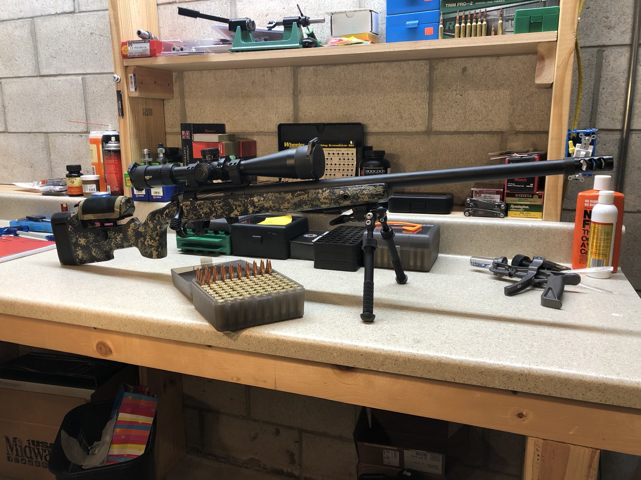

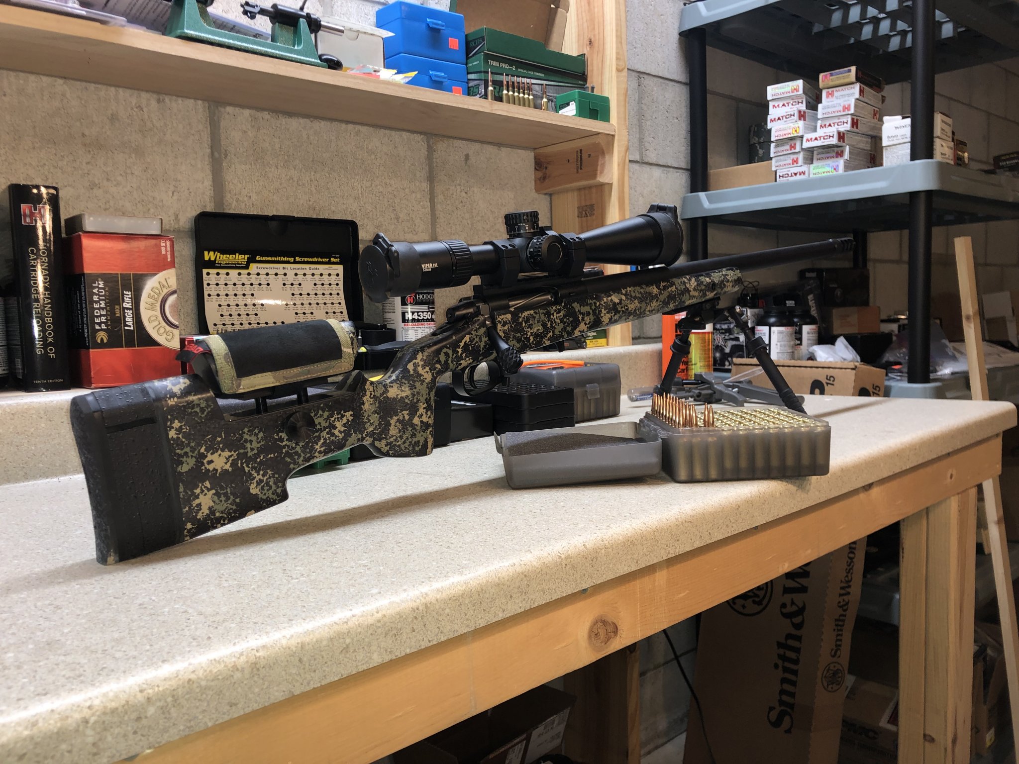

Well, after 7 months of having everything else, my McMillan finally came in and I got everything put together! Did load development all last week and shot my local match with it on Sunday! Thing shot lights out, and was a real joy to shoot. My smith shoots at my local matches and helped me tweak feed lips on my AW mag to get it running almost 100%. I ordered an MPA tool to do some final tweaking to get it running like it should.
So Without further ado, here she be!!
Bighorn TL3-SA NP3 with AW cut
24” Bartlein M24 chambered in 25CM
Area 419 Hellfire muzzle break
Huber Concepts 2 state trigger
McMillan A5-A in Woodland Carbon Ambush
Hawkins Precision Bottom Metal
Atlas CAL Bi-Pod(accidentally bought the bolt on, need to call and order quick detach conversion.)
Gen II PST 5-25x50 FFP Mil/Mil
Vortex PMR Rings
Weibad Cheek Pad
TBAC Ultra 7 sitting in jail!
7053976
7053943
7053941
7053942
Huge Shoutout to Isaac Frank at Southern Indiana Precision, that guy turns out some hammers! Highly recommend to anyone looking for an awesome Smith!!
Also Miles & Logan at Blackjack Bullets! They were super helpful at answering all my questions. I know it might not be for everyone, but if anyone is on the fence about going .257, just do it! These are stand up guys that are passionate about there product and will do what they can to make sure you are satisfied!
Stoked with how this thing turned out!

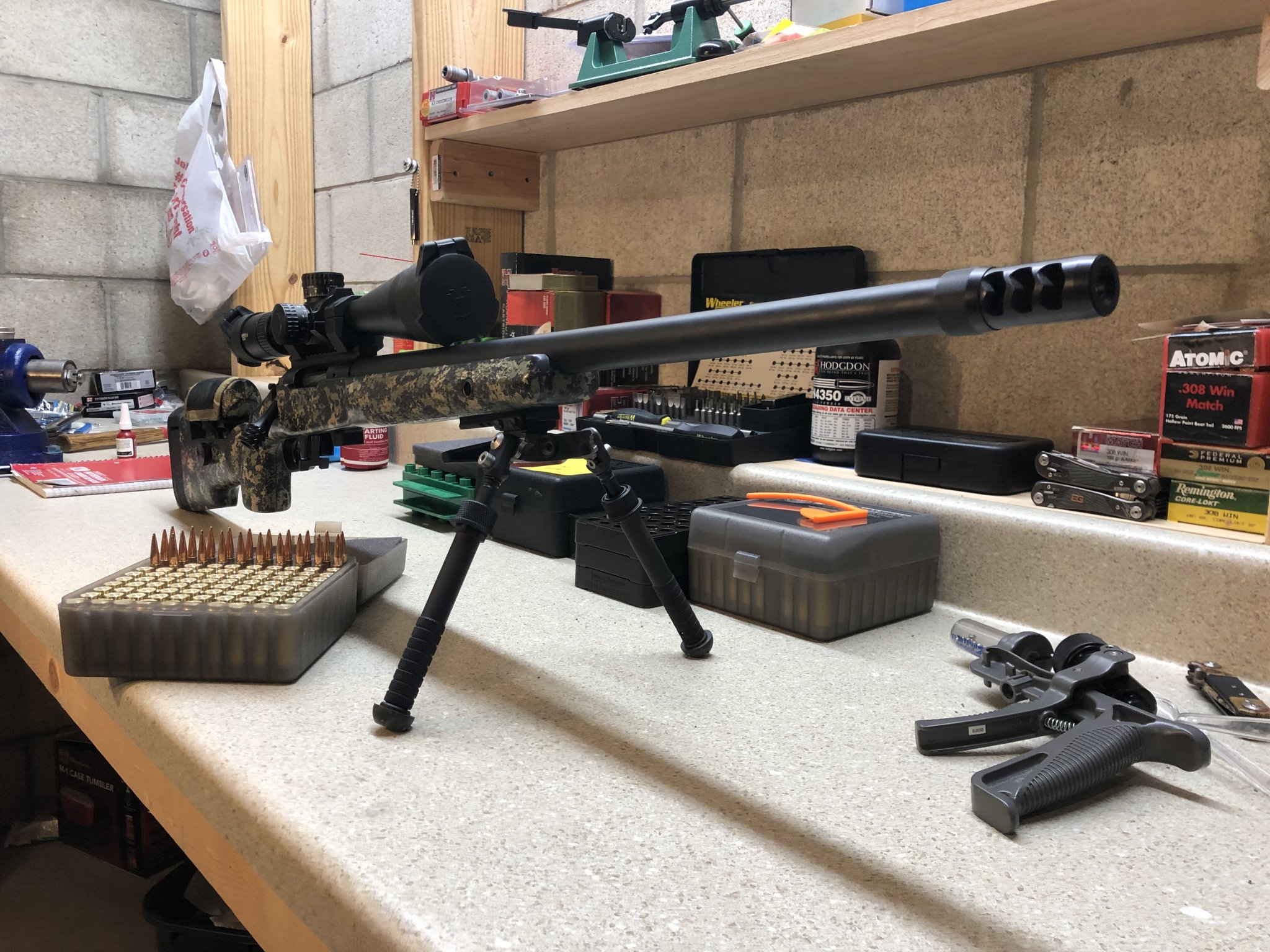

I just got my TL3 with 223 barrel from a hide member. PVA barreled it and it's shooting real good right now!
Did you check headspace or just thread it on? I know some people that will check and some who don’t with a shouldered prefit. Just curious what route you went... thanks

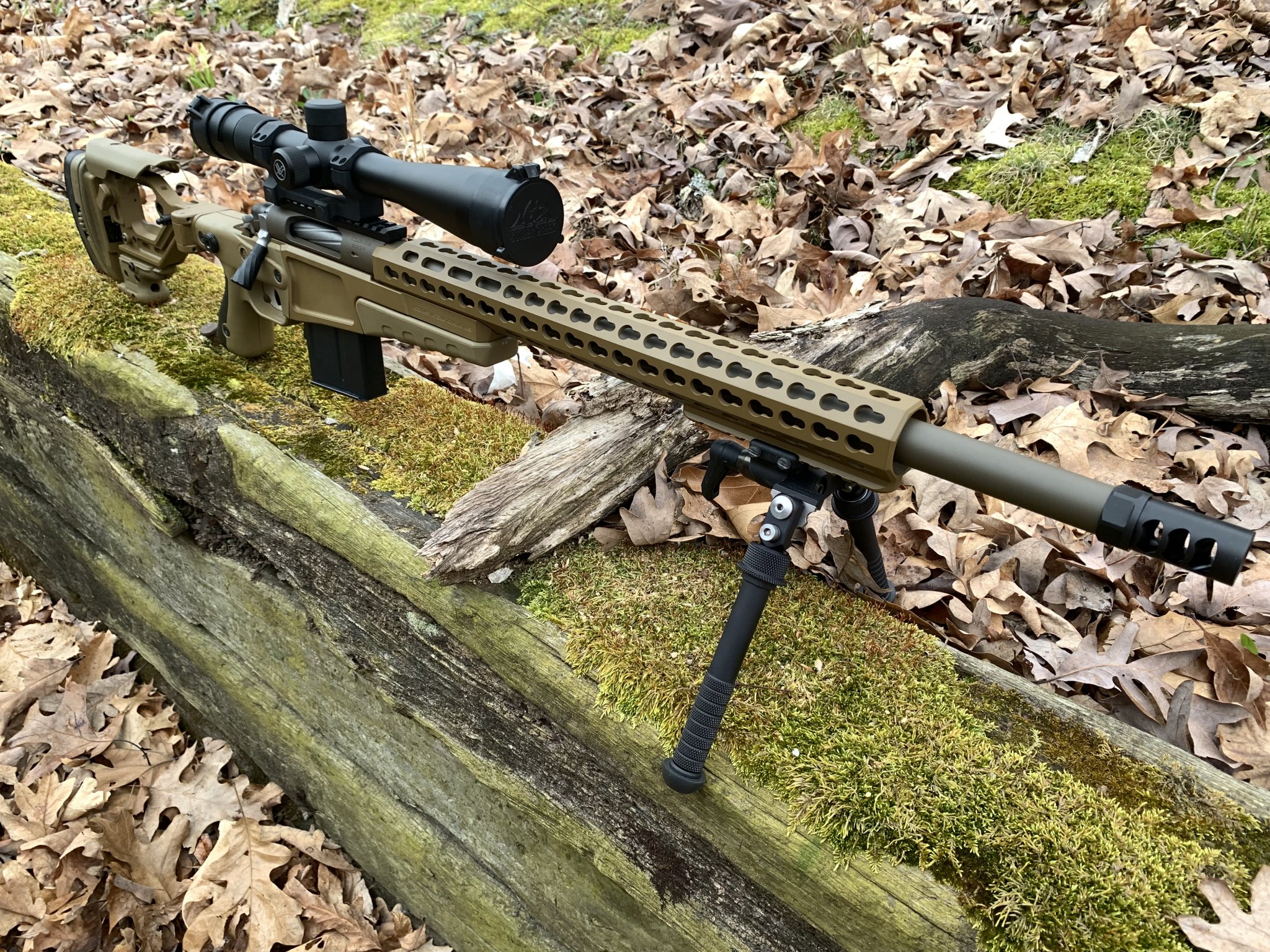

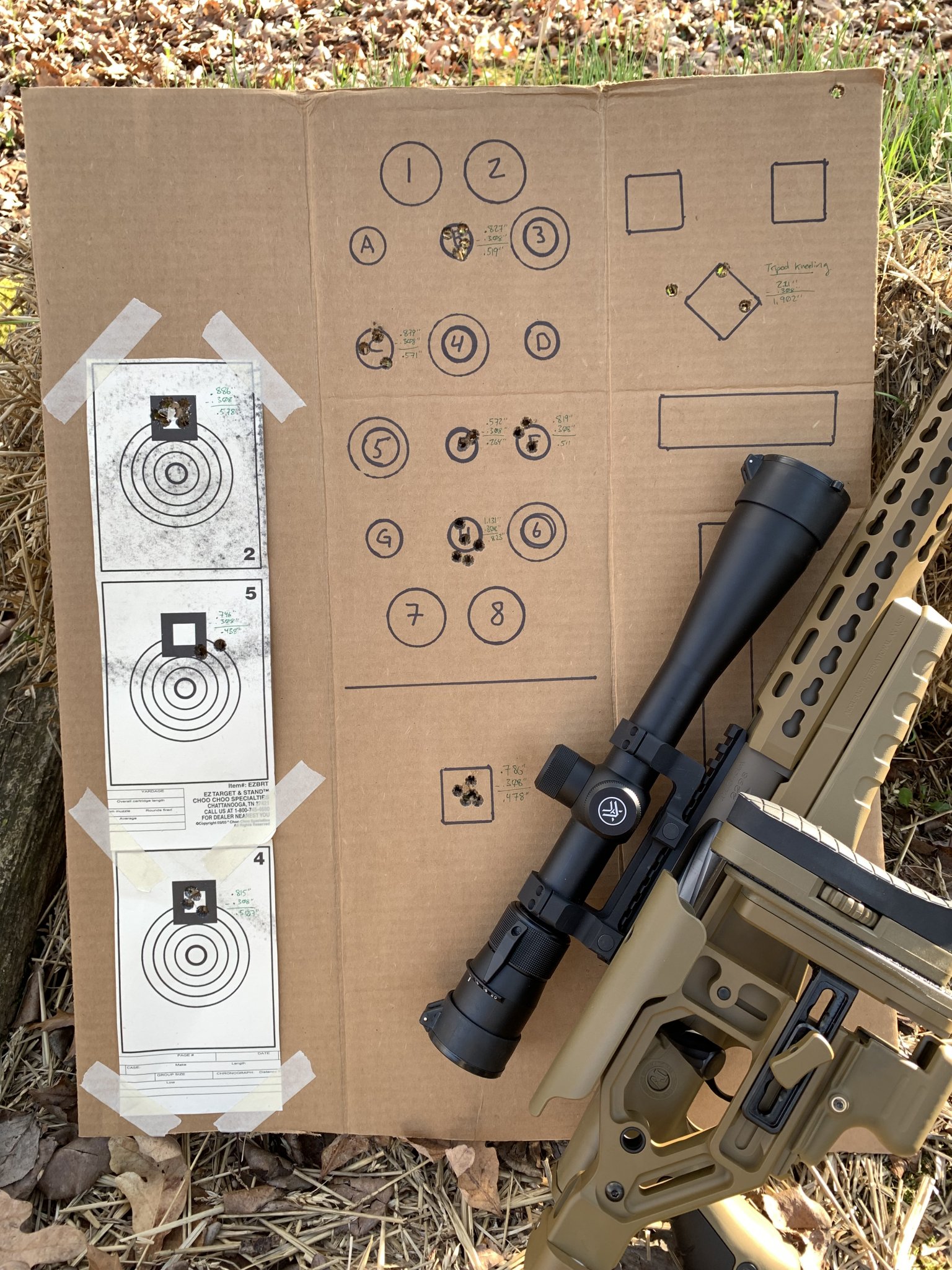

First post.

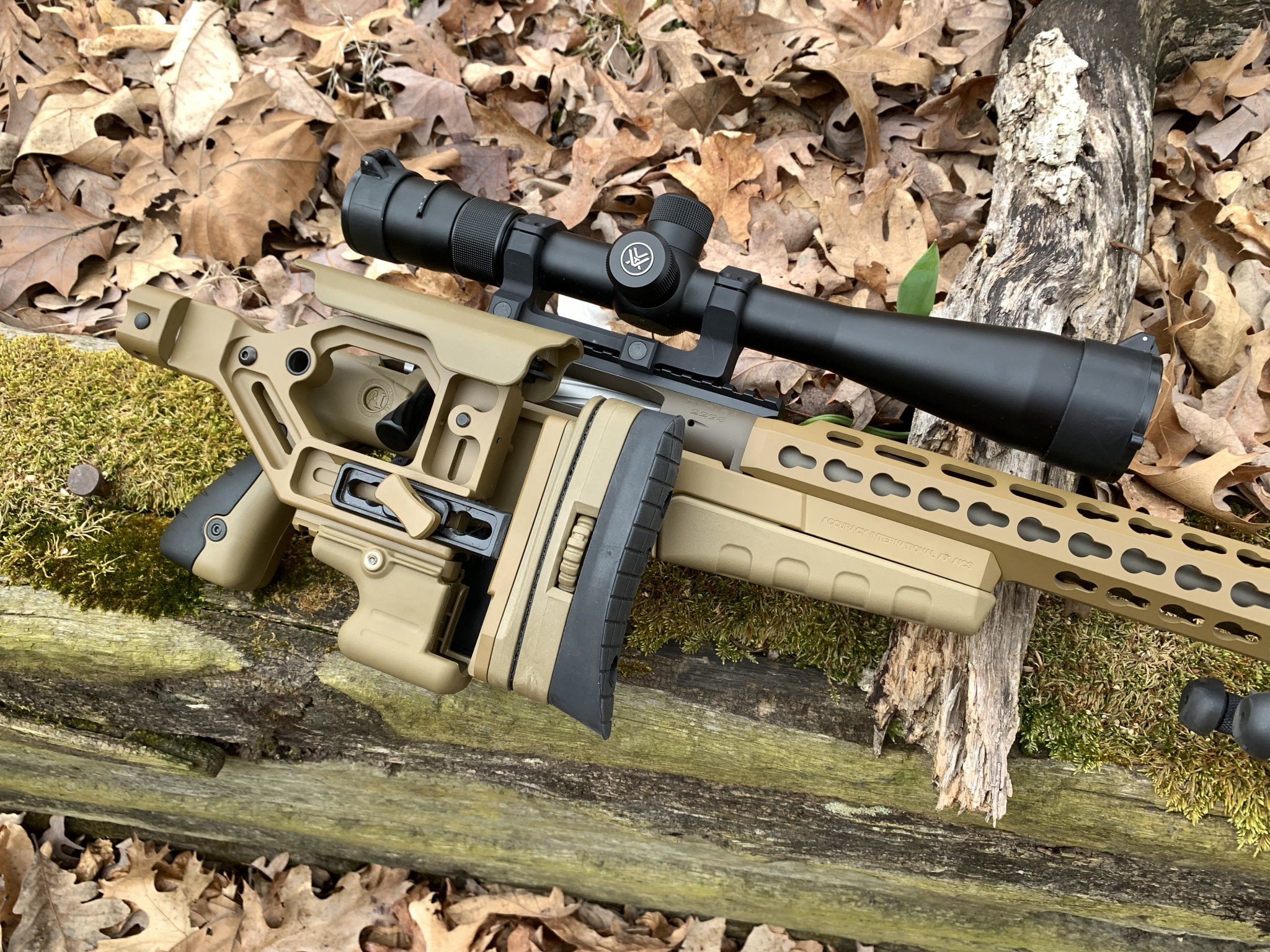

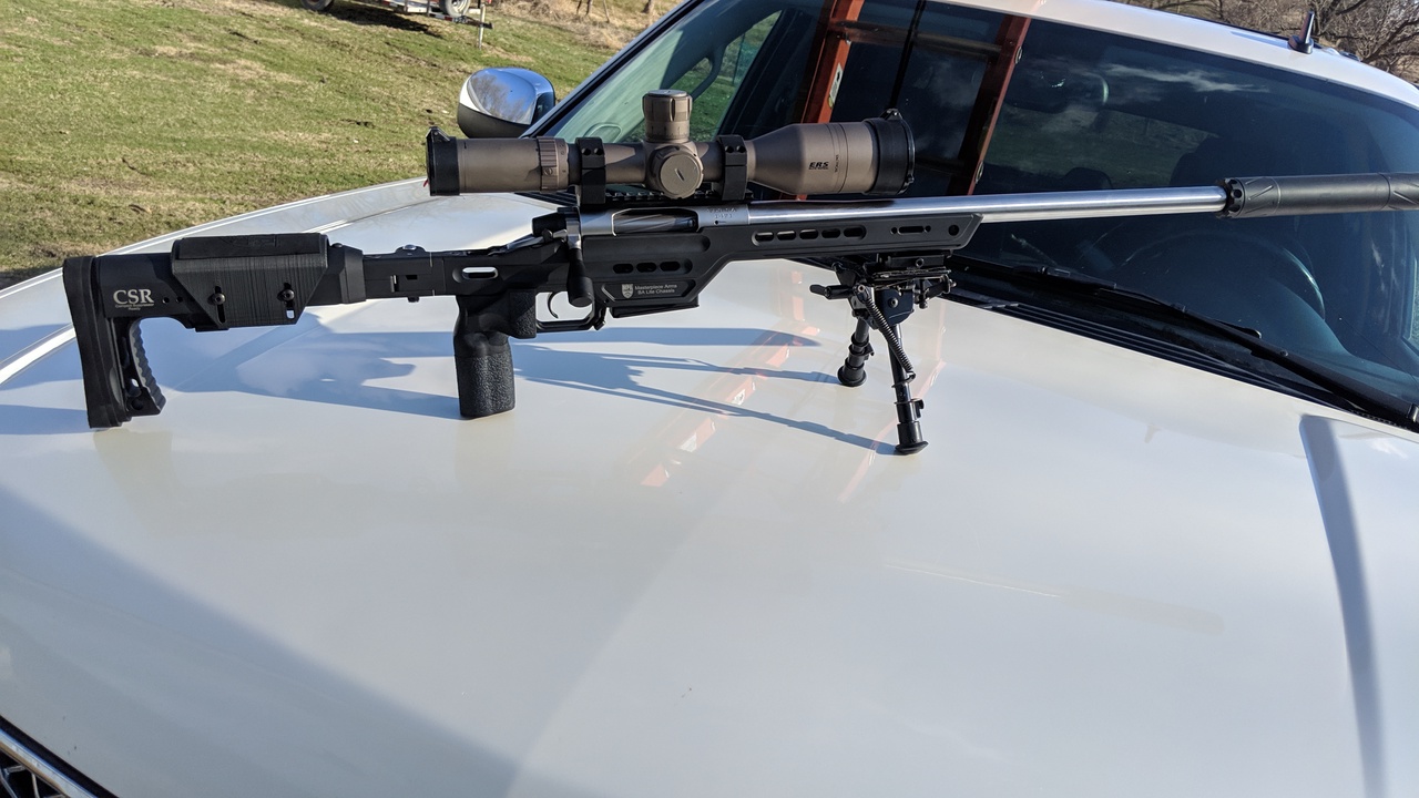

TL3 SA RH in a dark earth AX AICS (16” tube), both from Mile High. Bartlein 10 twist cut all Houston Warehousey by Matt Stewart in Oklahoma, .308 Win (Robert Gradous reamer). Bolt knob is the spiral one. Trigger is Geissele Super 700. Brake is APA LB.
Patriot brown cerakote, Mile High did the receiver and Matt color matched the barrel at his shop.
Scope is a placeholder, Vortex Viper 6.5-20x44PA mil dot in a Badger 1.4” Unimount.
Took it out to 538 yards, haven’t had it past that.
7056829
7056842
Skins needed to be relieved at rear of tang, and at the bolt knob. Recoil lug area was G2G.
7056831
Right folder is way more awesome than I ever figured it’d be, and I figured it’d be like fuckin titties.
7056833
Been putting 168gr FGMM through it, 10 shot at 100 yards.
7056834
Consistent shooting stick. 5 shots are averaging high .4’s into the .5’s off a bench with bipod and bag, 3 shots are averaging about the same with the occasional group in the .2’s. I’ll take it for factory ammo. Haven’t started loading for it yet, have medical shit to worry about before that.
Here’s a range day’s target. One 3 shot group kneeling unsupported off a tripod (Manfrotto and a HOG saddle), one shot my brother was going for a clothespin, the rest were just shooting for fun. A couple of the larger groups (easily identified by the shots that went abnormally low), were traced to my brake rattling loose. Once tightened sufficiently it has not moved and groups have returned normal in terms of aggregates.
7056836
Really slick action and hasn’t skipped a beat. Using 10 rd AX AICS mags mostly, but also the 5 rd one if came with. You pretty much have to try to make it bind.
