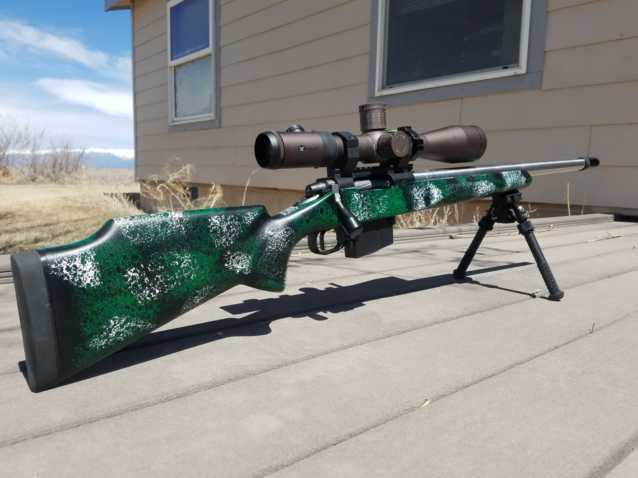

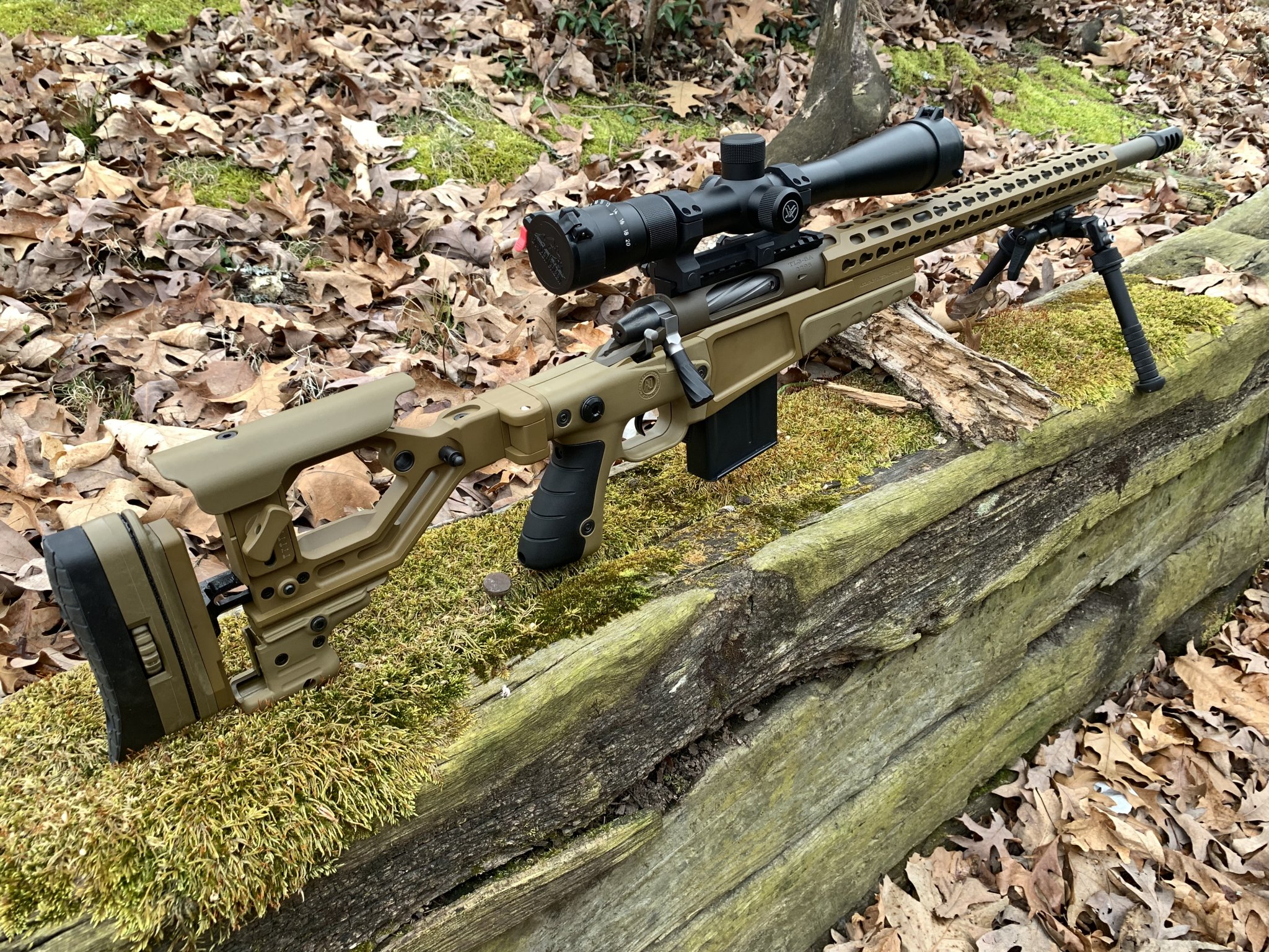

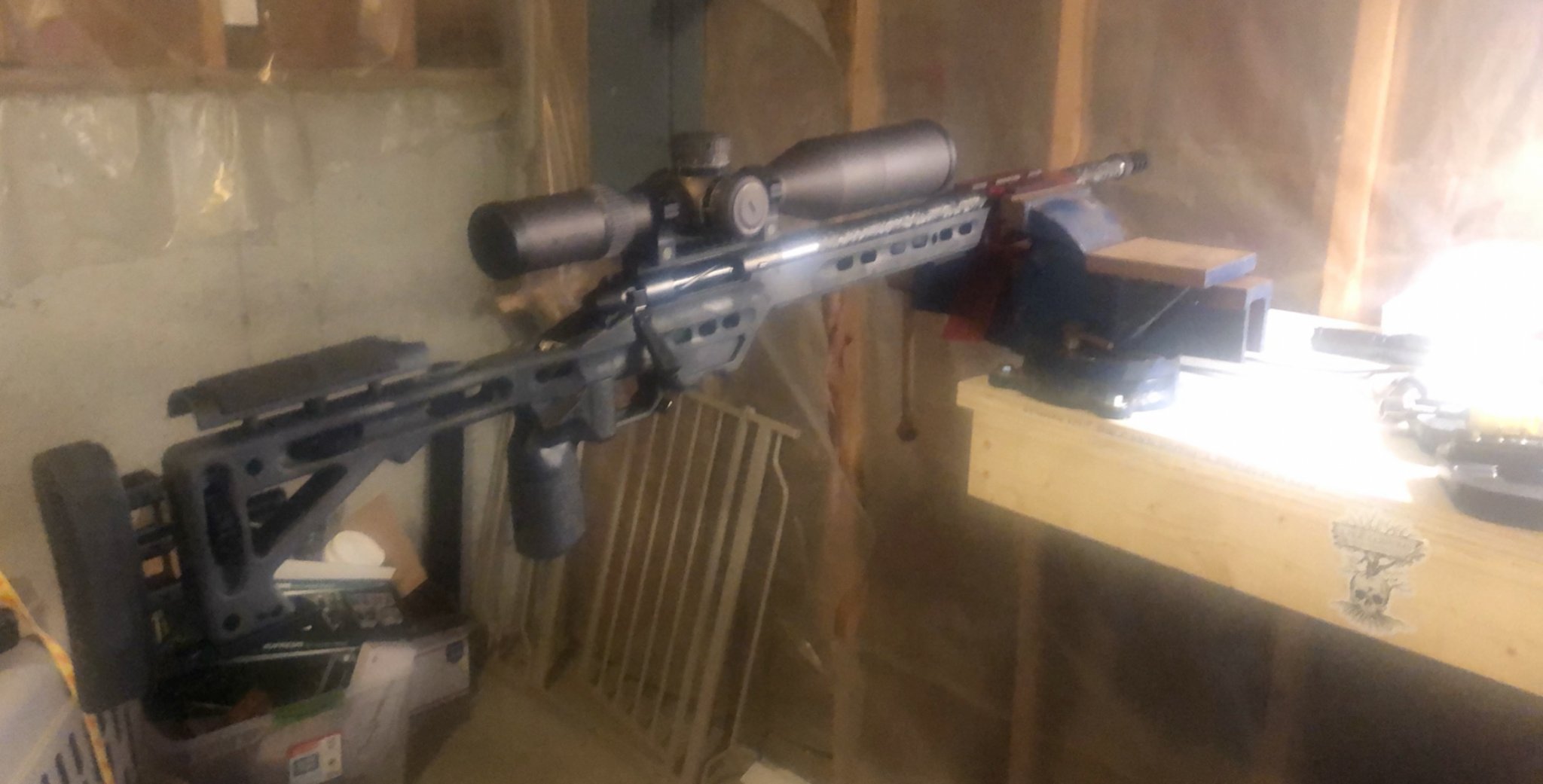

Just a quick pic from the ride home i like the all black.

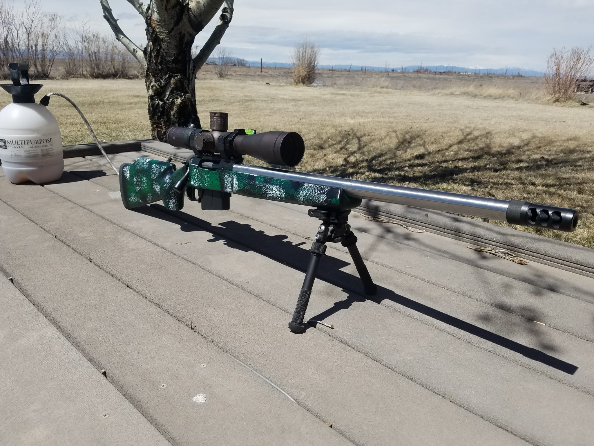

New TL3 build
Altus barrel 22 creed barlein
Manners T3 that i picked up for $320
Hellfire brake
Triggertech Diamond flatView attachment 7062106View attachment 7062107

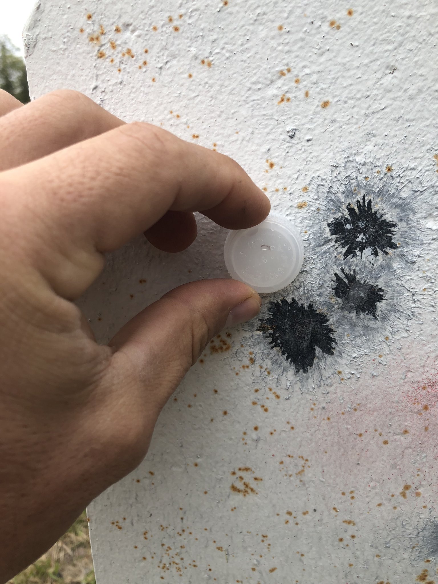

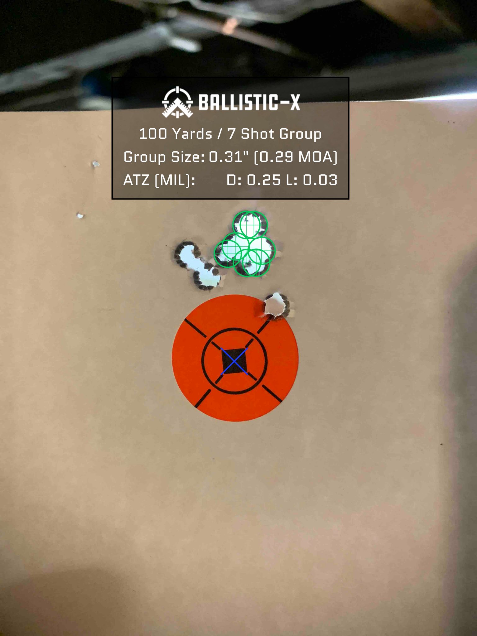

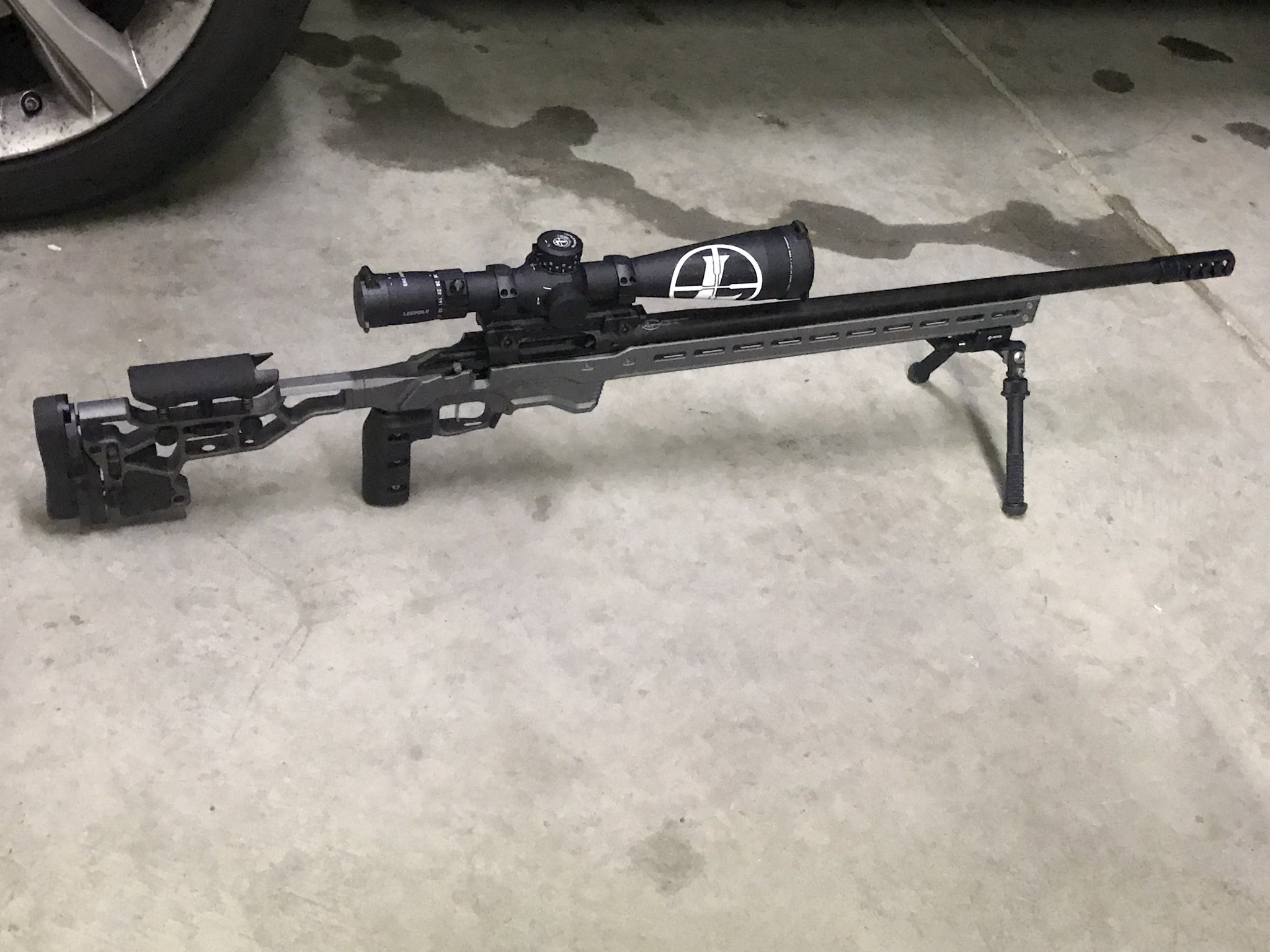

Finally put together and made the maiden voyage to the range.
TL3 SA
Proof Research CF 6.5 PRC
MPA Chassis
Triggertech Special
Razor Gen II
Hellfire Brake

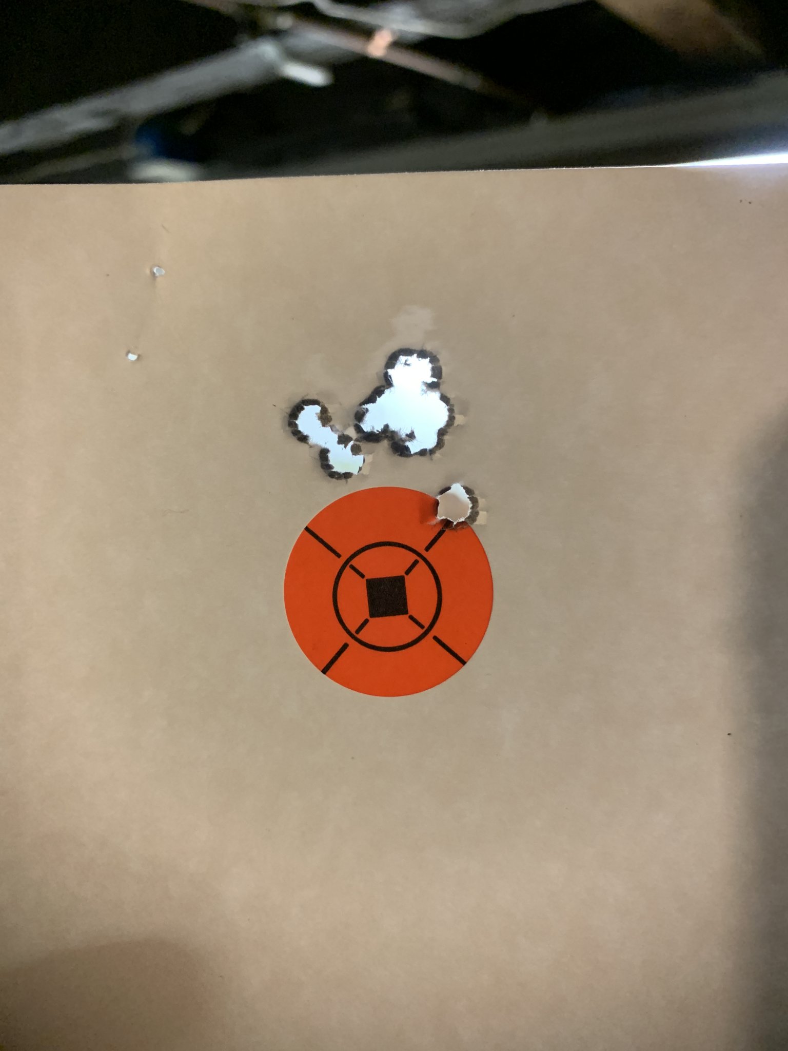

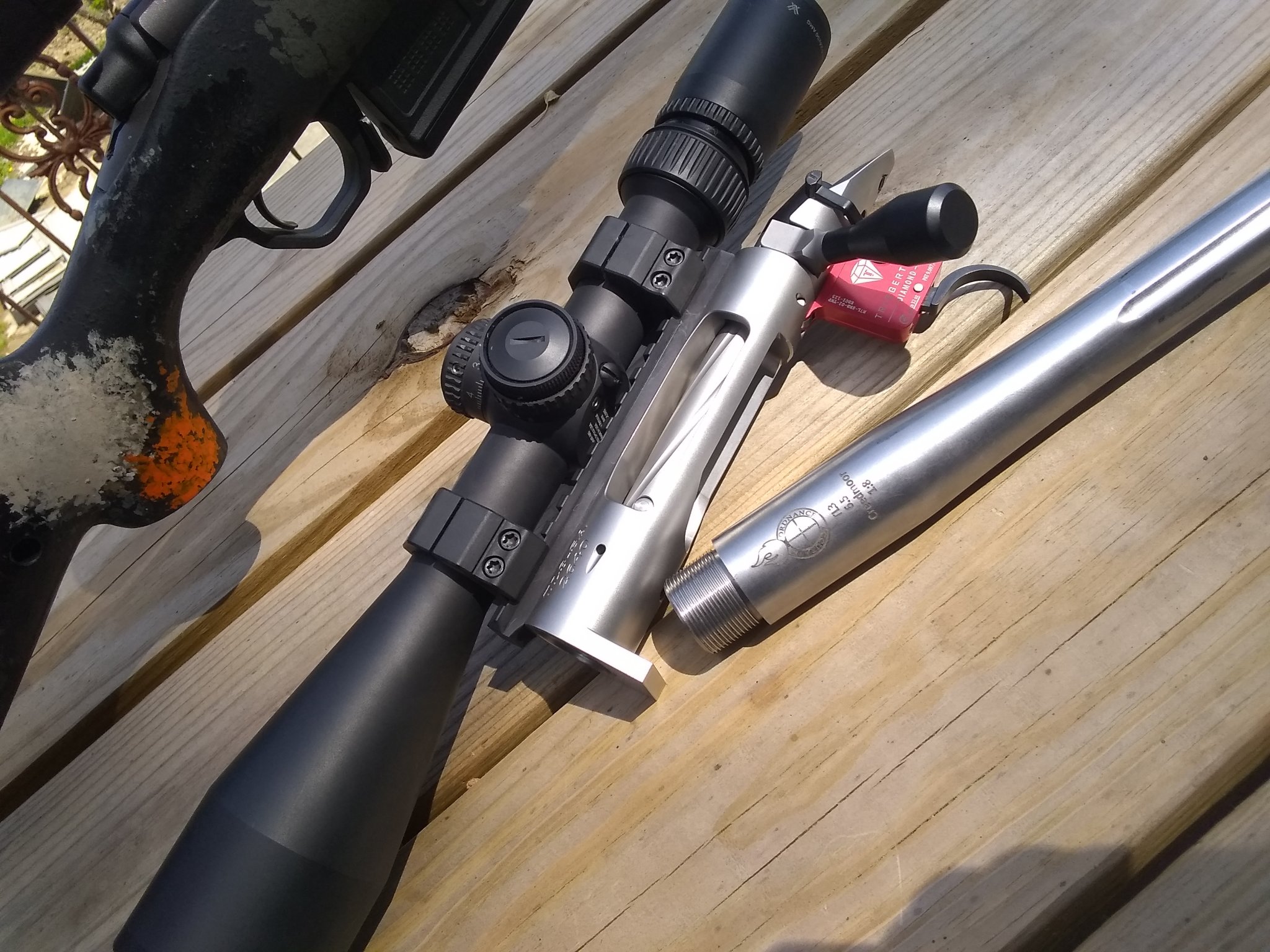

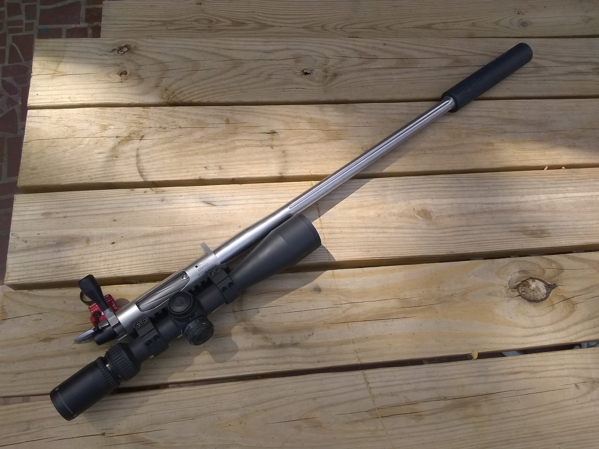

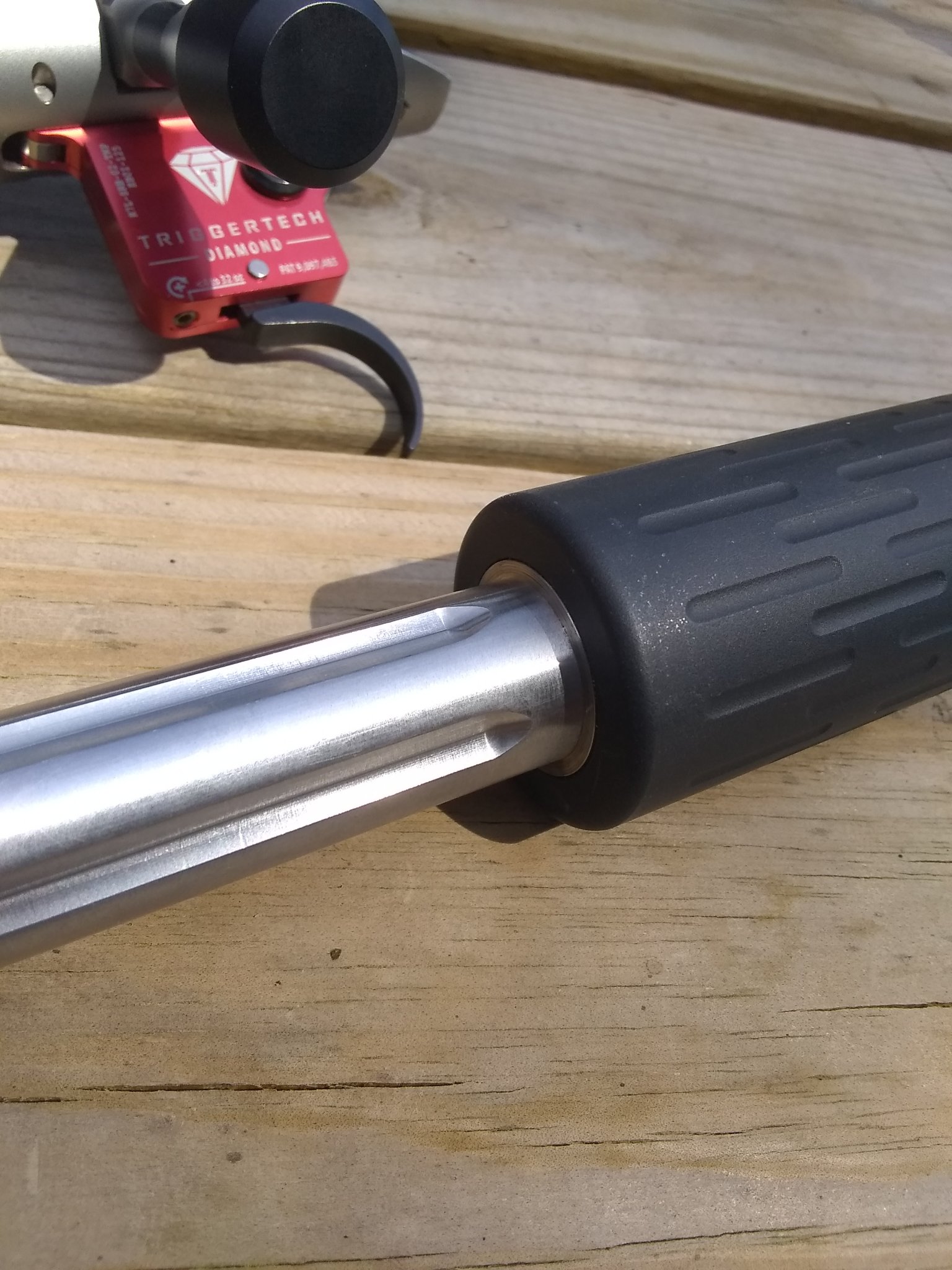

Just Incase anyone needs a pre-fit barrel spun up fast, I’d highly recommend Greg Young at Southern Precision Rifles/Bugholes. His lead time for pre fits is still 4 weeks right now.
This ones a Shouldered 26” 1:7 Twist Bartlein Heavy Palma in 22-250 AI. Still fire forming my Lapua brass, but the forming load shoots excellent. I’ve got almost 200rds down the barrel now. The 10 shot was as fast as I felt comfortable shooting, pulled three. Couldn’t be happier with his work and customer service.

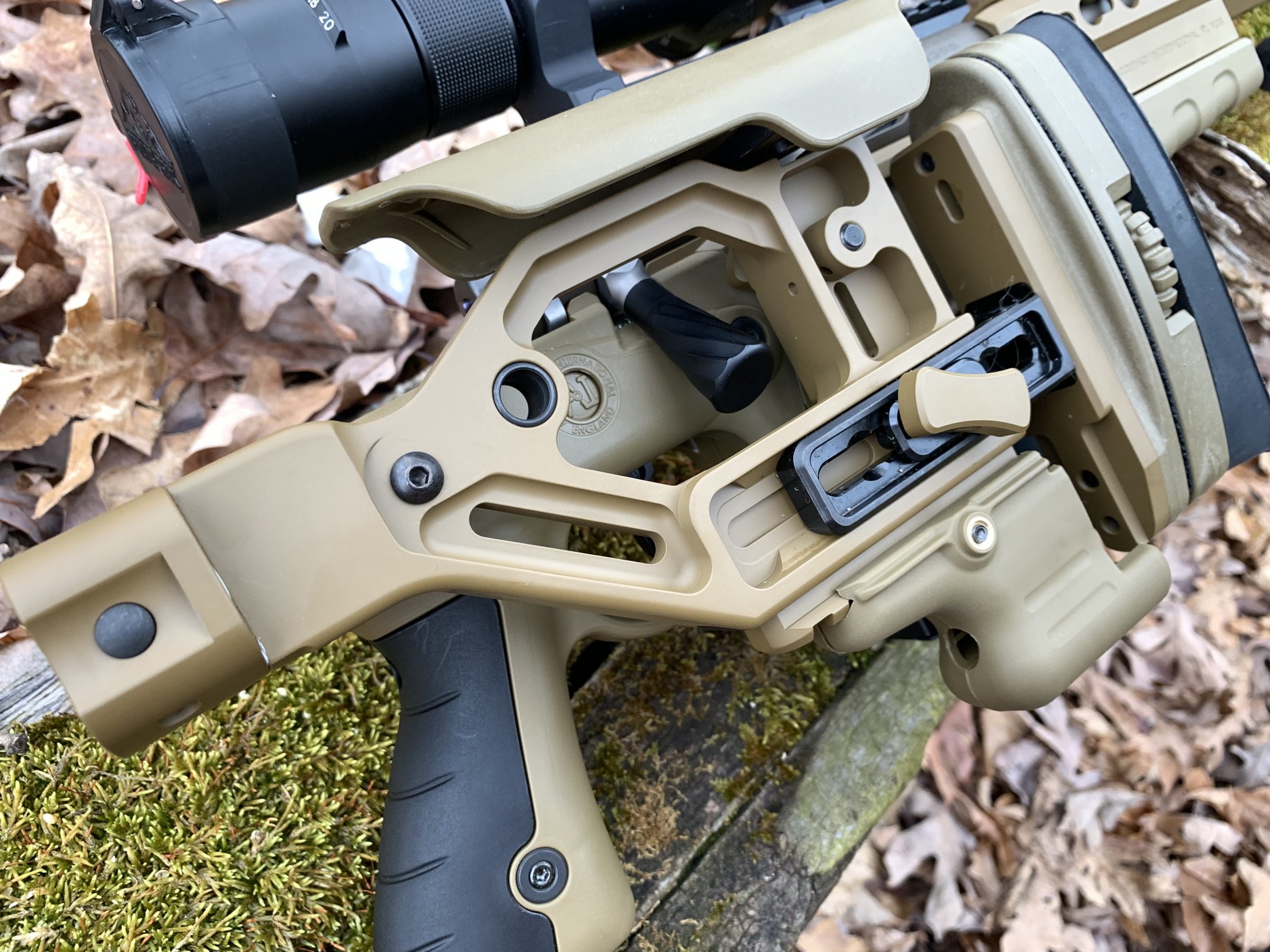

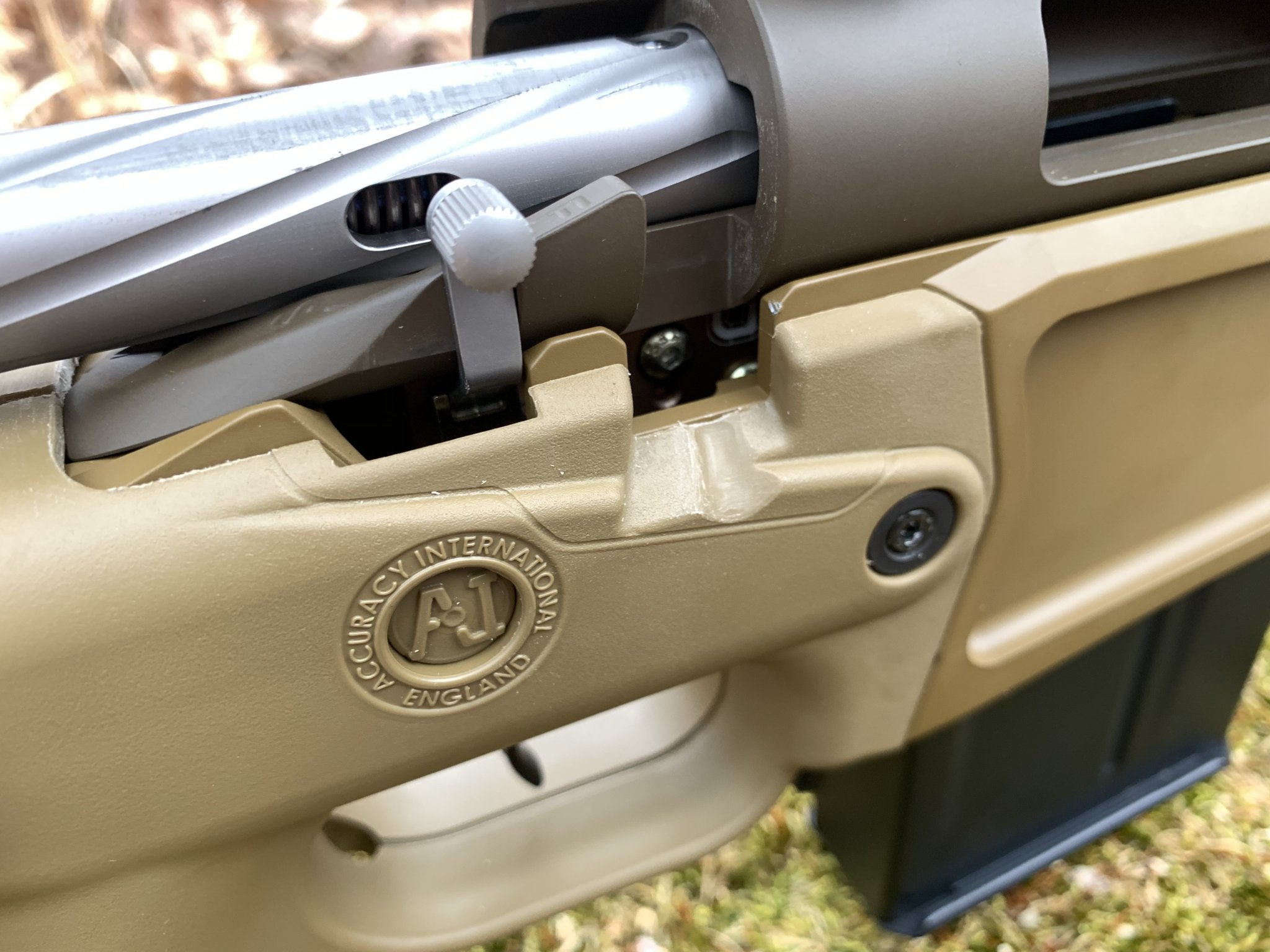

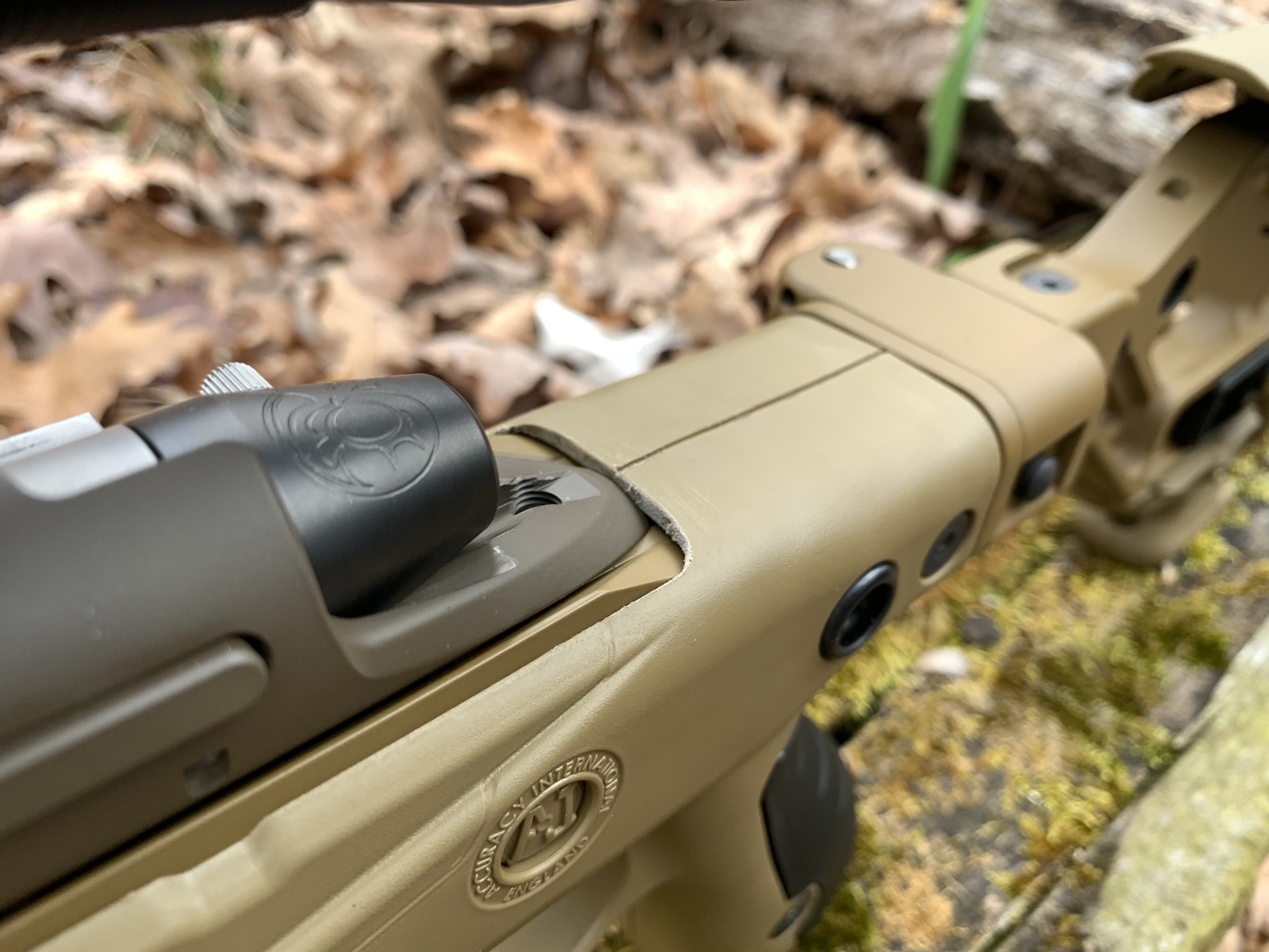

Anybody run a TL3 in an AX chassis? Does it fit w/o mods? Anyone have pictures? Thanks
Yes I do. No, it requires relief at the tang and bolt handle on the skins.
7086376
Relieved with a rotary tool and sanding drums carefully until a piece of paper won’t get stuck at any point from bolt body down, like relieving a barrel channel that’s contacting. Take down the high spots until they’re not there.
7086379
I don’t have a milling machine so I used files and the same rotary tool to relieve the skins where the tang is too long.
7086380
Clears bolt handle nicely when folded.
7086381
I love the combo. This chassis was purchased from Mile High back in March. Recoil lug clearance was checked and is sufficiently deep and makes 100% contact across the TL3’s lug. Great shooting gun.
