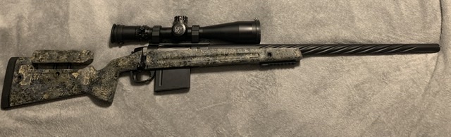

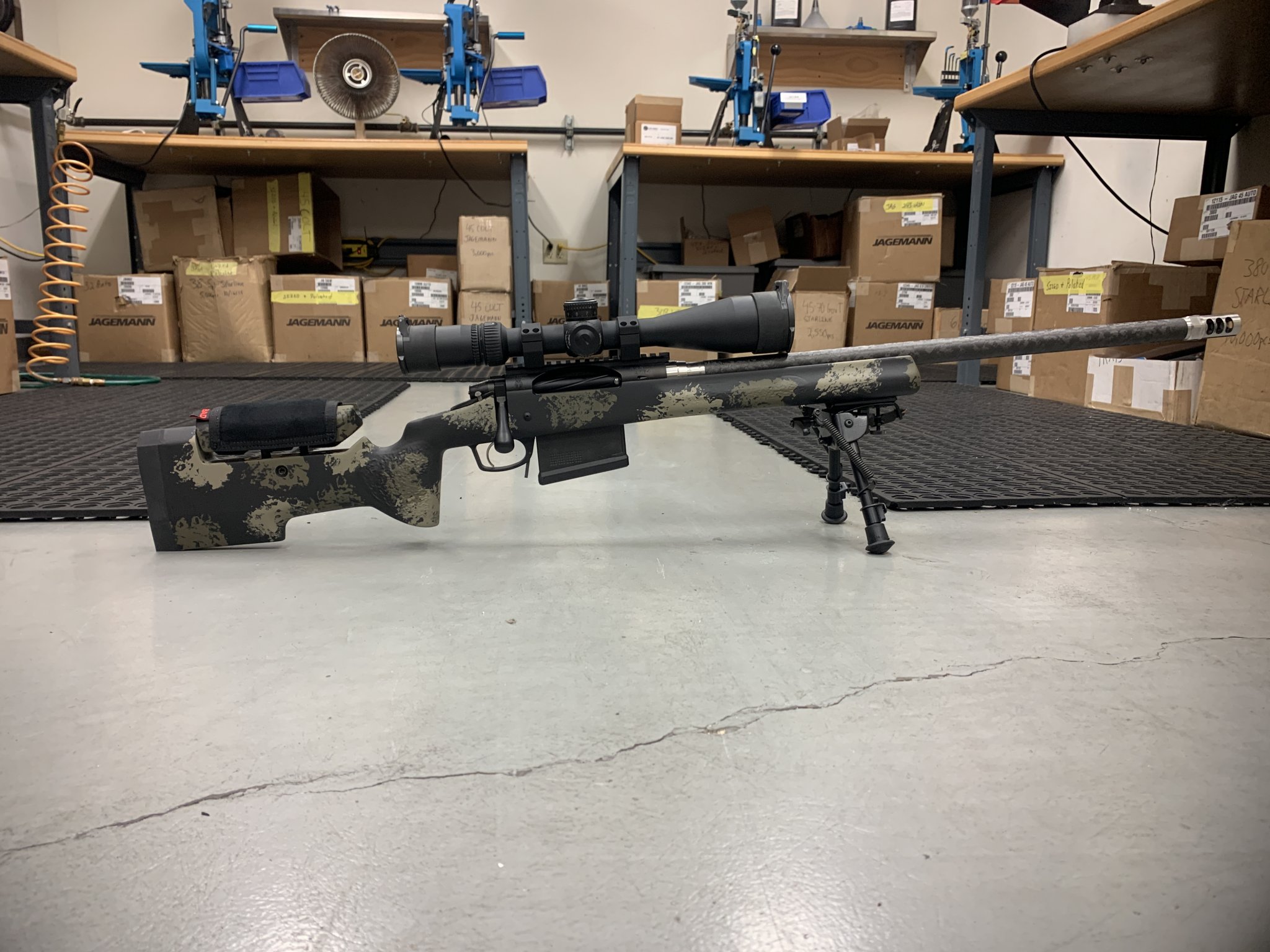

Was gonna wait to share until I got better pics but what the hell. Used to be in a Grayboe Terrain and had an XTR II. Traded the XTR II for this Manners T4A that was originally tan and cut for a Surgeon. Sent it back to Manners for a paint job and re-inlet for my SR3. Could not possibly be happier with this Manners and the company in general. Also upgraded to a Razor AMG EBR-7. Rifle has a Proof CF Savage Pre Fit chambered in 7 Rem Mag. After about a year of building it and changing things around, I’m absolutely in love with it.

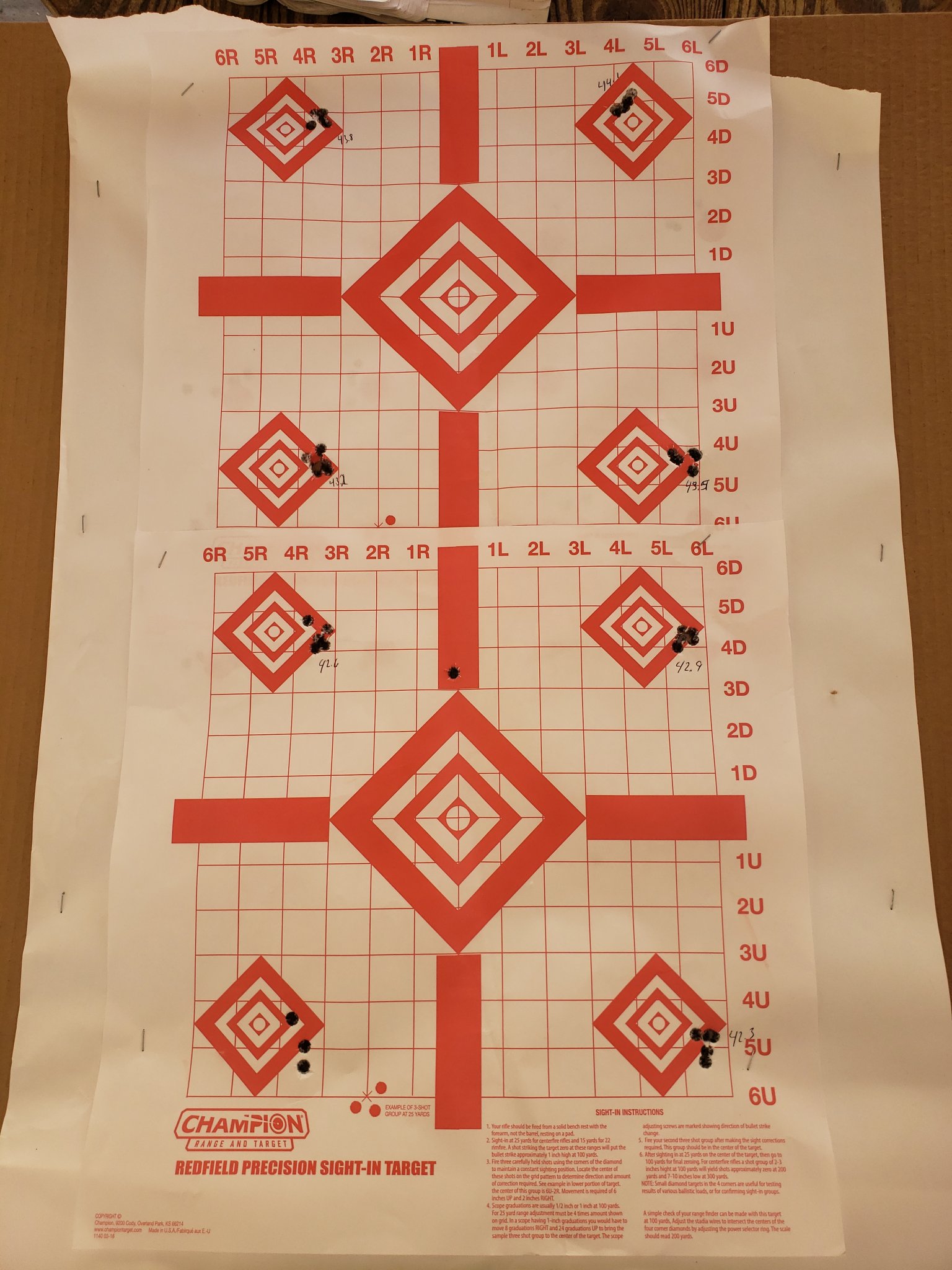

I love this thing, I've had 4 other 308 rifles this shoots and feels the best out of all of them. This is also the best and most consistent I've ever shot. The target has 8 groups of lapua 5 times fired brass, 4064 varying from 42.3-44.1, br2 primers and 175 smk at 2.800 oal. All except for bottom left is 5 shot groups and no more than 5/8" most hovering at 1/2". I'm going to go up in charge weight to 45.6 unless I see pressure signs, but so far this rifle has been rock solid.
PVA Tl3
24" m24 button barrel
Jet blast brake
Timney Calvin Elite
Xlr envy with bag rider
