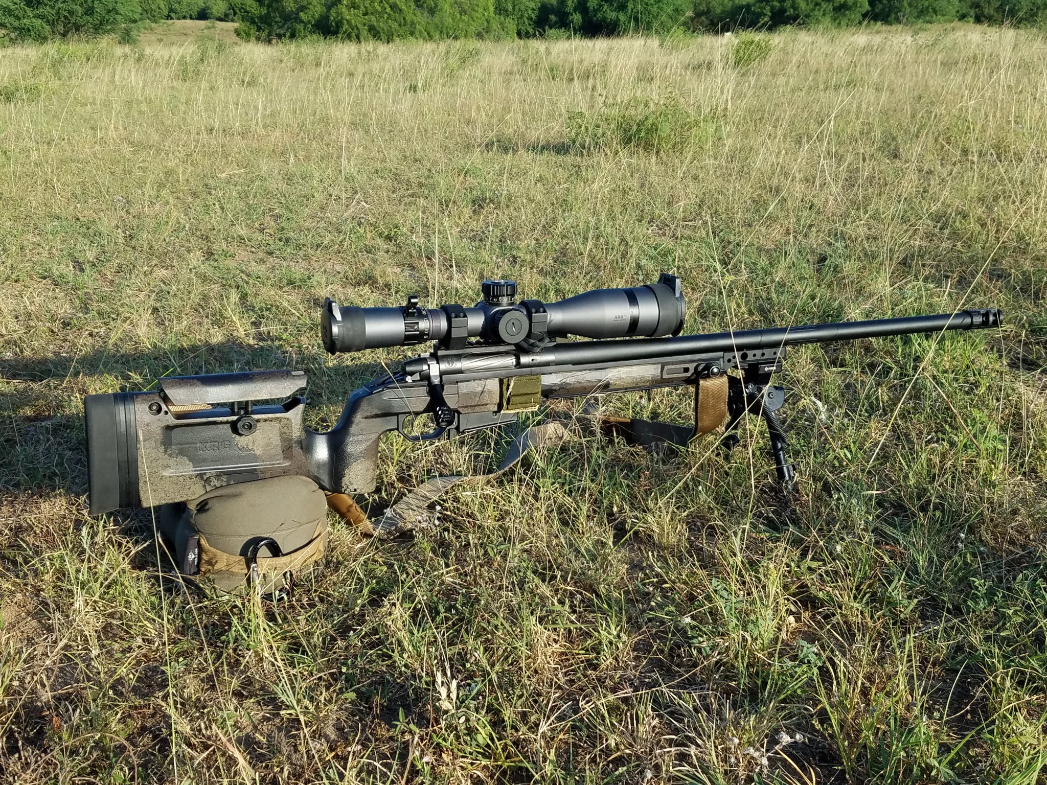

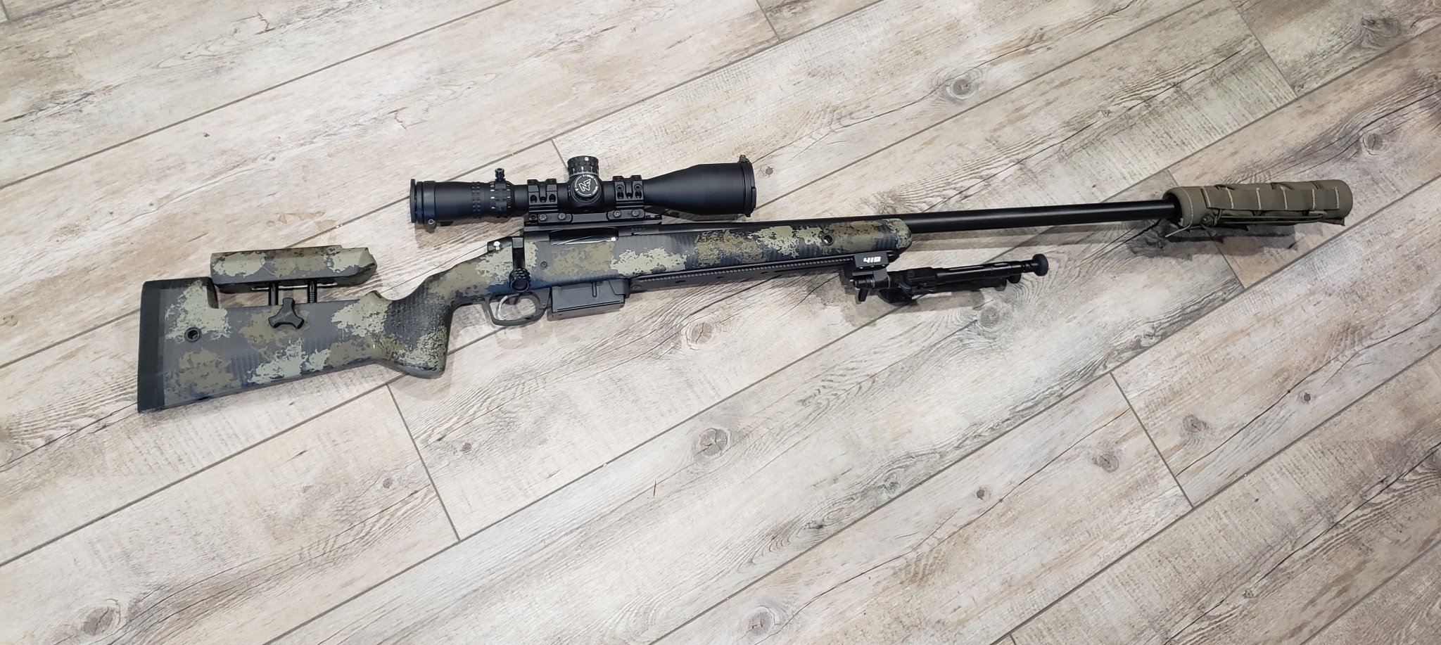

Bored so here’s another pic of the ol’ belted mag
not sure how many people this applies to. but i'm sure quite a few people have gotten an origin and then a TL3 after. we know Hunt makes a recoil lug to use TL3 barrels on an origin, but that doesn't work the other way.
I have a spacer made that will allow for the use of Origin barrels on a TL3
could potentially make a batch if there are enough people interested
18" 6.5 creedmoor barrel (Bartlein M24 1:8) currently on my action. Also have a 26" 6creed barrel (Bartlein Heavy Palma 1:7.5 4 groove) for it and they both shoot!
Manners T2AGAP in swamp w/ gen 2 mini chassis.

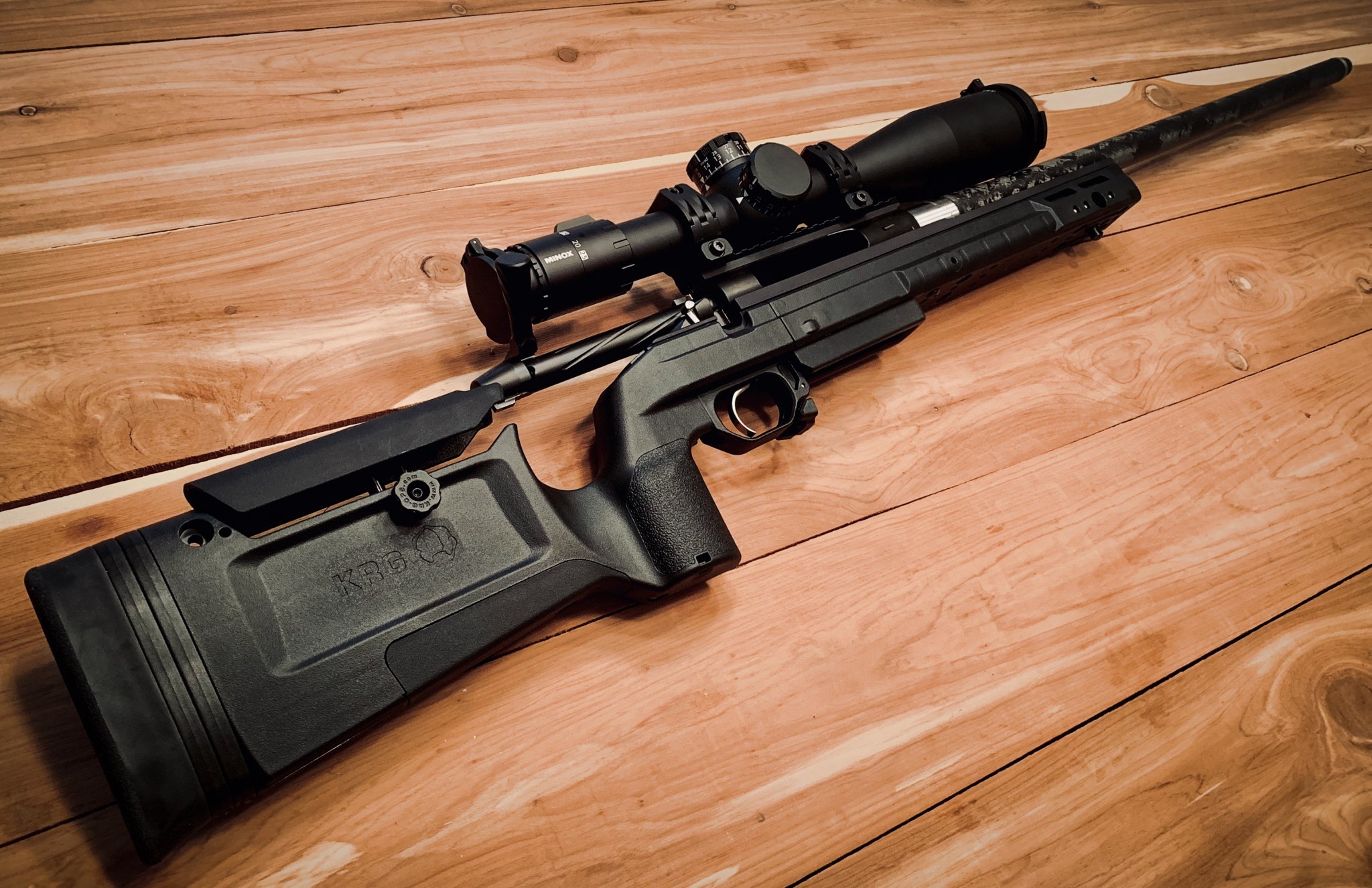

I believe this was addressed long ago but I can’t seem to find it,
The TL3 is a direct drop in to the KRG bravo stock?
If you're buying new, yes it will fit no problem. If you're buying used, some of the early Bravos used a different backbone and the recoil lug slot isn't big enough for the TL3. There probably aren't that many of those out there, but it would be worth checking in my opinion.

Question for those who dropped their TL3 builds in a KRG Bravo chassis, did you go with the trim, or the medium tang?
Thanks, that's what I thought but better to ask than be sorry. The medium is what I'm going to get; for a while I was thinking about getting the trim to avoid issues with whatever stock I might want to drop it in but the Bravo is my preferred and I like the medium tang better.
