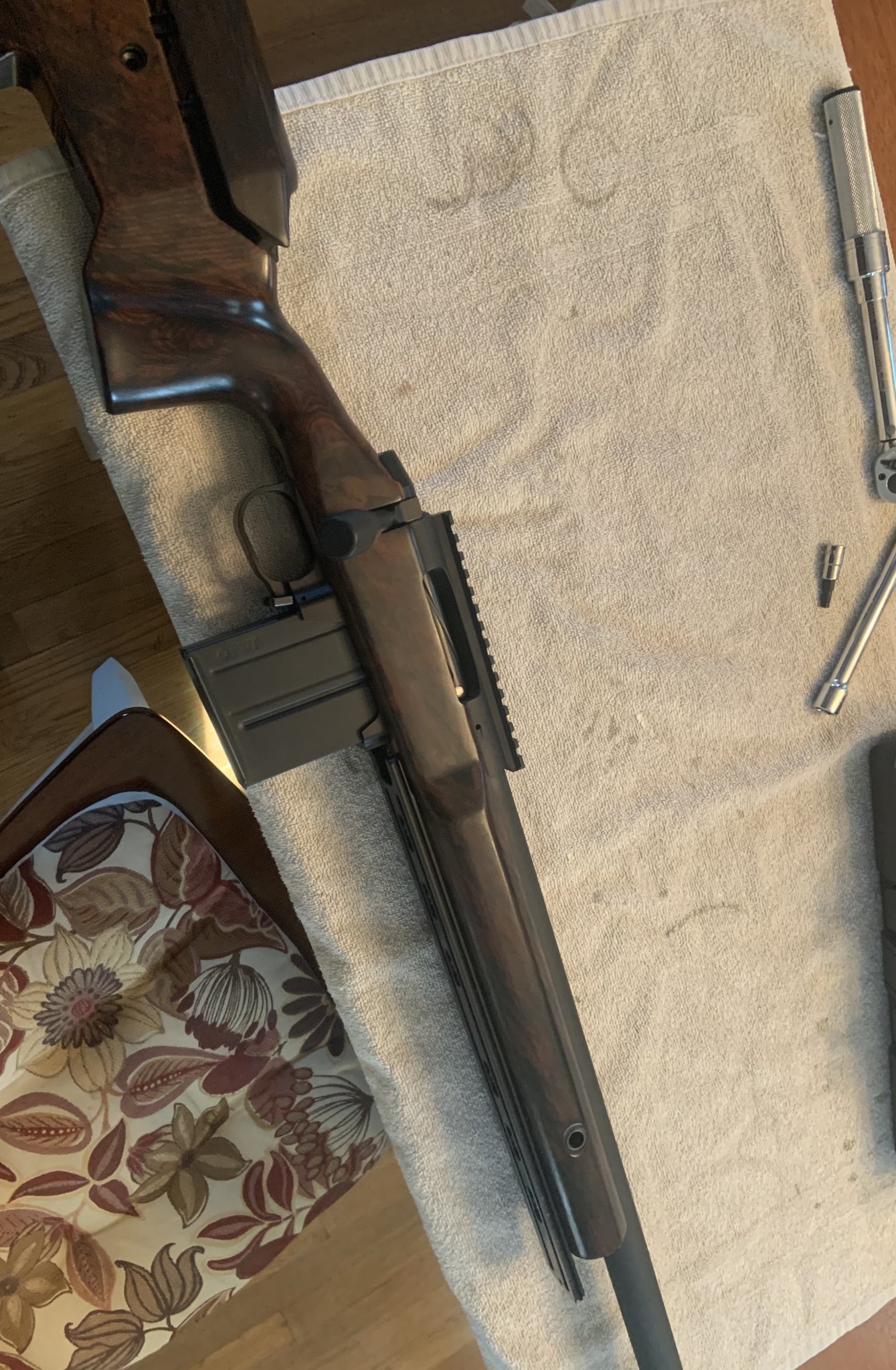

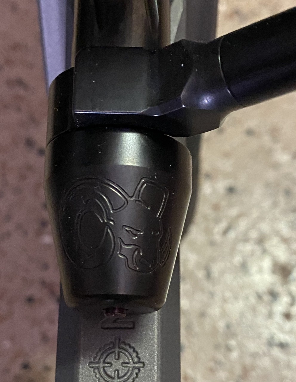

I just put together a TL3 in a whiskey 3 chassis. I know it’s supposed to be a straight drop in, but it appears that when if full lock up, the bolt handle just makes contact with the backbone of the chassis. Is something that needs to be relieved or should I just run it as is?
I just put mine in an x-ray and noticed the same thing. I will be notching for full lockup and lug engagement.

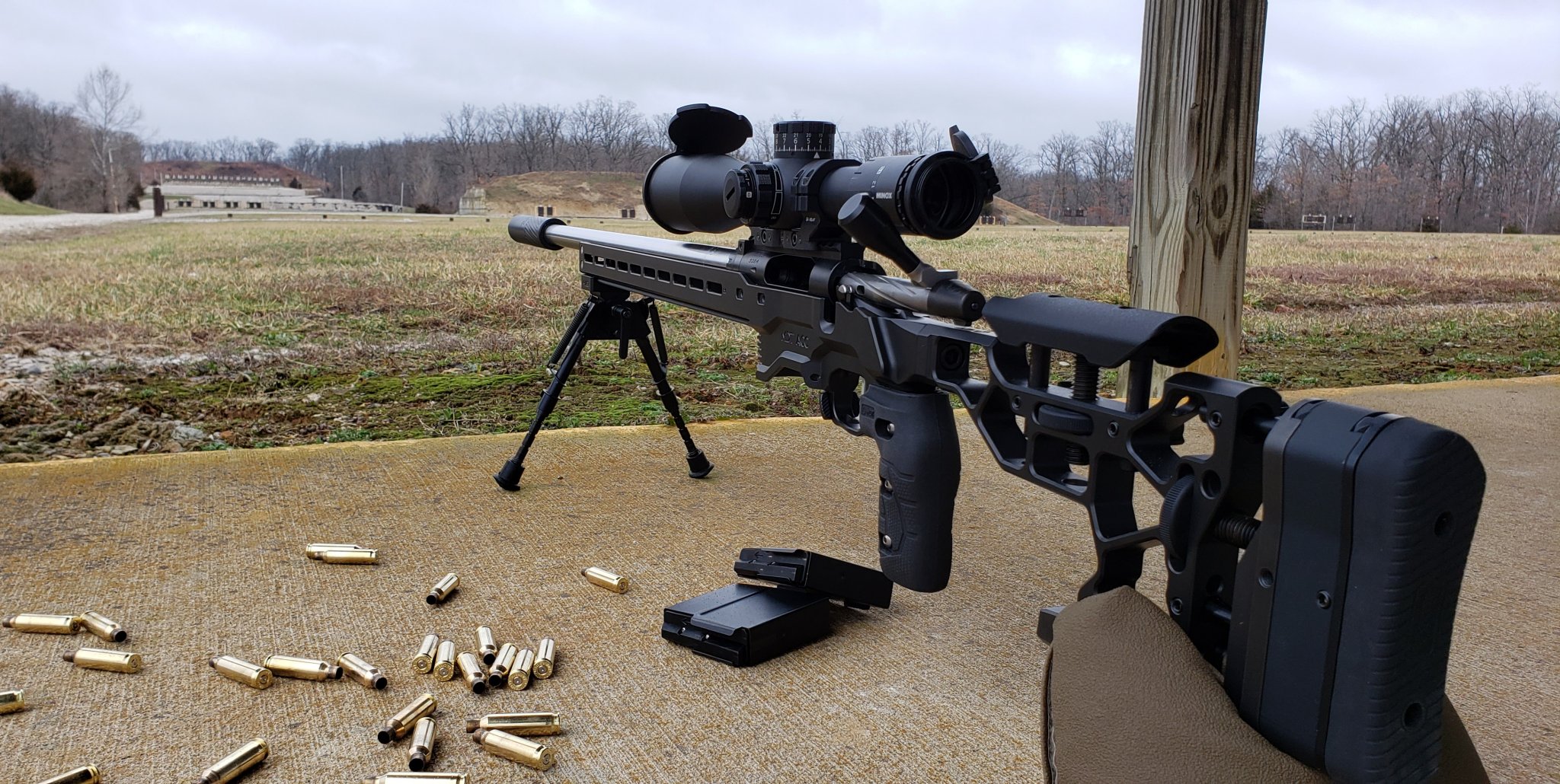

Finished my TL3 build and used it in a match last weekend.
TL3 Lefty
26" MTU Criterion barrel in 6.5creedmoor
MDT ACC with lop spacer and bag rider
BixnAndy Tacsport pro 2stage
Minox zp5
Mpa mount
Area 419 arca adapto
Harris bipod
Thunderbeast ultra 7 6.5
Aw mags
I love it. Working up loads now
