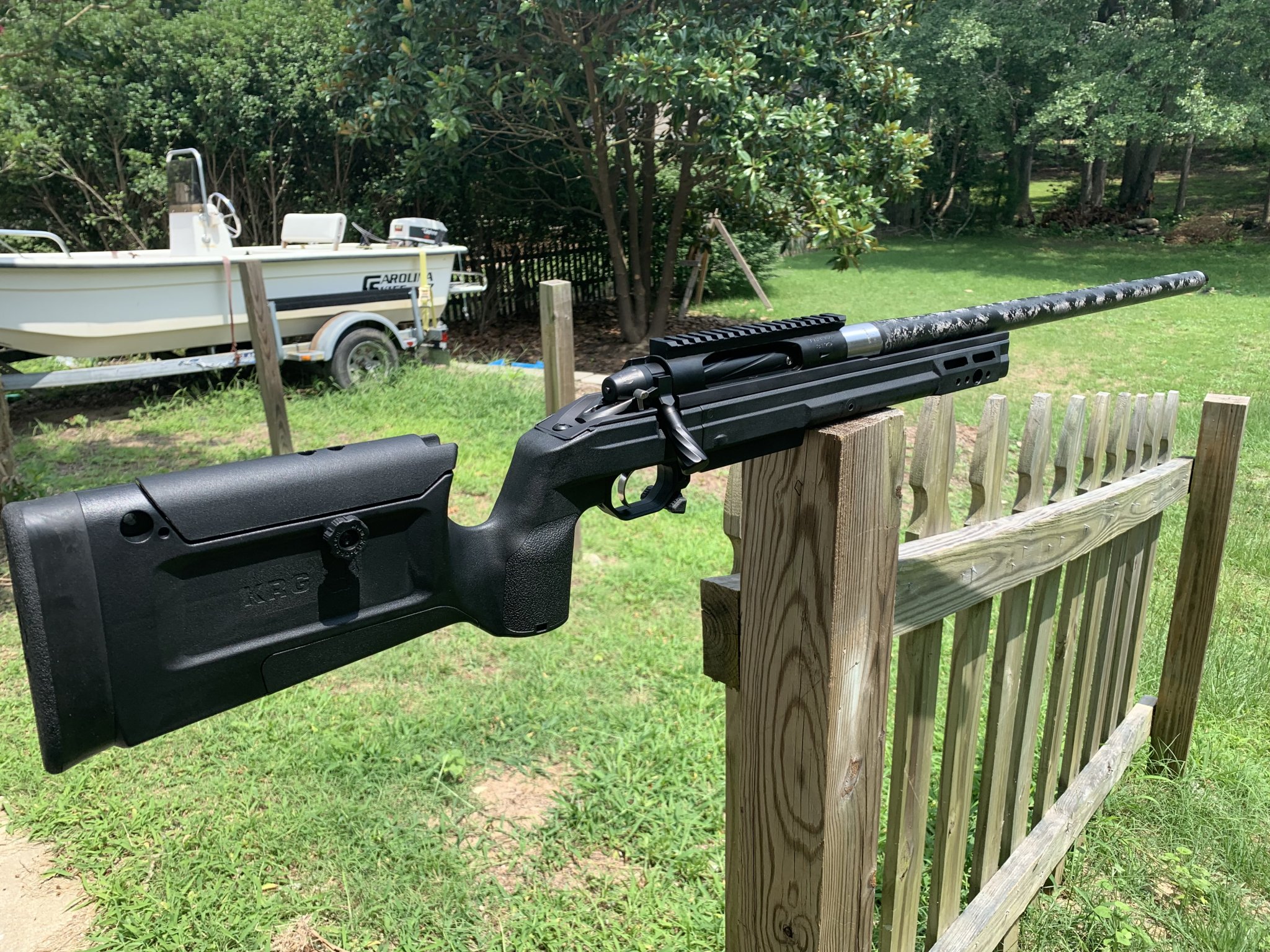

New rig put together by Shaen Magan
(Shooter71 here)....
6 BRX .120 freebore .292 neck
Bighorn TL3
Hawk Hill 7 twist Marksman
Trigger Tech Diamond
KRG Bravo temporarily
108s running 2970 on FF’d brass don’t suck. Trued DOPE out to 1200 and reckon it’ll make the cut. Top plate is 3 @ 600, second is 1k with a 1/10 put in after the first shot low. ES/SDs are single digits....

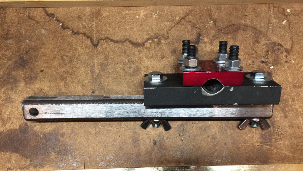

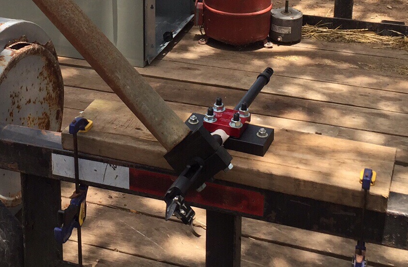

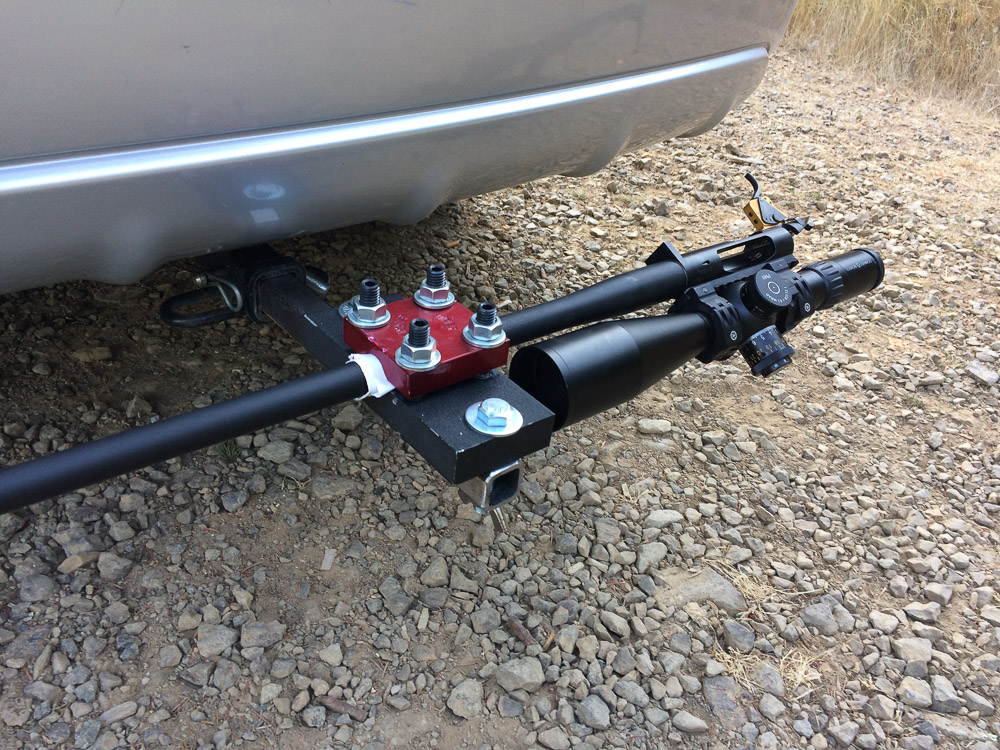

How much torque is everyone putting on their barrels when changing them? I have a 6.5Cm and .223 barrel and have been doing 60 lbs when switching in my garage but I’d like to start doing it at the range, I read some things saying benchrest guys don’t even torque em down they just snug them up by hand or a firm press on the wrench and call it a day and shoot the next barrel.
I use a Ross vise and about 35 ft/lb. Haven't taken my action out of my chassis in the last two dozen barrel swaps. Return to zero is very repeatable.
That’s a neat vise. Wish I would have bought that one. I have a viper barrel vise, I was gonna construct a mobile sort of attachment for my truck hitch or brainstorm something else to be mobile with it
I just drilled holes in a 2x board, ran bolts up from the bottom (you can spade bit a brief moment to remove material to sink the head in flush if you want to get fancy) and then just clamp it to a table or tailgate or whatever.
7117996
I just drilled holes in a 2x12 board, ran bolts up from the bottom (you can spade bit a brief moment to remove material to sink the head in flush if you want to get fancy) and then just clamp it to a table or tailgate or whatever.
And you bring this to the range with you? I was thinking something along these lines somehow attached to a trailer hitch extension of some sort or off of my tailgate
Drill a couple holes in a piece of square tube and you're G2G. That's what I used before I got the Ross Vise.
Well, no, I have my own range only a couple hundred yards back into the pasture so I do it all out back in the shop or drive way if its too hot inside the shop. But I could just as easily clamp it to the truck tailgate as I did to that trailer rail as pictured. Or a shooting bench, or counter, table, post, telephone pole etc. You can clamp it anywhere.
Sheldons is more elegant. Mine is just dirt fucking simple lol
