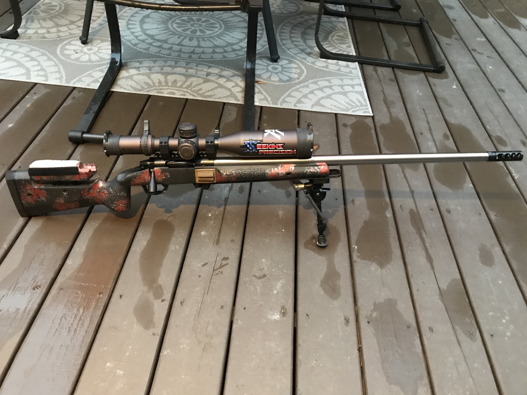

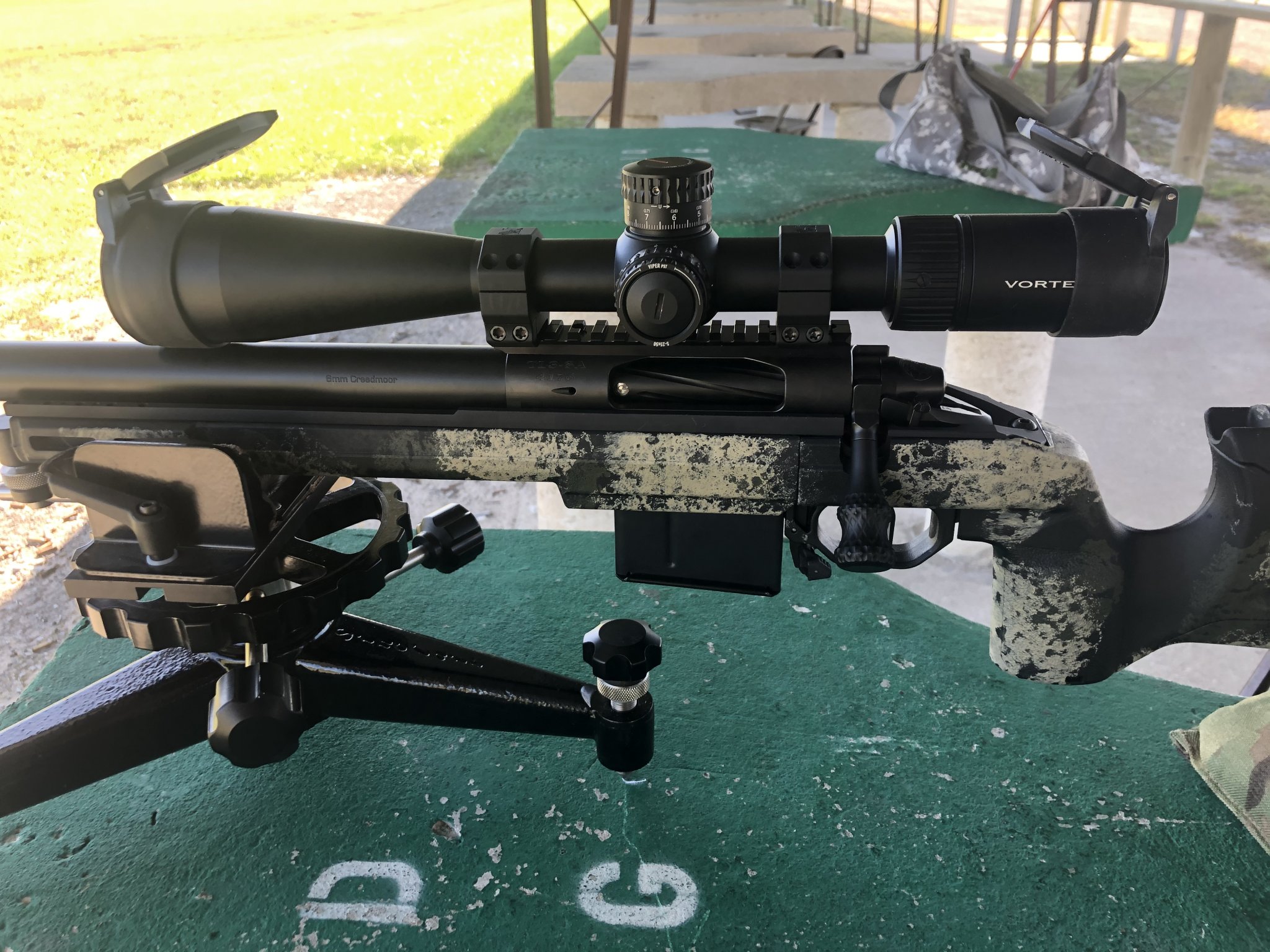

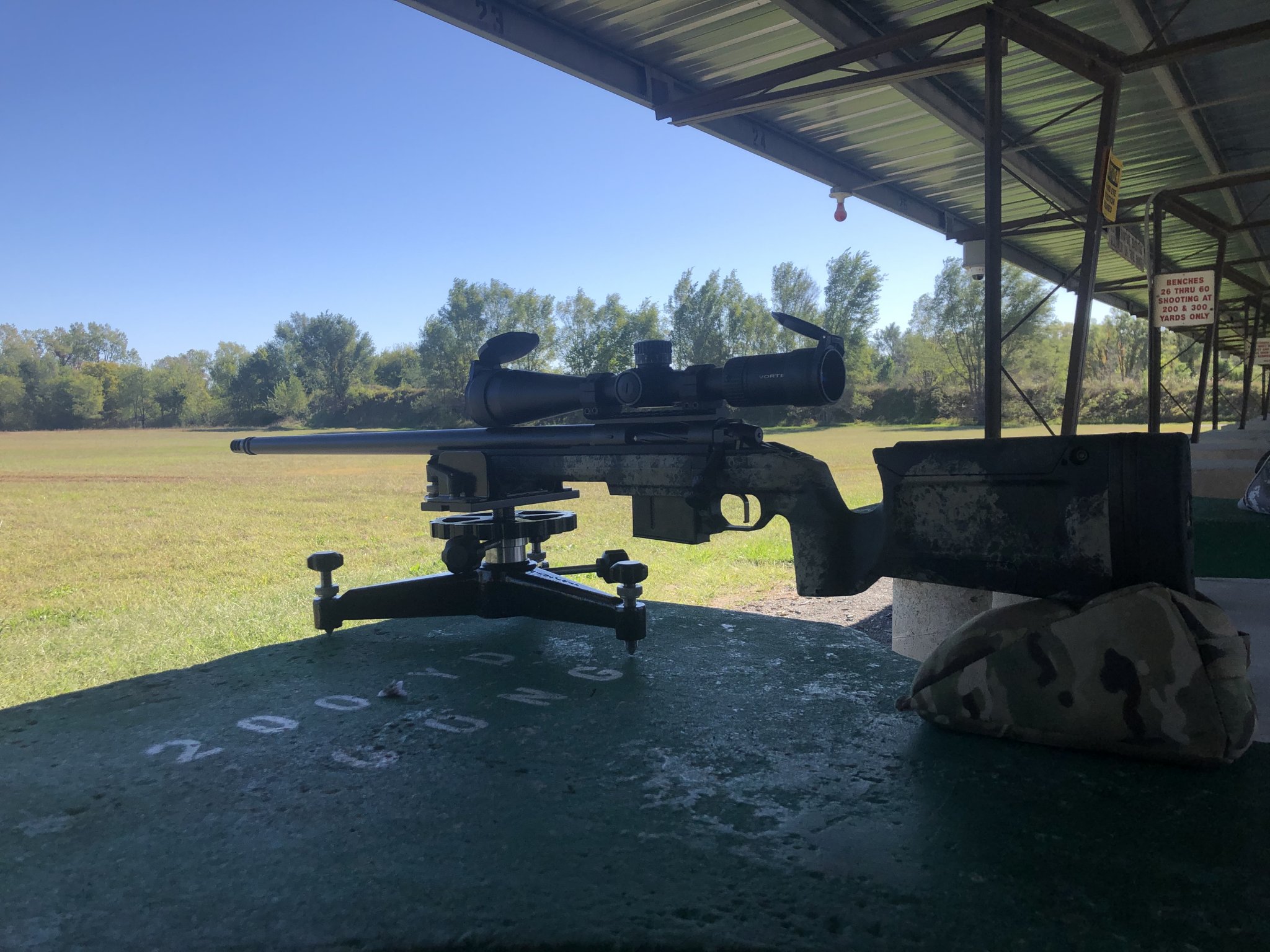

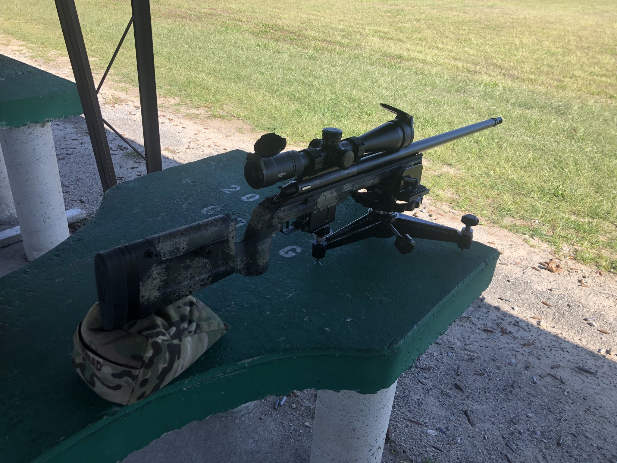

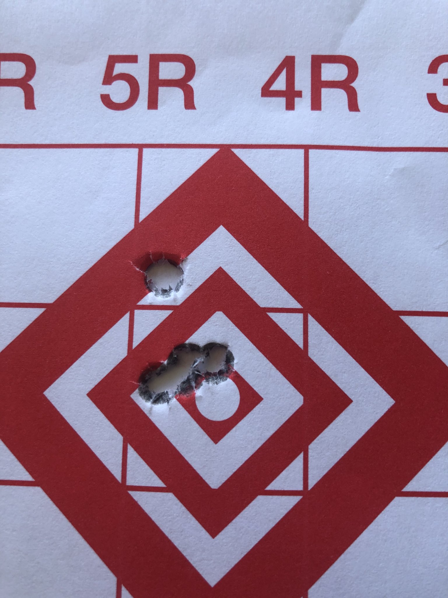

Alright, today was an awesome range day! I showed some details on this build earlier, but it is finally complete and barrel break in is very promising.
First, a little back story. Back in 2016 I decided to build a 6mm creedmoor and planned on doing a savage barrel swap. I bought one from a company in Louisiana and the guy took my money and disappeared. After almost a year I was finally able to get a refund, and at that time PVA just released the John Hancock rifle. I put down a deposit for a lefty 6 creed and waited, and waited, and kind of just forgot about it. Two years later with no rifle to speak of, in April I said F you jobu and I did it myself.
lefty dlc coated TL3
Bartlein m24 profile 25”
Trigger tech diamond
KRG Bravo
Vortex pst gen 2 in their pmr rings
I started barrel break in this morning and just threw some 107gr nosler cc’s over 40gr of H4350 at .020 off the lands. I will do load development after 100 rounds of so, but this thing is a hammer! This is rounds 11-15, the top shot was on a clean bore and went a little high, but the next 4 will work for me!

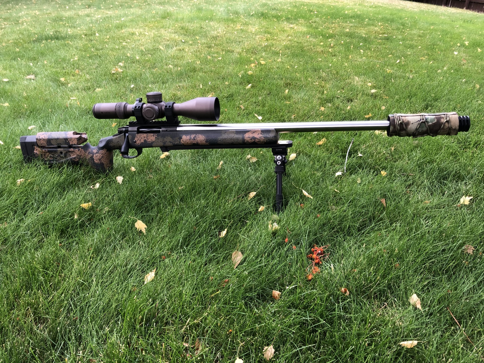

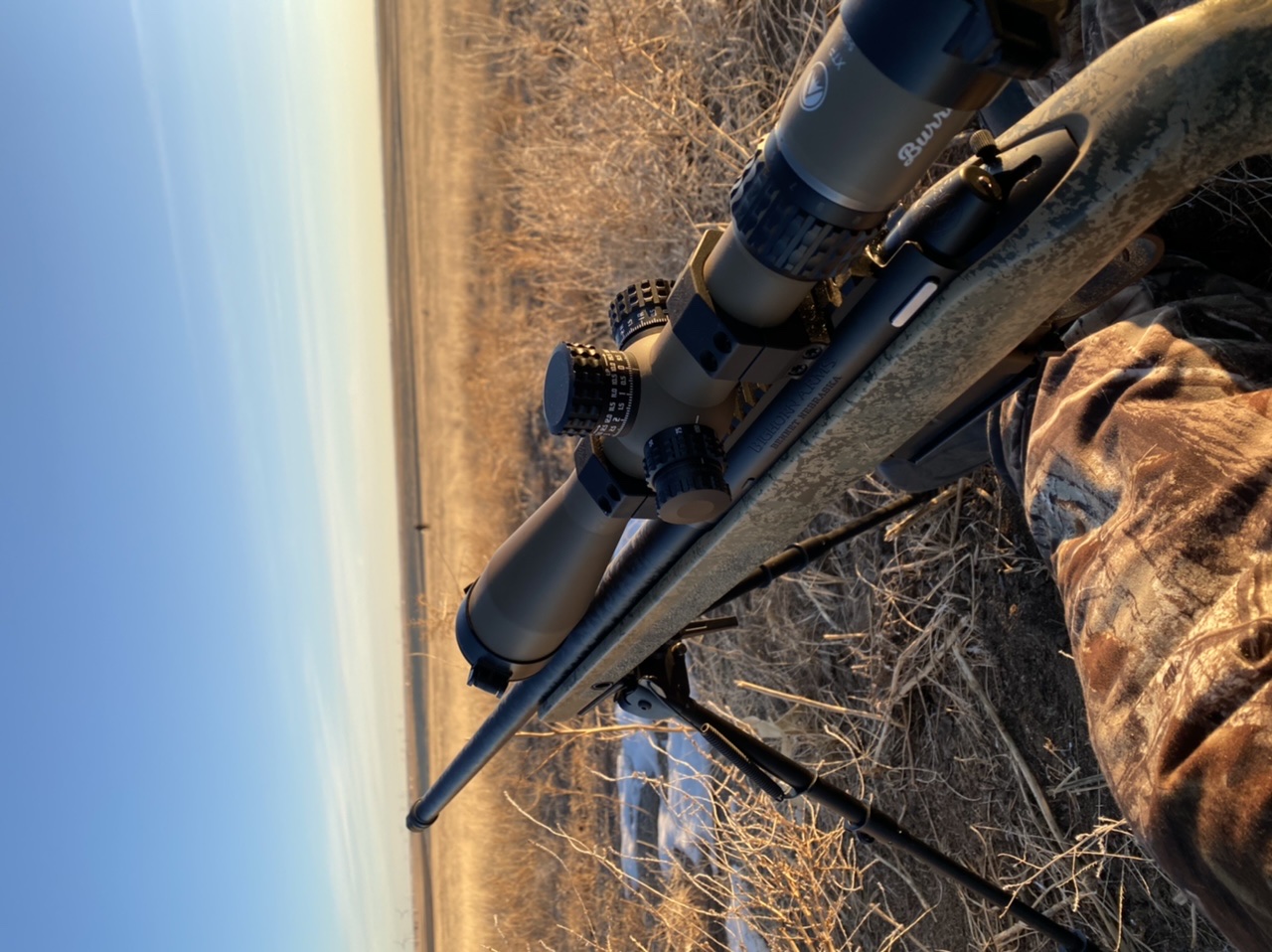

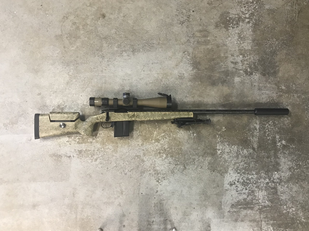

My Bighorn in 243AI, I’ve only shot coyotes with it so far but deer season starts in a week for me so I’m hoping for some success.
Carbon six 26” barrel, TBAC ultra 7, McMillan A3 in Sonoran Ambush color, and currently a Burris XTR II on top. Weighs a little over 11 lbs like this.

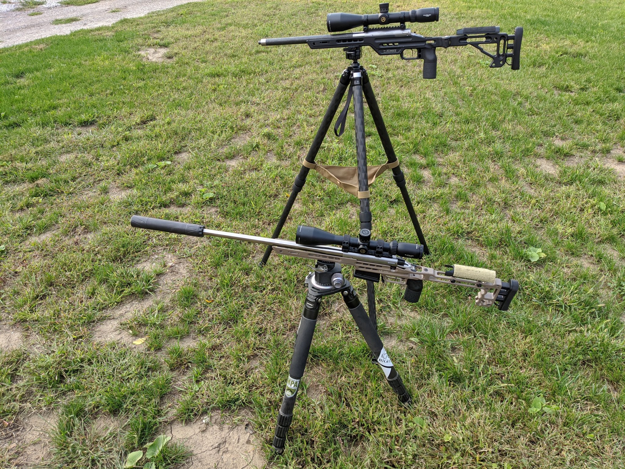

TL3 I'm putting together with a Proof prefit in boring 6.5 Creedmoor and a TT special. Undecided on the stock, love Manners but have been thinking about something different........JCS Composites, Mesa or possibly a KRG Bravo.

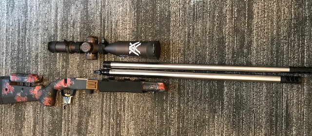

Well got it all together. Picked up my action around 4PM at the FFL and with dinner in the mix had a rifle together at 6:30pm. Can't wait to get out and shoot it!
Big thanks to @bohem Josh at PVA for doing the prefit barrels for it in 6.5 Creed and .223.
