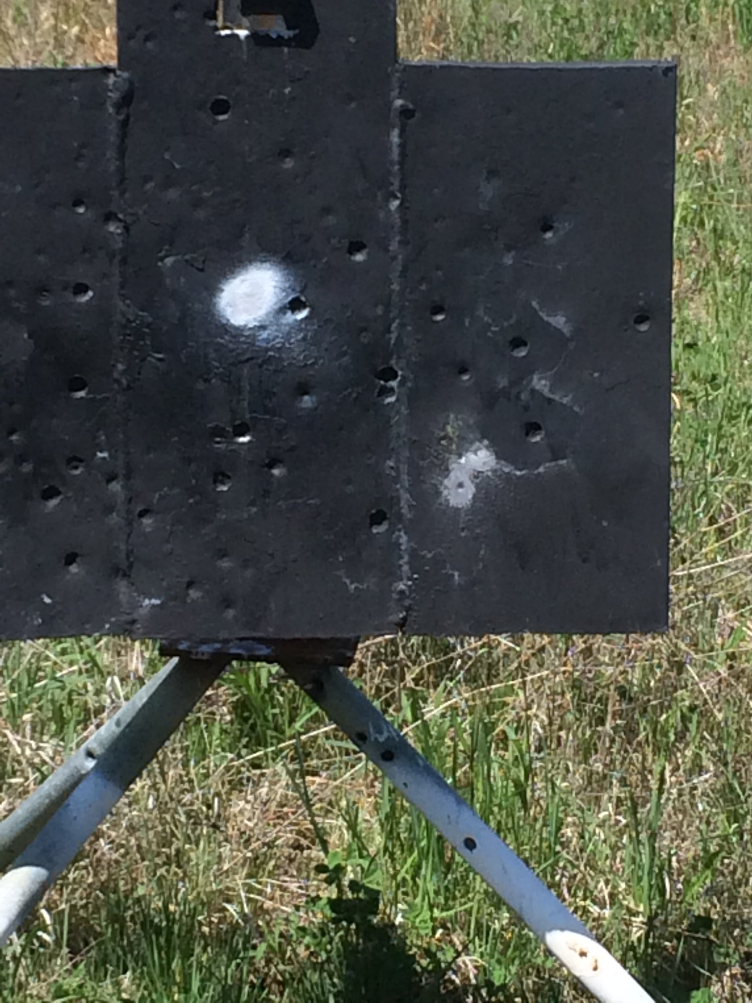

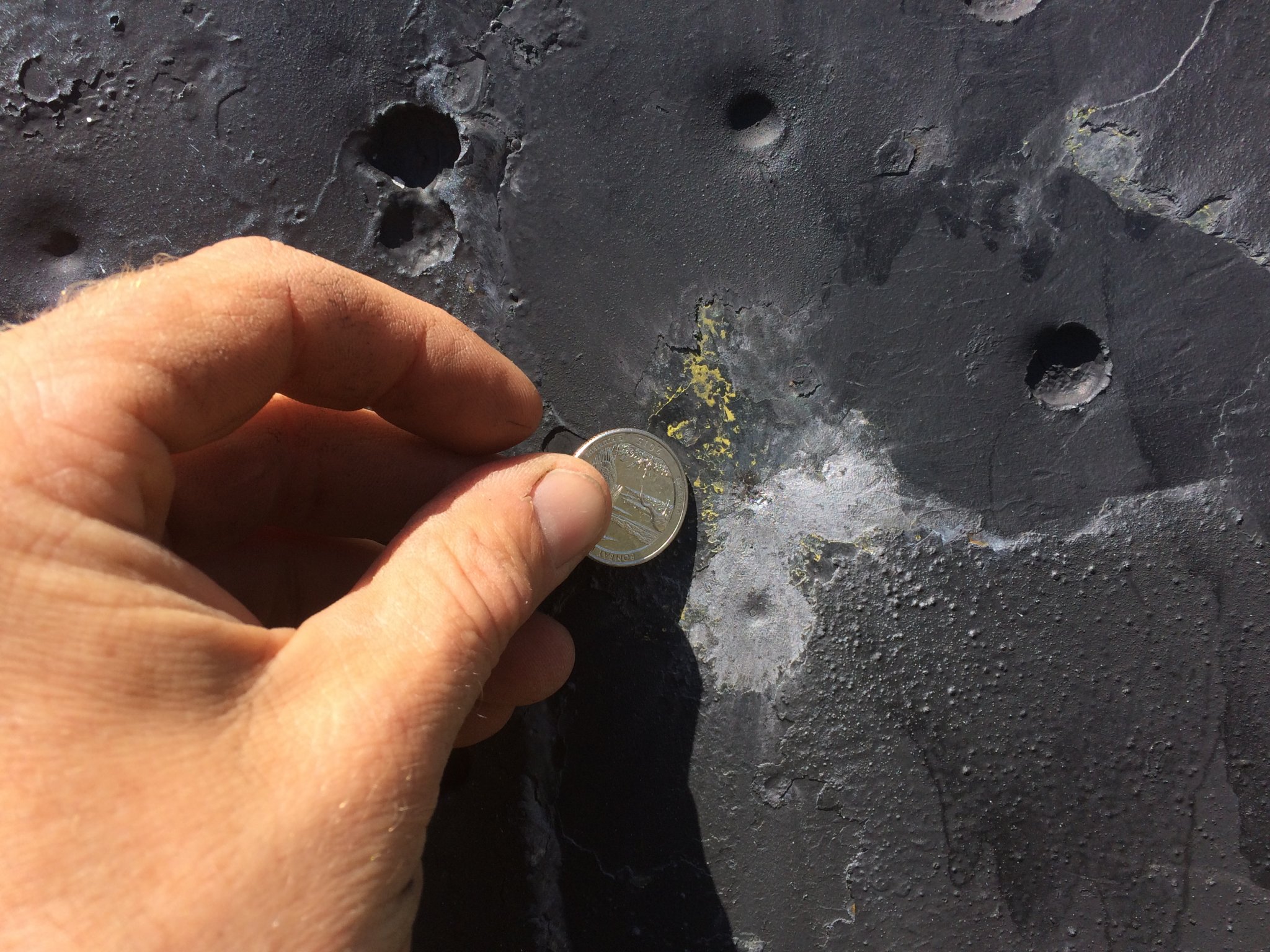

938 yards with a Pva chambered 6 creed with approx 1000 ends on a button rifled prefix I screwed on
