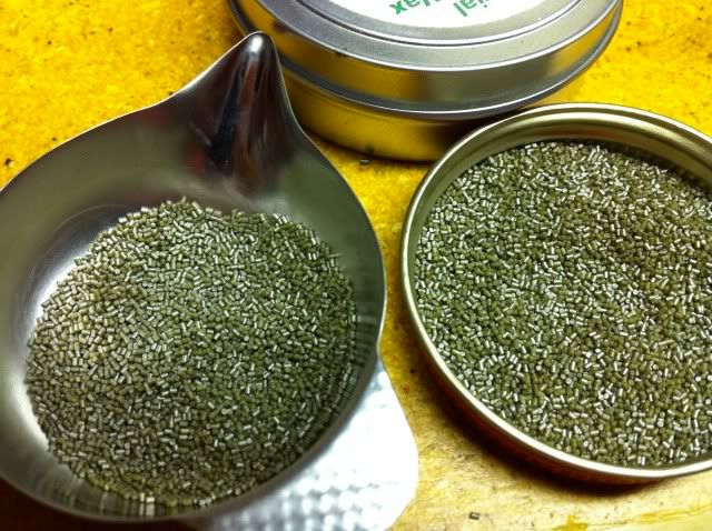

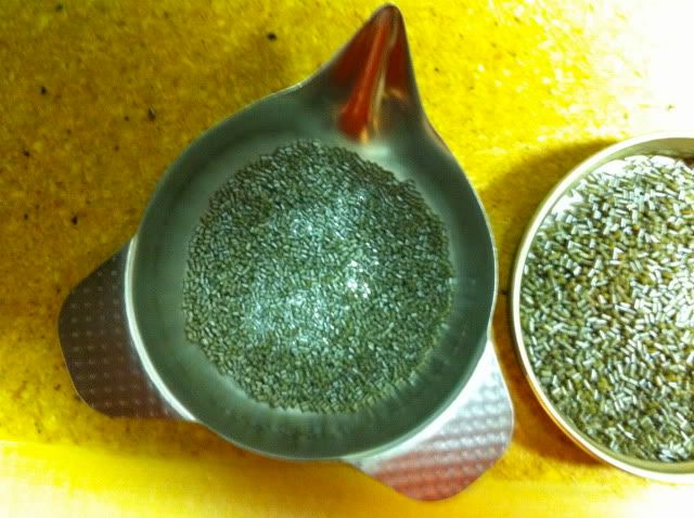

Got the new box style Black Hills 175gr Red box. I pulled the round. Looks like 42.2gr of Varget. Pulled 4. 2=42.2, 1=42.1, 1=42.3

Is IMR brown/tan like varget? I will take a picture of the box later. It is not the usual black hills red box. It is a new style box I have not seen before

Ok I'll take pictures of the powder to. Thanks.
Re: Black Hills 175 SMK Red Box
Greg I was wrong. But I forgot that the 8208XBR looks like varget just a smaller cut. So 42.2 of XBR.
Top picture XBR and black hills, Second Varget and black hills .
Once again sorry. I messed up.
