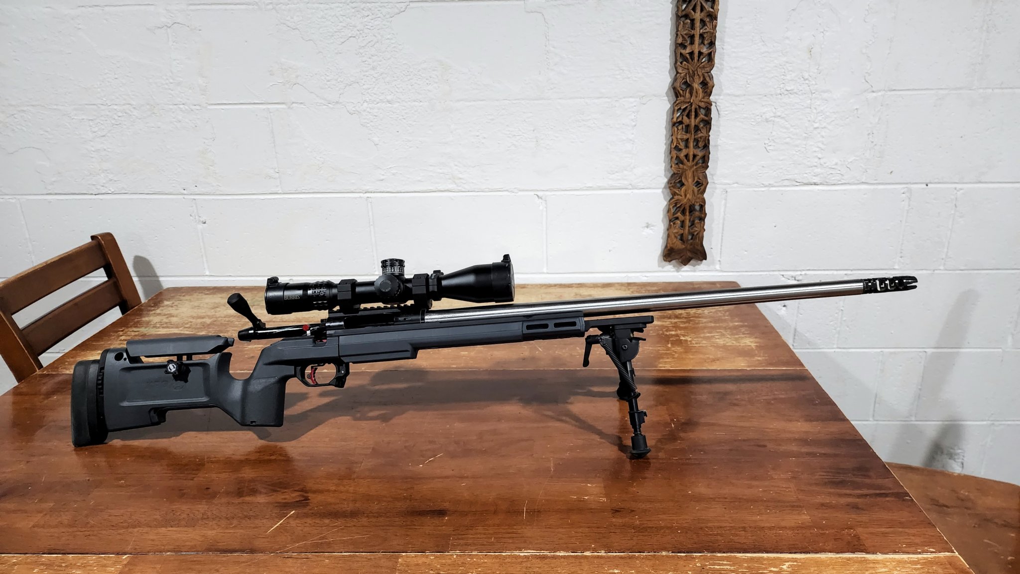

Much better! Went with the Origin action and 26" M24 prefit barrel from PVA chambered for 6.5 Creedmoor. ELF 700 trigger on a KRG Bravo Chassis. Burris XTR II scope thats getting replaced with a Vortex PST Gen 2 later this week. Thanks for the help everyone! Can't wait to get out and shoot it tomorrow.
