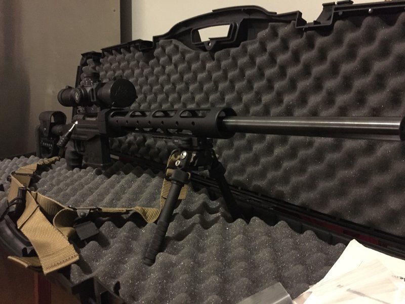

Below is a pretty crappy picI just snapped of my T3 varmint 24" in a folding XLR chassis. On top of loving the XLRs in their own right, that switch over also means you're using AICS mags, which saves some money compared to factory Tikka mags.
