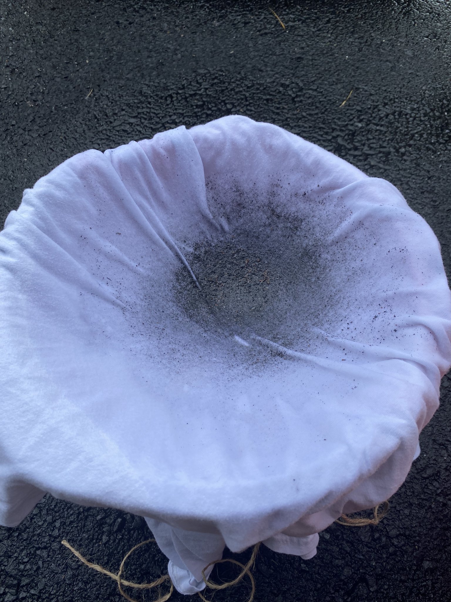

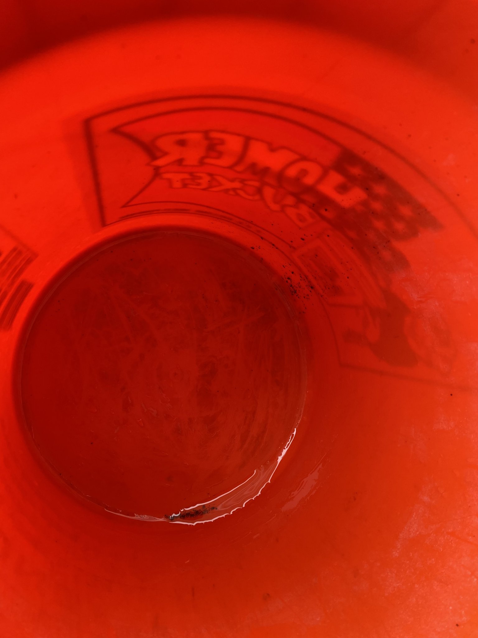

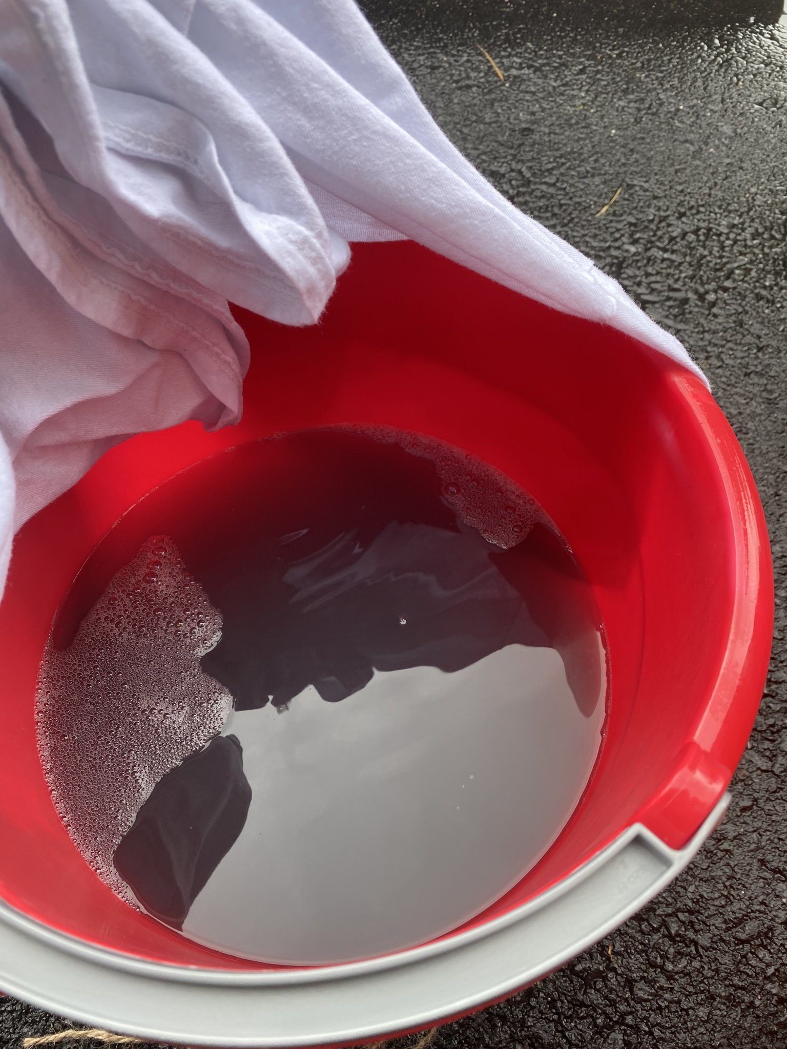

Aright… been a while. I almost forgot I had all this shit. Last night I was trying to screw on my brake mount onto my Omega can, after running the Area419 system for 1,000 plus rounds. Since I couldn’t screw down the ASR adapter onto the can, I figured this would be a great time to clean it, and test the BoreTech system.
Let me say again, this was paid for by me. BoreTech has not been in contact with me for this. Purely purchased for my own use, and giving an honest review. Also, I am not a chemist or an engineer and this is just my opinion. I own enough suppressors now, and shoot a lot where cleaning them at least once a year, is beneficial.
First, the 2 chemicals “A” and “B”
A: If this isn’t CLR rebottled into BoreTech Part A, I’ll be surprised. I smells identical to CLR. It looks like CLR. Carbon reacts to it the same way it does to CLR. Is it CLR?? Maybe. BoreTech said this is safe for ALL suppressors, even Aluminum. That said, before using this on your Aluminum cans, I would test it against something first, or stick with BoreTech C4.
B: This smells nothing like A, and is pretty close to C4 in terms of smell, appearance and carbon reaction to it.
With regards to both chemicals, they did their job in breaking down the caked carbon in my can.

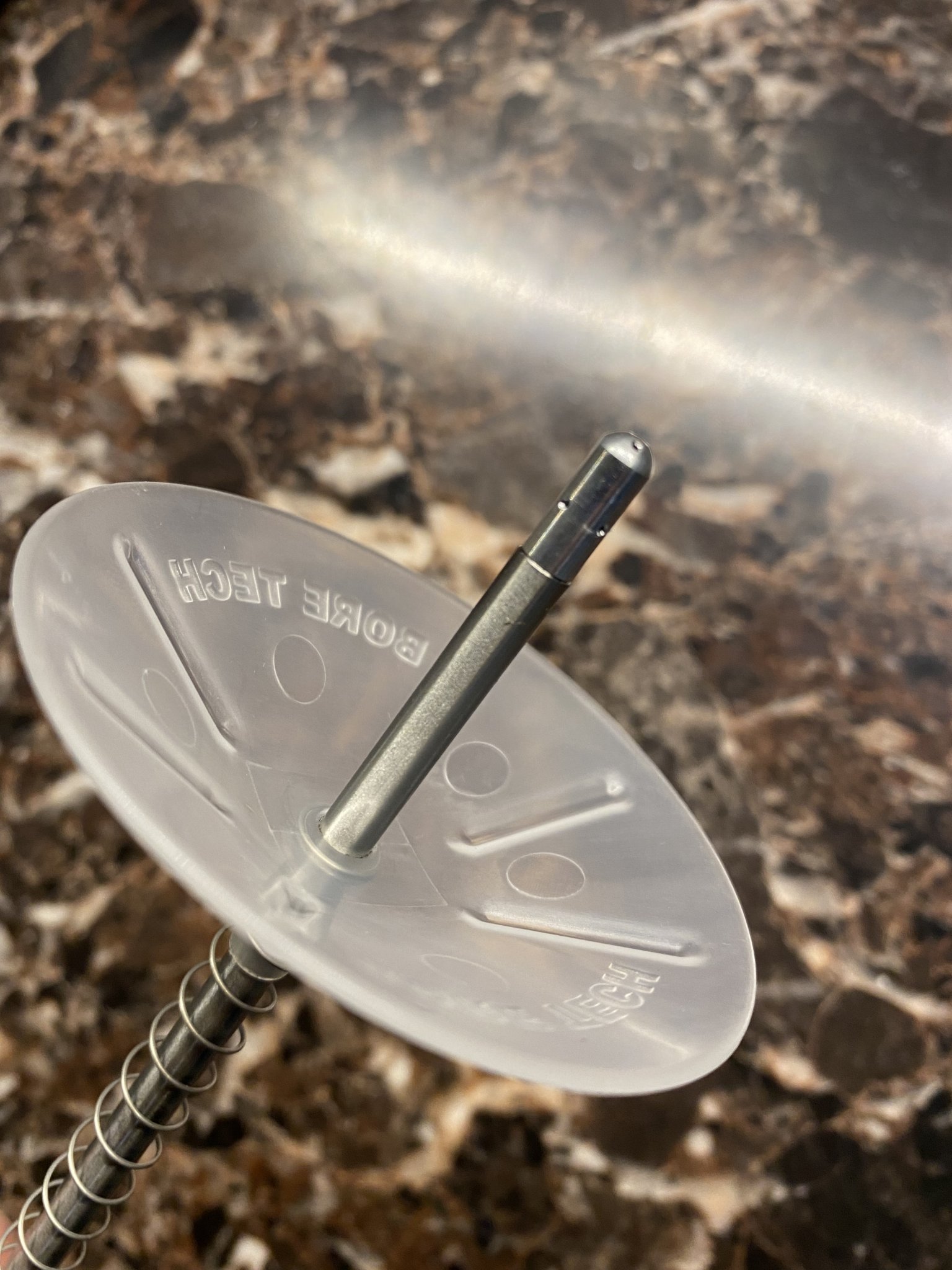

The suppressor holder. This I really like. Simple, effective, the can doesn’t move. If you mess up with sealing the can, it simply flows into the tin bucket. They do supply various sized plastic corks, which worked fine. I did end up using some plumbers tape to seal the end adaptor (Omega 300 flat end cap) on the can, then plugged it, which lead to zero leaks in both 24 hour soaks.
The Lance: This thing is very nice. I bought a $30 pressure washer handle, and a Craftsman 1700 PSi pressure washer from Amazon. Set everything up, read the fucking manual, and off I went. The 1700 PSi seems to be just fine for flushing this can out. Now, part A I was stupid and didn’t flush it into a bucket to collect all that came out, (so no Part A flush photos) but it was a lot. Part B, I did collect into a Home Depot bucket.
Plenty of carbon chunks, dirty bong water and left over clumps in the HD bucket.
Now, is it worth it?? Well, that depends. Do you have a bunch of cans and do they get a lot of use? Maybe the $250 is worth it for the system, esp if you already own a pressure washer.
Personally, using C4 as a cleaning solution, or CLR ( if your can’s materials allow it) is the cheapest route and find someone willing to make you a flushing lance. IMO, the lance is where this kit shines.
