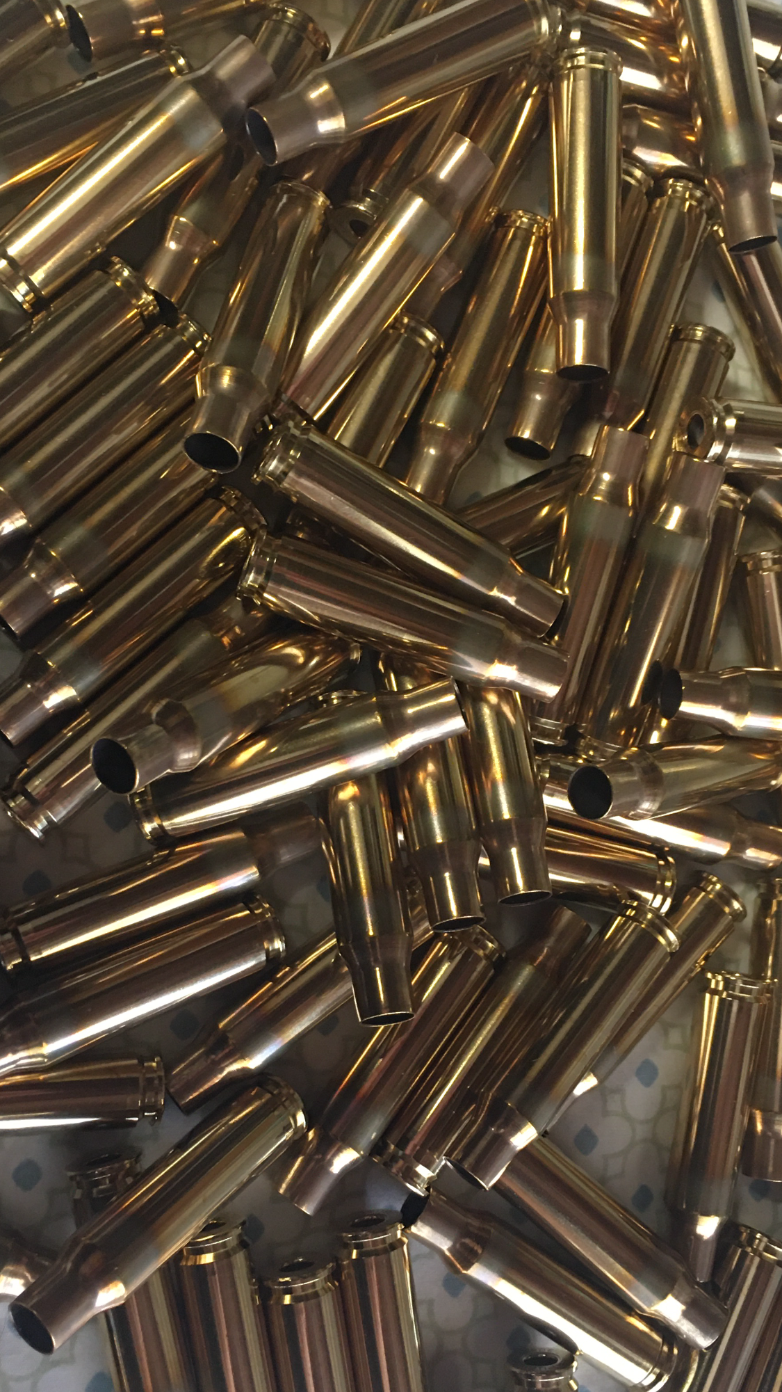

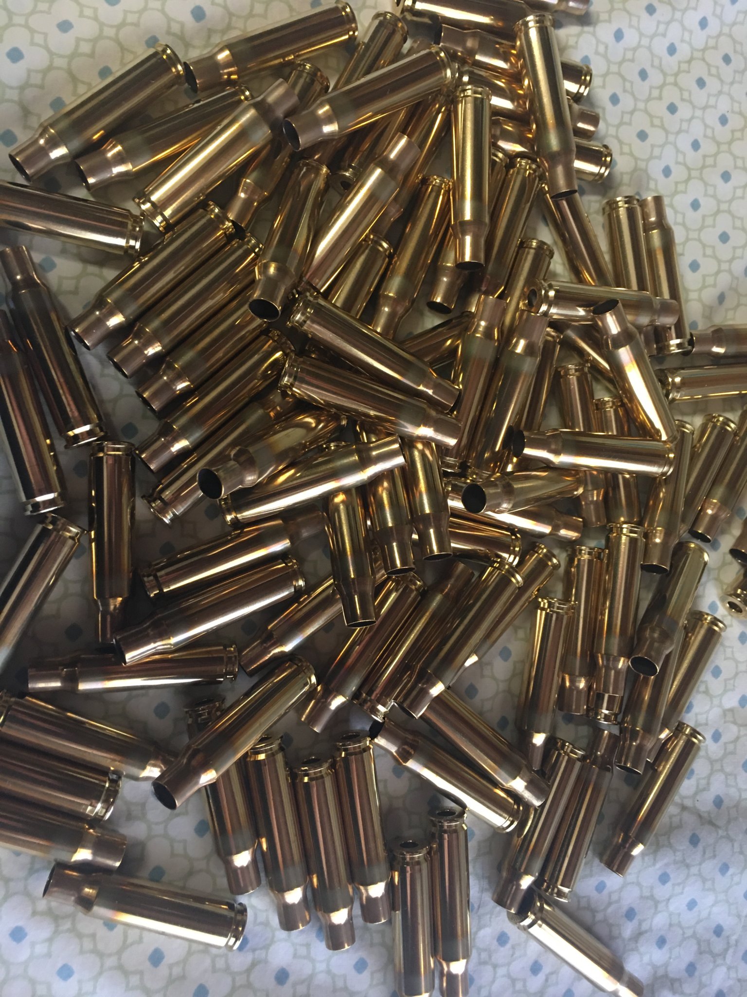

Been a while since I posted a Before and After... just processed these yesterday.
Before
After
Primer pockets as well as the insides are factory-clean, too.
