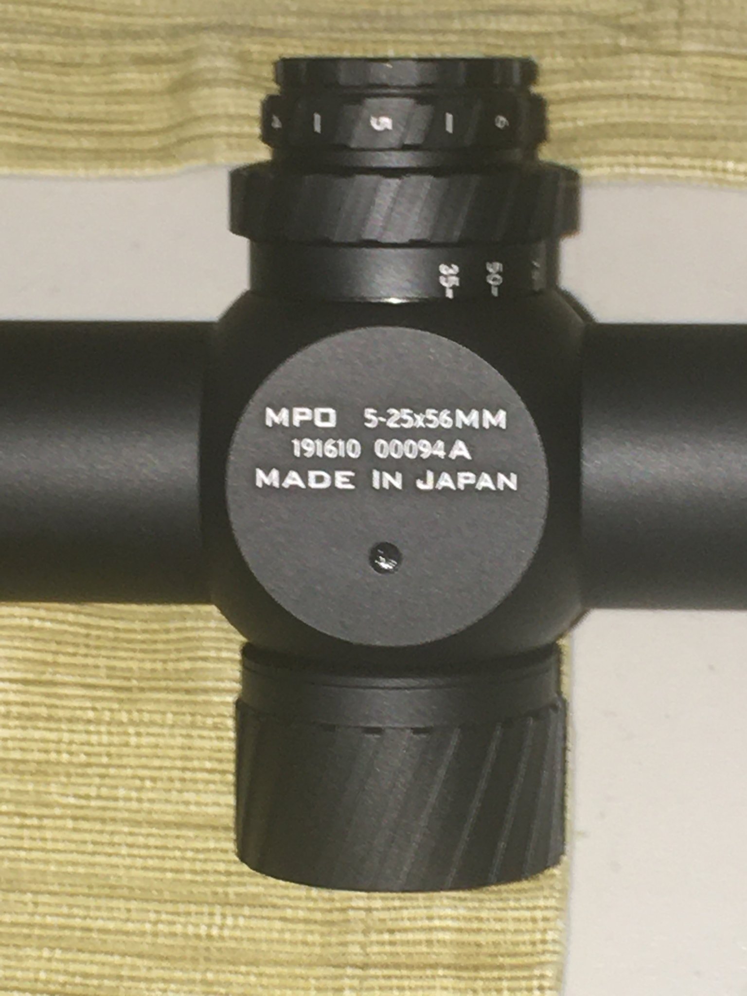

Looking at this site and scrolling down to the specs on the 5-25x56 variant (the one I have), it sounds like you are correct in the manufacturer assuming it's confirmed that Crimson Trace is made there as well.
BTW, they claim a light transfer rate of 97%. Would be interested to know if that's correct.

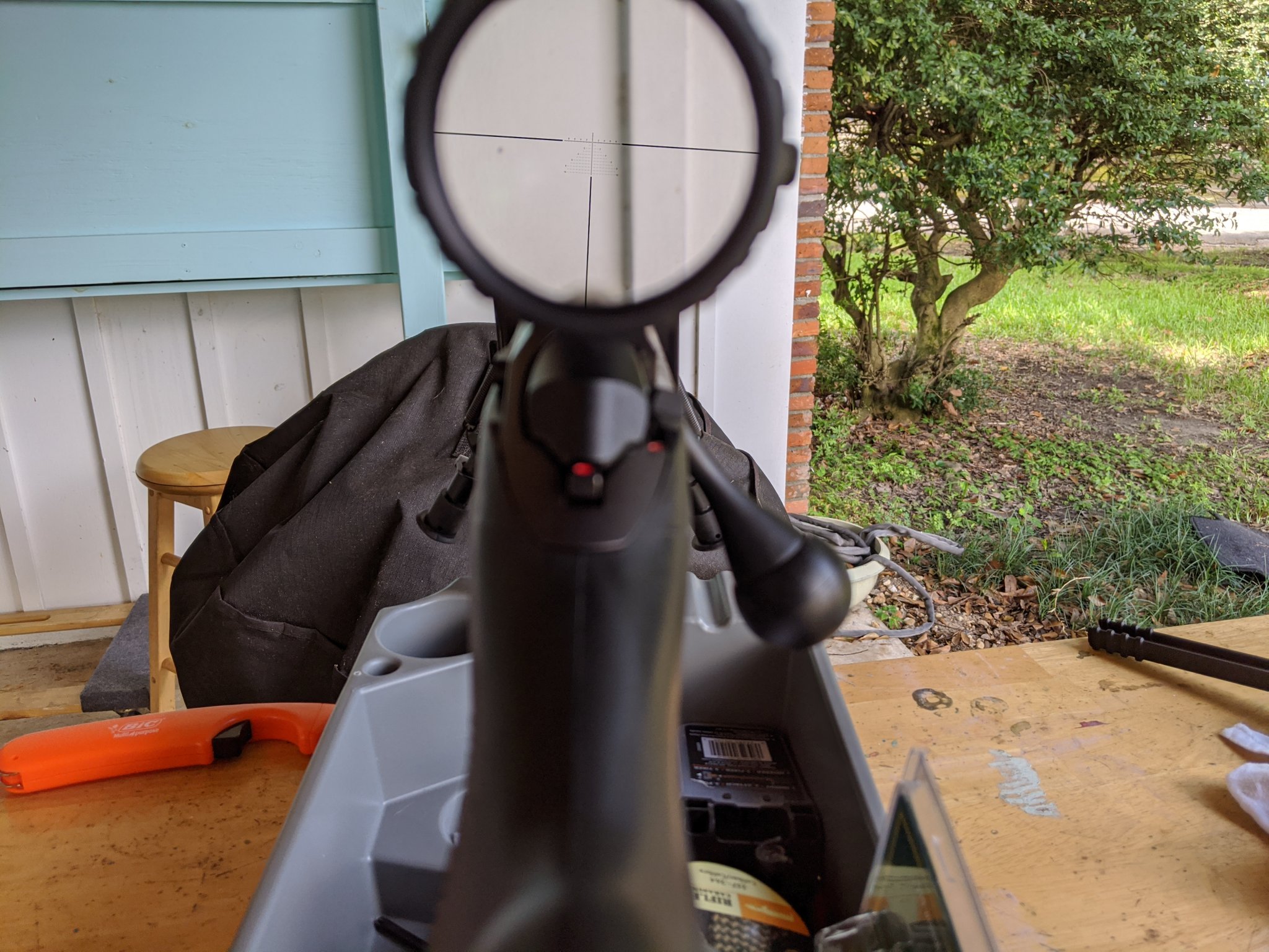

I bought a 3-18 from the PX. It's a nice scope glass is good, not great. Very bright and definitely an improvement over the PST 2 that it replaced. I have it on a Tikka CTR and have hit steel out to 1000. I just recently noticed what appears to be a small defect in one of the internal lenses. It's only noticable between 3-4 power. Once you get past 4 it's fine. Obviously a small chip on the edge of a lense. I contacted Brownells about repairing it and they said that they won't fix it without proof of purchase even though they are the only people who sell these. I contacted the Hide member I bought it from to see if he will help out. I think he's going to...we will see. Added pic of problem. Noticable at 6 o'clock on 3 power.
Scope is fine. User is an idiot. It was the new brake. I didn't even think about it mysteriously appearing at the same time. Thanks

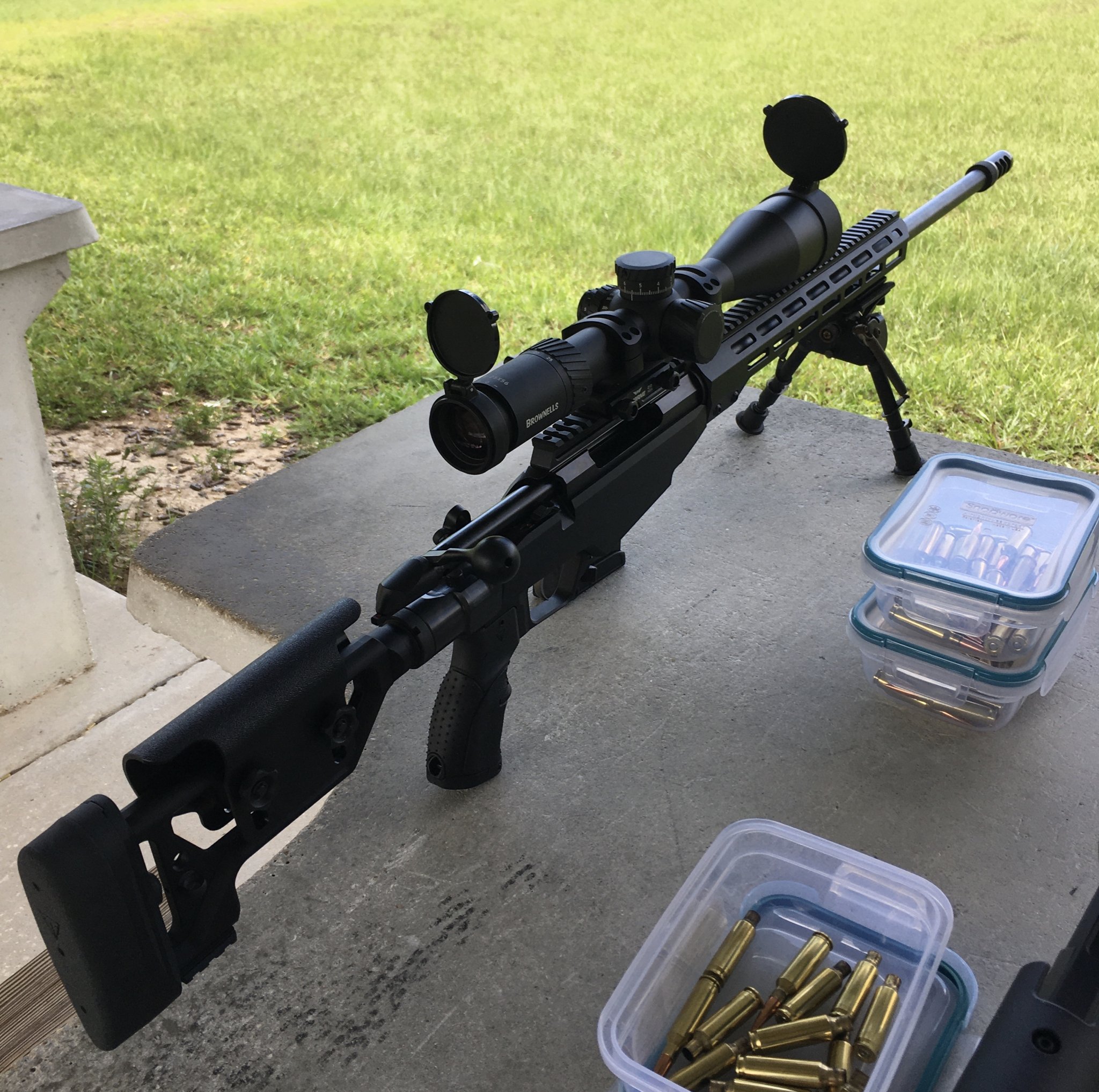

I bought this scope. So far, have only had it to the gun range to sight it in. My impressions are as follows:
Very bright (better be...56 Objective, fully multi-coated, and a 34mm tube to make it easier to pass the light along)
Very clear (for a $1000 scope, it's pretty darn nice)
Feels VERY solid
A bit heavy
One con is that to adjust the reticle takes GI-Joe with Kung Fu grip...that thing is TIGHT.

JOL (https://www.jolusa.com/products) makes scopes in that exact specification as well. They are in Japan as well. They could have made them there for all I know.
If you have talked to the reps and they say LOW then fine. You just said that Brownells said who made them. I thought you had a link to that. Didn't realize it would trigger you this way.
