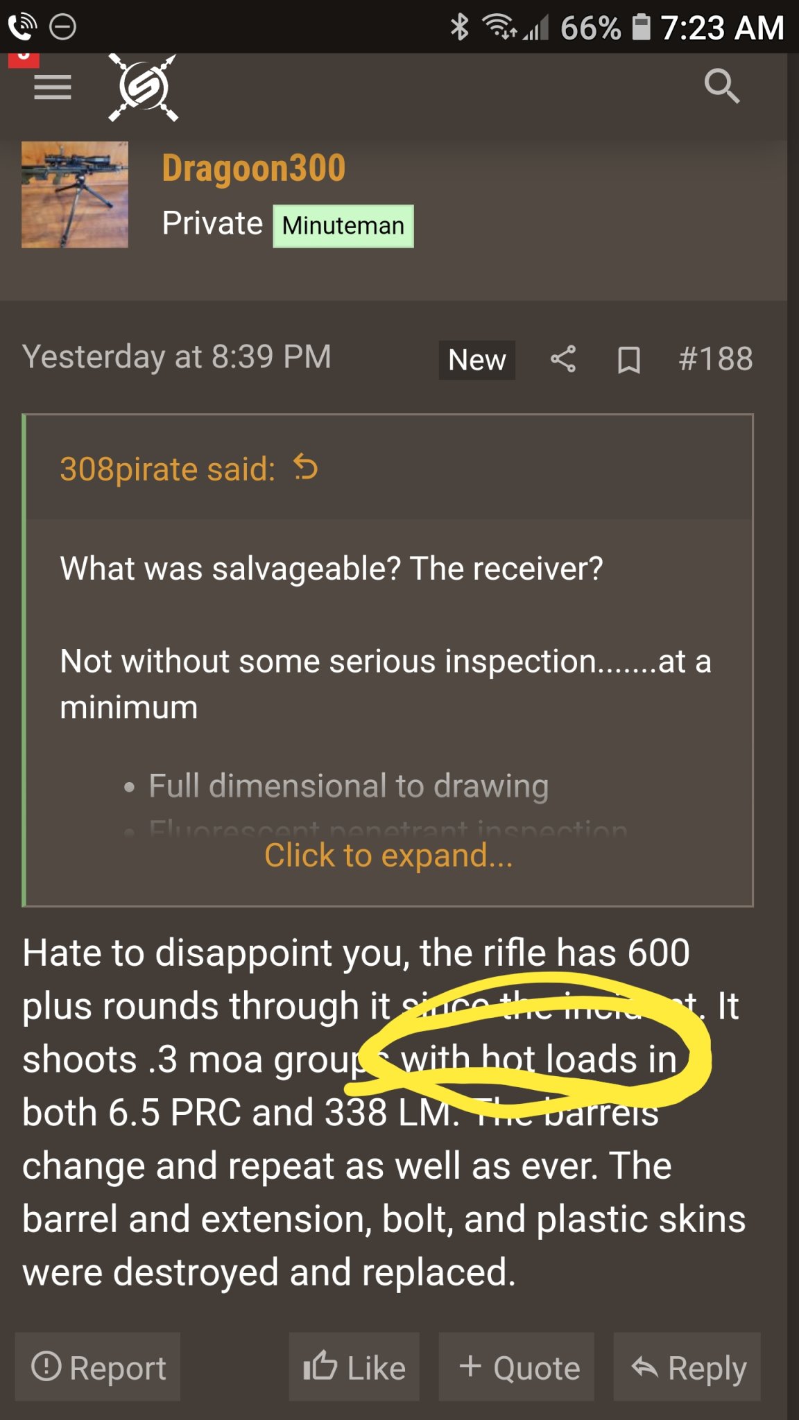

Sure, reasons cited by dragon are not based in scientific principle… I agree. Though when you replace the bolt, extension, and barrel in a DT, you’ve replaced everything that I’ve ever seen damaged by up to nearly 180,000 psi. The chassis remained unaffected in every test.
Any traditional action… and you’re 100% correct. Though the DT is not remotely traditional.
In this instance, it would be like someone replacing their entire traditional barreled action with a new one and claiming they don’t know the new action is safe until they had it analyzed.
I hope that brings some clarity.
Reactions: Dragoon300
Hate to disappoint you, the rifle has 600 plus rounds through it since the incident. It shoots .3 moa groups with hot loads in both 6.5 PRC and 338 LM. The barrels change and repeat as well as ever. The barrel and extension, bolt, and plastic skins were destroyed and replaced.

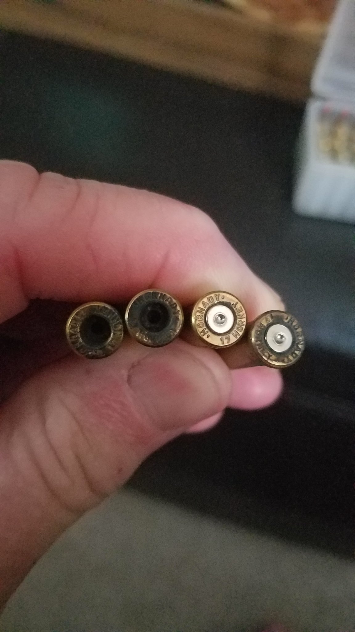

The biggest mistake I ever made reloading was to accidentally grab 17 Caliber 25 grain V-Max by accident instead of the 20gr when I was loading for a 17 Hornet.
I had exactly one box of them. What are the odds?
5 grains in most other cartridges wouldn't have been any big issue.
In the 17 Hornet it was a 25% increase in bullet weight with a 12-ish grain powder charge
That's huge.
The results weren't pretty, but, thankfully the only damage was to the tiny brass.
The range was noisy and I didn't even notice a different sound signature.
Pulled the rest of the loads apart and the brass is on my shelf as a reminder to double check EVERYTHING.
