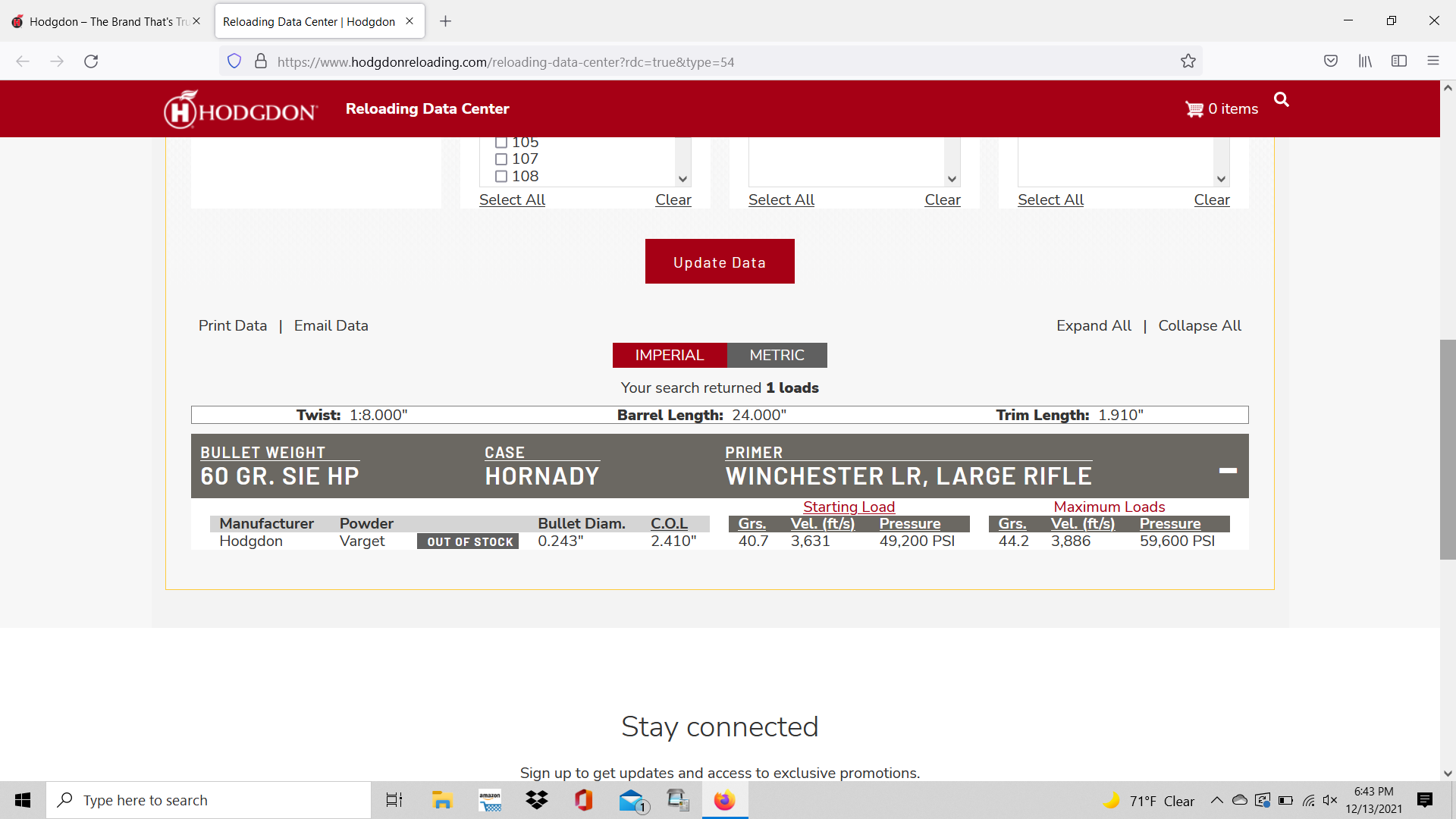

Buddies 22 creed blew up…. Any ideas
I know there's a pressure differential between jacketed and solids.
I'm puzzled about the posts stating this was an obvious and "stupid" overcharge at 80 to over 100 KPSI.
Now, I know a 60 Sierra HP isn't a 62 grain solid- but Hodgdon's reloading data, which I've always regarded as conservative- shows 44.2 grains Varget as max load w/velocity of near 3900 and pressure under 60 KPSI.
WTF am I missing here?
6mm data, bullet length, bullet material, etc etc
It's around 80-90 psi on quickload depending on what you use as a bullet (I used a barnes ttsx just for shit and giggles) and what you use as case capacity.

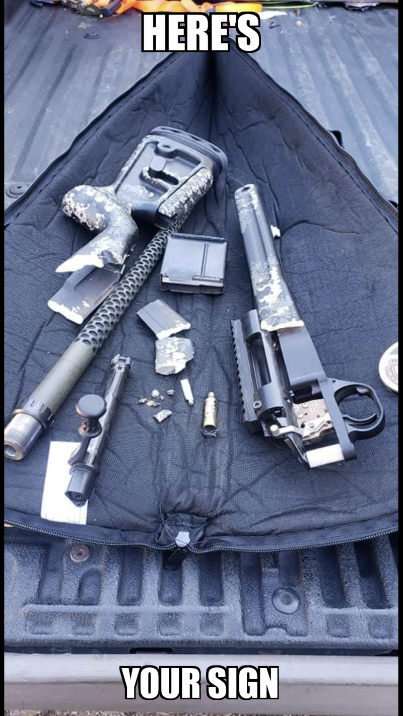

Buddy was doing some load testing.. “very proficient reloader”. 🙃
My first thought was a double charge of powder.. or an overage.
He Was shooting 44 grains of Varget which he had shot previously… with no pressure signs.
Bullet hit gong. So I think it rules out an obstruction.
Sheared extractor off bolt and case head separation? Brass failure?
Brass was twice fired copper creek 22 creed brass.
62 grain controlled chaos bullets.
Criterion barrel
Luckily the action contained all the shrapnel and he just got a wake up call and a little fire ball.
Gun had 200 rounds through it.

That looks classic for a case head separation secondary to either excessive headspace vs. setting the shoulder back after each shot resulting in a bright ring forming (incipient brass failure) just above the base, eventual case failure.
I've seen quite a few case head separations. None of them were eventful in any way.
You may be correct. I've only seen evidence of other's case failures. One firearm destroyed, thumb amputated secondary to partial barrel obstruction.
Like 85k PSI in regular brass.

I did a run in QuickLOAD with 22 creed, 44gr VARGET, 26" barrel, 2.6 COAL, used a Barnes 62gr as that's the only solid I seen in that range. To get the 4150fps case size is ~47gr H2O. So here's the kicker, pressure = speed more or less. To get that speed in those parameters, it's kicking out 103k+ PSI!
The fact that you got as many out of is as he did and then walked away from it is a pretty awesome advertisement for the toughness of the parts both in that Alpha brass and the rifle itself. No way regular parts pull that off.

Yeah I told him… any factory action he might not be doing so well…
To be fair. Any other brass I think he would of hit “normal” pressure signs and stopped…
I didn’t know alpha brass didn’t show pressure signs either…
I also don’t just keep going…. For the hell of it..
