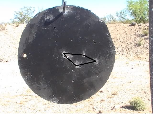

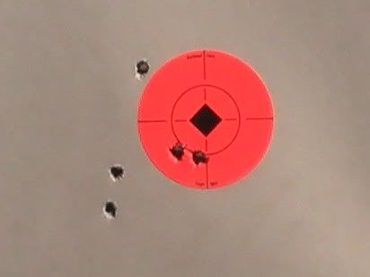

My group at 200 yards wasn't that great. Haven't measured it but it's probably around 2 inches. However, this ammo seems to be more accurate out at longer distances. I put three rounds on the gong at 500 meters and it was about a 3" group.
