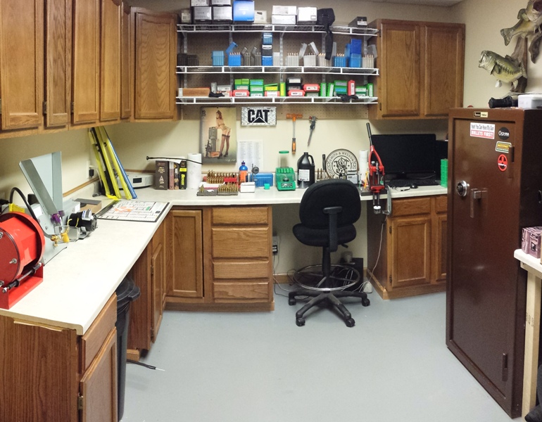

go to home depot and get can light fixtures and put LED'S or CFL'S in them. you can get 6 for about 50.00 bux
i like LED lights better than CLF light less time to start (warm up)
that's what i have in my reloading room.
i love your reloading room. I'm closing on my new house Monday ans specifically picked out our floor plan so i could have a room finished off in the basement for reloading. I have been using all the the photos you posted in another thread of your room to get ideas to design mine. great job man.

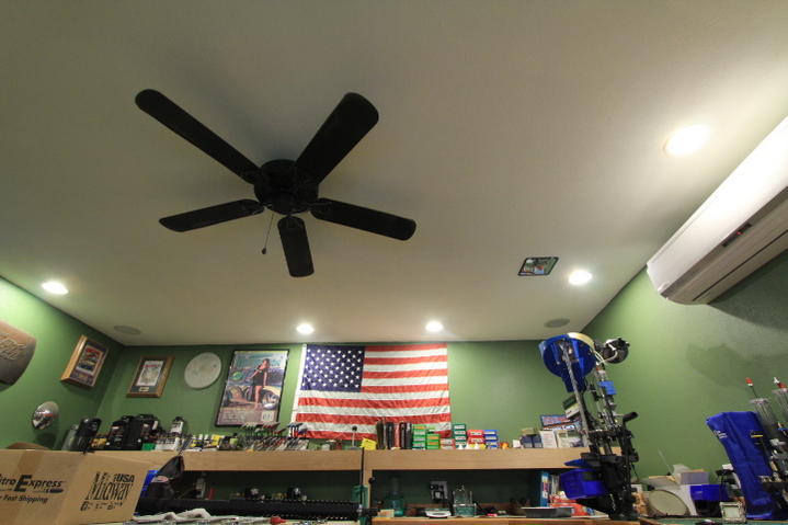

If you're gonna use LED spots in like in the pictures above, you should pull down the entire roof and make boxes for them to sit inside.
IF not they pose a rather big fire hazard, of course worse with Halogen bulbs, but LED do produce heat too.
If you don't you're roofs insulation will be partly melted away after a few years.
I've seen results of this done while using Halogen bulbs a few times, and well only thing that kept the houses from burning down was lack of Oxygen in the roof, just something to be aware of.
