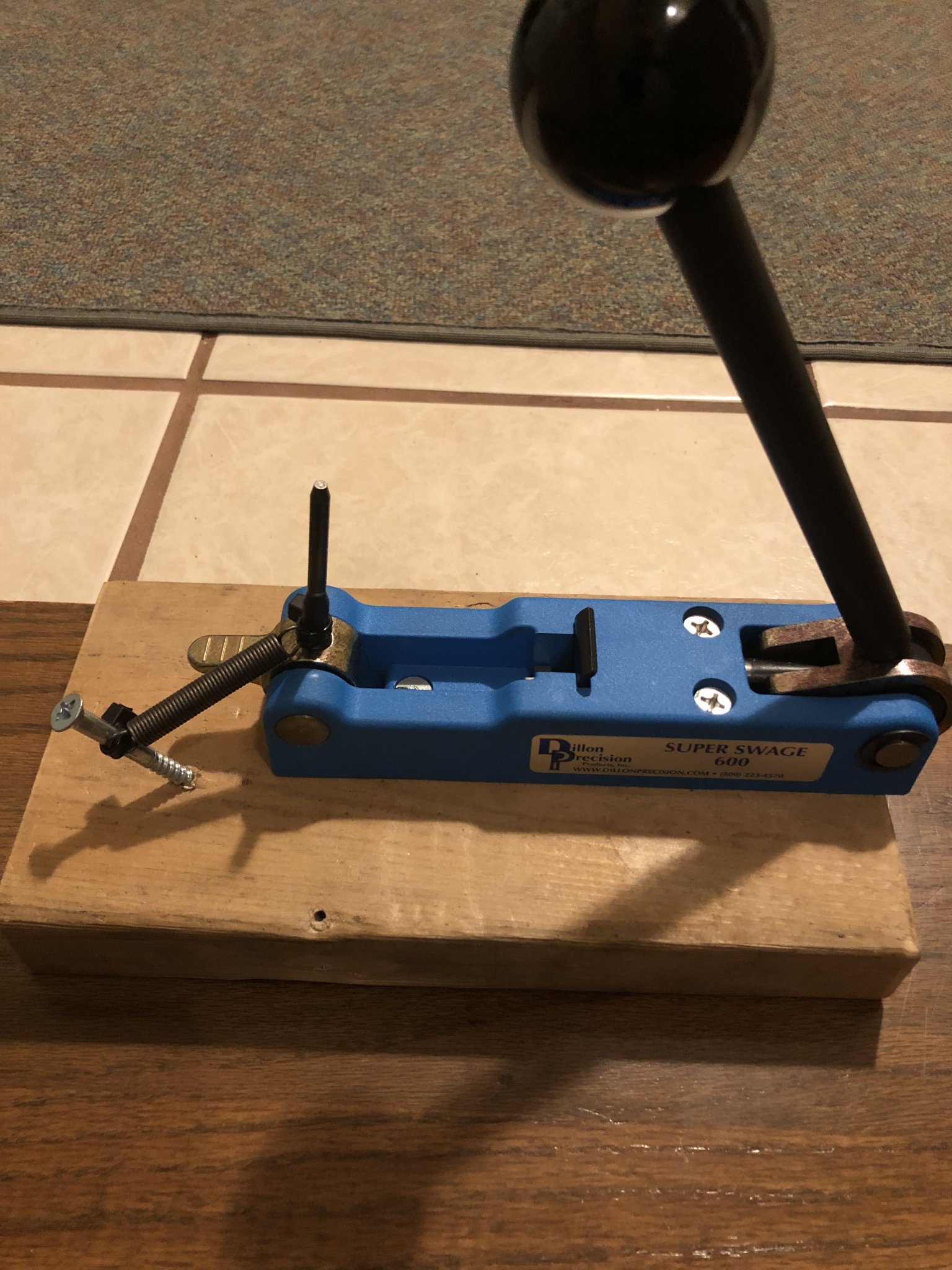

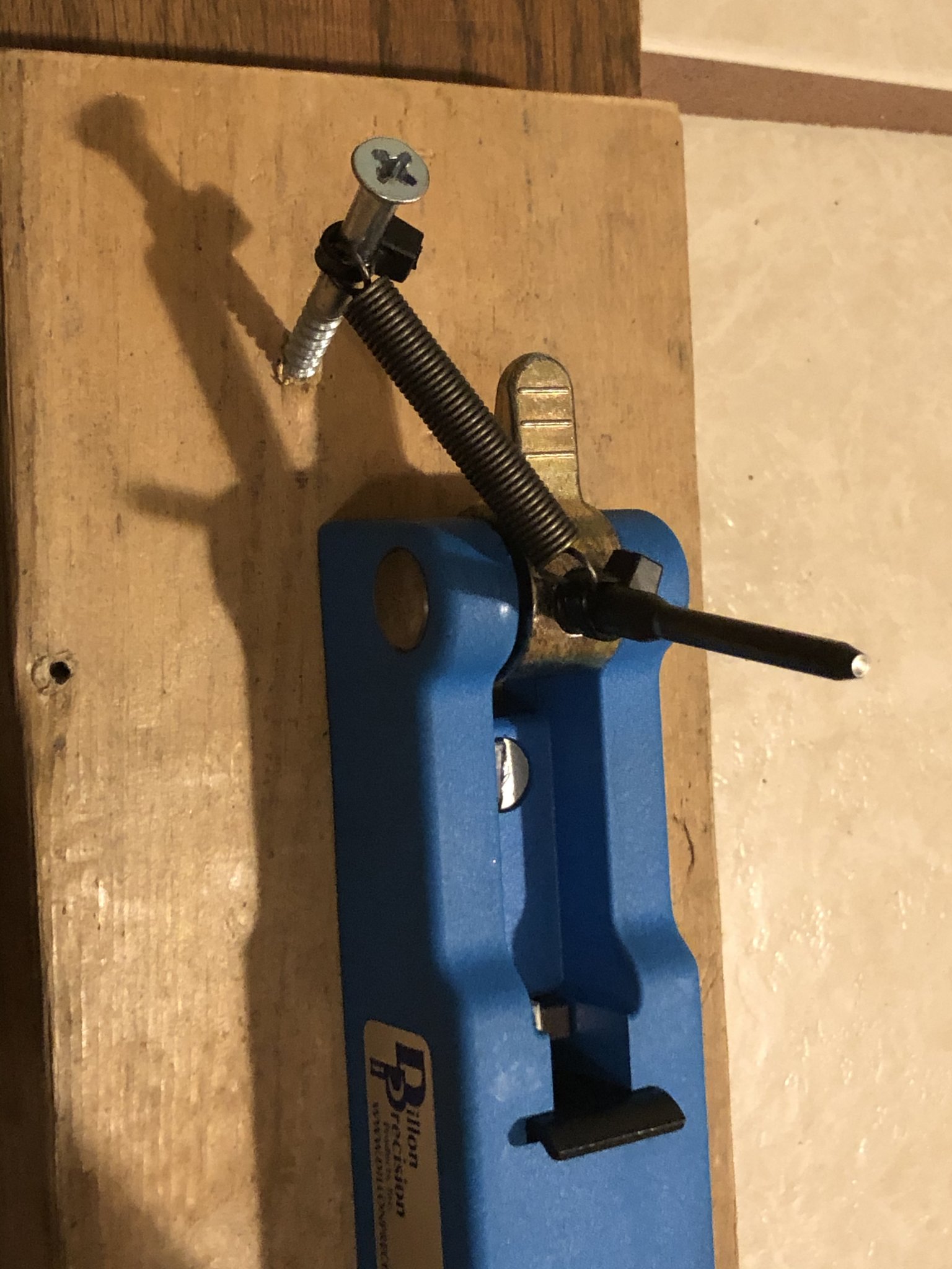

The Dillon SS with a spring attached is about the fastest and easiest way to accomplish this.
There are a few youtube videos out there with additional modifications, but the amount of time wasted is not worth while.
This is simple and not permanent as the spring is attached with zip ties.
Once swaged and you let go of the case, it springs back and flies off the rod so you will want to have a towel hanging over a box to collect brass.
It's actually pretty fast once you get going, but after a few thousand rounds, you'll wonder why the F you ever bought or picked up crimped brass!!
Best of luck!
