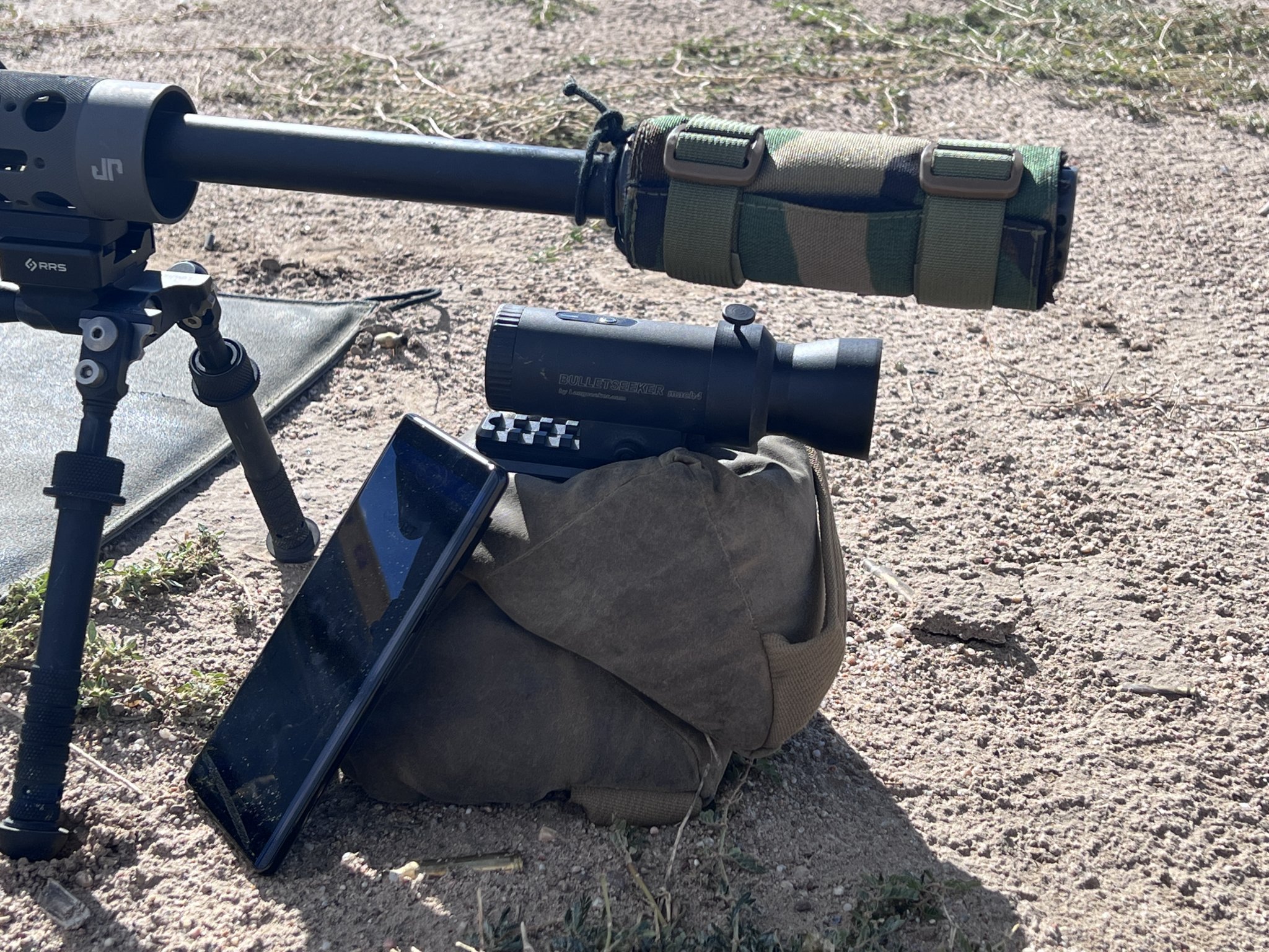

I got to the range today to try the BS. Everything set up easily. The BS connected to the Android tablet immediately. The system worked as advertised. I shot it on a DT SRS with a 300WM conversion kit. I would definitely get the parabolic lens if you get the unit. It worked best with the lens on, at least on the 300WM. The velocity was consistent with other chrono speeds for the loads I was shooring. I have a Magnetospeed and my son has a Labradar. The BS is much easier to use and is more consistent than either one of them. If it keeps running the way it did today, I won't be using the MS or the LR again....it's that good.View attachment 7961764View attachment 7961765View attachment 7961766

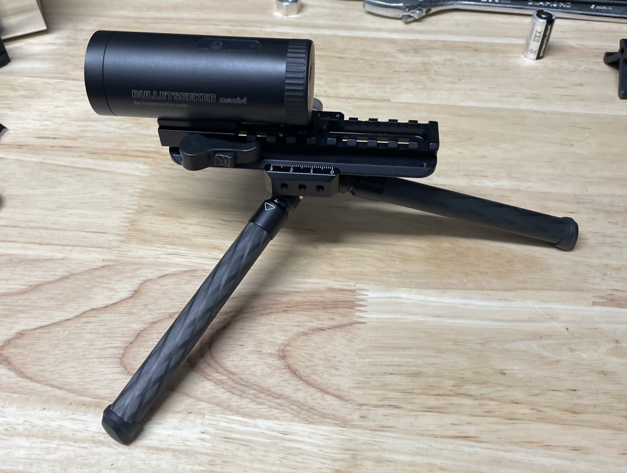

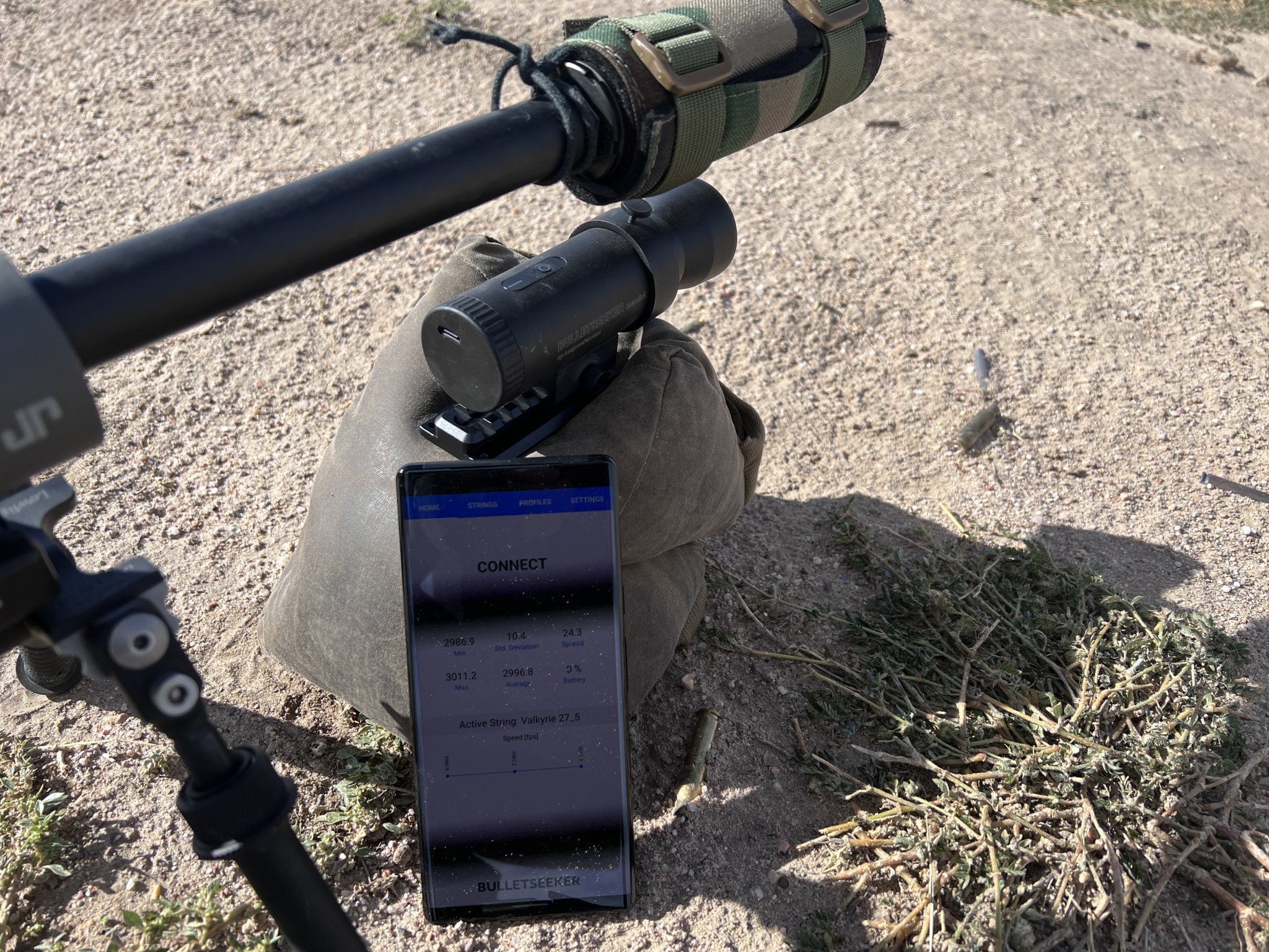

I was out today with the Bullet Seeker and this worked pretty good
This gave me more flexibility to aim it and it worked very well this way

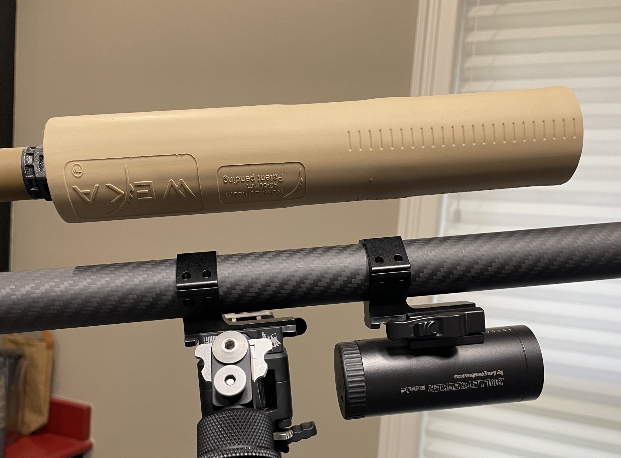

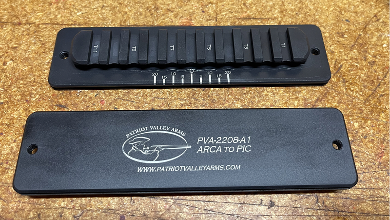

Is that the PVA ARCA Picatinny adapter? I've looked at bolting some sort of contraption together like that, but it looks like a no brainer for slapping a scope/thermal/bulletseeker on a tripod.

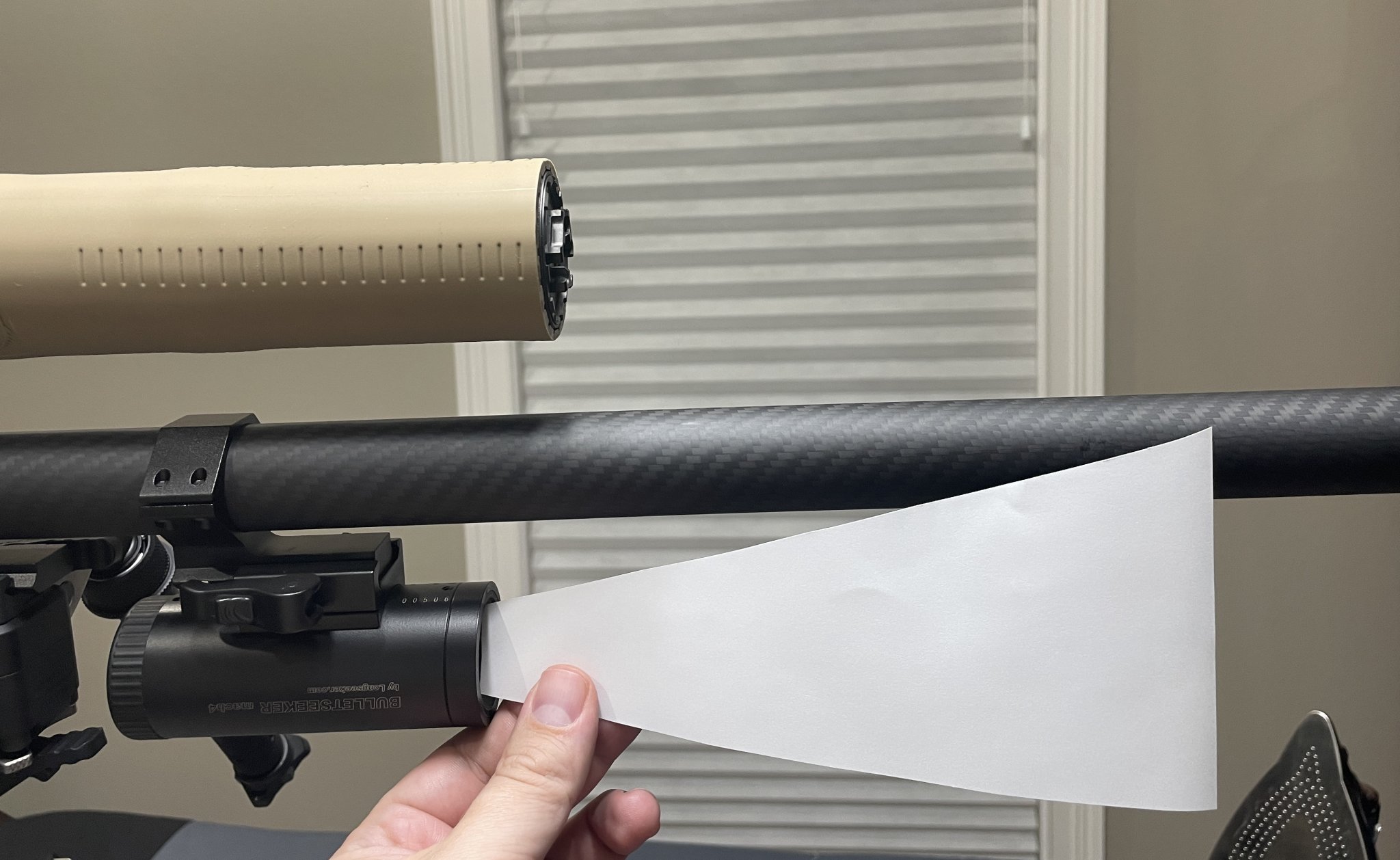

I put it there temporarily but it’s too far from the muzzle according to the manual. I also cut out a 22° triangle from a piece of paper and it was easy to see that it would be behind the suppressor shadow if I mount the radar back on the forend.

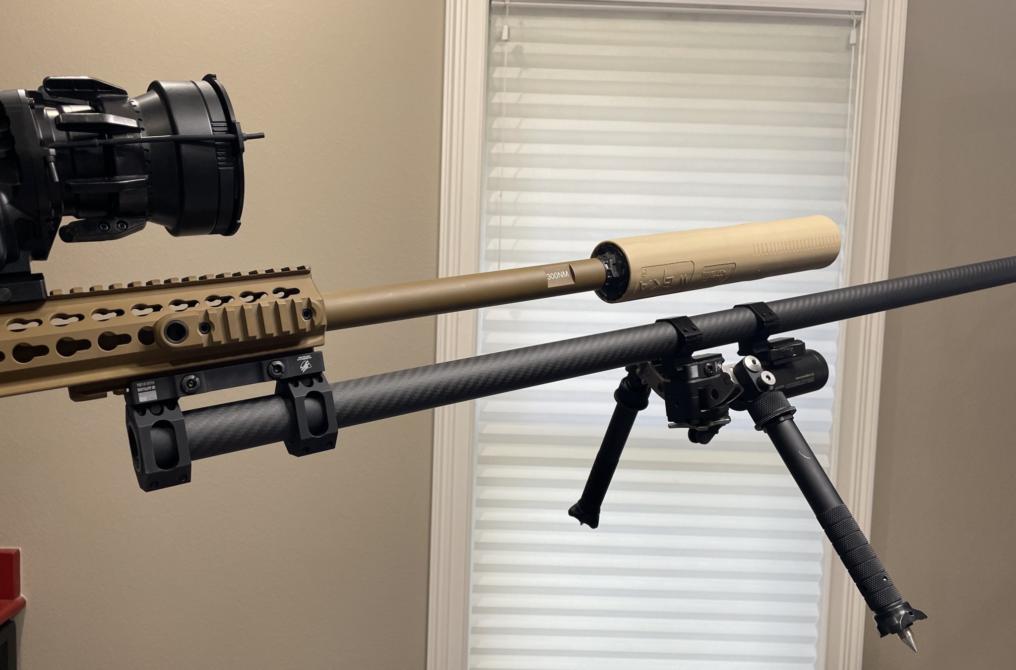

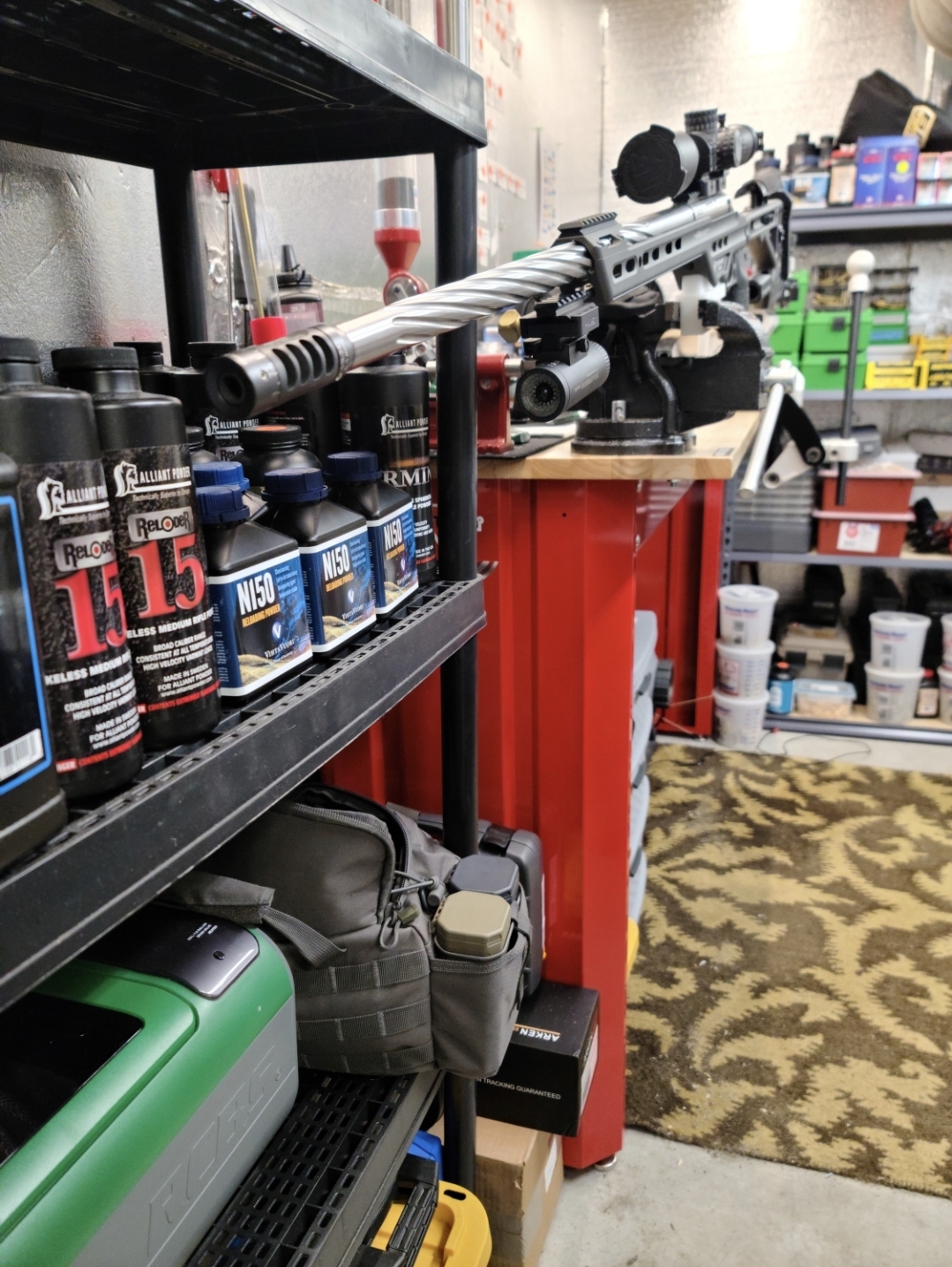

I have a datasheet from Longseeker indicating 10.5-24" behind the muzzle is optimal. But then their manual says "as close to the muzzle as possible." I interpret that to mean closer is better, and 24" or more is probably too far. On my AXSR with the CGS Hekate, the radar is about 24" from the front, but the suppressor is very fat which exacerbates the problem. With a 22 degree FOV, if you put it at the muzzle, it may not see the bullet until it is 12+" in front of the muzzle depending on your axial offset. With my setup pictured above, my paper triangle indicates it will first see the bullet about 18" in front of the suppressor if I leave it in the pictured position.

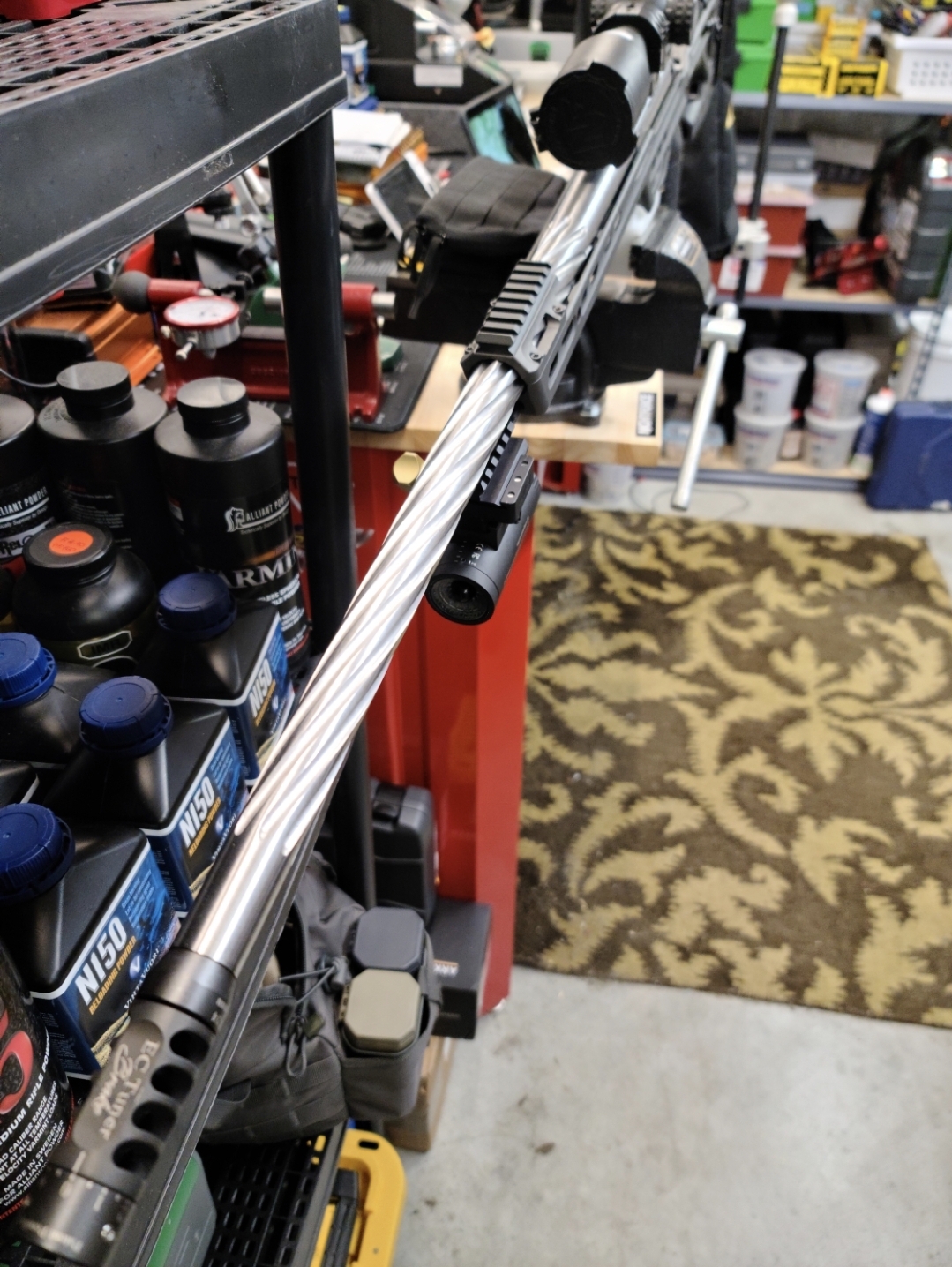

Here are a couple pics to illustrate the geometry issues. I encourage everyone who buys a BS4 to cut out a piece of paper with a 22° angle - makes it pretty easy to spot setup problems with radar shadow.
Here is a pic with the radar on the forend, you can see the suppressor will obstruct half the radar cone:

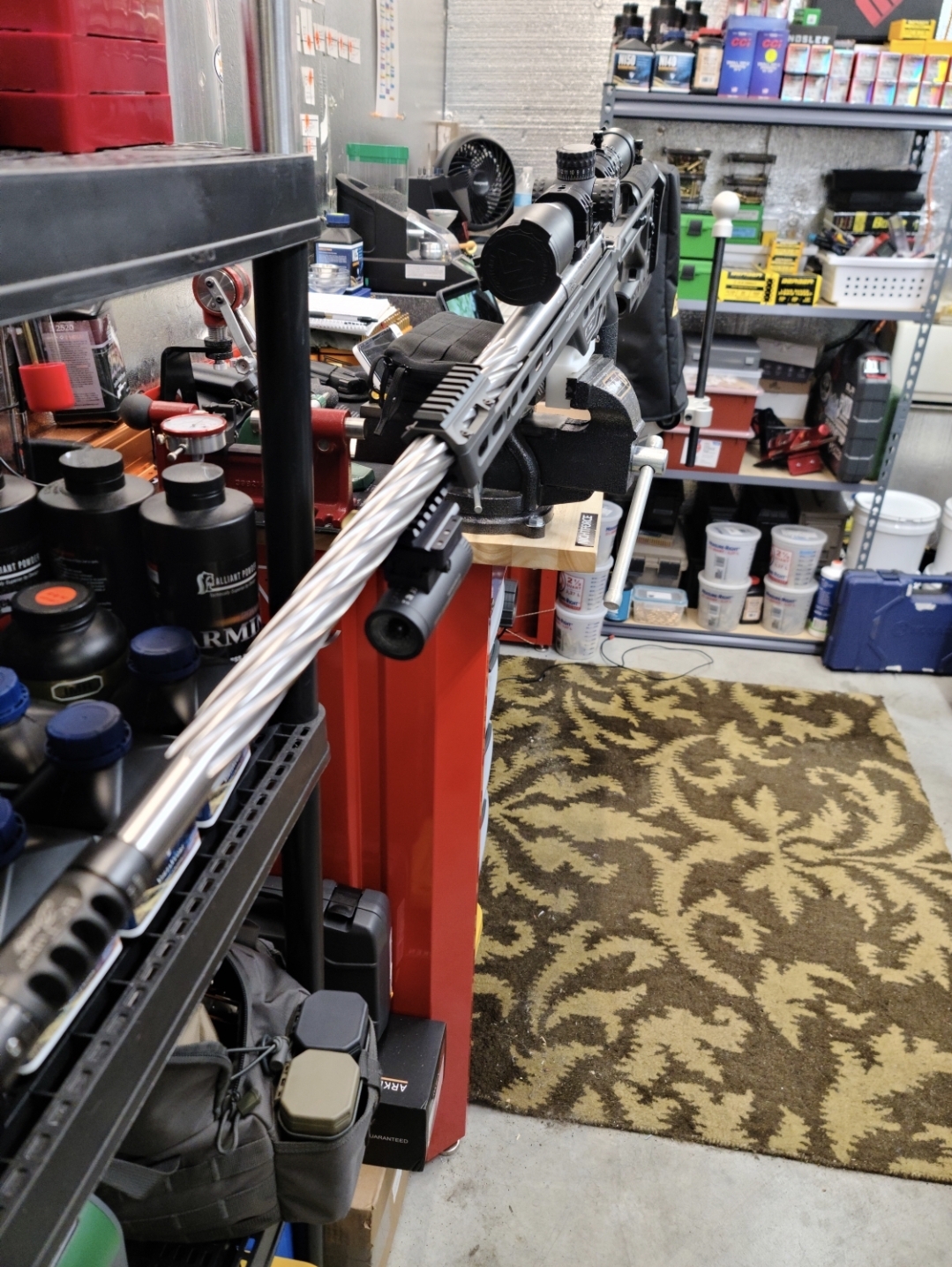

And here it is mounted on the bipod extension. When the CF tube is chopped appropriately there will be no shadow and the radar cone will intercept the bullet path maybe 12-18” from the front of the suppressor.
Seems like turning the bullet seeker at 90 degrees or more on that carbon tube would ensure a very clear view of the projectile.
Great idea with the 22degree cone. I'd put it on cardboard if I had challenges I needed to verify regularly.
