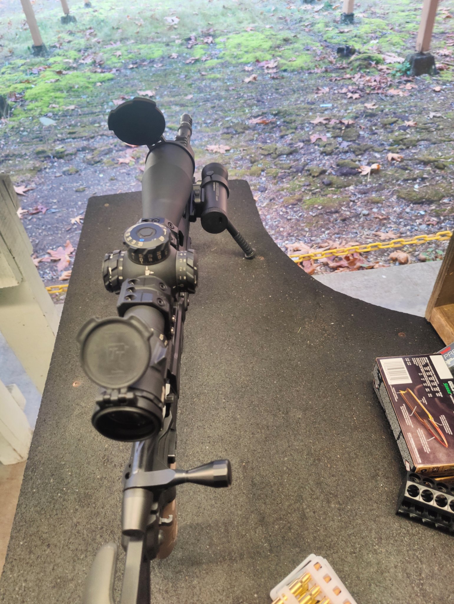

Mount mine right side just in front of the ejection port. Can move from rifle to rifle with no issue. Couldn't be happier.

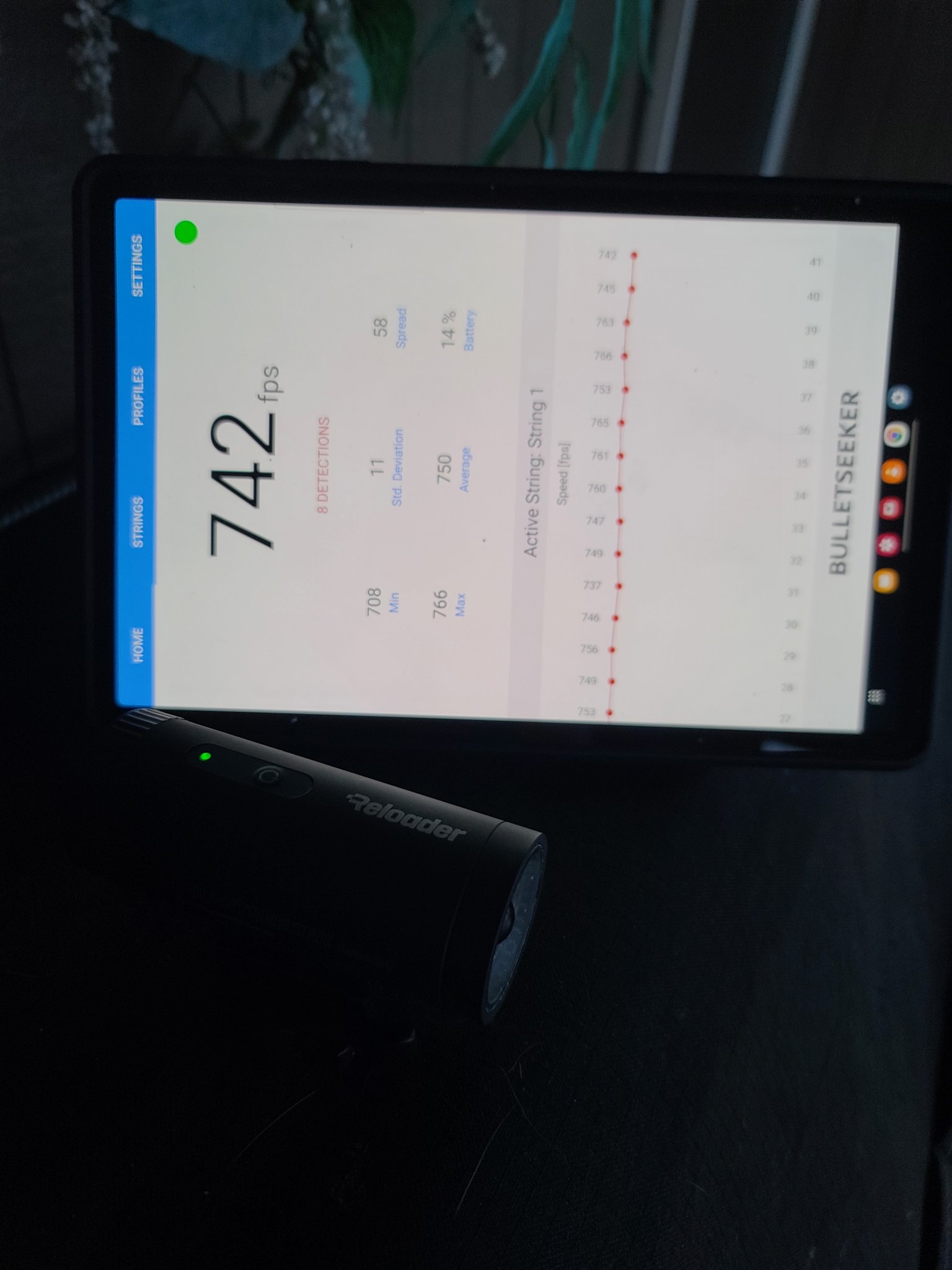

See this is in my backyard just sitting on my grill it just keeps spitting out readings my theory is that it happens when the battery is almost drained but yesterday at the range it was doing it at 95 percent battery so idk wtf is going on

Hey I'm starting to wonder If maybe the bs4 just doesn't like Samsung devices.. cause both of my s20 ultra and tab s6 it malfunctions by either disconnecting sometimes or spitting out readings like the 750fps even if I have my hand covering the bs4. Or maybe I got a lemon from ssd
Mine does the same thing especially in the wind. Even covering it gives readings.

Honestly though I know we got ours in the same batch and I think there is something wrong with the battery. Mine always happens when the battery gets low and I talked to longseeker and they are sensing me a new one
My battery is at 75% so I don’t think it’s the battery. Let me know how the replacement fares.
I mean ya I've had issues at all over but multiple times when it got under 20 percent I would get like 50 readings of 700ish fps in 1 minute... I will but it might take months who knows

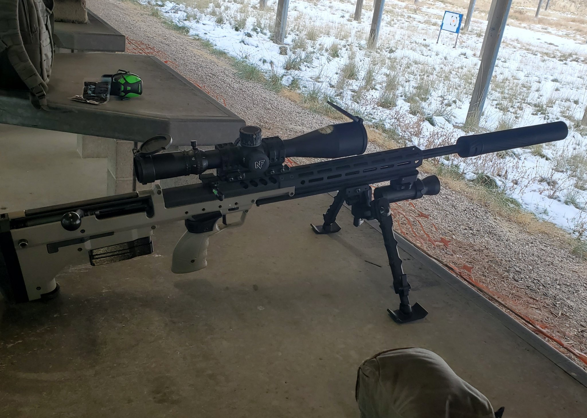

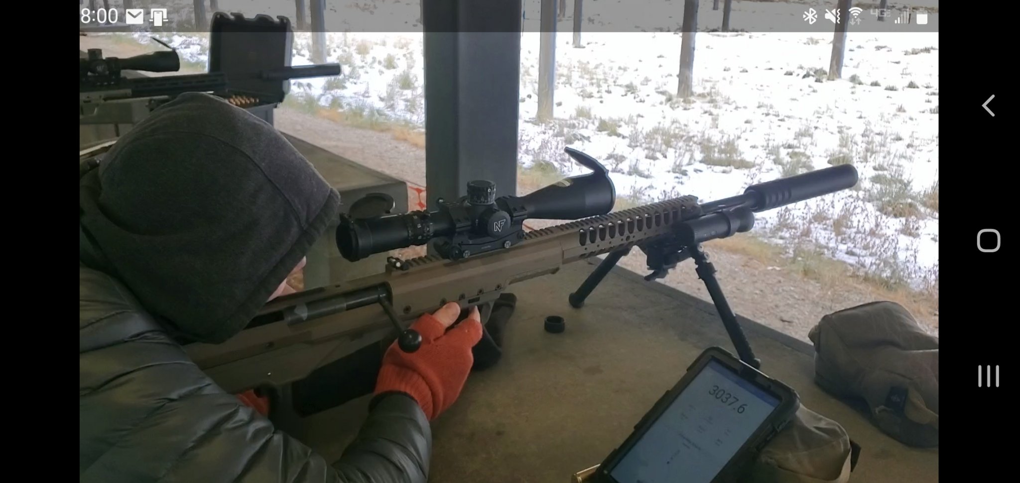

I'm genuinely disappointed that many users on SH are having so many problems with the BS4. I have had excellent results with mine configured as shown below and shooting suppressed. My two units have not missed a read on a shot yet after several trips to the range. However, it sounds like I have just been fortunate, because there appears to be some real problems with some of the units. Hopefully, BS can get the bugs worked out of the bad systems that have gone out. Fortunately, I have not experienced the issues that some are having. For expensive as these units are, they should work flawlessly and will not survive in the market if they keep putting out a significant percentage of bad units. FYI, I have used the Android version only. I have not tried the iOS version.
