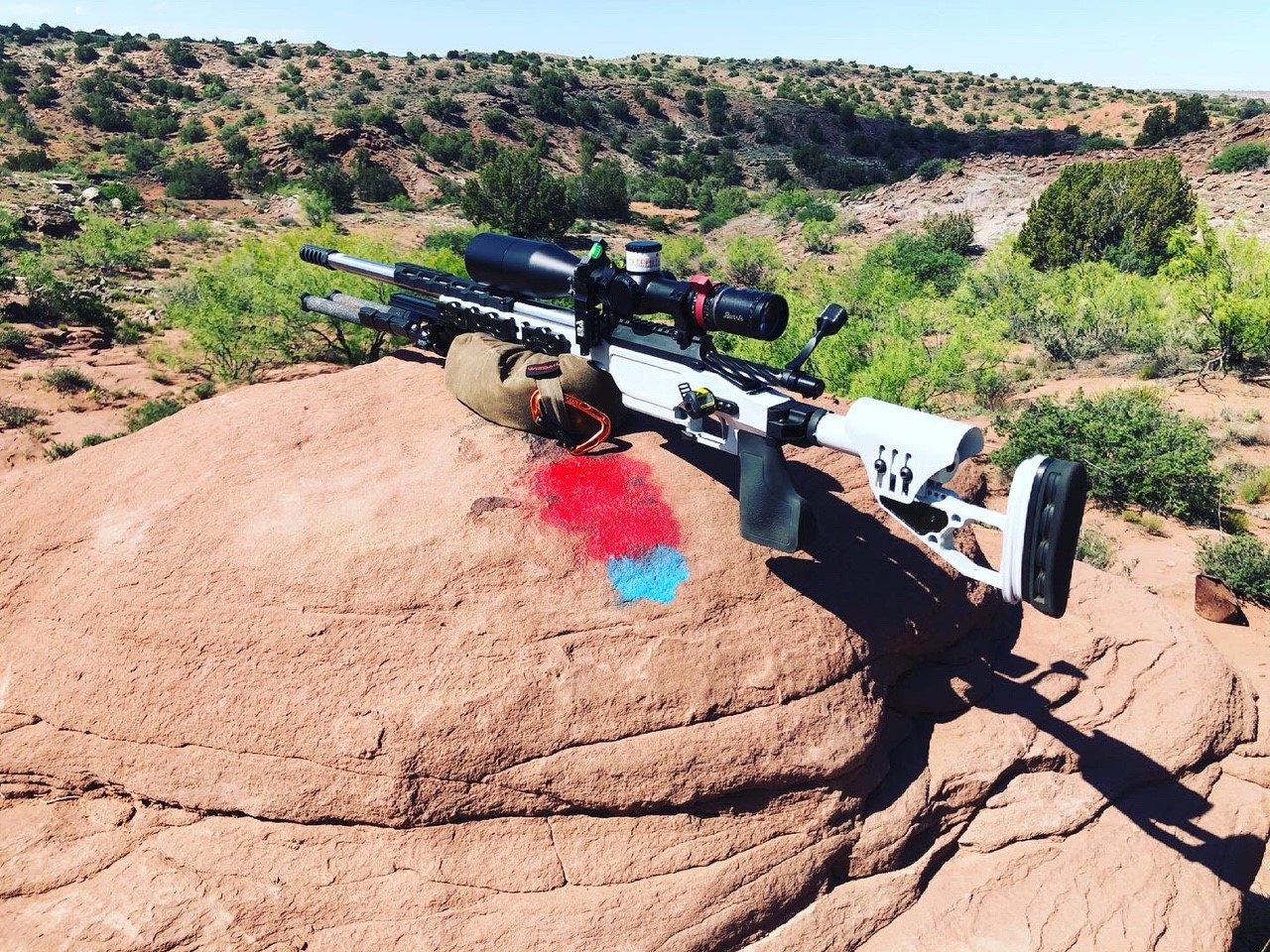

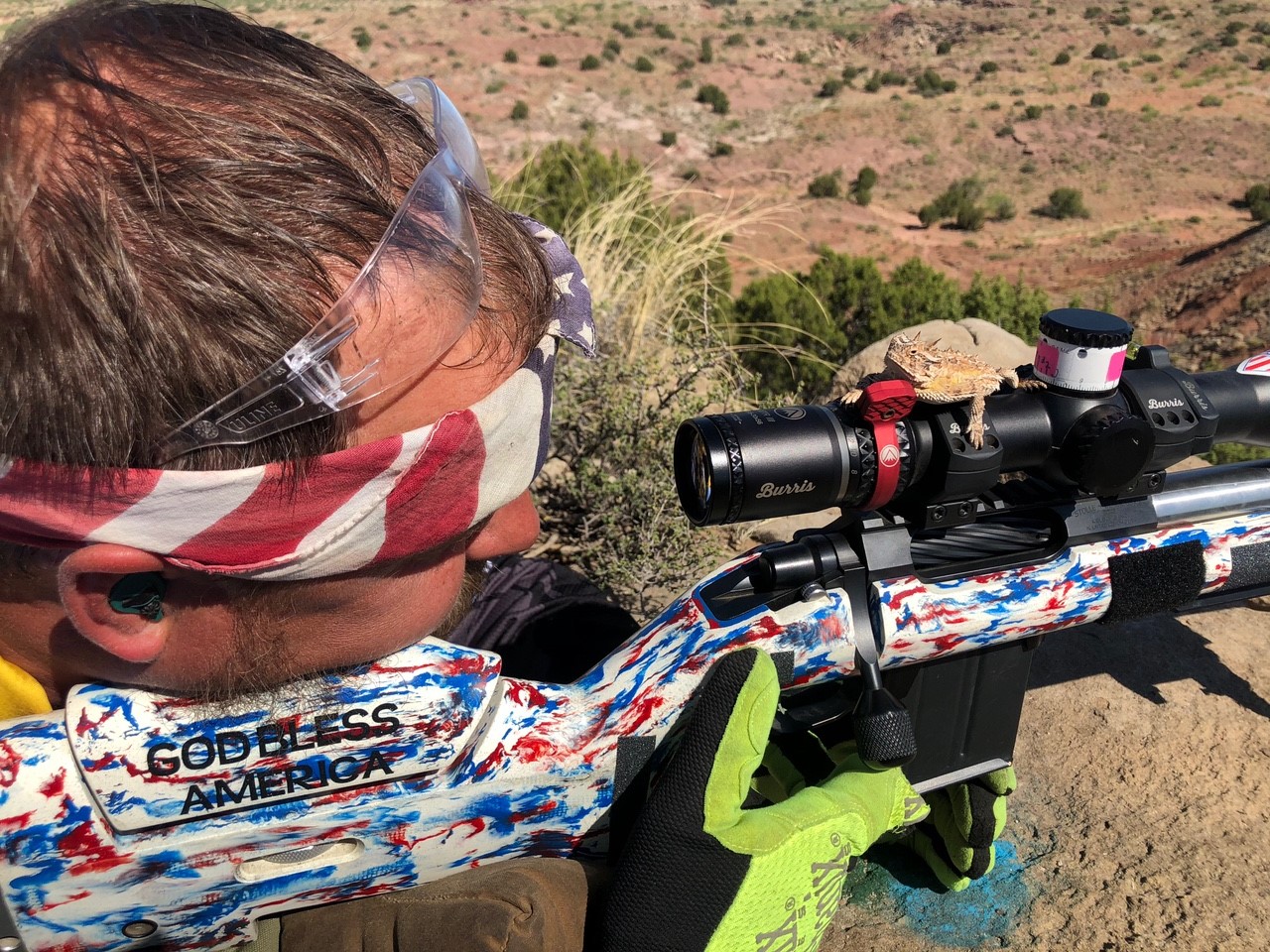

Great match this weekend. Was lucky to pull off a 2nd place. Was first rolling into the last stage up by 2 shots over dude that won. Went up and missed first 3 shots on a skylined targets. Darn it darn it lol. He cleaned the stage. Still happy.
Elevation was flat right on and during sight in I thought I missed the target a couple times as my shot went inside my previous shot. This bad boy is flat shooting.
MAN this blackbear action is crazy smooth. Literally had to check a couple times to make sure a round fed into chamber. I have or have owned all actions except for an Impact, and this guy is noticeably by far the smoothest Ive ran.
The only down side is the flat base of the action I cant swap into other stocks BUT XLR makes a chassi that is inletted for it. I hope other companies start to do the same. Will be a big selling pt but I guess I cant complain my Kelblys bedded KTS stock had no problems with accuracy dept.
SPECS
- Blackbear Action
- Krieger barrel 26"
- VV N140 30.0 grains
- 105 bergers going 2800
- Kelbly KTS stock
- Burris XTR3 with race dial (very very useful)
- SCR2 retc
- SAP 2 rnd holder (short br version)
Regards
DT
Lots of great scope talk here, but man, that is one sweet bandana!
