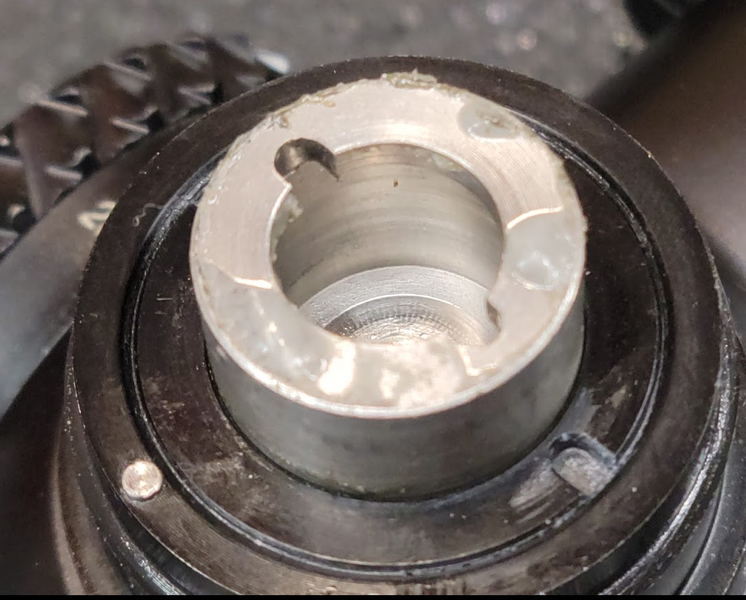

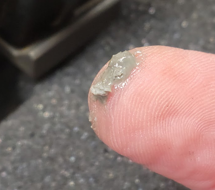

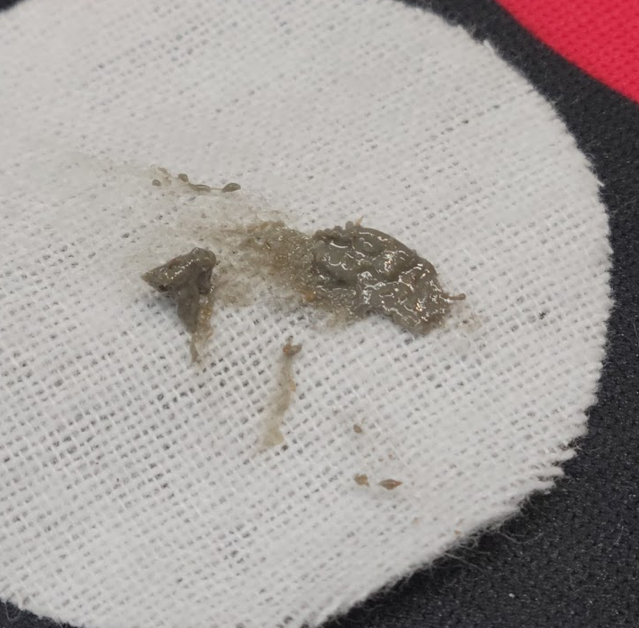

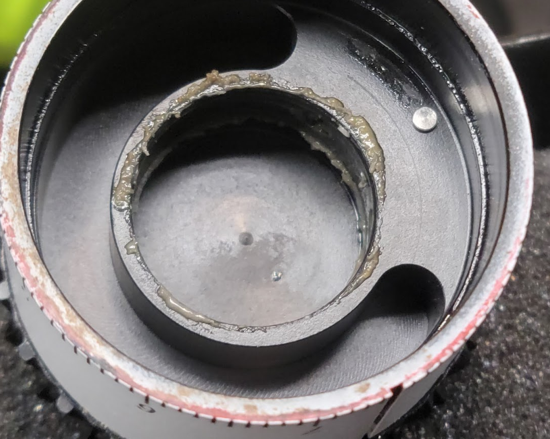

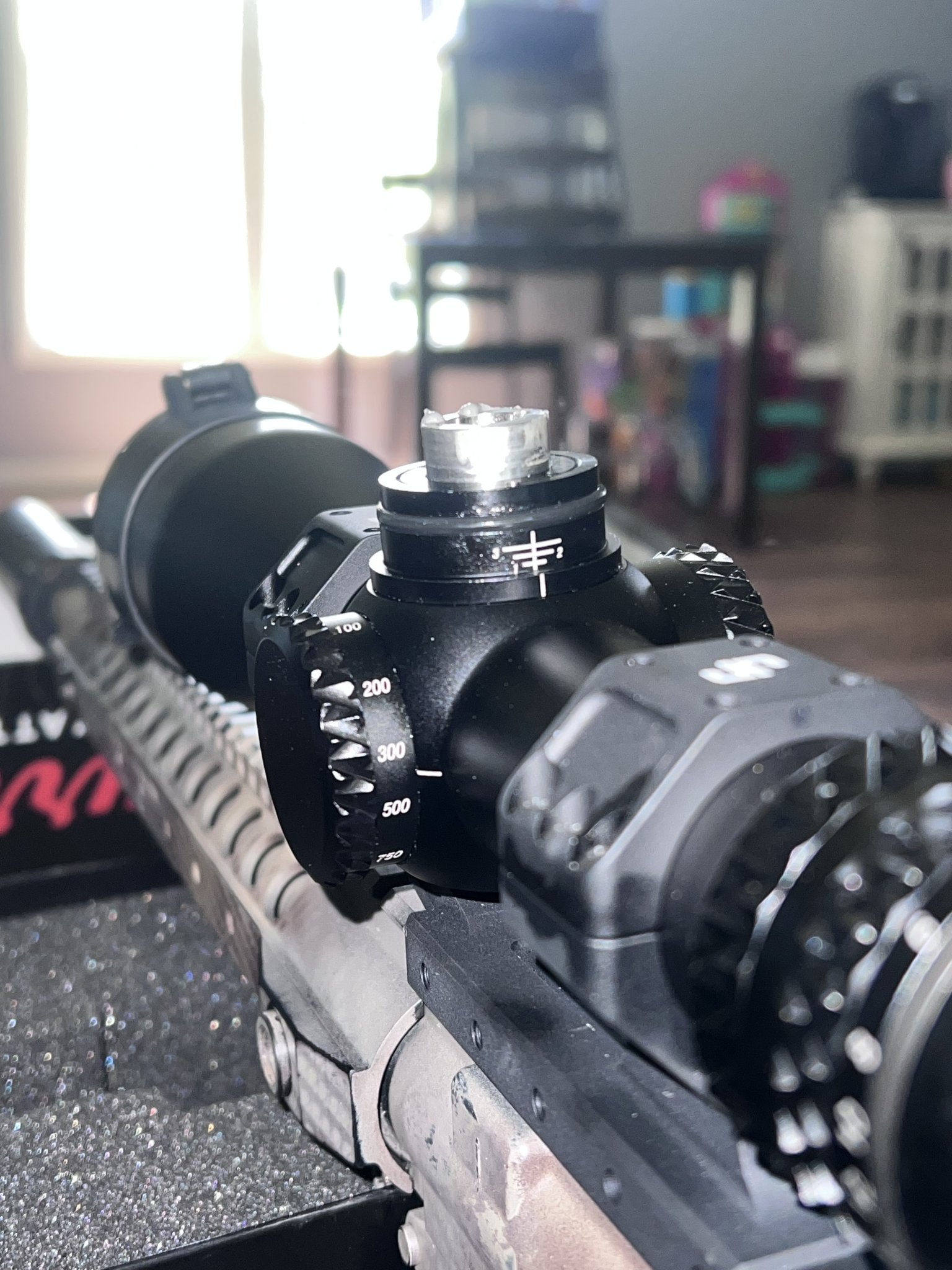

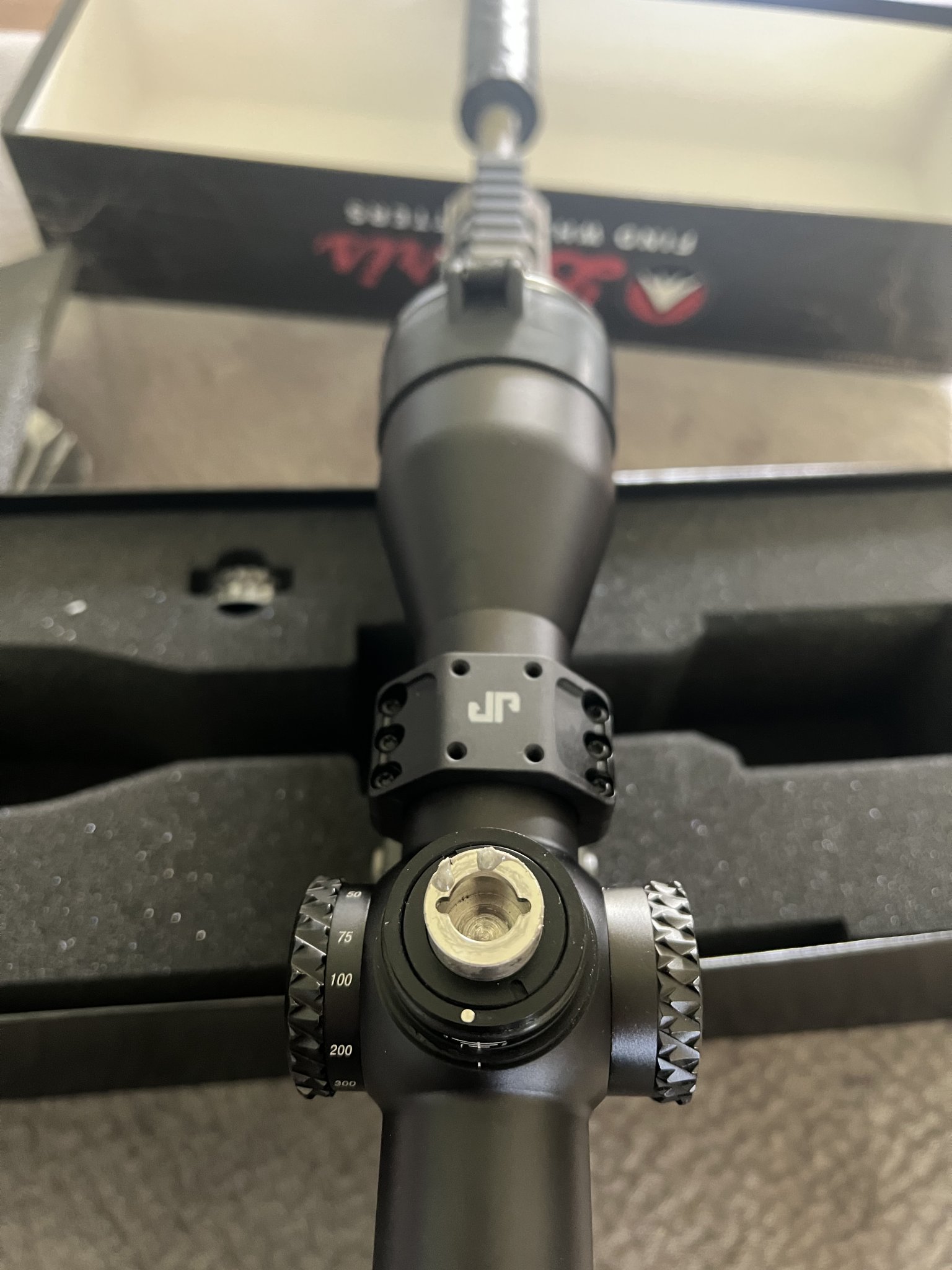

I have had my XTR3 for about 9 months..love the scope except one thing..the damn dial is stuff..so much so I avoid it 90 percent of the time in matches and just hold over. I thought it would get better with use but that is not the case at all...Anyone else have that problem? With the aggressive grip, it can "bite" you pretty good..especially in the cold. Other than that, it's a great scope..and has made me real comfortable with hold overs, which has made me a better shooter honestly..I do however wish it wasnt so hard to dial. Anyone else have this issue?
^I've got 2 - both hard to dial magnification - have to stabilize rifle so it doesn't twist or jump. Turrets are stiff, but no stabilization needed. Parallax is fine. Haven't used below 40 or so degrees.
I do not change my mag much so i dont remember if it's stiff or not.. all other dials turn fine as well. It's just Elevation for me. I do have to shoot below 40 but this went on in the summer as well..I bought the race dial (hard to turn with both dials) and I have to put enough pressure on the dial, that when I do turn it, I will usually wipe off my marks because I have to have a pretty good grip on it.
Mine did soften a bit, but I don't compete (haven't turned them much) - just the first few turns checking the scopes when they first arrived got them going. If it bothers you that much, maybe get it back to Burris (assuming they can loosen them)?
That was my next step..just wanted to see if there was another fix before I did that.
My very first one was really stiff, but it loosened up and feels very good now.
My 18x on my rimfire is still fairly stiff. Not annoyingly so, or to the point I dont want to dial, but its a stiff dial.
