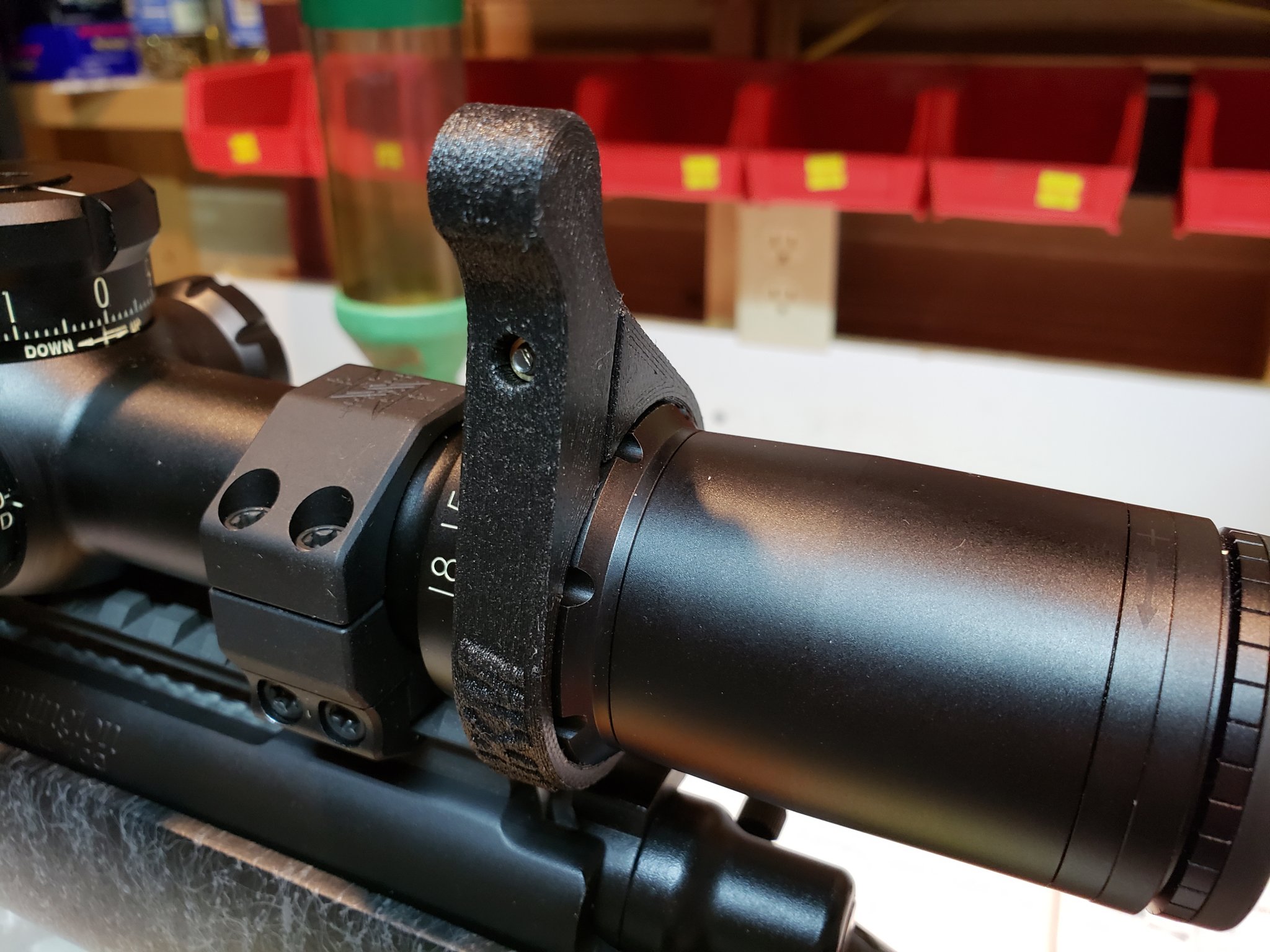

Got the lever today. Fit is great on the mag ring with some minor obstruction of reading the elevation turret setting which is not a big deal to me. Thanks Mr. Kemp.
