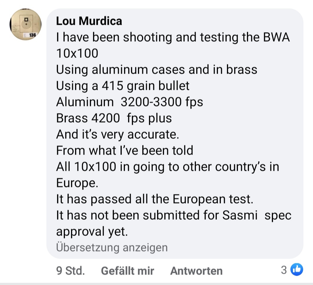

Here is the issue blackwater was claiming and hoping for 3500 fps with a light per csliber .408 bullet please note a light per caliber 408 bullet would have a shitty bc. So end results would perhaps be no better past 2500 yards then a high bc 375 cheytac going 3000 fps. Second issue claims of some one shooting the round at 4200 fps with a heavier bullet is way beyond that of the projected velocity that blackwater was hoping for and has produced nothing to the public as to ever exceeding it. So if they had trust me we all would have heard about them bragging about it by now. The cartridge case used by lou was a lathe turned Rcc case. And trust me if any one knows about limits of lathe turned cases in 272 alloy your speaking to him. In short. Its not going to happen by that design. His barrel was not long enough . Even If the case was beefed up to handle the pressures there are many other issues like the action not being designed to handle pressures needed to have his claimed results he also claimed special extra slow powder that would have a negative out come with his barrel length. There is no free lunch when it comes to performance based results and designs

Not saying if it’s true or false…
I want info as well but if he has a contract and a NDA for testing…he can’t give data out just yet.
Be realistic. First it was 3500 fps, then 4000fps, now 4200+. Even if I want to believe it, I only believe what I see. Why not a single video, with no cuts, from the load to the shot to the numbers on the chonorgraph. (Video without cuts and editing). Then I'm willing to seriously apologize. Until then, I remain skeptical, to put it politely.

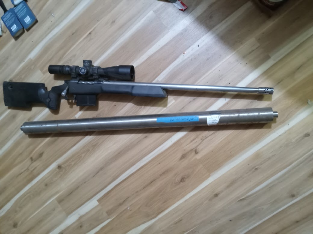

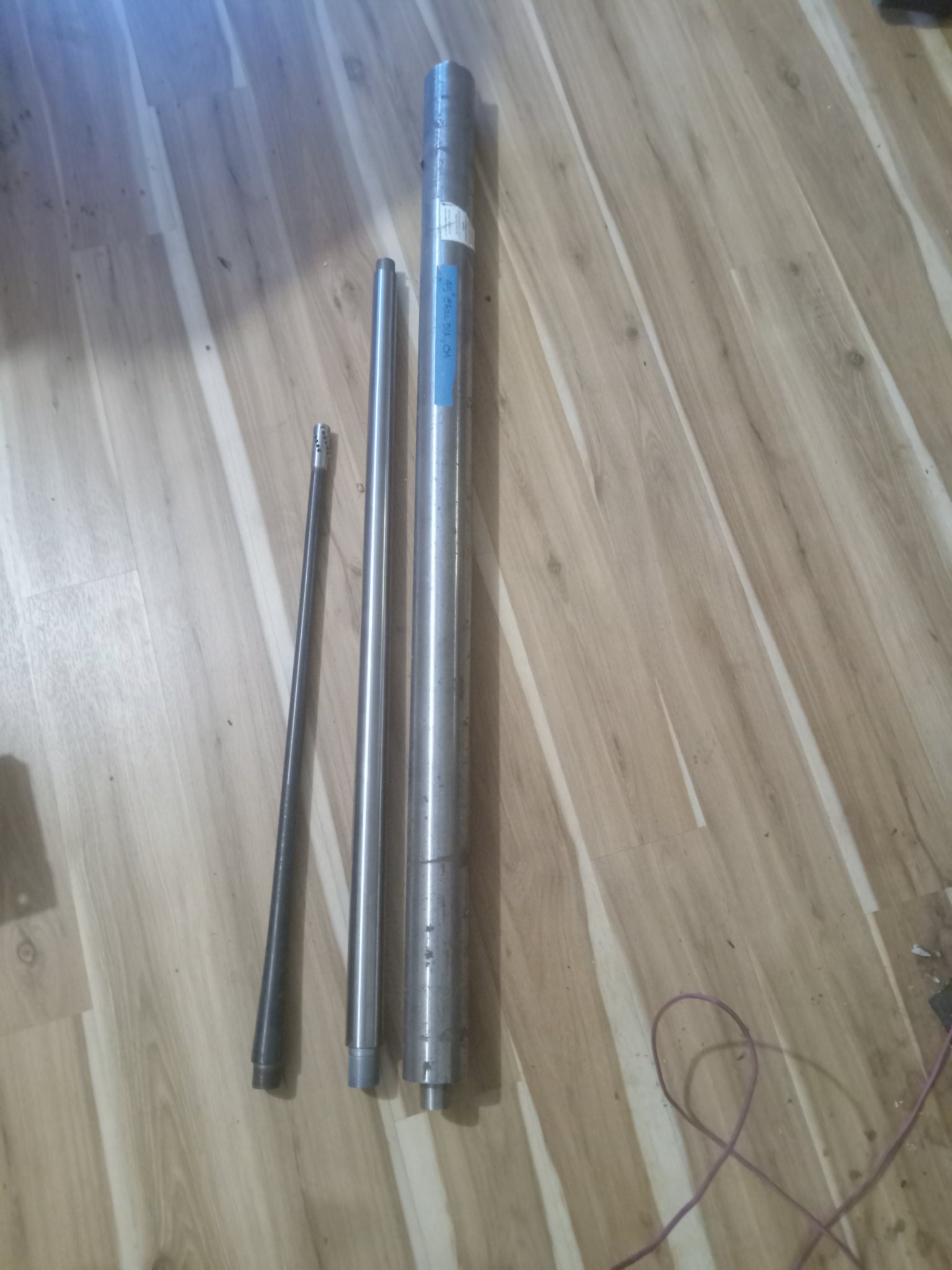

My longest barrel is 45 inches long 2.5 inches straight cylinder and it weighs 65 pounds just for the blank
Think about it like this. How much lighter, easier to handle and nicer would it be if you could achieve the performance you want with a 38 inch barrel instead of a 45 inches. What I'm trying to say here. Ultra long barrels are not necessarily needed to achieve better performance if you can run higher pressures. Personally, I don't like it when rifles are longer and heavier than necessary. But some people may see it differently.
By the way, in what caliber will you chamber the 45" barrel?
The barrel was intended for a 50 caliber wildcat on a 20mm case but will now be built as a 50BMG Ackley Improved.
In the picture 7 RUM 26 inches plus brake then 36 inch 375 Snipetac then 45 inch 50 caliber barrel and next to typical elr rifle

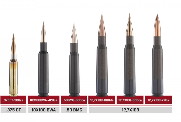

So some of you may or may not know that Blackwater Ammunition has a new ELR cartridge, projectile and powder combination they have been working on.
It is the 10x100 (with 420gr projectile) shown in photo below for comparison to their 375CT, 50BMG and 12.7x108
