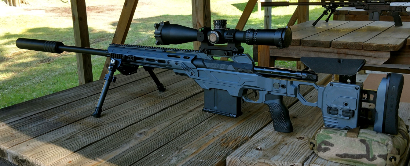

Here's Jake's new .375 Shadow!

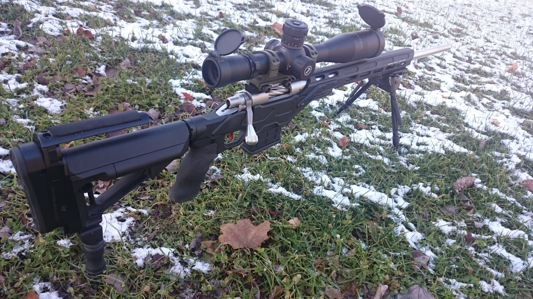

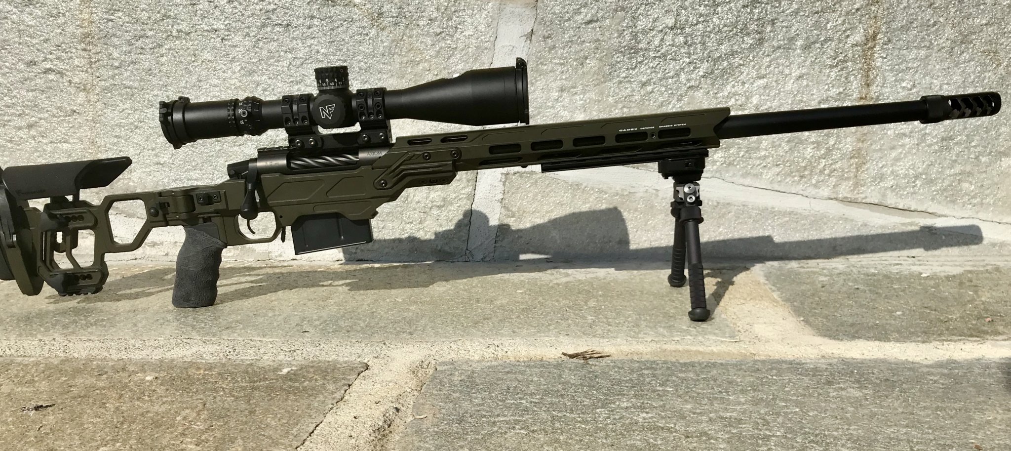

Loving mine! Field Tactical Chassis with Stiller Tac300 in 6 Creedmoor with, spare PTG bolt and LA bottom metal to shoot 300win Mag. WTO SwitchLug with Criterion Barrels. Timney 40x flat trigger set to 1lb.

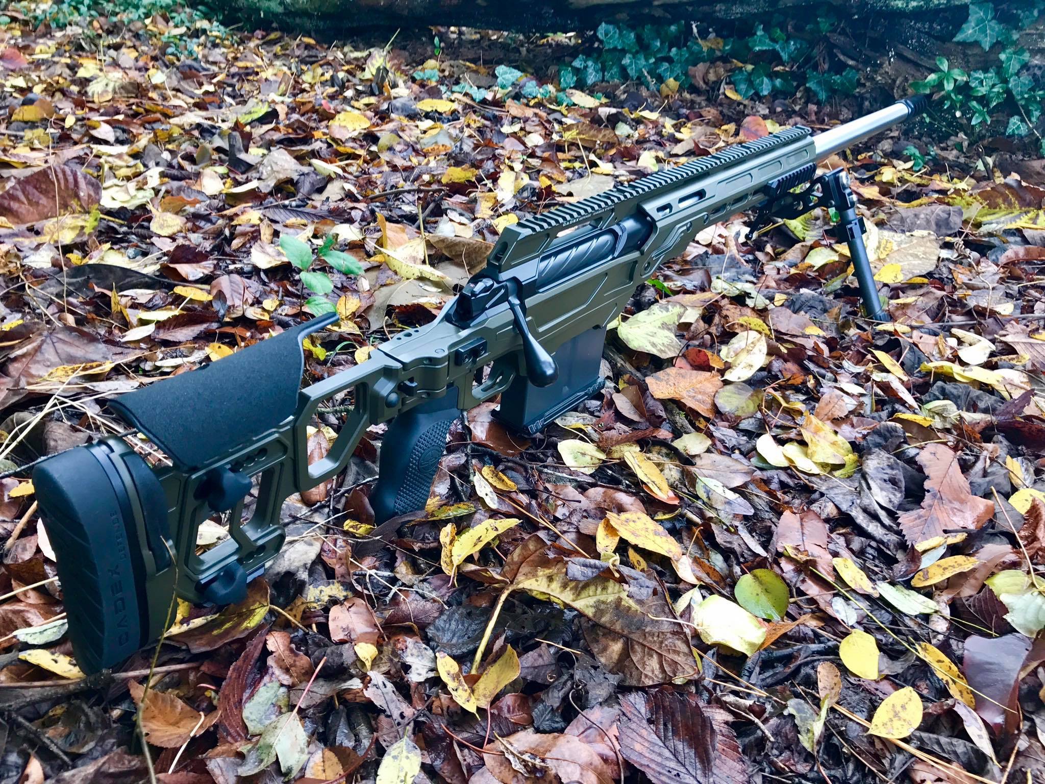

Picked up a cadex CDX guardian in 6.5CM. I have always been am AI fanatic, but I think Cadex has converted me. This rifle is gorgeous. I have to say one of my favorite components I never see mentioned is that the folding stock has a buffer on it to prevent pinches and slams. Like a fancy cabinet door. Im wierd... I know. I hope I get to keep it, but I have too many rifles.

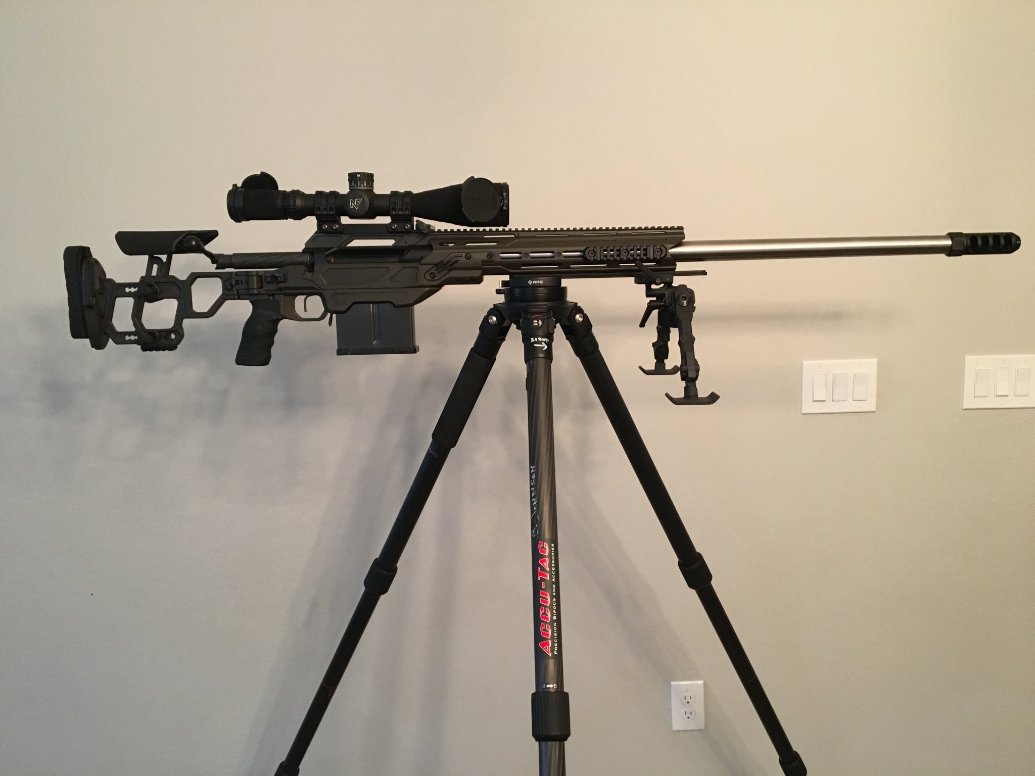

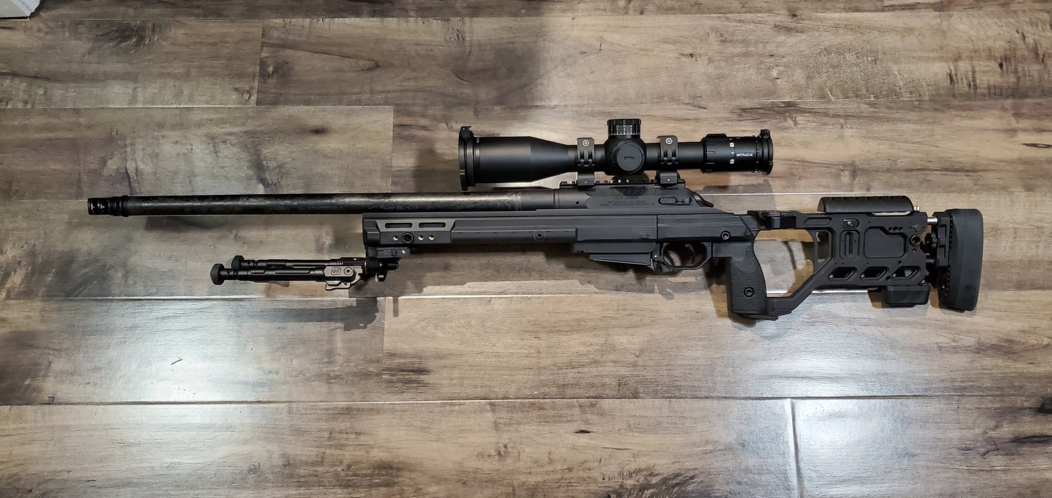

Cadex Sheepdog action. 6.5 PRC. 22" proof sendero 7.5 twist. Whiskey 3 folder. ZP5 3-15 MR2 in Arc mediums. Cadex DX2 trigger. TBAC Bipod. Spigot is on it's way still for the Whiskey3. Will wear my ultra 7 most of the time or the ultra 5 once that one gets approved. 156gr bergers with ADG brass. Well see how it does.

Great pairing. KRG W3 is my favorite chassis.

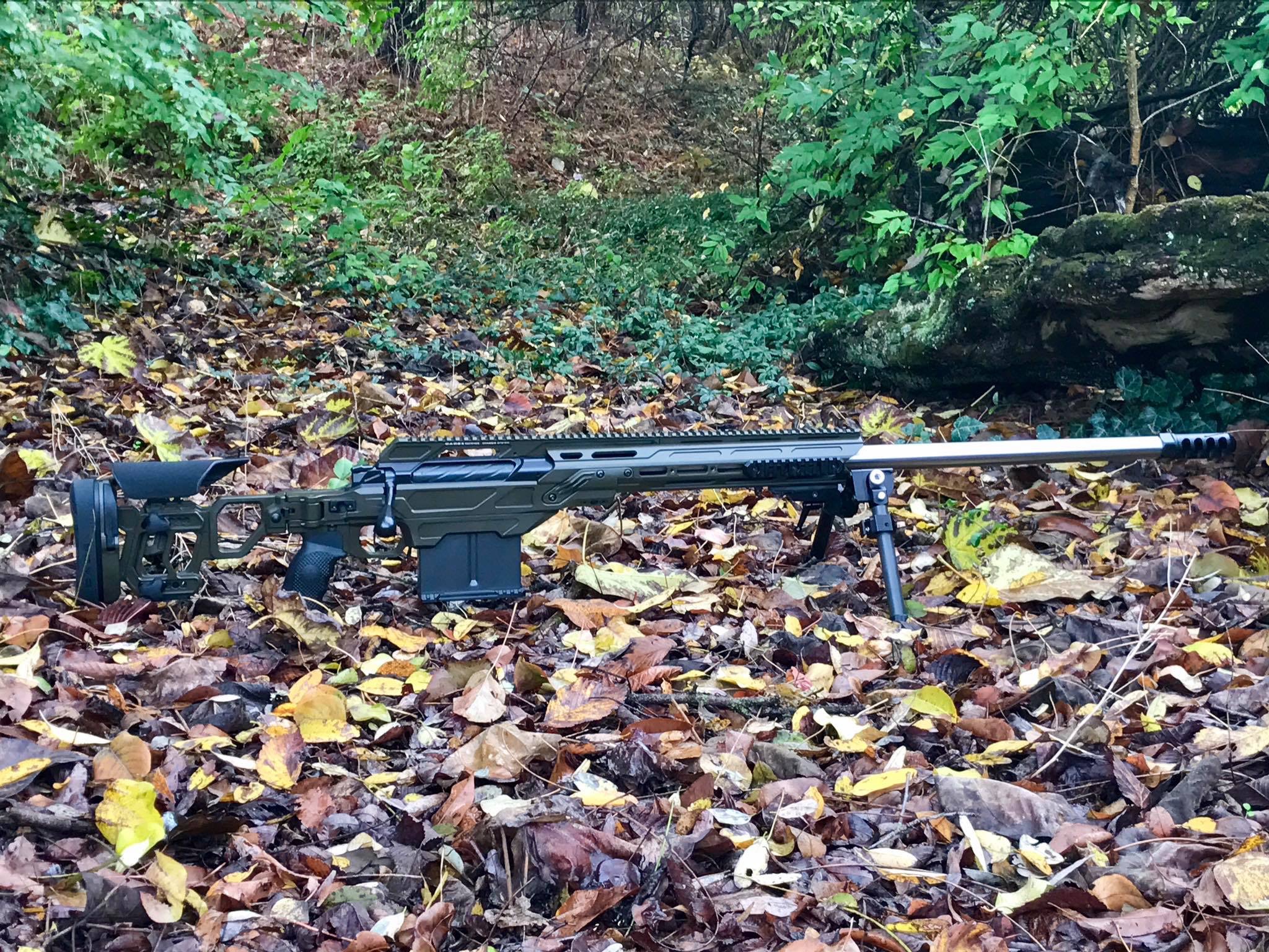

Rifle is a Remington 40XC-KS. 223 Wylde.
Chassis is a closeout from Eurooptics swapped to the Magpul/SAPR combo. combo. Magazine is from MDT.
The SAPR isn't quite as tall as I'd like but it is workable. Magazine feeds okay but not great.

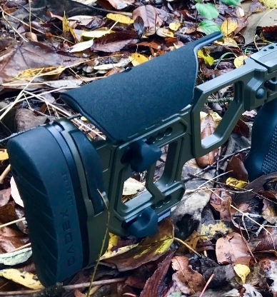

I'm trying to zero in on the material used on top of the cheek rest..... It's a softer stick or glued on material.... Looking to get more of that for my other rifles....
Any insights on what is used by cadex or alternative options would be appreciated
