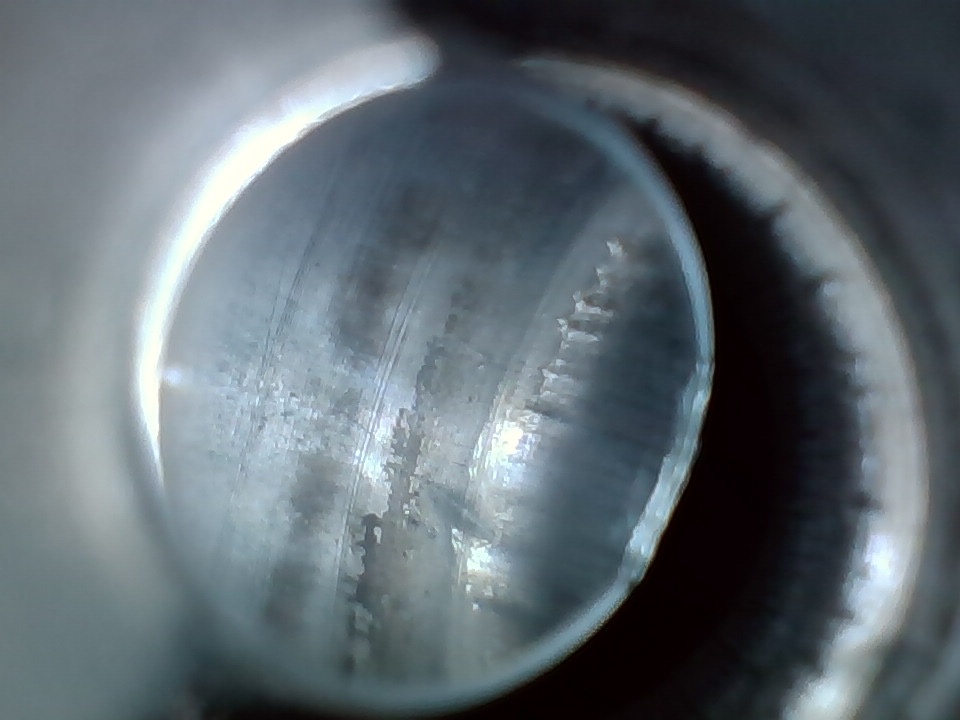

Where did you take that picture at? Is that at the case mouth junction? That's what it looks like to me. Let me know.
Yes. I believe so. If I have my chamber terminology correct, the upper part of the previous photo is the end of the neck area, and the part just below the lip in the bottom is the freebore before you see the lands and grooves (leade?). Here are some additional snaps. This is from an AI-AT .260 Bartlein barrel (Gradous) with about 1800-2000ish rounds through.
Before attacking the Carbon ring
After soaking the chamber with a nylon 9mm brush wrapped in a patch soaked with Boretech C4 Carbon remover for about 45 min:
I bought some CLR in case the C4 didn't get it out. But the Boretech C4 worked like a champ. I just left the patch/brush w/ C4 in the chamber for a while and then gave it a few twists by hand, patched it out and then re-scoped it and viola!

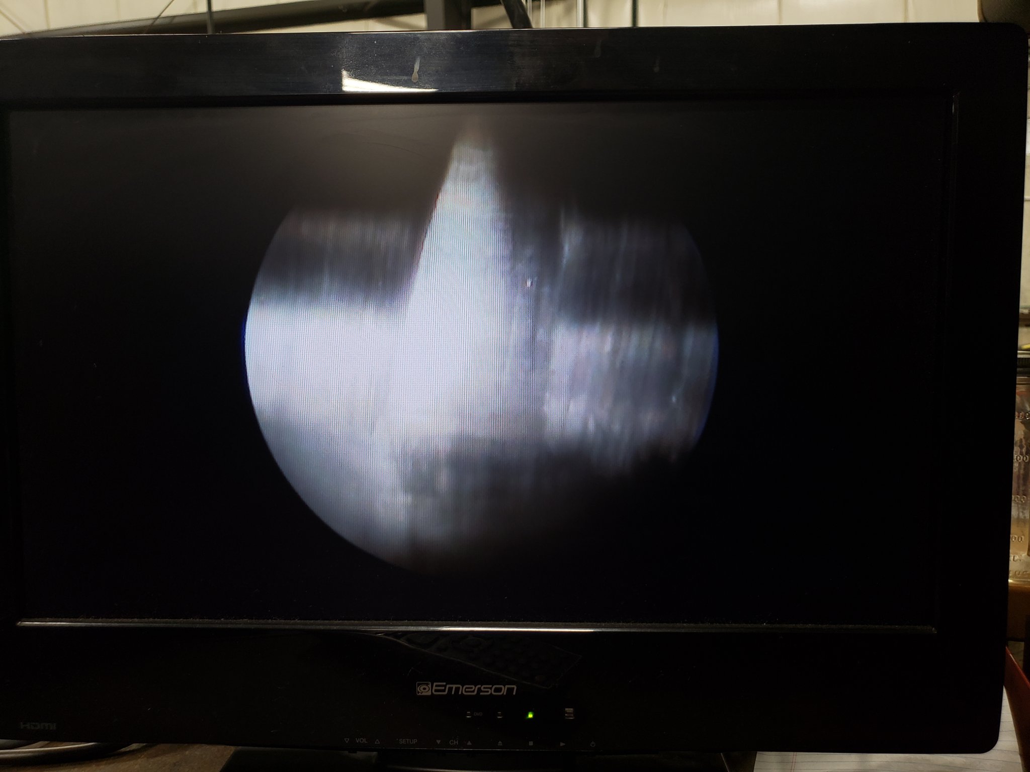

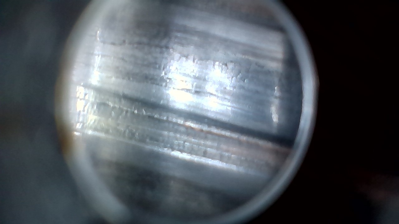

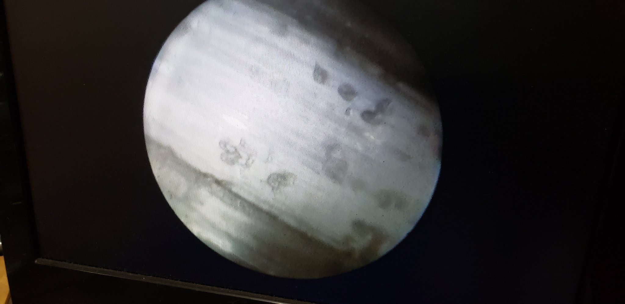

Hey Frank, is there any chance you could post some pics of pitting versus carbon build up and maybe even describe what to look for and how to decipher the difference between the two when looking at it with a borescope. We see these pics of what people call pitting but often it has a more raised look to it and looks more like carbon buildup than actually pitting. If you could possibly give a quick lesson on what to look for and how to tell the difference it would be greatly appreciated.

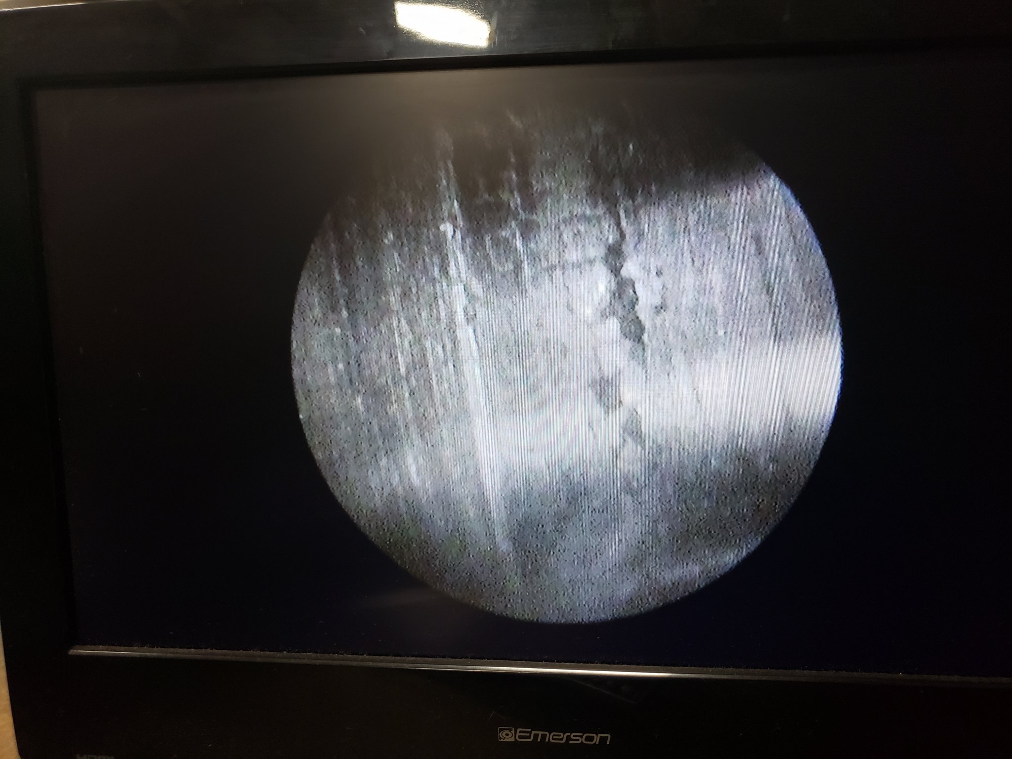

Sorry not the greatest picture....but this is the real early stages of pitting in a bore of a barrel.

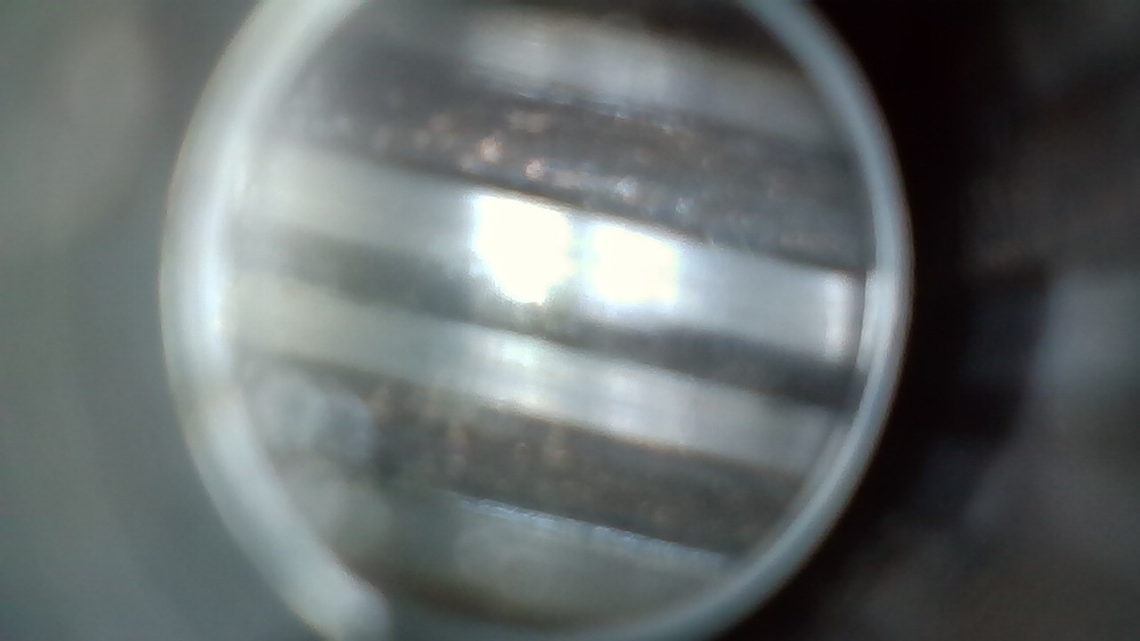

Again sorry the pic's are not the greatest. Here is what a new throat looks like and one that has 14k+ rounds on it. The used barrel was a accuracy ammunition test barrel I got back from Sierra. Up to the 14k+ rounds it was holding 1/2moa. Caliber was 308w and 1-8 twist, 5R rifling. The black spec's are actually little areas of metal that has broken/flaked out of the bore and then they get filled with carbon etc....

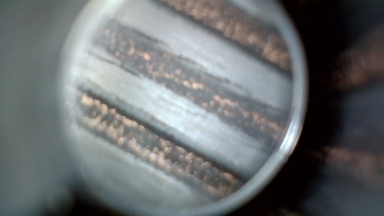

Carbon Ring formed in my custom 6XC. Can hardly close bolt on round. Bore scope confirmed ring so I immediately came to this thread. I appreciate the ability to use this thread to remove and prevent in future. Thanks for all the input by Frank and others.

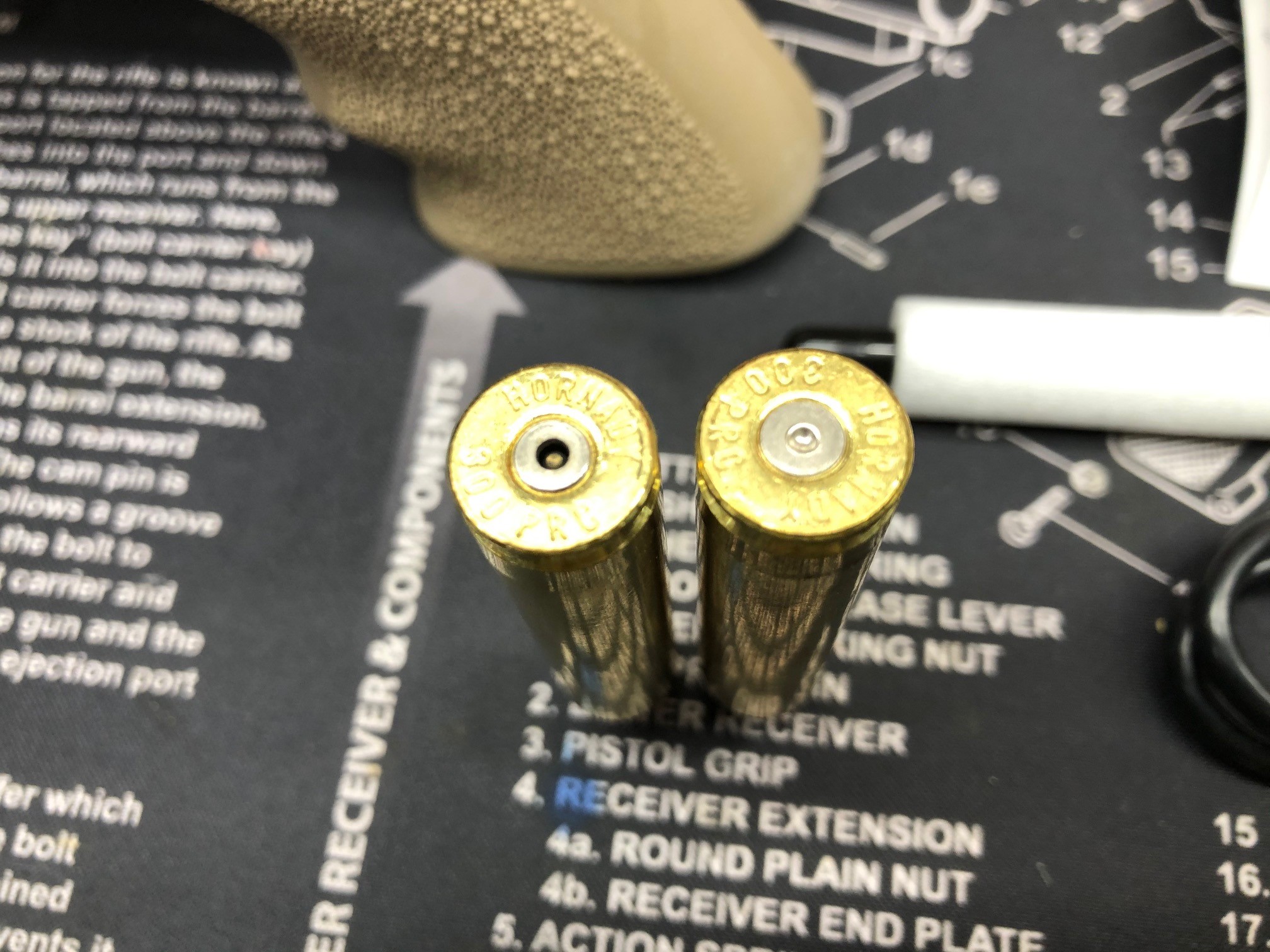

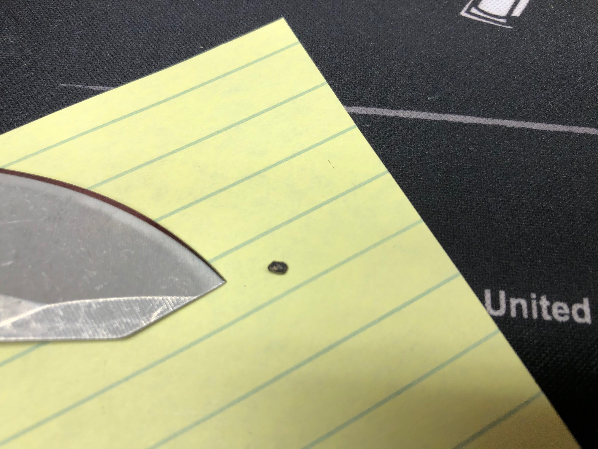

I was shooting factory rounds in my 300PRC and noted higher than normal velocities on the labradar. The 4th shot I pierced a primer so I took the rifle off the line. I got home and took the barrel off the AI and found a factory round would not drop freely into the chamber. My bore scope confirmed I had a significant carbon build up in a barrel with 354rds. I have been using bore eliminator and an occasional nylon brush, but clearly I need to up up my cleaning regiment.
I try and use my bore scope sparingly but I broke it out to find not only was their carbon in the first 6 or so inches of the barrel, I had a nice carbon ring. Anyways, I ordered some bore eliminator C4 and JB paste and until it arrived, used a gentle cleaning cycle and soaked the barrel overnight in kroil.
The C4, and a kroil soaked patch with some JB, took care of the ring and carbon, so a factory round will now drop into the chamber un-impeded.
Pics show the pierced primer and the small piece of the cup that got blown back into the AIs bolt assembly.

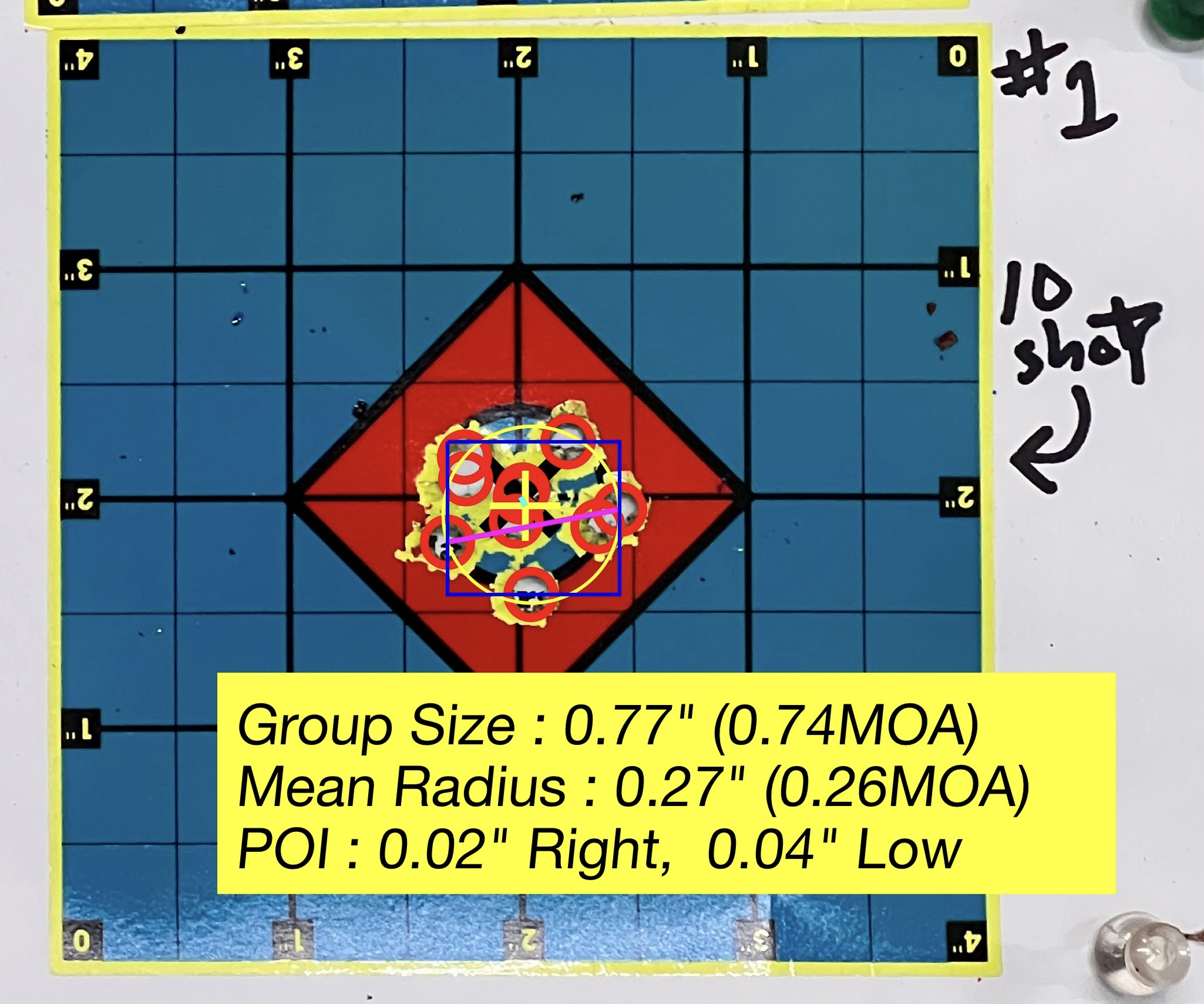

Just want to say thanks to @Frank Green for the carbon ring removal and bore cleaning techniques. I didn’t know anything about carbon rings before joining this site, and had what felt like hundreds of bore cleaners lol.
Before, this R700 204 gun would throw some flyers and mess up a good group.
This 10rd group at 100yds is after using Frank’s blue JB paste cleaning method. Had to modify it a little for the little 20cal bore. Bug me for details if you want. Also bought a cheap borescope to verify the ring was gone.
Shot about 30 rounds after that cleaning, cleaned with Hoppes #9 as per Frank, and the below group includes the cold bore shot. This is with the semi-shitty factory Hornady Superperformance 40gr 204 ammo, with 130fps ES and 38 SD.
The pdogs, they will be crying extra hard this summer. Thanks Frank!
I recently devised and tested a method that requires no manual work, uses commercially available parts and safe solvents (Boretech Carbon remover or Eliminator or anything you want, frankly) and gets the job done in less than 24 hours.
It will probably be the subject of a video at some point.
