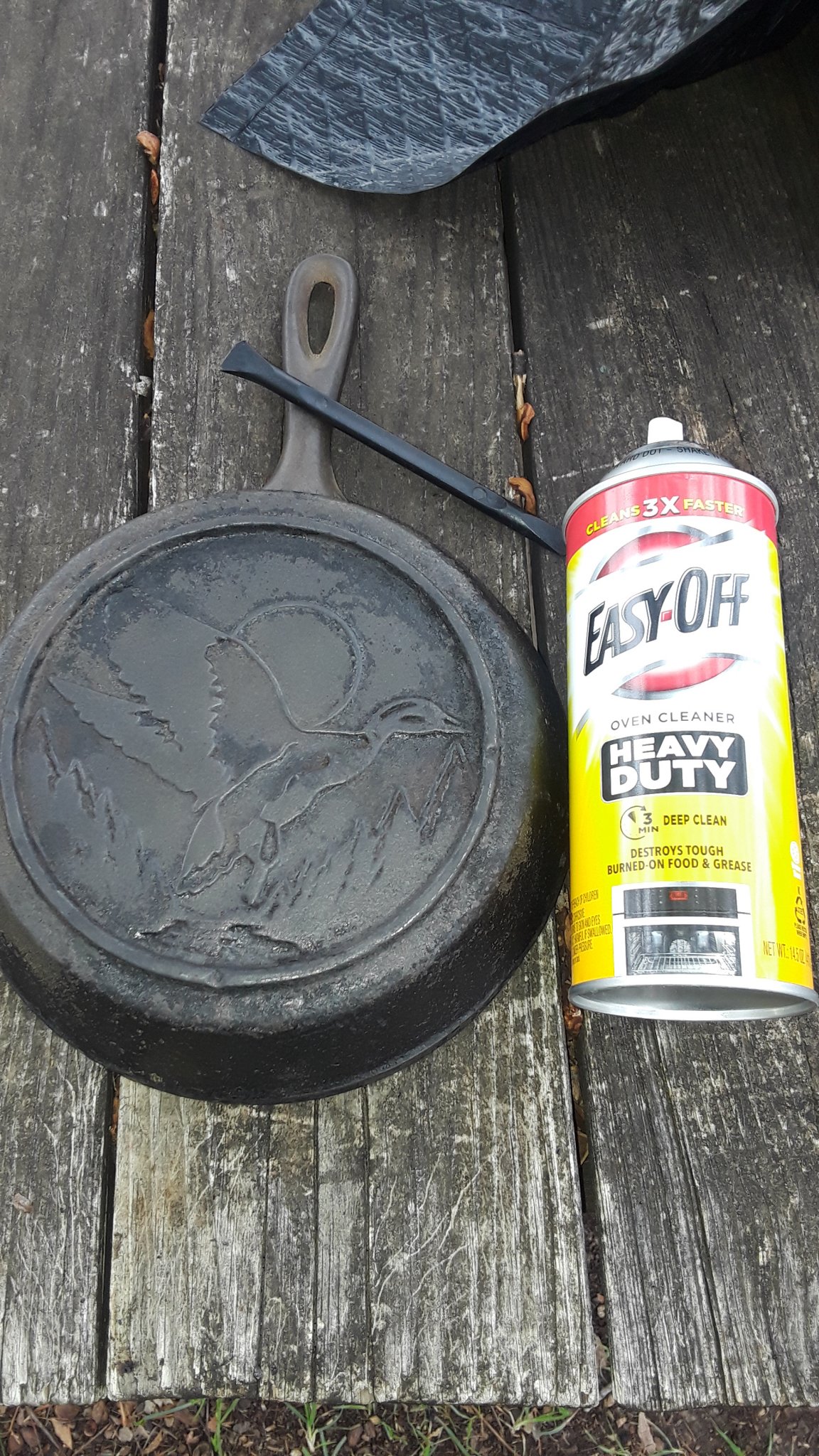

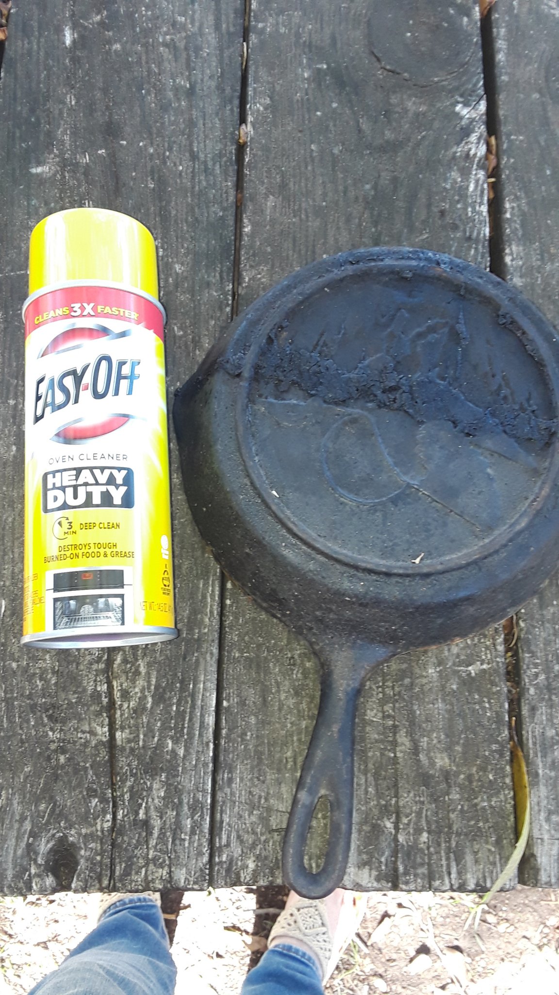

Well I decided to see what was under the crud of this abused left to the weather pan.
24 hours later I find this.
What company made this?
Still in work.
That was sprayed with the oven cleaner (lye) about 24 hours ago.
I didn't rinse scrub or anything prior.
When I pulled it out of the plastic garbage bag I rinsed it, and scraped around with that plastic scraper nothing else.
There's still a tiney amount of gunk in the fine details and around the fire ring. Almost half the surface came back to unseasoned grey cast iron.
I am trying to remove all prior seasoning and start from scratch.

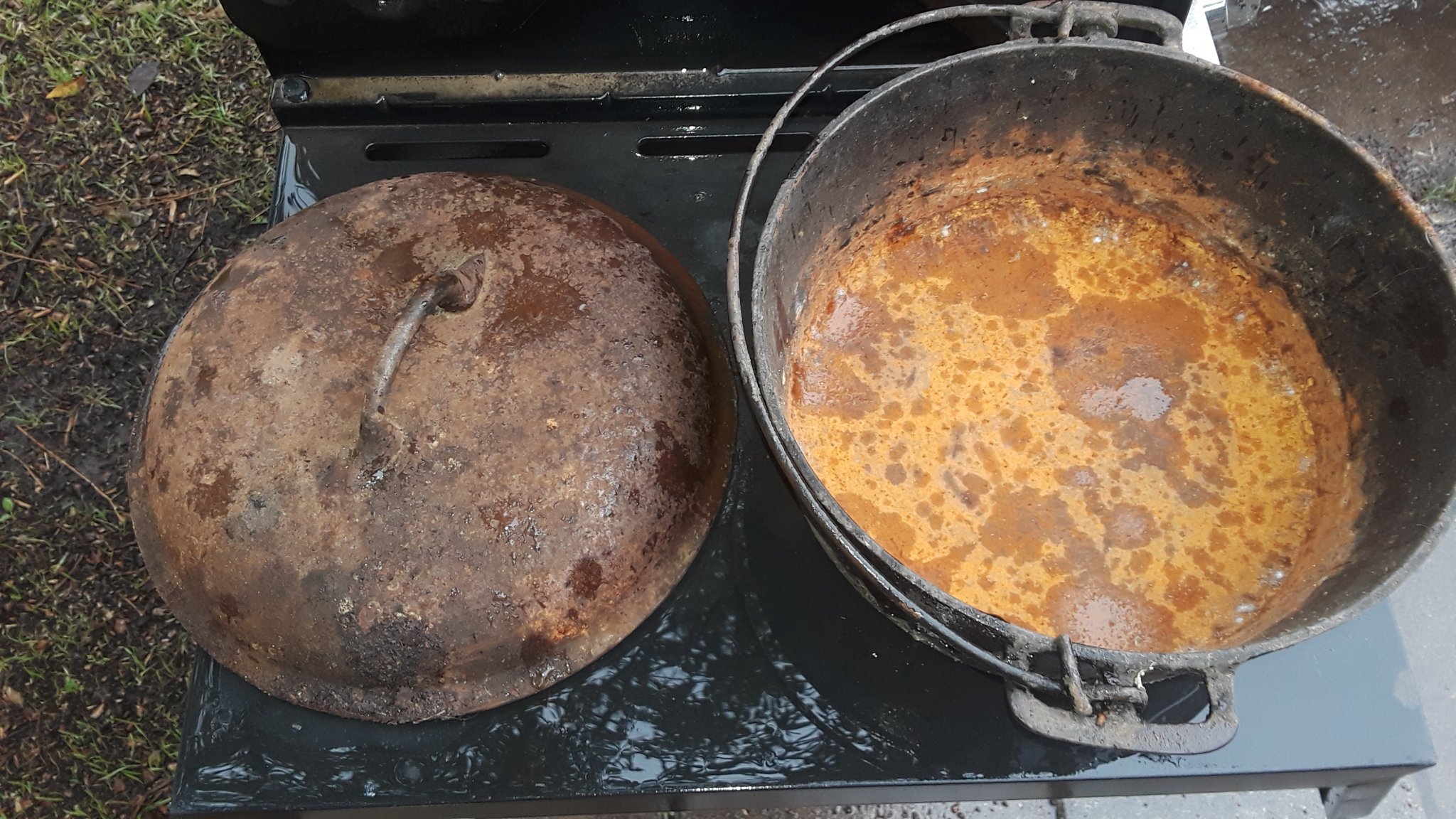

Get a load of my next project. Not sure how to start.
Still in work.
Good luck, that looks like a mighty fine Dutch oven. Be sure to post pics when done.

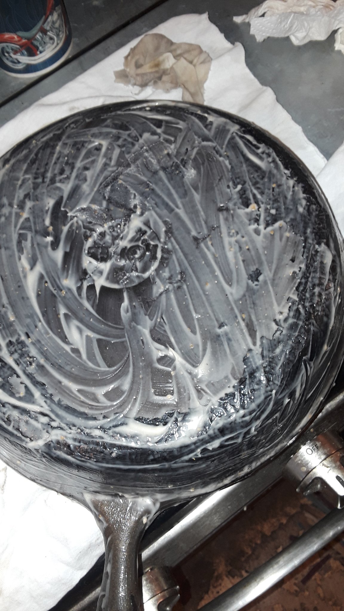

Well my hands give out scrubbing the duck pan.
Three trips overnight in the oven cleaner and scrubbing on between.
After rinsing off the cleaner (outside) was looking decent.
Two scrubbing with soap and a blue scotch bright pad and final hot rinse.
Done for a daily driver.
Warmed on a stovetop and grabbed a 20 year old worn t-shirt and some crisco oil.
Oiled it up and sat it on the shirt remnant , started laughing my ass off.
You couldn't make this up .lol
Seems after a point you get diminishing returns on the oven cleaner soak.
So the rust bucket Dutch oven is going two days on the first run.
Plenty more to work on.

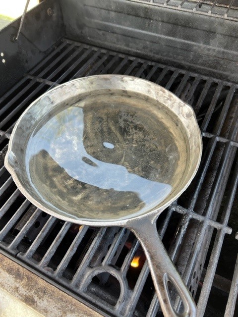

The molasses trick does work....if you're ok with it taking a long ass time. I did it to an old set of heads off an engine I pulled. Hardest part besides the waiting for it to work was actually finding a feed store that could get me the molasses, for whatever reason its not stocked in my area.
Reactions: tomcatmv
What solution did you use? 1part molasses to 1 part water?

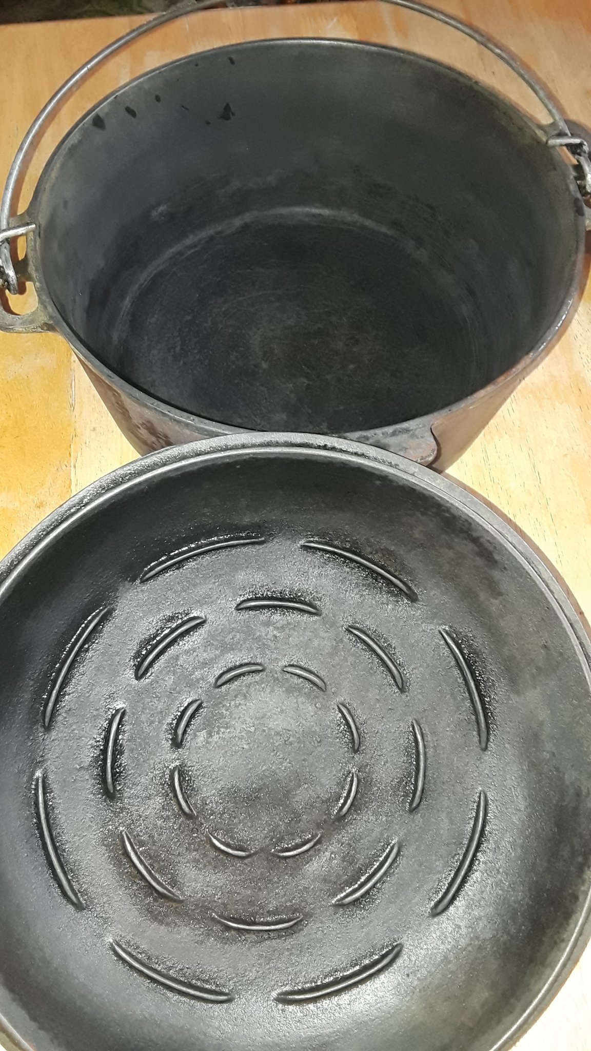

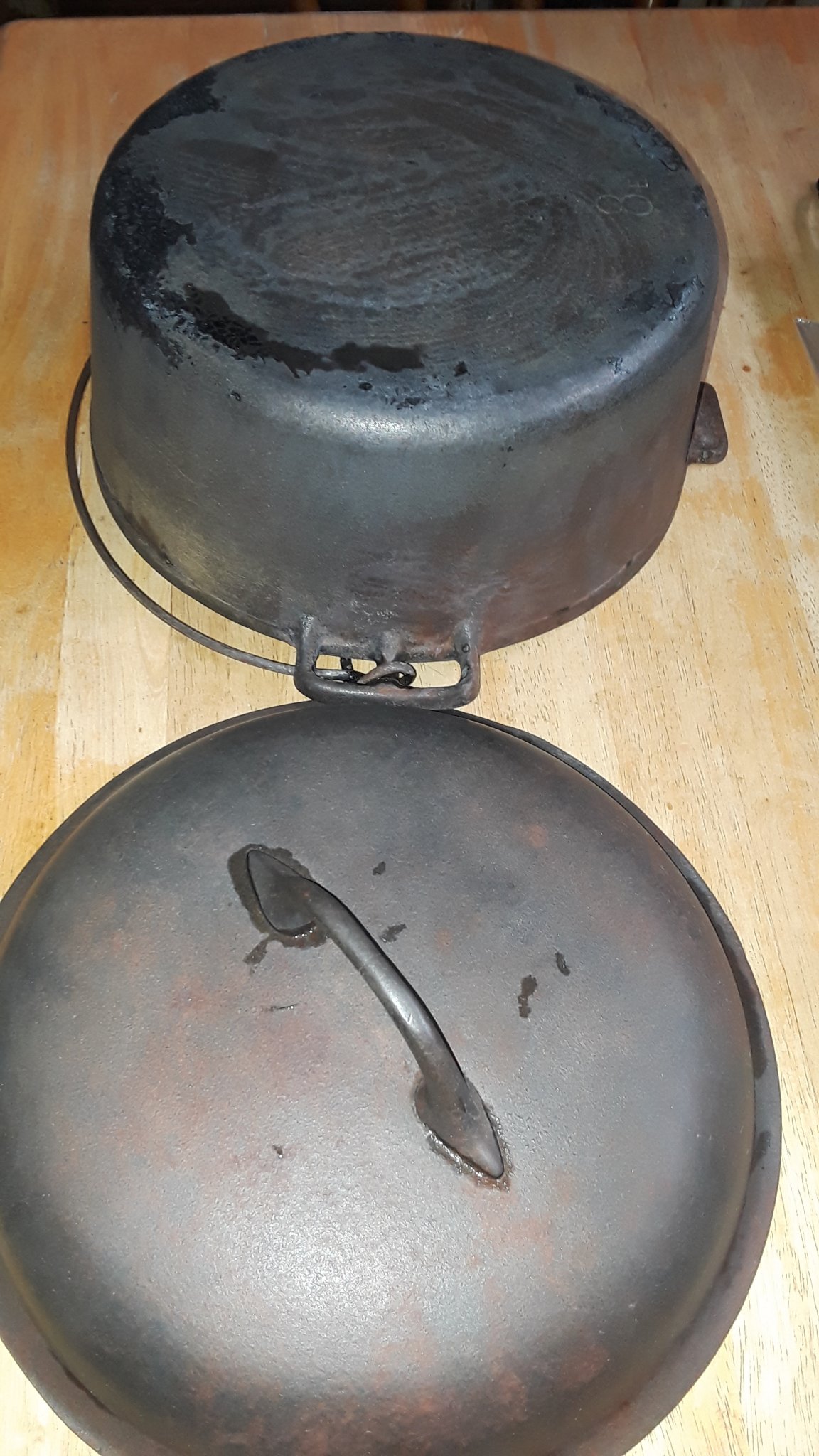

Saga of the rust bucket Dutch oven continues.
Two and a half days ago it looked like a lost cause.
1 hour worth of scrubbing and washing after a 48 hour soak in the oven cleaner inside a garbage bag resulted in this.
Conclusion Easy Off oven cleaner is viable but doesn't do all the work.

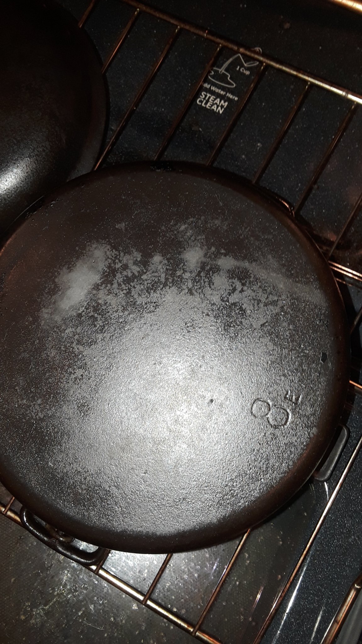

Another cleaning and now a first round of seasoning. Looks like the old gal will survive the abuse.
Being left to die out in the rain and cold is a sad death.
So what kind of Dutch oven is an 8e ?
And yes would have been better to take that picture before it got to 500 degrees. Lol

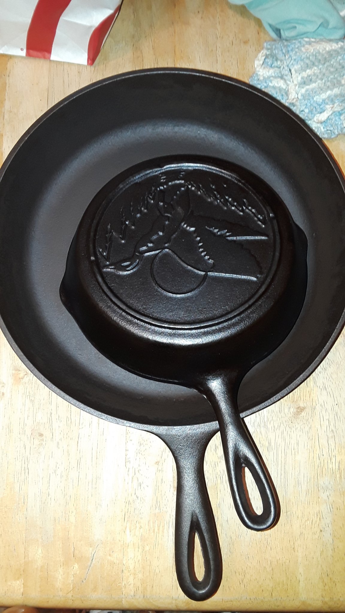

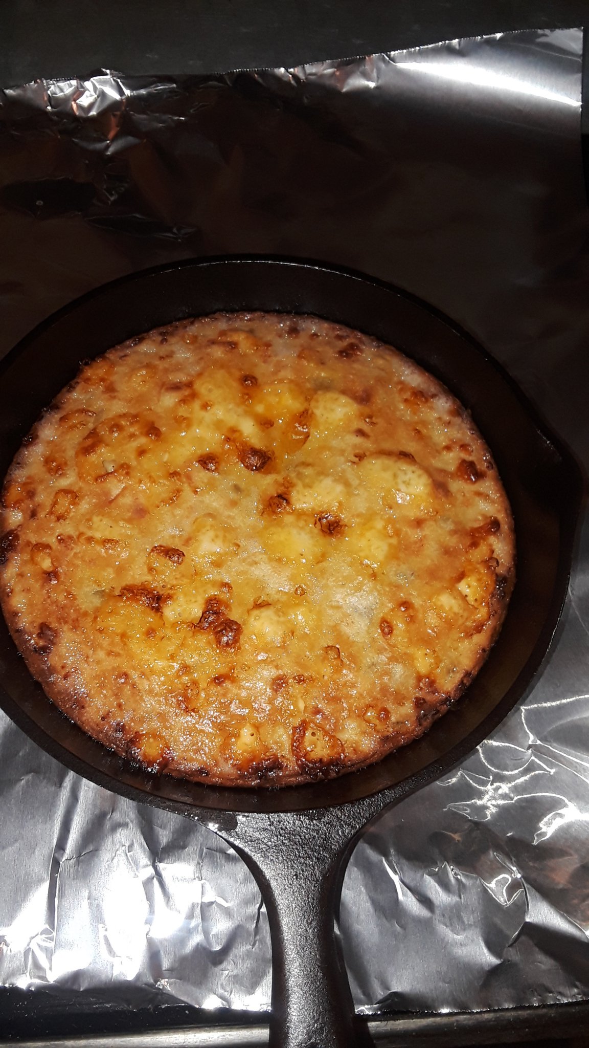

So had to break the cherry on the restored duck pan.
Heat it up 425 degrees.
Crisco it up and let heat 8-10 minutes.
Was feeling my oats so added hatch chillies and way too much cheese to a white cornbread mix.
It sizzled when it hit the pan as it should.
Half hour or so later.
Flip and walk away.
Fell out on it's own.
That's the way we do it.

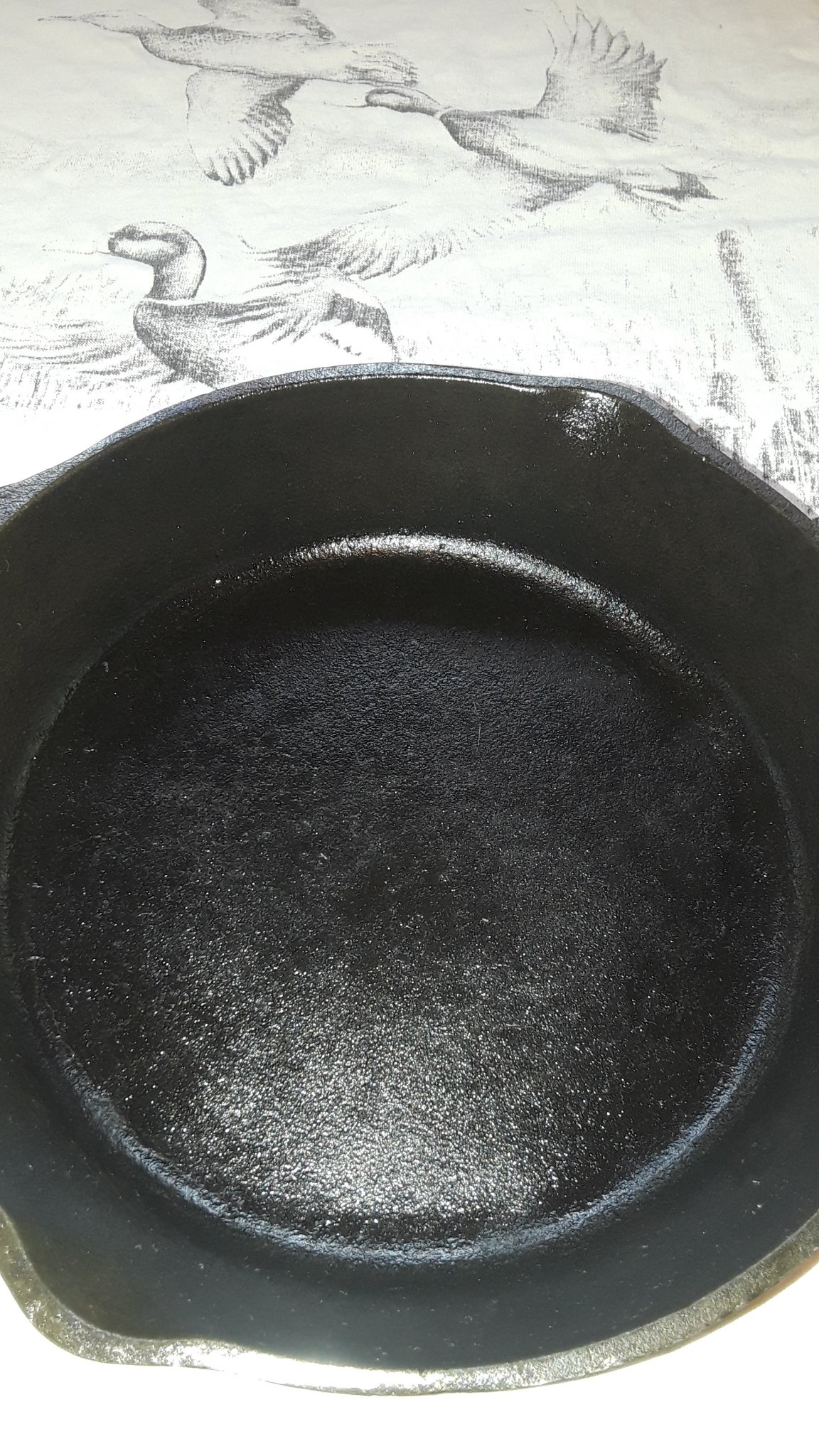

Here is the duck pan with about 8 seasonings on it in contrast on
a pan with the first two.

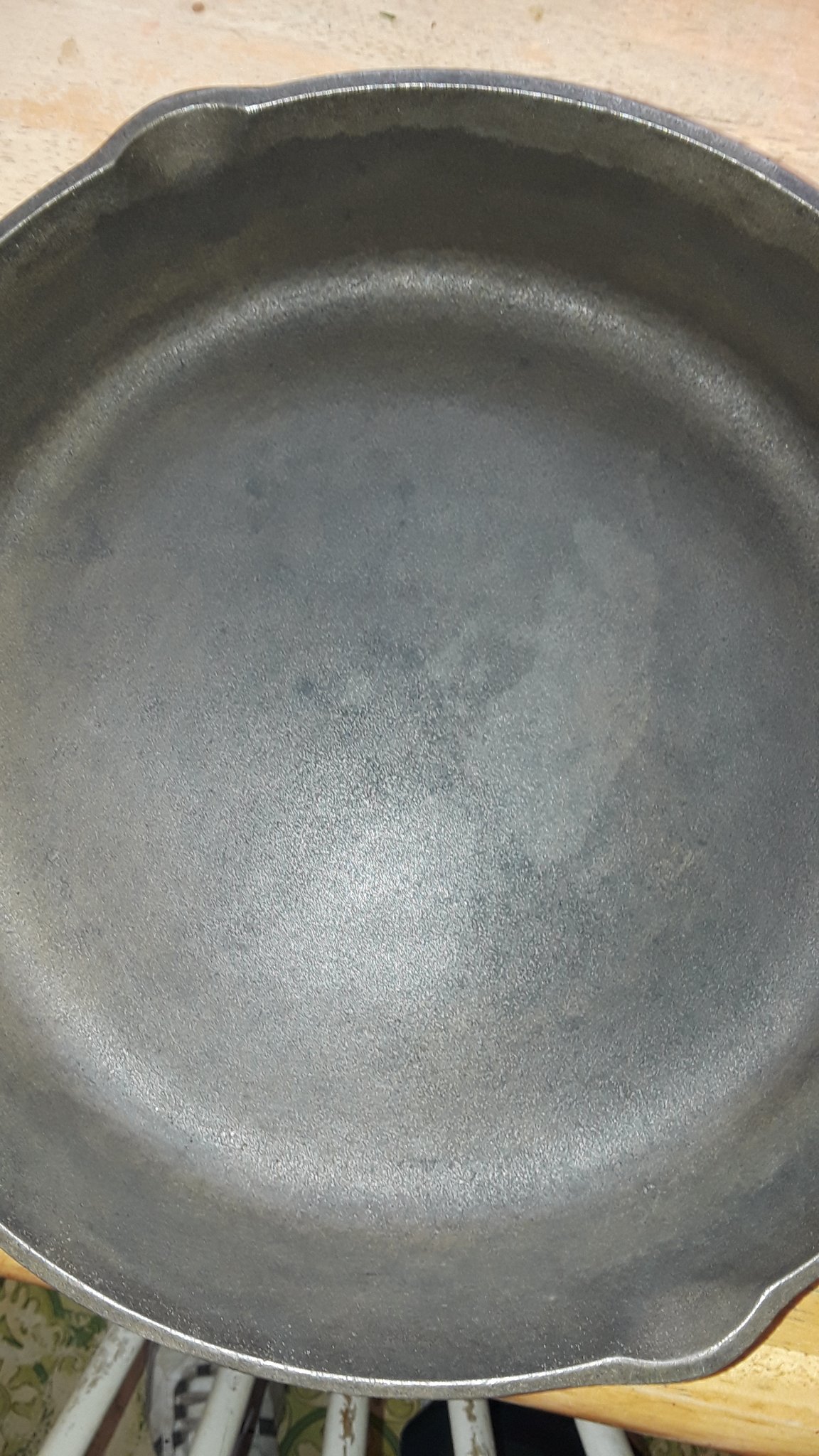

The big pan was in the grey (stripped) earlier today.
Here is a tip.
I don't care what process you use to strip it down to grey.
And then you decide it could use a good wash to clean out the pores of stuff. (Sterilised)
Use cold water and soap to give the final clean before seasoning.
I stupidly used the dishwasher.
The hot water on the pan started to flash rust before it was dry and quicker than I could get oil on it.
No time to take a picture but got ugly quick.

Here is the duck pan with about 8 seasonings on it in contrast onView attachment 8097558 a pan with the first two.
Here is a tip.
Plus, a lot of dishwashing detergents have chlorine in it, so they’re corrosive.

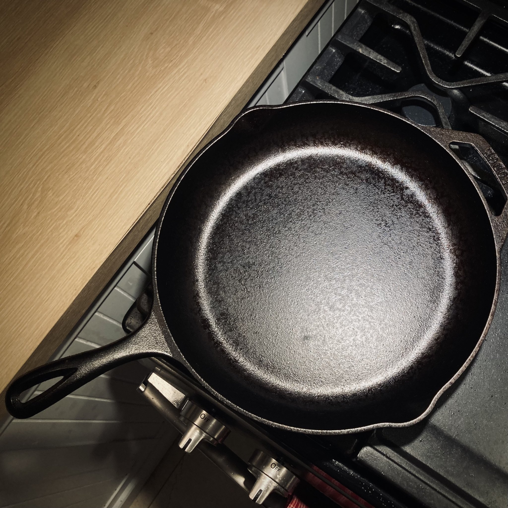

If I was buying new today, I would buy Smithey.
Older Wagner, Griswold, and Birmingham Stove are also great.,
Not a lodge fan, at least the modern stuff, as it it too rough
I've warn my Lodge down with use, but you're right, it's not worth the added hassle.
Smitchey are insanely slick and are the very best I have used. Expensive and worth it if you cook on cast often.

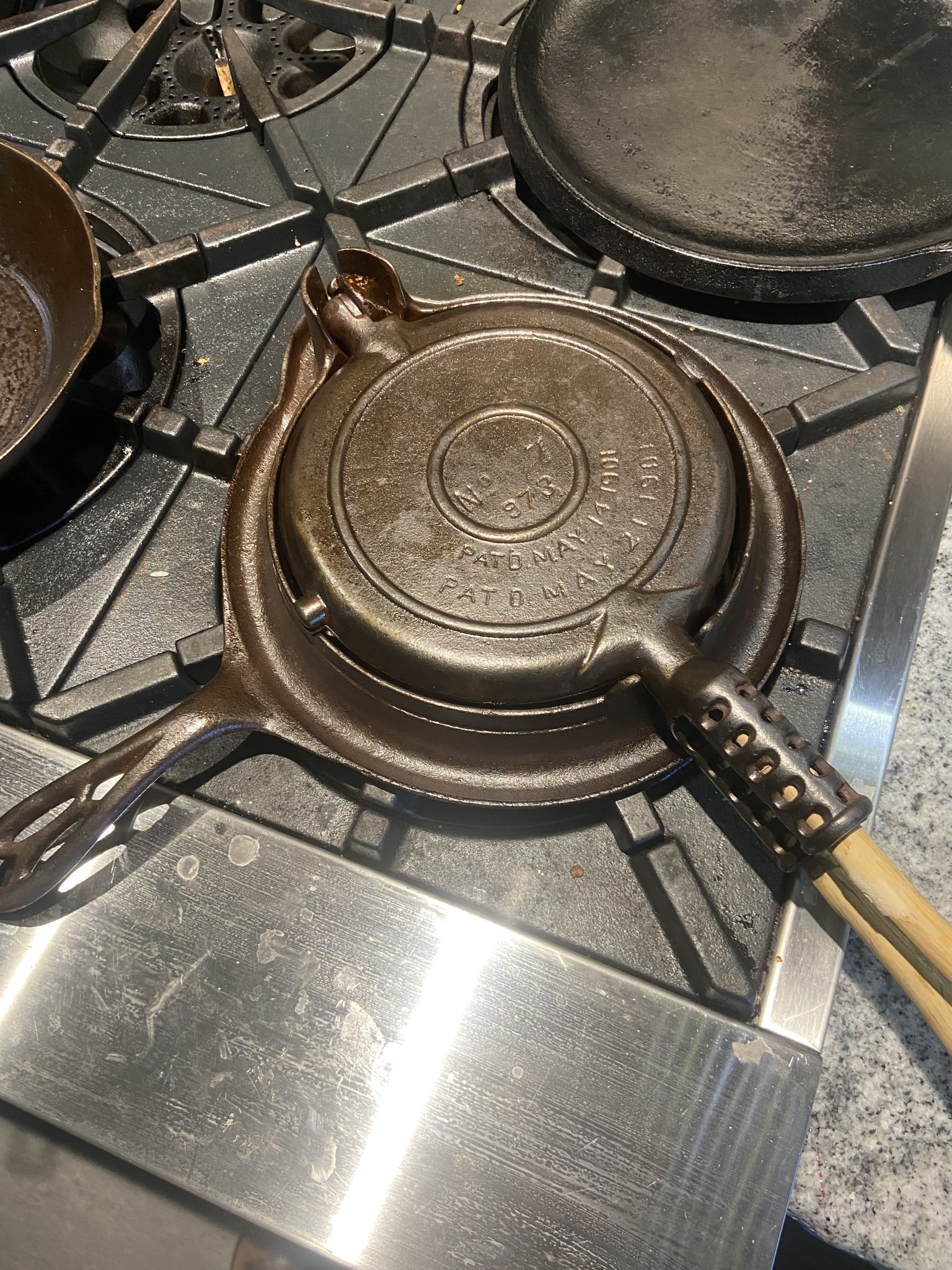

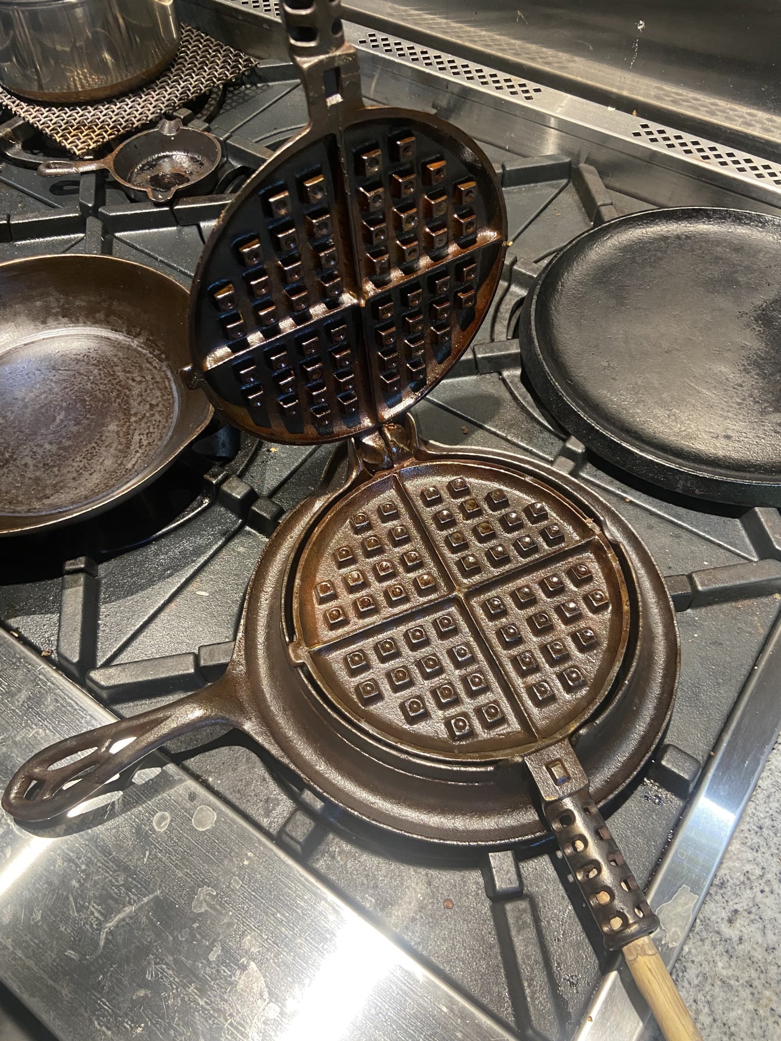

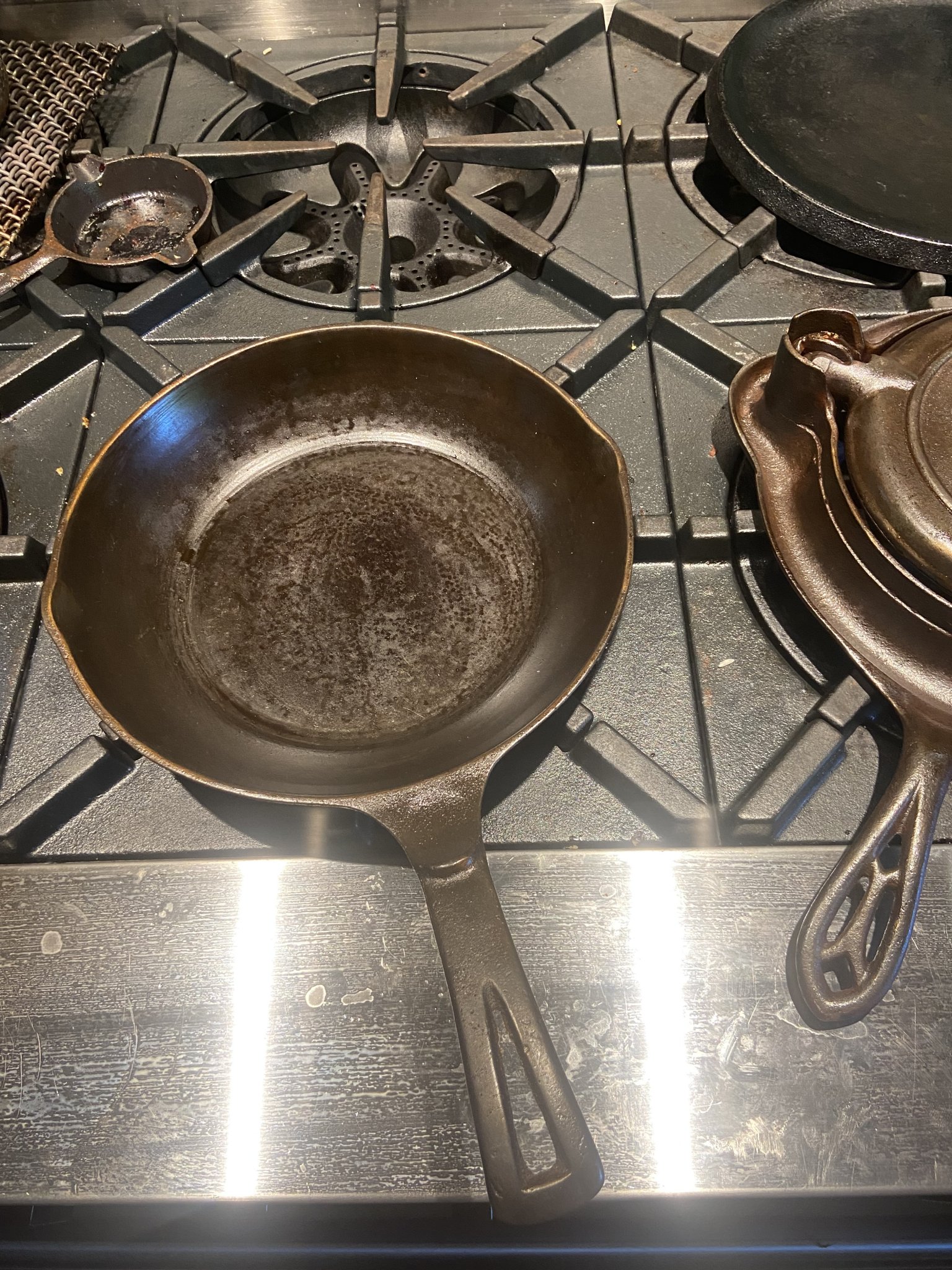

Just got done resurrecting a couple unique finds, a 9” chefs skillet and a Griswold #7 waffle iron. I can hardly wait until tomorrow morning for waffles!!

The best cast iron is not modern at all. Best stuff is smooth finish vintage. Griswold, early Lodge, Wagner, Favorite, Volrath, Martin. New shit with sand grain casting is worthless to cook in.
I hear guys take the newer stuff and grind/sand it smooth. I need to do it to some of mine to see the difference

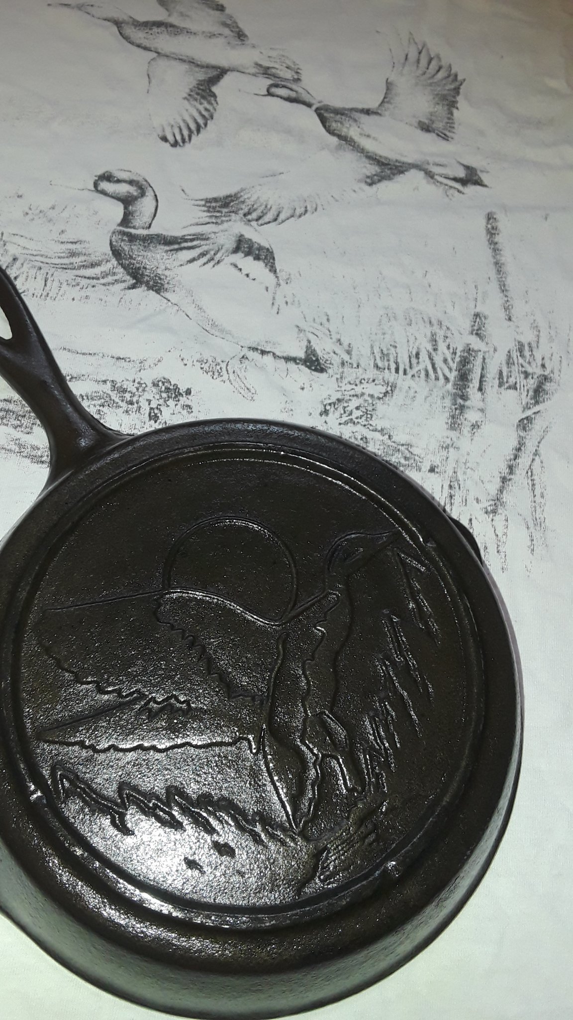

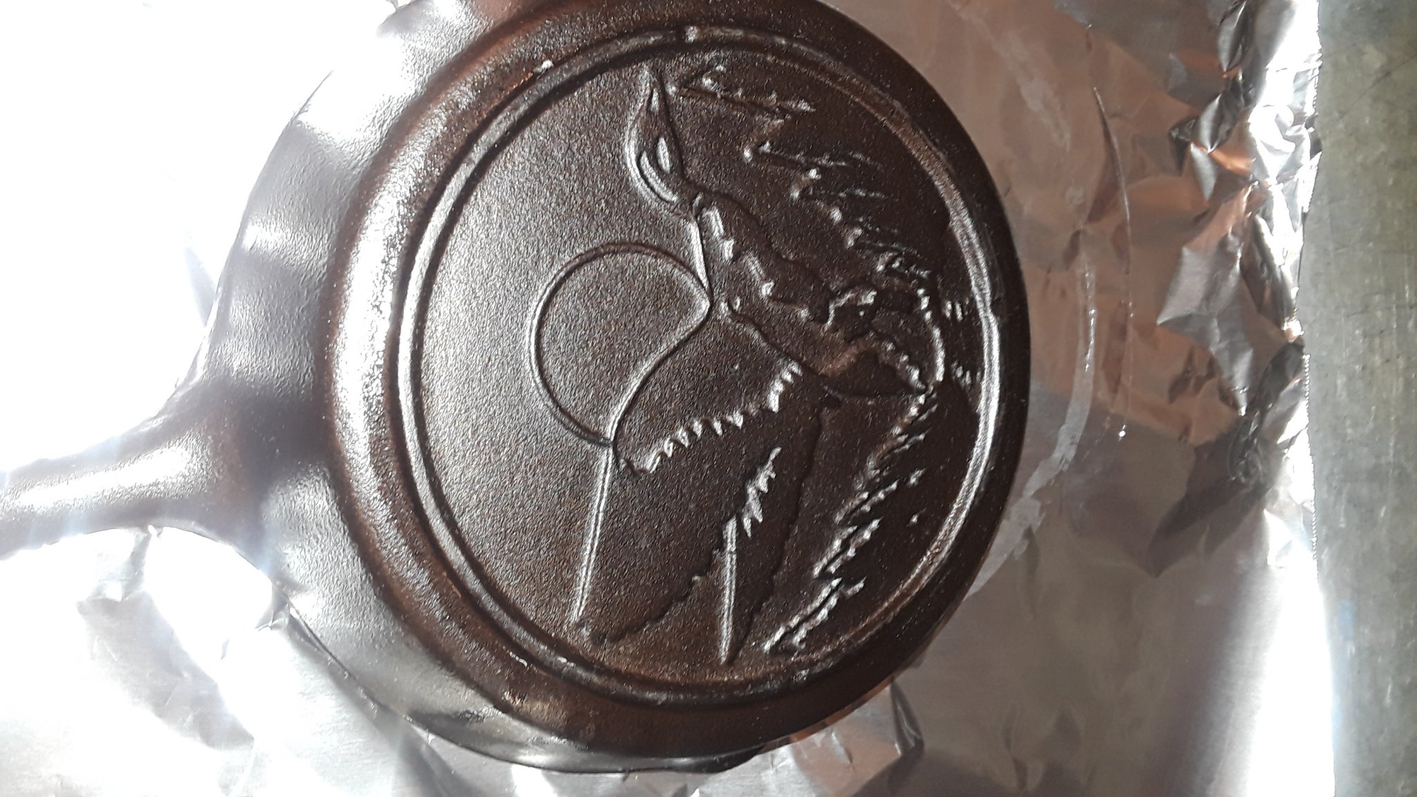

That's a Lodge brand from their wildlife series called Mallard I believe. Maybe called "flying mallard" too.
It's from the first run of the wildlife series from back in the 90's made by lodge , There's a more recent wildlife series that was manufactured by Lodge here within the last 10yrs. You use to come across them every now and then but anymore they are getting harder and harder to find.
The middle row is the complete early series wildlife pans.

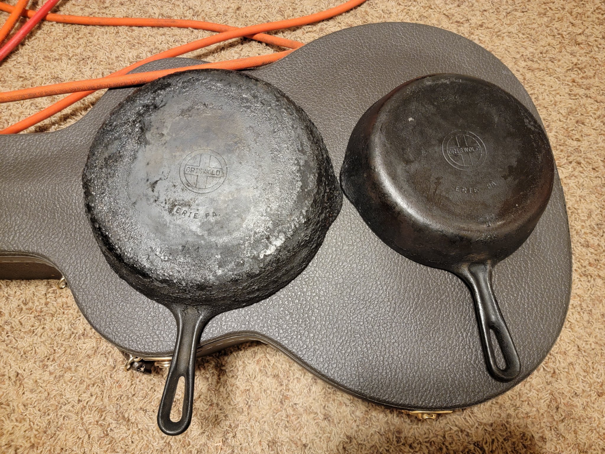

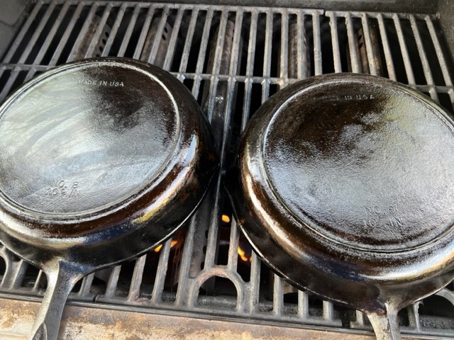

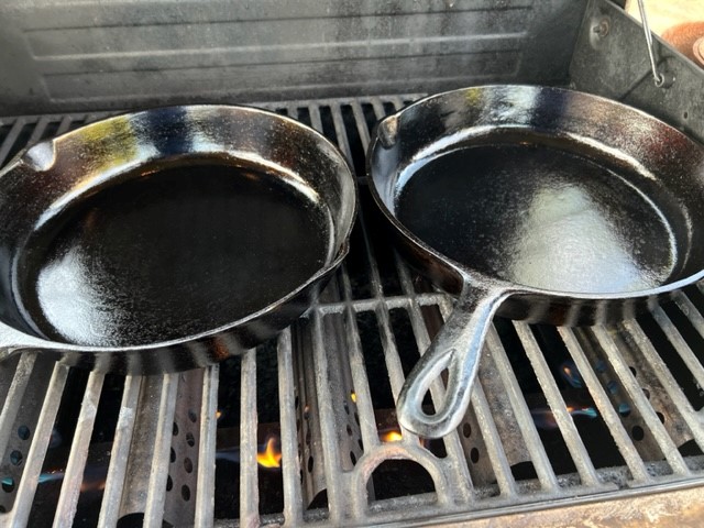

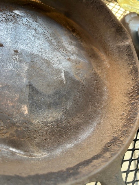

Here are a few pictures of some I did last year that were in pretty rough shape. You can see peaks and pitting in the skillet bottom. The second picture is after the sanding and scrubbing clean. I fill with water and boil out any oil or debris left behind.
The last picture shows this skillet and another that I did at the same time that was not as bad. Both turned out great.
